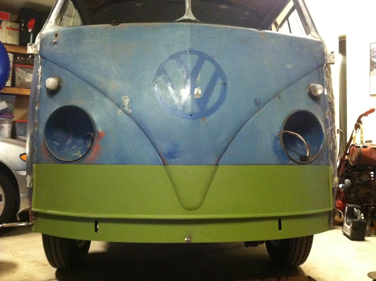

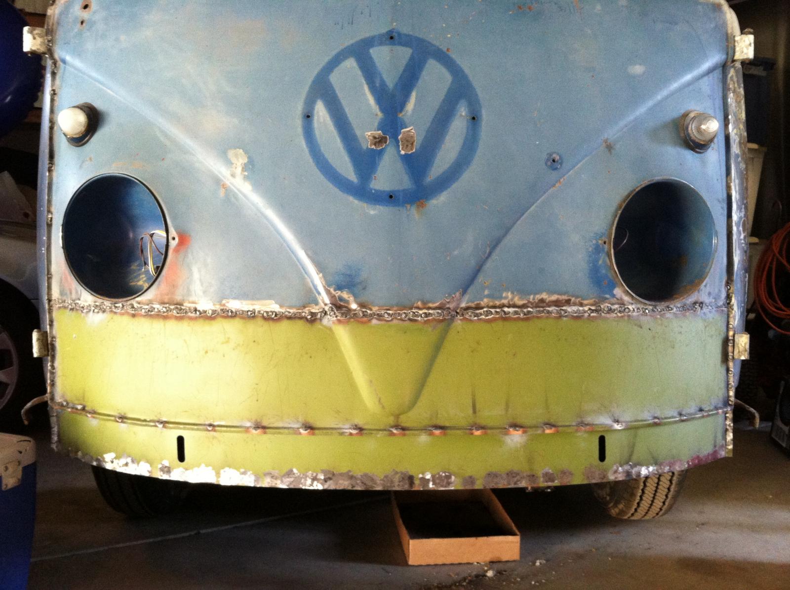

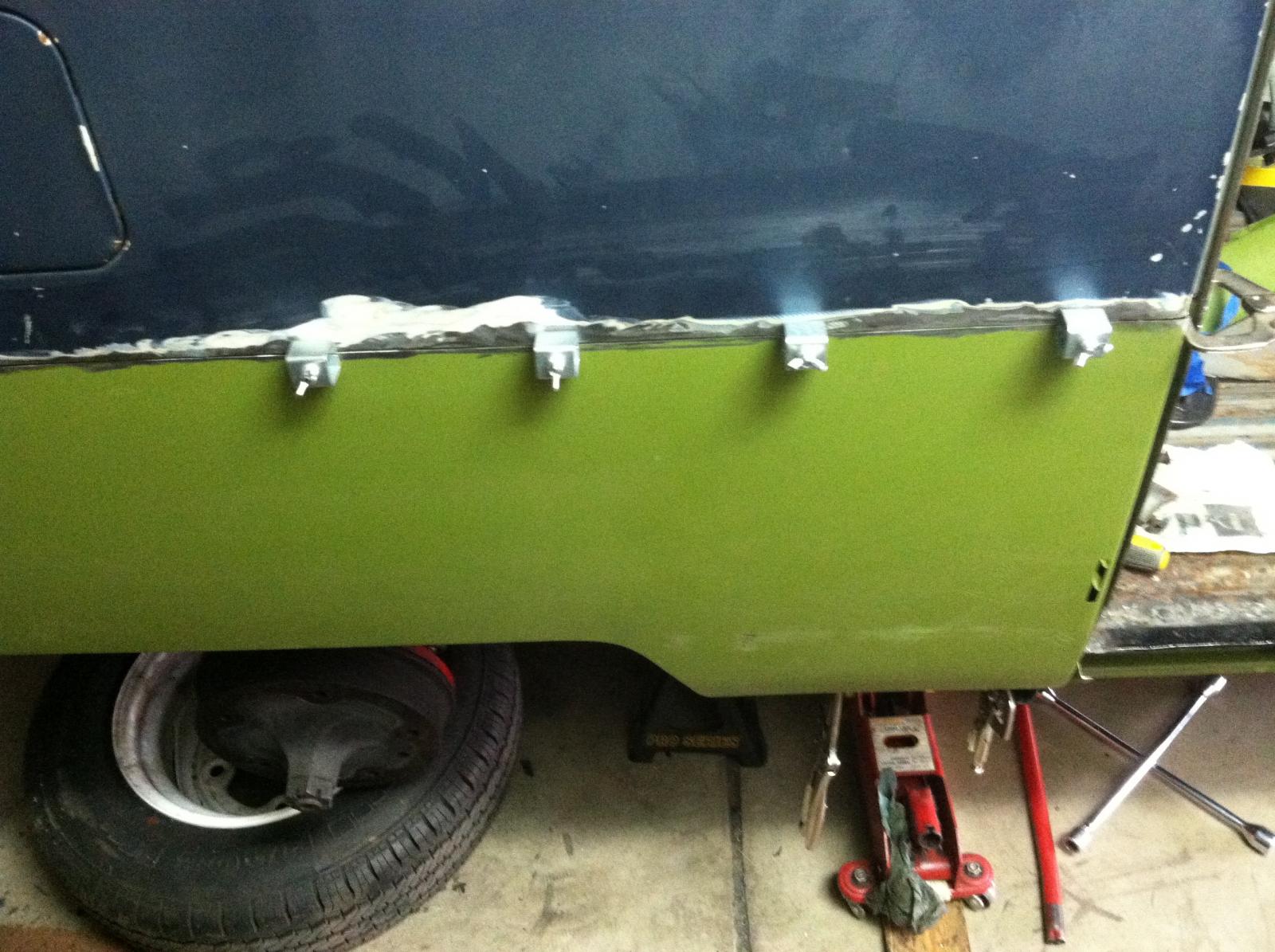

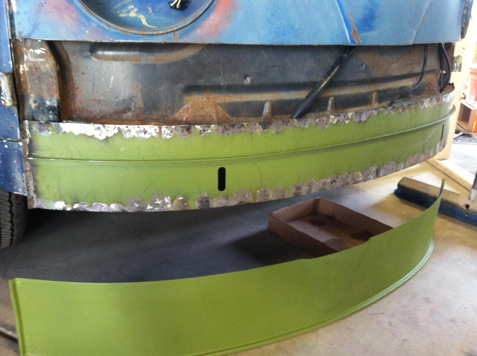

Thanks for the positive words everyone! I'm trying to stay on these big jobs and knock em out so I can move onto some other details to get this baby road-ready!
I had the second half of Saturday to tack on the Valence and size up the lower nose. It took me a while to find the right settings on my welder to tack on the valence. I had to amp up my wire to .35 gauge.
Valence and Lower Nose

That lower nose is looking good!! I spent twenty minutes on my KF panel moving the lines to fit exact. Just hammer and dollie. Take your time. Killer bus!! I have noticed this panel fits exactly on November 58 and on front skins,nothing older without re-working. Still,very grateful do have something to work with!

If you look at the third pic down on this page,you see the kf lower nose panel mocked up,notice the lower "V" of the nose in the center, the lines are wider at the indentations on the KF panel. They need to be re-worked back to fit. I believe I have pics of this somewhere on the sleeping beauty forum. Not too bad of a job.

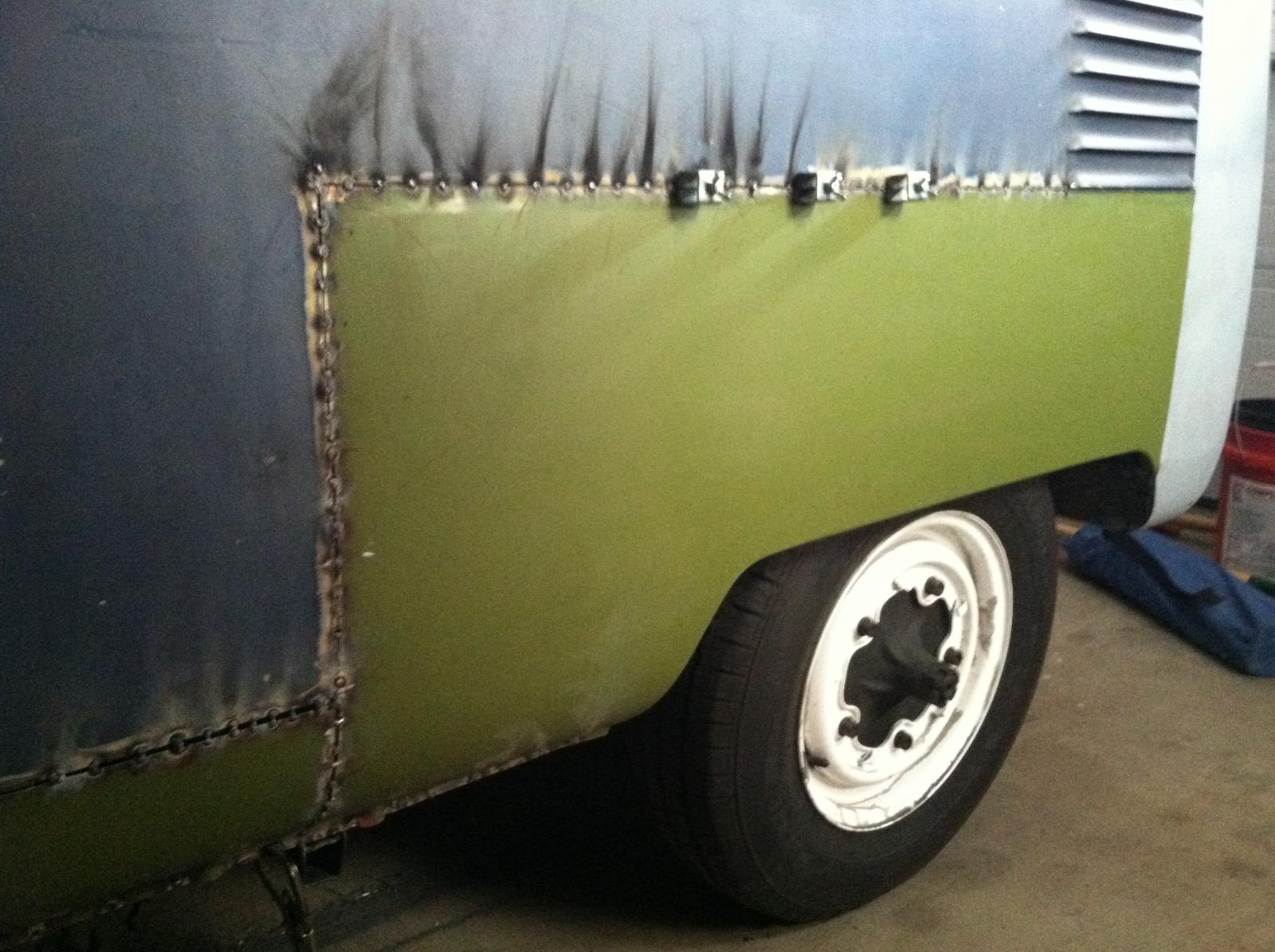

Ski season keeps me busy but getting back at it...started on the lower driver side panels Very Happy Have all the metal now from Gerson to finish... now just gotta make the time.

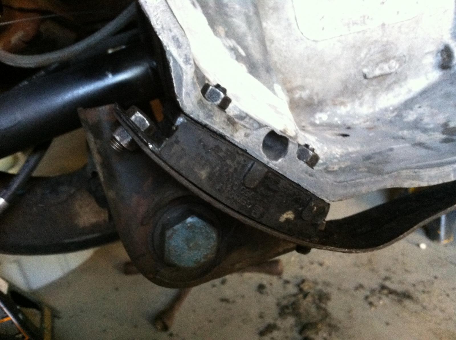

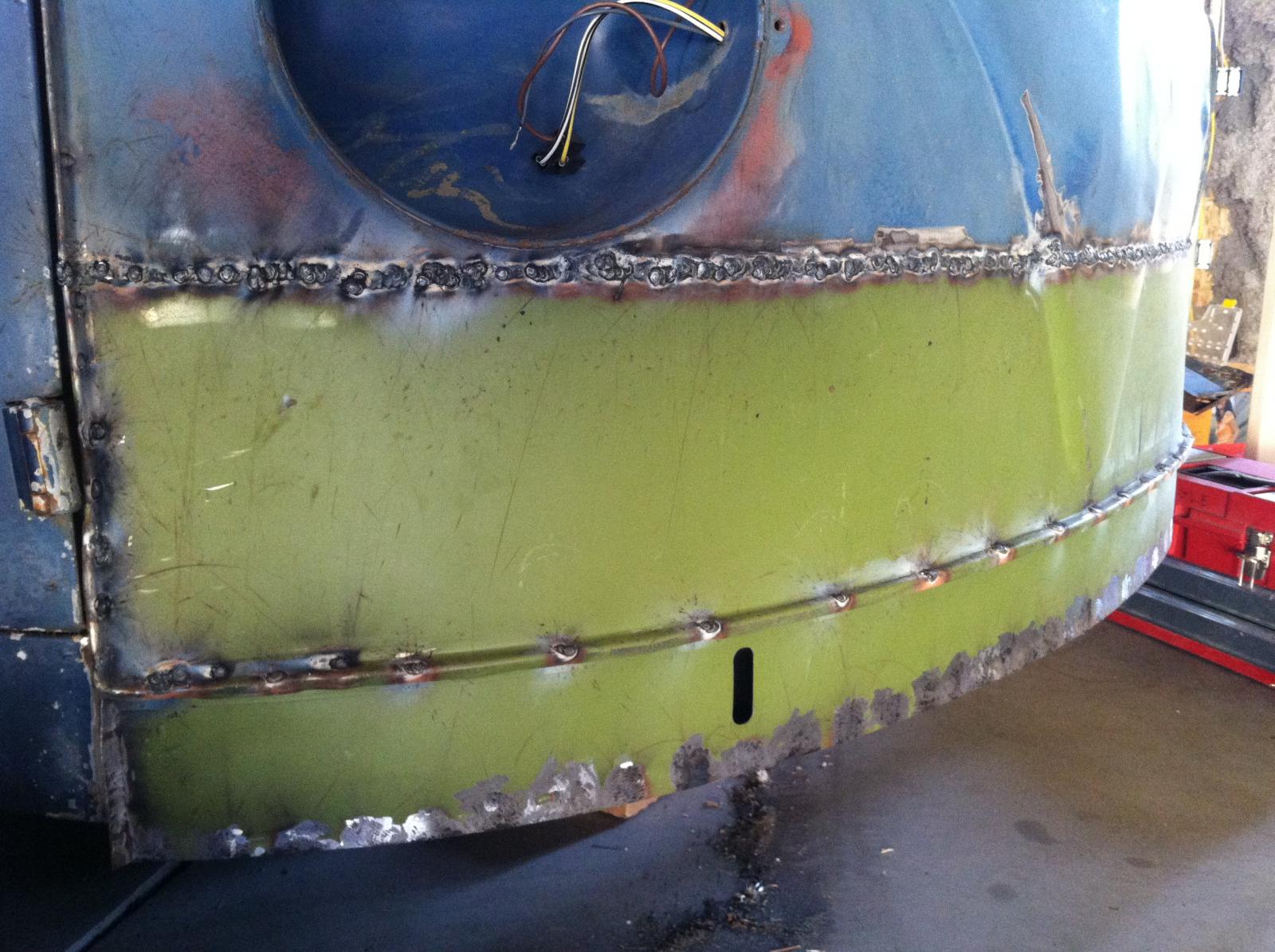

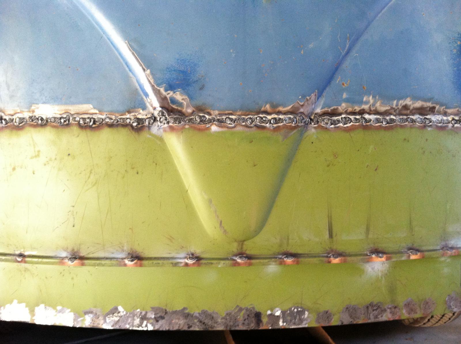

Some details of the inner valence and lower nose that I did back in the Fall 2012.
Inner Valence
Lower Nose

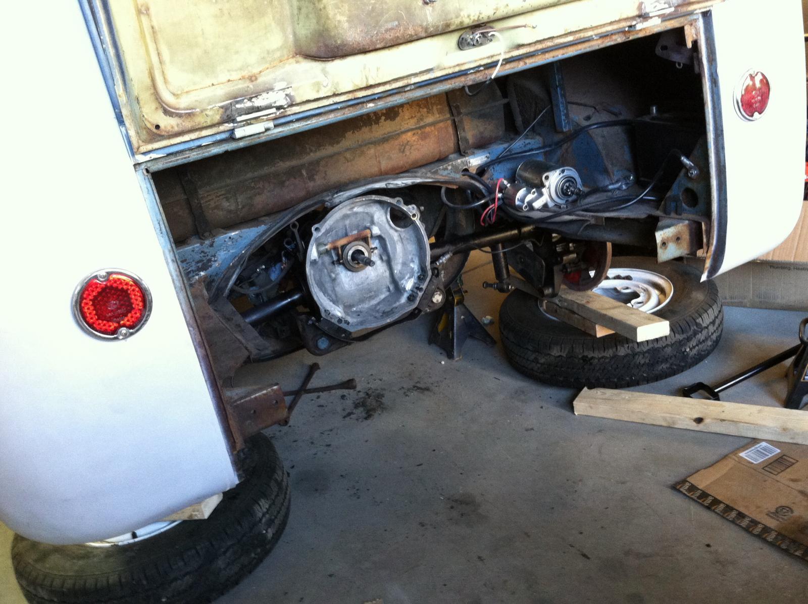

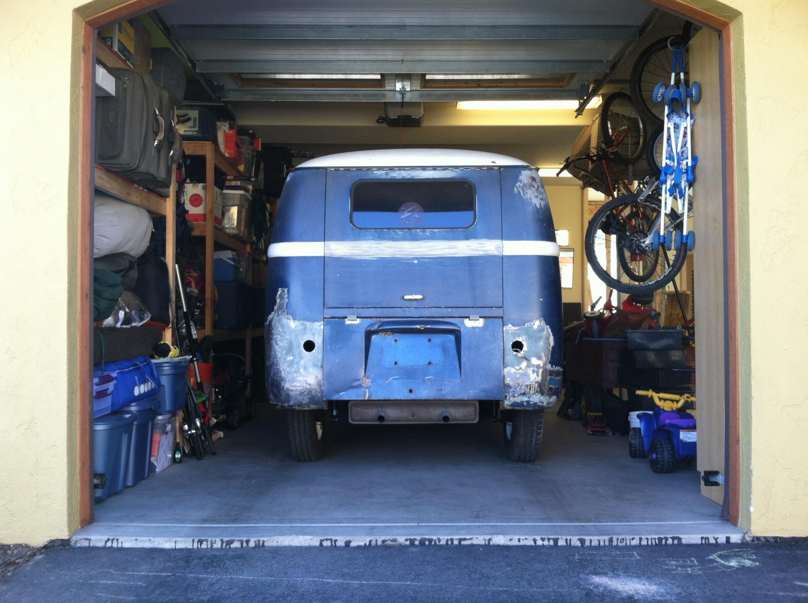

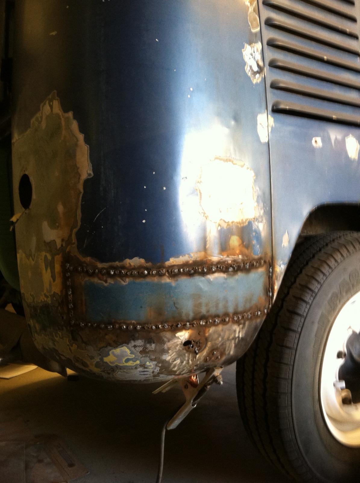

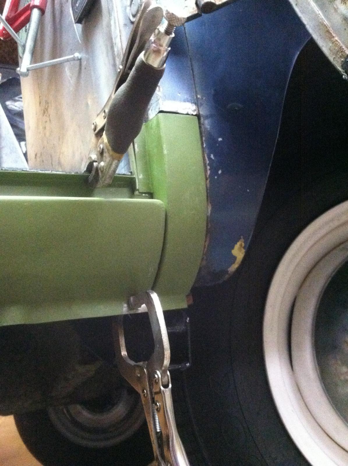

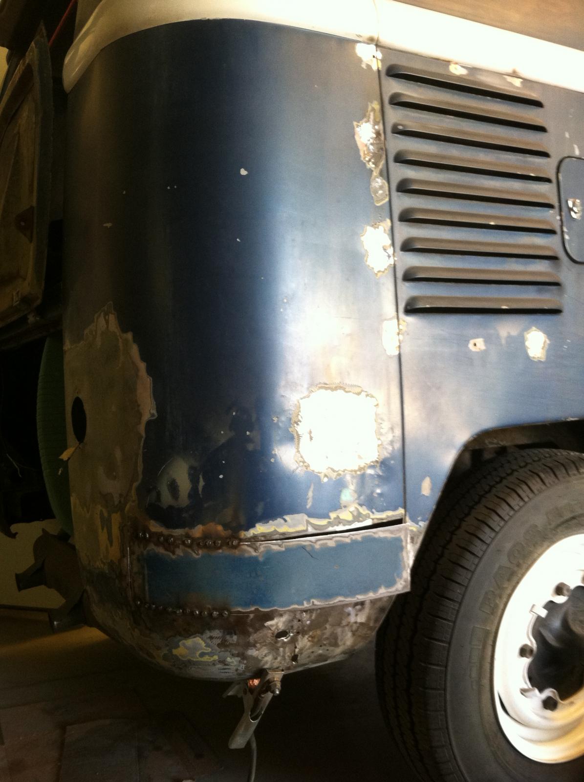

Rear Corners getting finished up. Had to bang out tons of the dents. Also had to cut out rust and replace metal where the battery tray meets the corner panel.

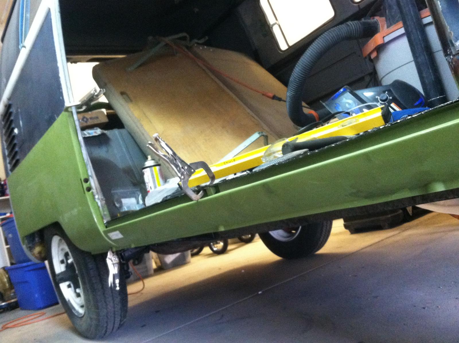

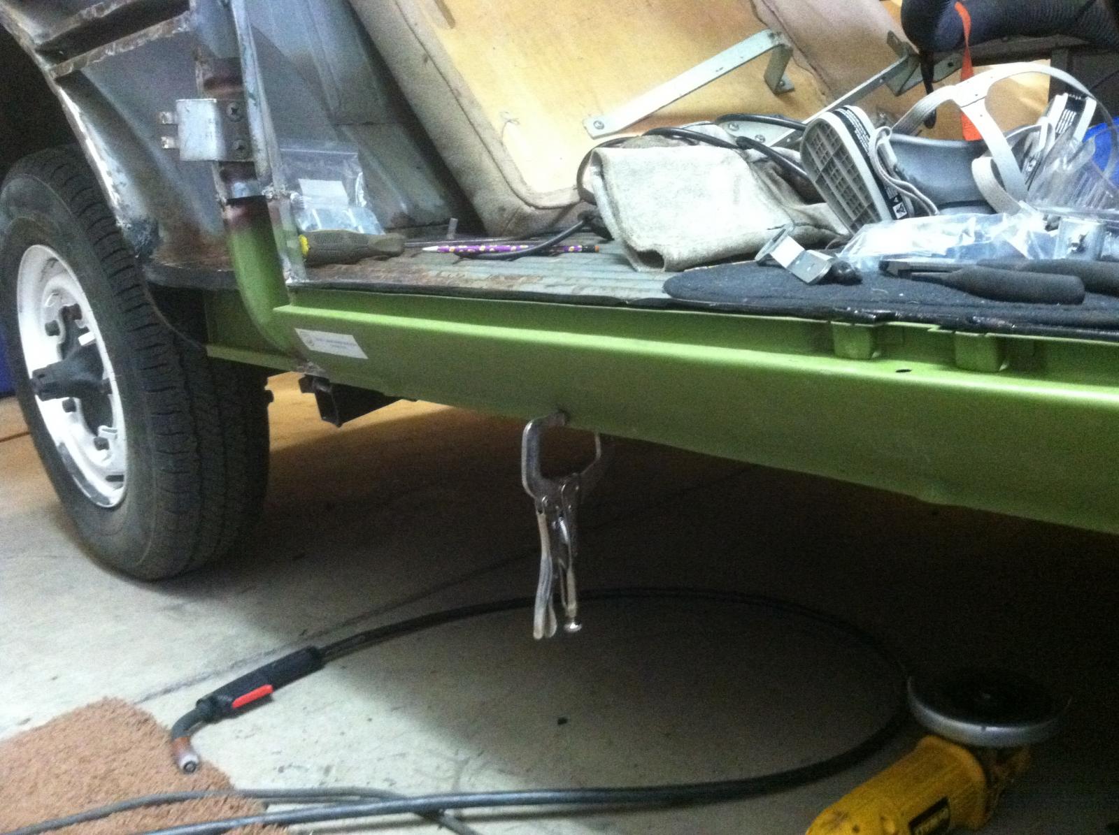

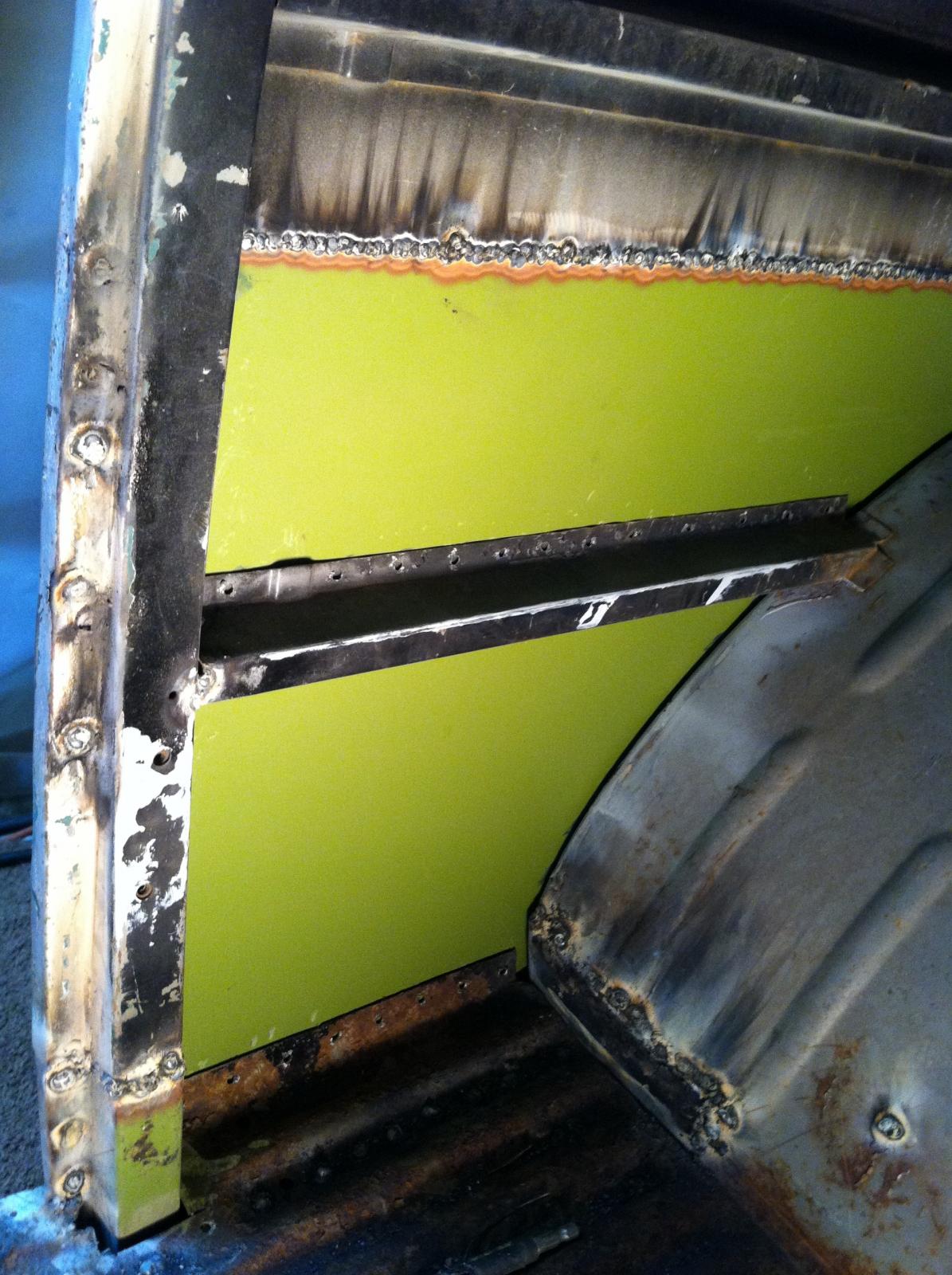

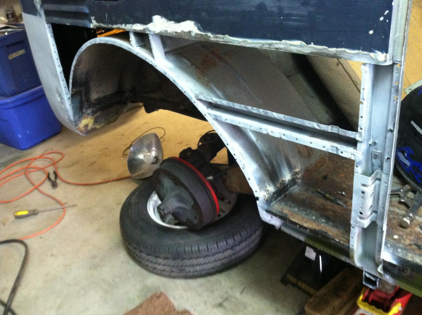

Driver Wheel Well progress. Cut out rusty metal and fabricating new.
Cargo Floor area:

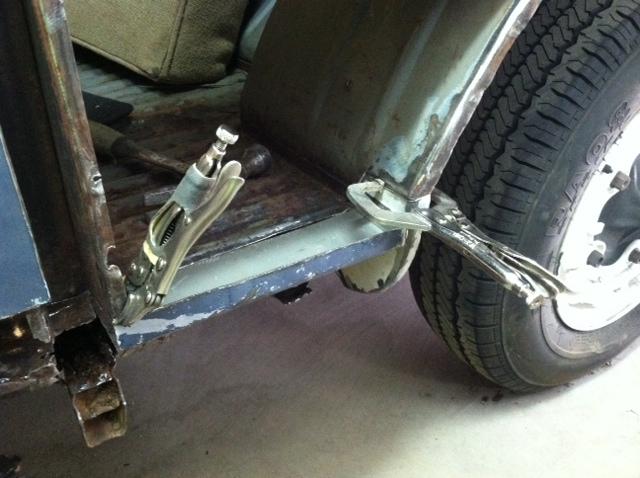

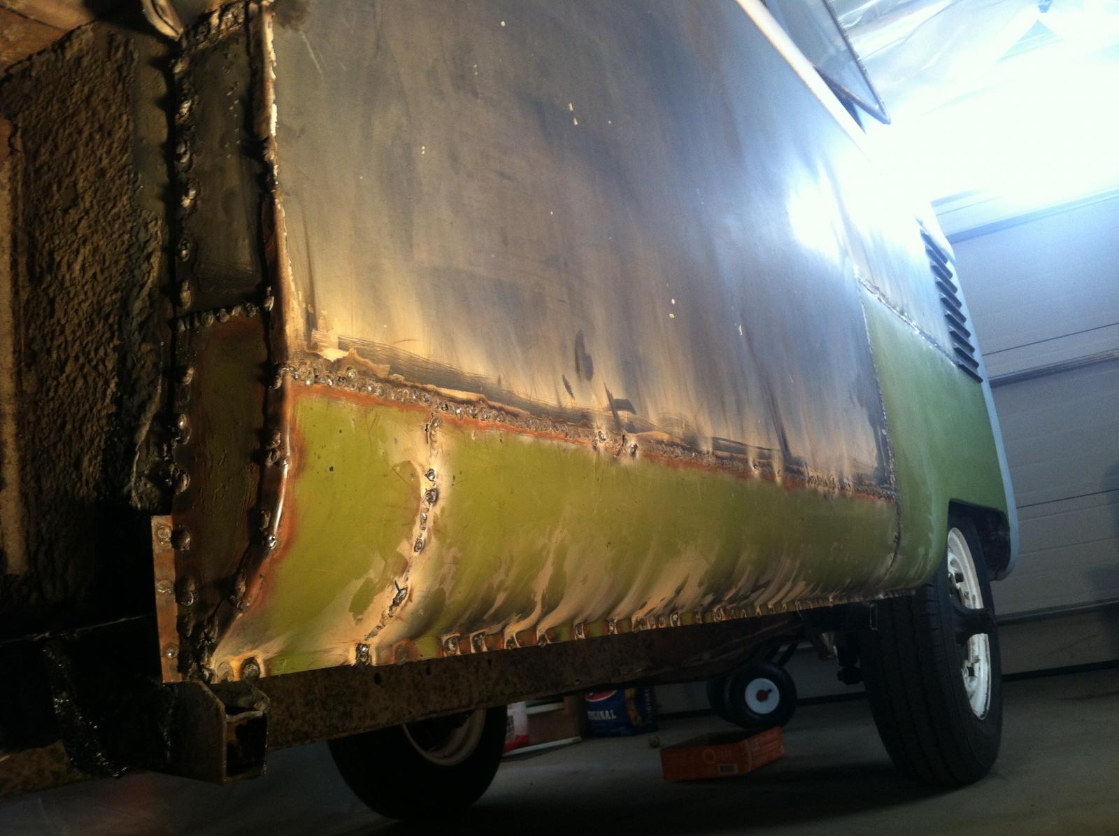

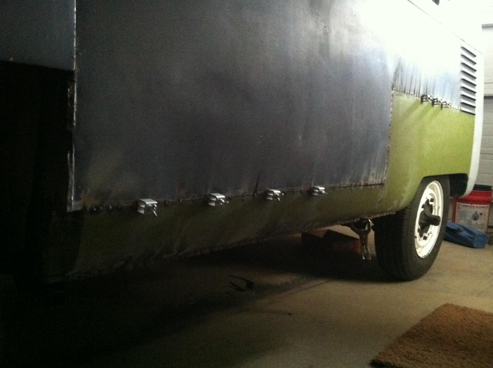

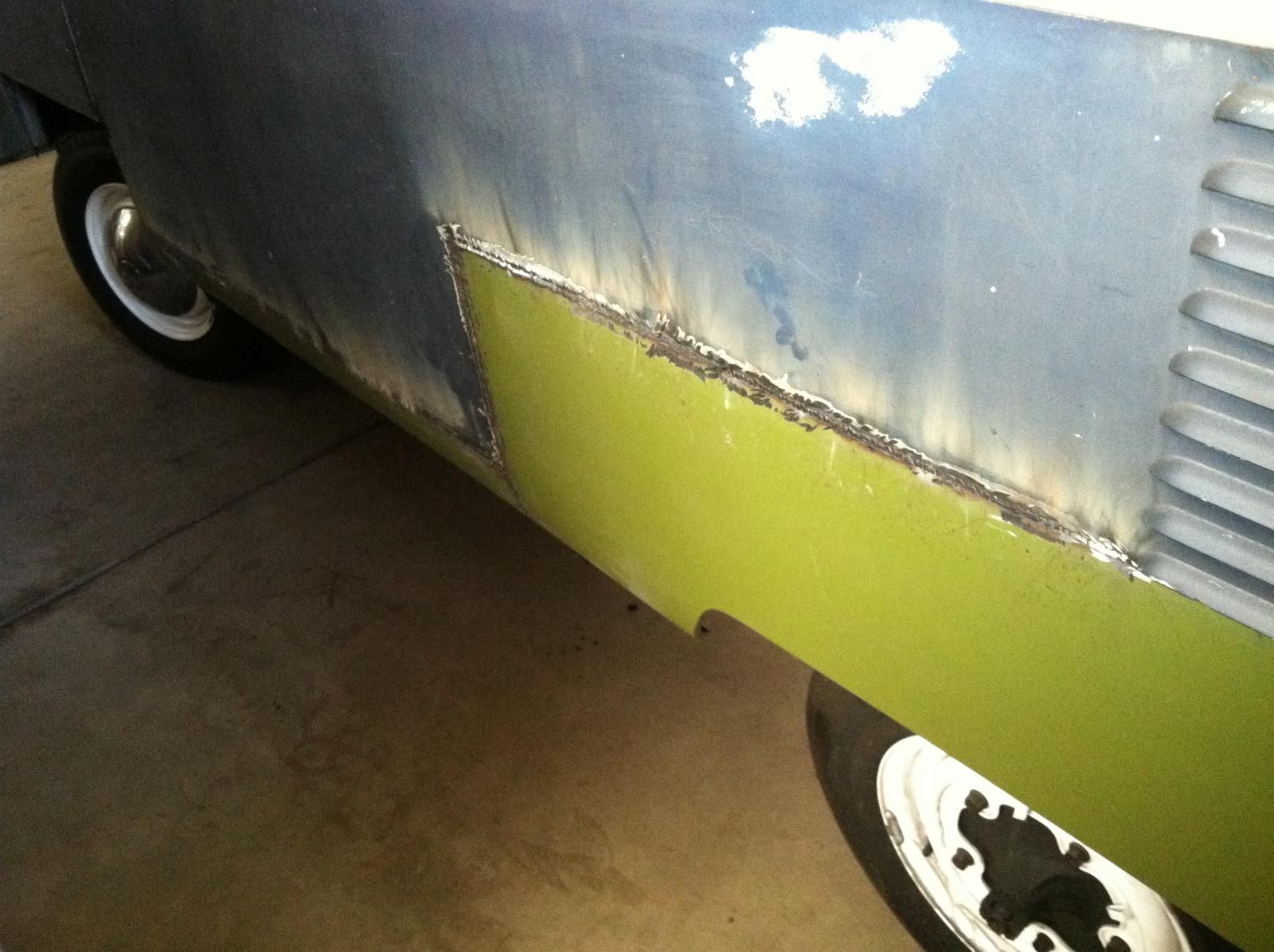

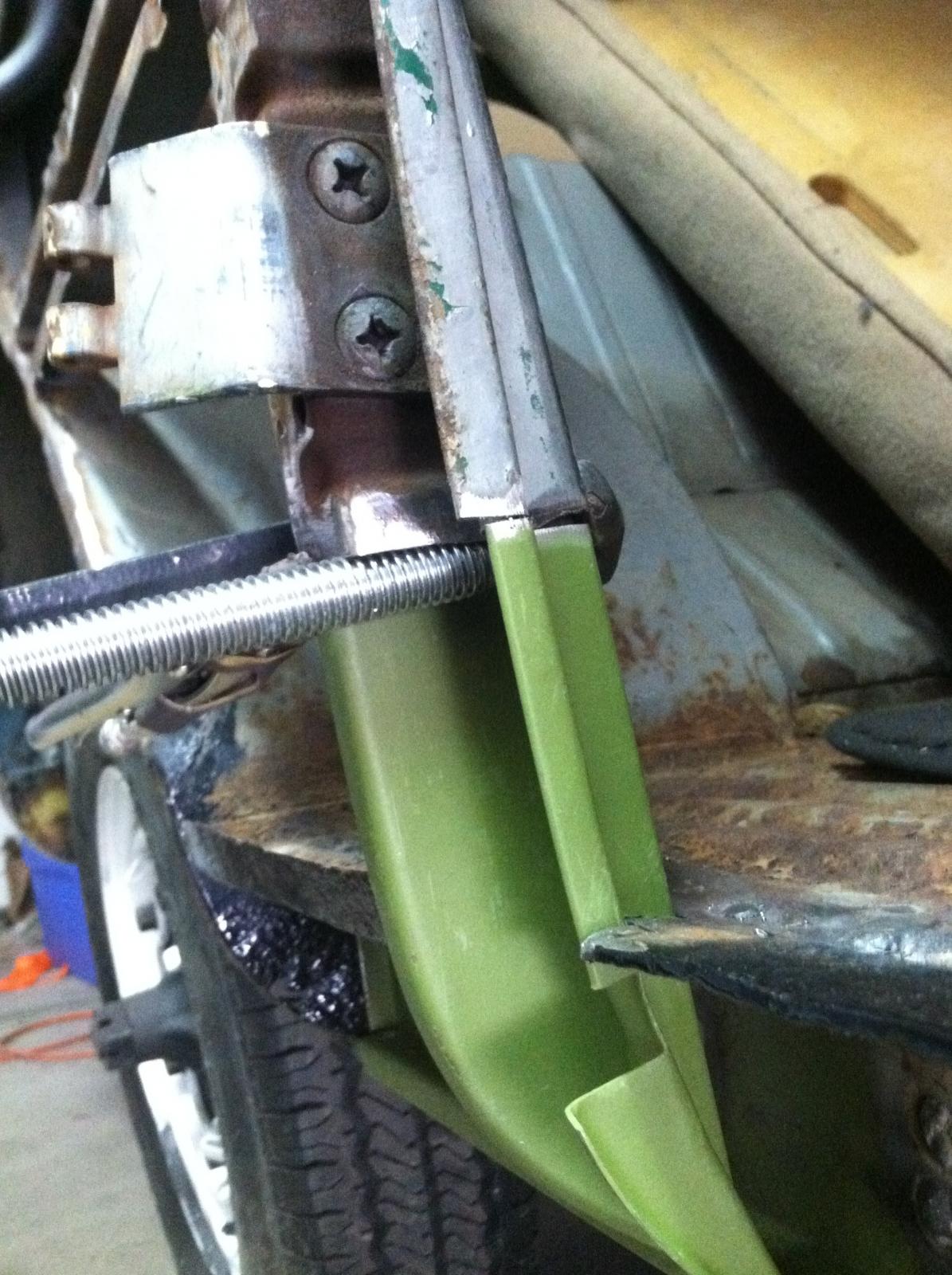

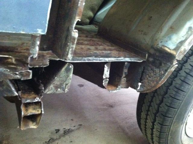

Thought I'd post some more progress on the 58. It's finally all coming together now that the big weld jobs are almost wrapped up. Still need to epoxy primer everything before driving daily. Still waiting on the paperwork from state to have it titled and registered.

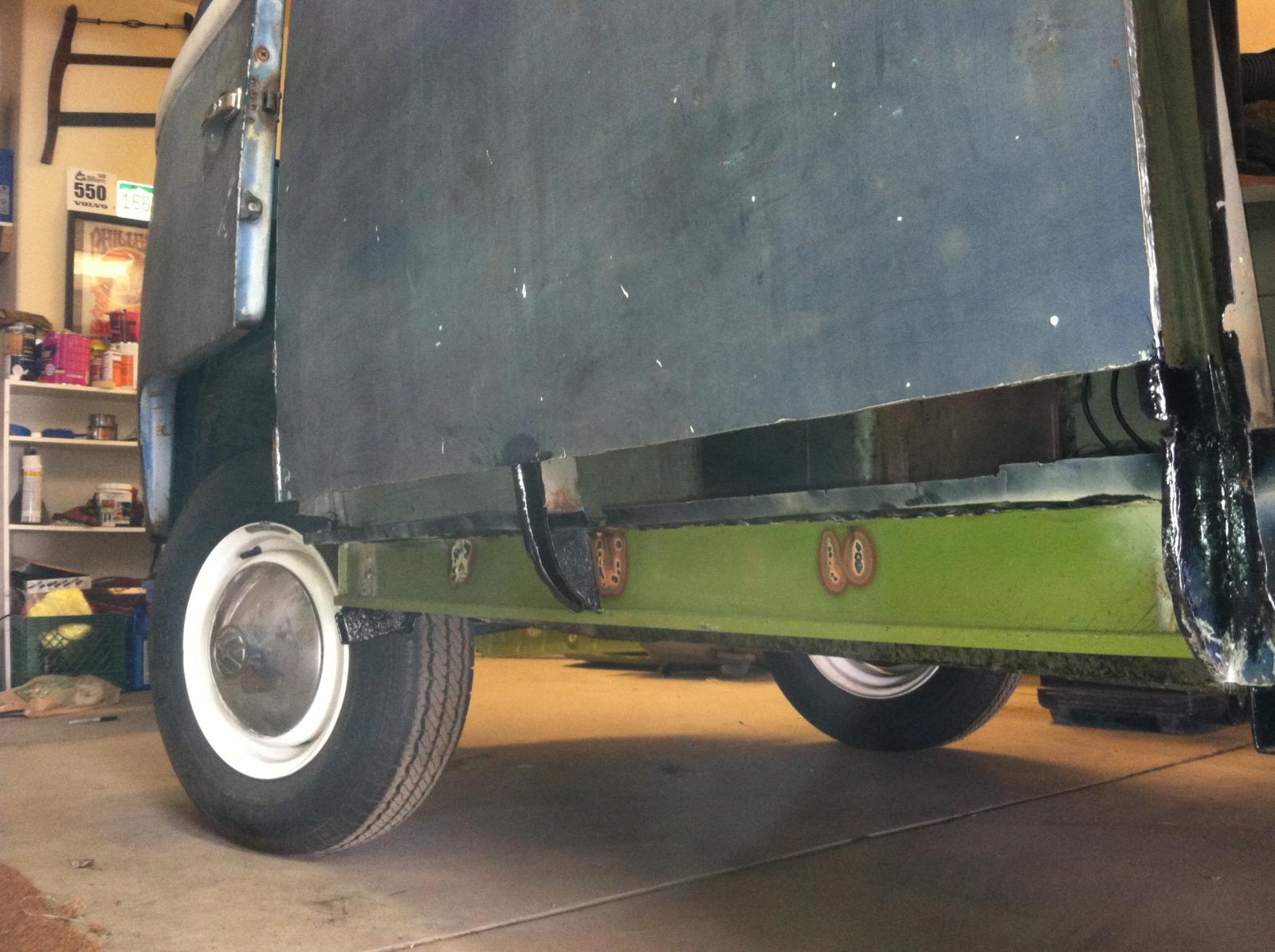

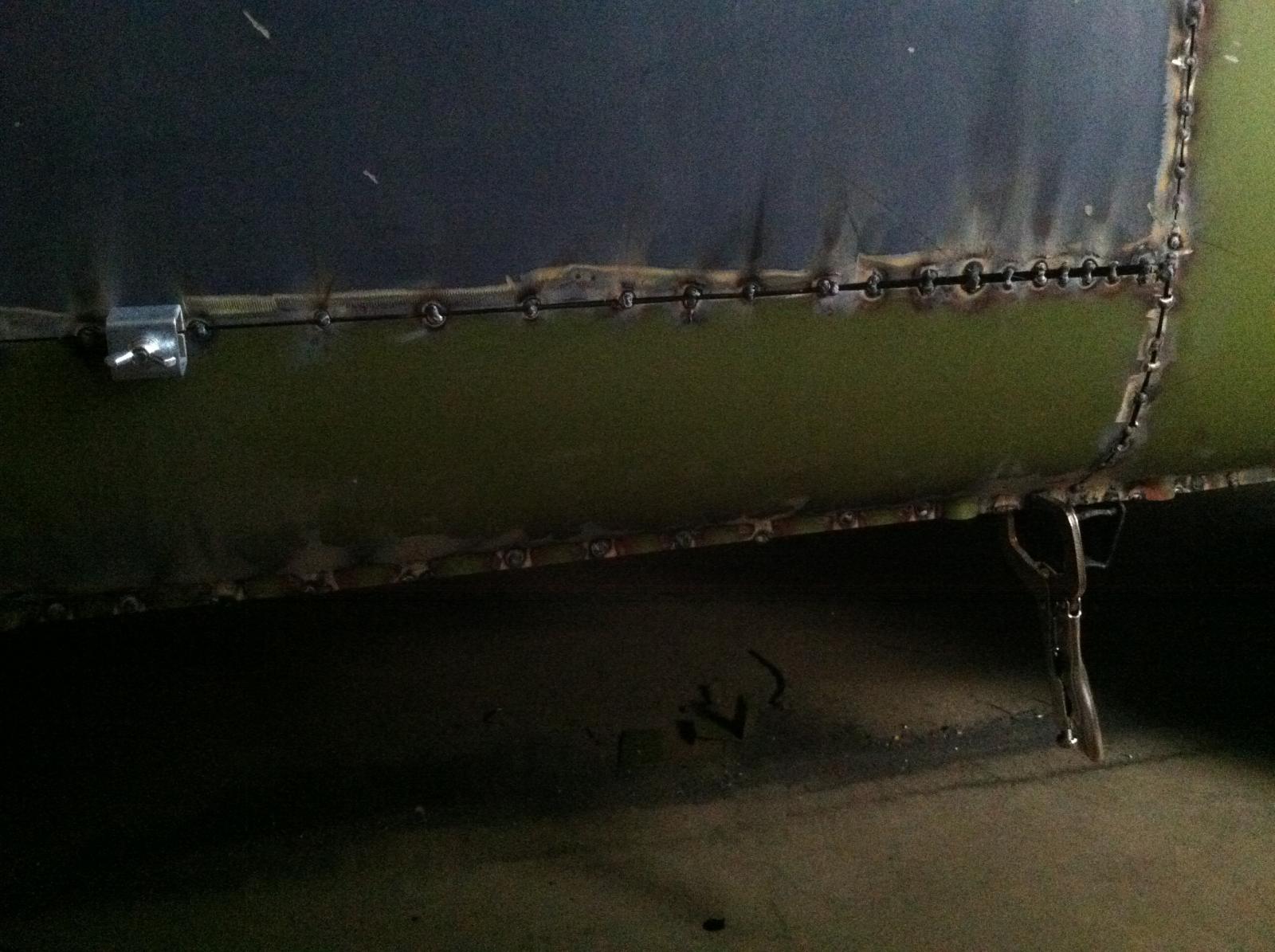

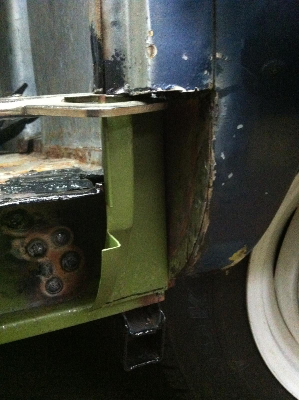

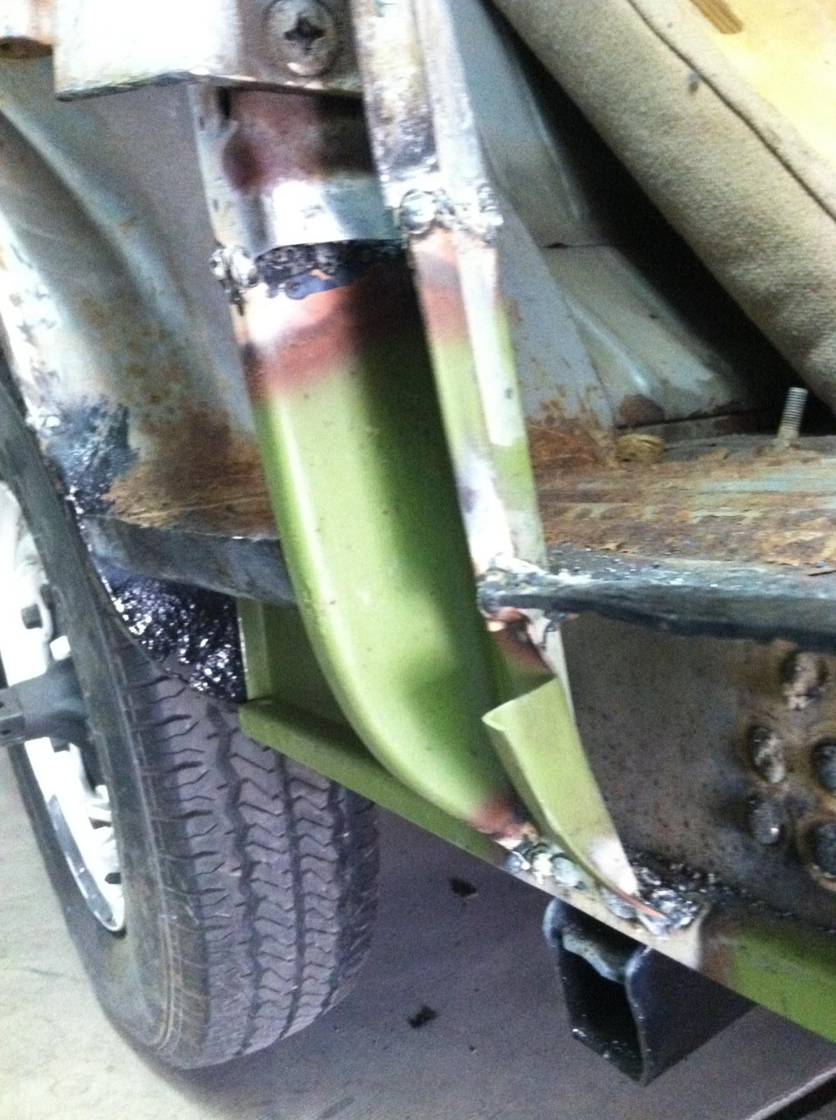

Back in the Spring and early Summer I worked on the inner and outer rockers, lower 6" of the pillars needed cut out and replaced, and the hacked wheel wells needed to get back to their original status. Cool
Inner Rockers
Pillars
Outer Sections
Wheel Wells
Driver Side Wheel Well, Rockers etc

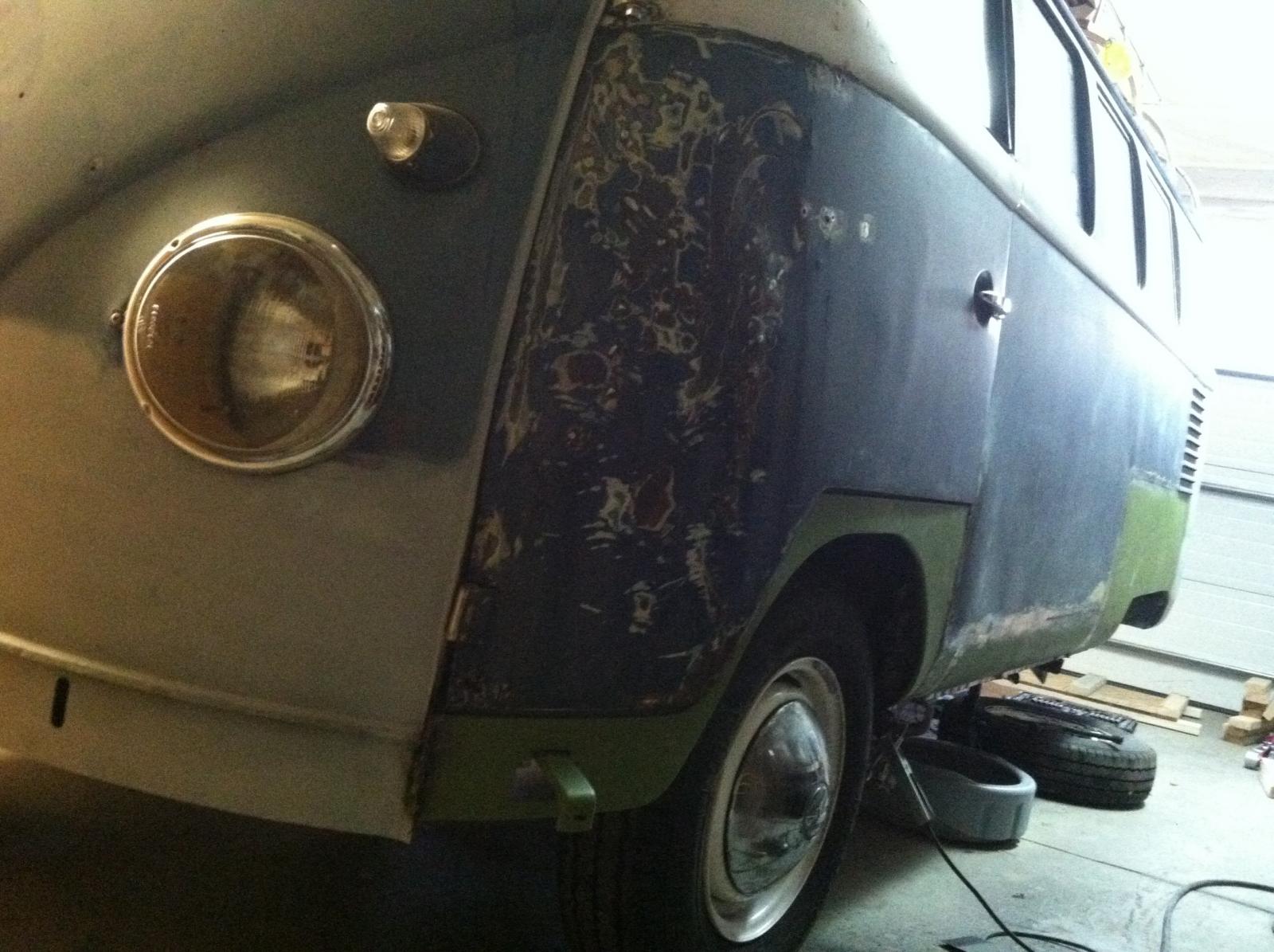

Also recently removed some paint to reveal og dove blue paint but it's in really bad shape. Any thoughts before I go further? It's taking forever to remove with heavy duty stripper. Would love to keep original paint but if I can't get it looking better, I might reluctantly opt for a re spray. Please Someone talk me out of that and give me some ideas on touch up, blending, etc. Thanks. Here are some recent photos. Finishing up on welding and still have a few kinks to work out on the body.
