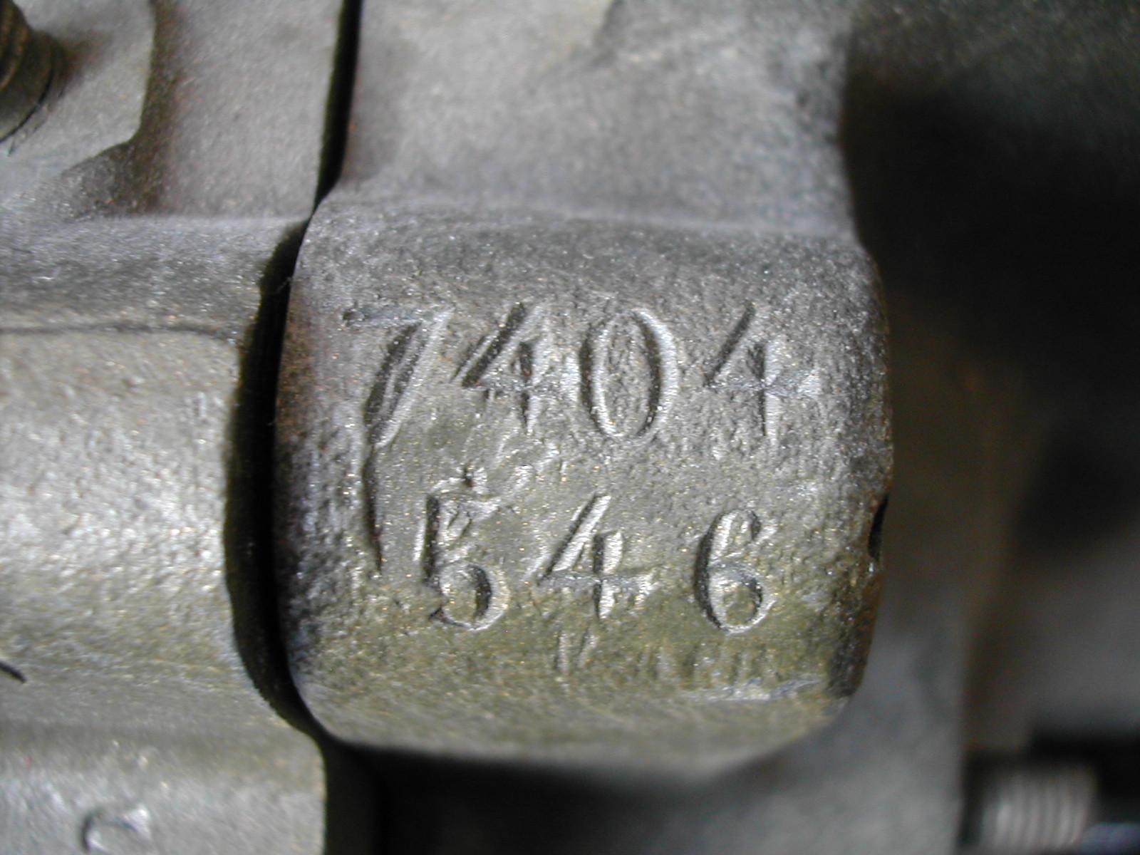

Attached is a sample for a 546 motor. Alan
Hi Alan. The only numbers that are stamped are the build numbers. My understanding from what I have heard/seen is
they were stamped on later engines starting around late '52 when the 527 was discontinued.

Most of the parts in the '55 spare parts catalog for the new 3-piece motor of late '54 have 539 as their prefix. The Type 546/2 motor used for one year only in '55 model year cars uses many of these parts. I assume this was an experimental first crack at a 3-piece case motor that eventually morphed into the 546/2?
I have a complete 546/2 motor that is unmolested, and it has many of these 539.xx.xxx parts. For instance, the cam on the motor is the 539.05.103, which is the normal VW profile camshaft for the 3-piece case.
Re engine 30064, it would be interesting to note if it was identified as a 502 motor, or if any of its predecessors were.
