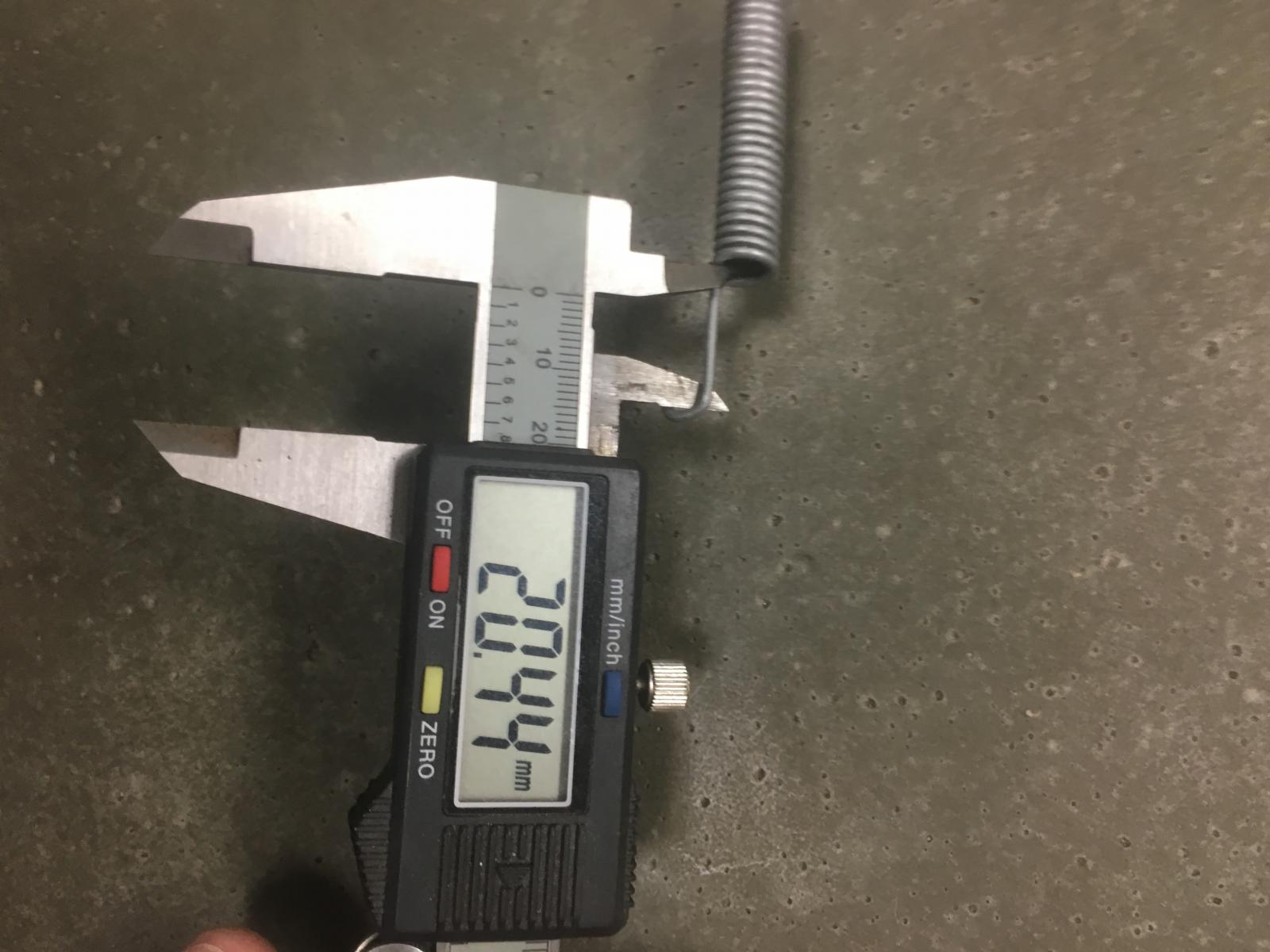

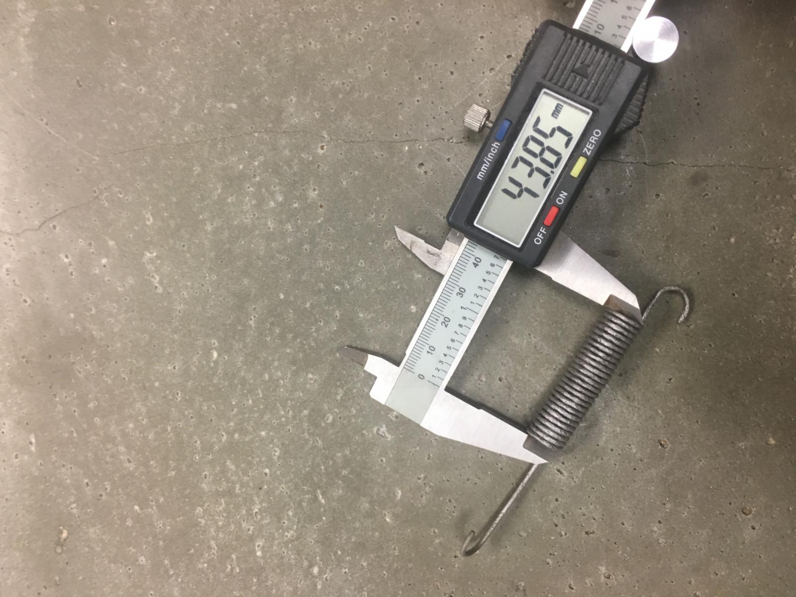

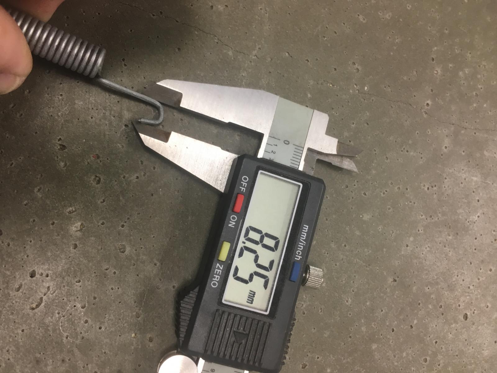

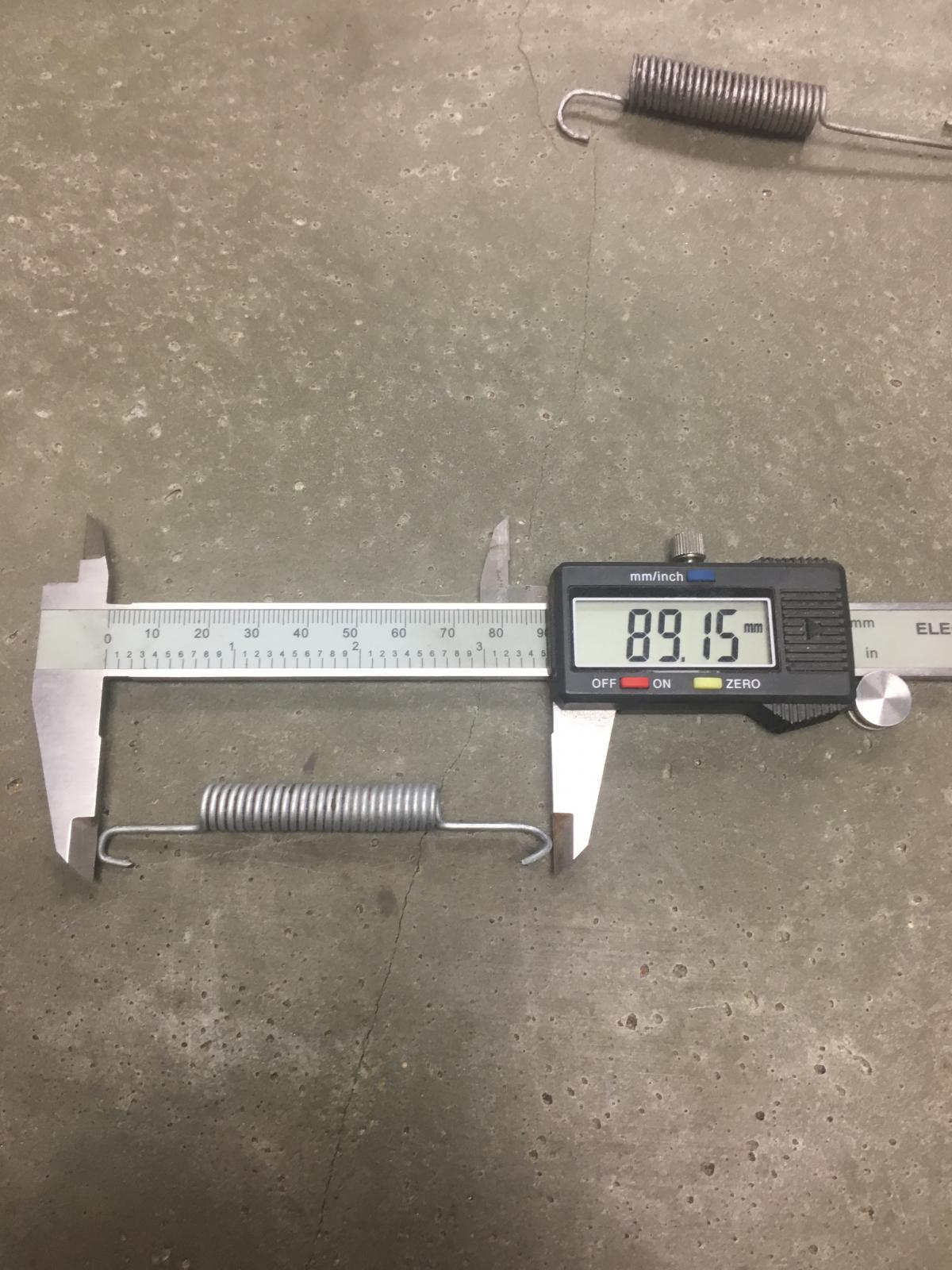

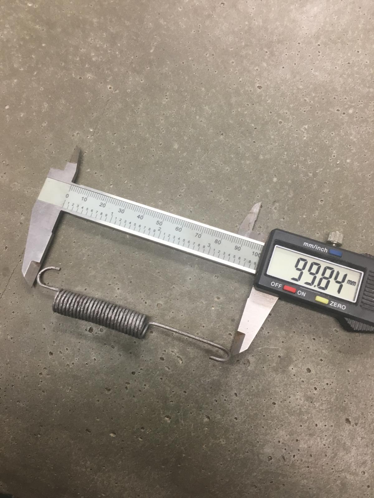

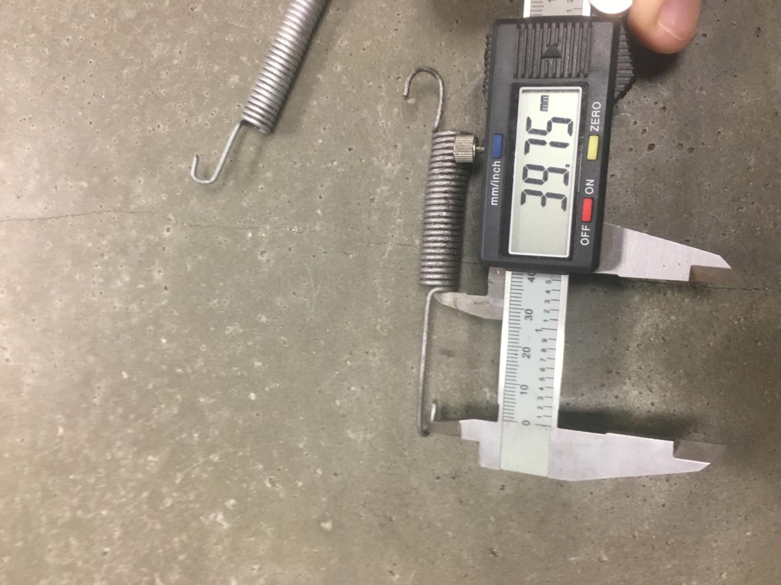

This measurement was the same for both sides
Showing clocking of bends

wow nice work man!!! no problem making RHD versions Cool

Thanks for the info on rhd springs .We are waiting for more spring wire to show up at our supplier , probably a few week delay in production.

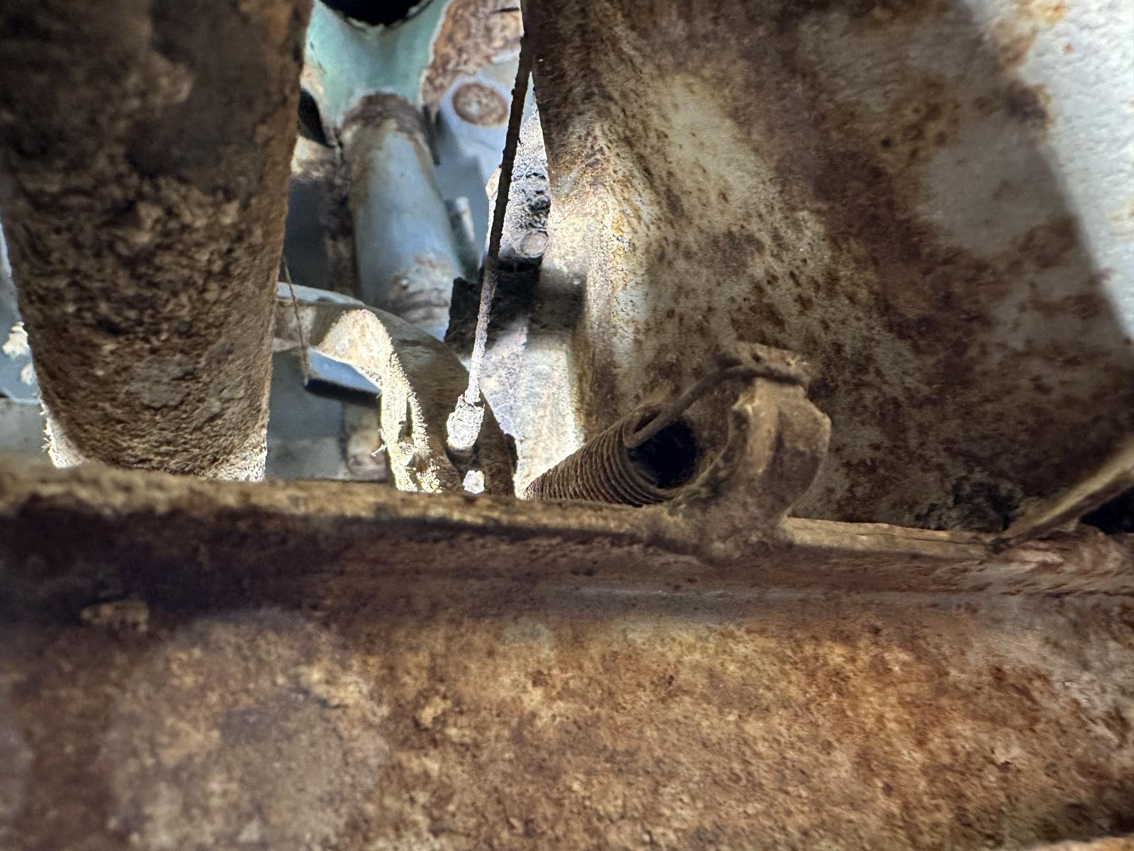

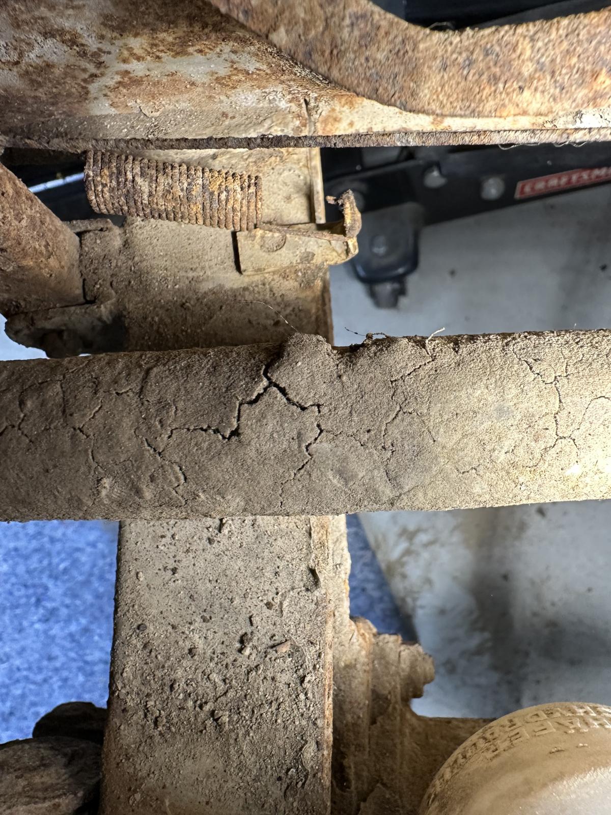

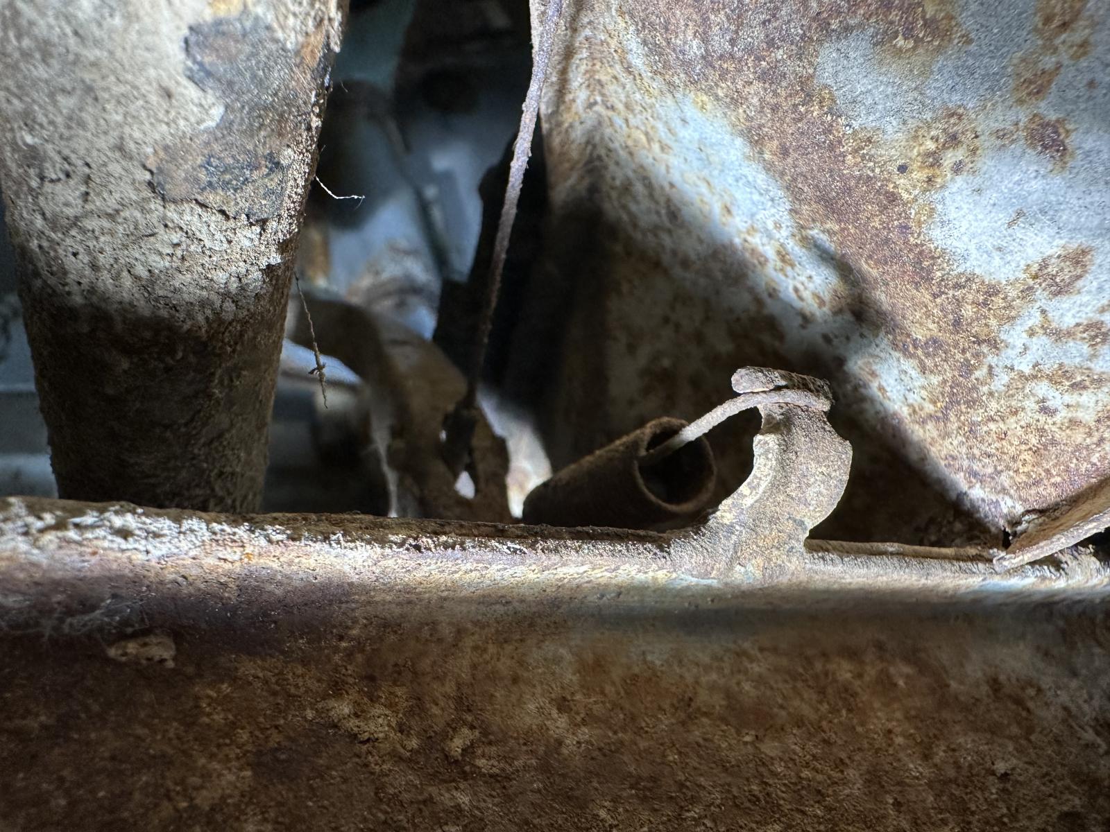

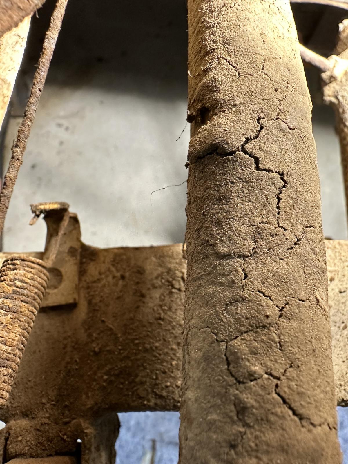

Anyone have a good photo of the brake pedal spring bracket? (Edit: make that accelerator pedal) I assumed the one on my 54 was just a 90 bend. After looking closer to what I thought was just rust damage I think there was a gusset pressed into it. Also was the weld at the edge normal or was this a repair?

Looks to me like you have it correct. Here are some photos of mine. They are also in the gallery if that view is larger or better. I tried to shoot a couple angles and in different lighting. Hope that helps.

Perfect.
Thanks!
