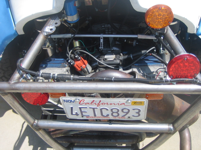

PostPosted: Mon Oct 21, 2013 11:46 pm    Post subject: Reply with quote
This is single seater Bunderson race car with a Fat Performance 3.0L Type IV engine in upright configuration with Porsche heads and Porsche 911 cooling fan shroud, a real fast torque monster!!

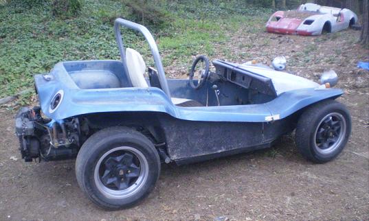

PostPosted: Thu Nov 07, 2013 7:20 pm    Post subject: Reply with quote

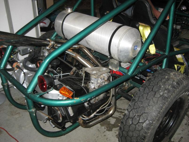

This is when I first put the Manxter together.
Engine is a type IV 2056CC with a German Auto/ SACO upright fan housing, FourTuned exhaust system using shorten type IV heater pipes.
Yes the Fan housing setup is not the best(big differences in head temp on each side).
I had this engine since 1976 in several different buggies and a Baja Bug.
Now buggy has a Subaru 2.5L non turbo. Big different in power.
Type IV engines have never been cheap to build.
Joseph

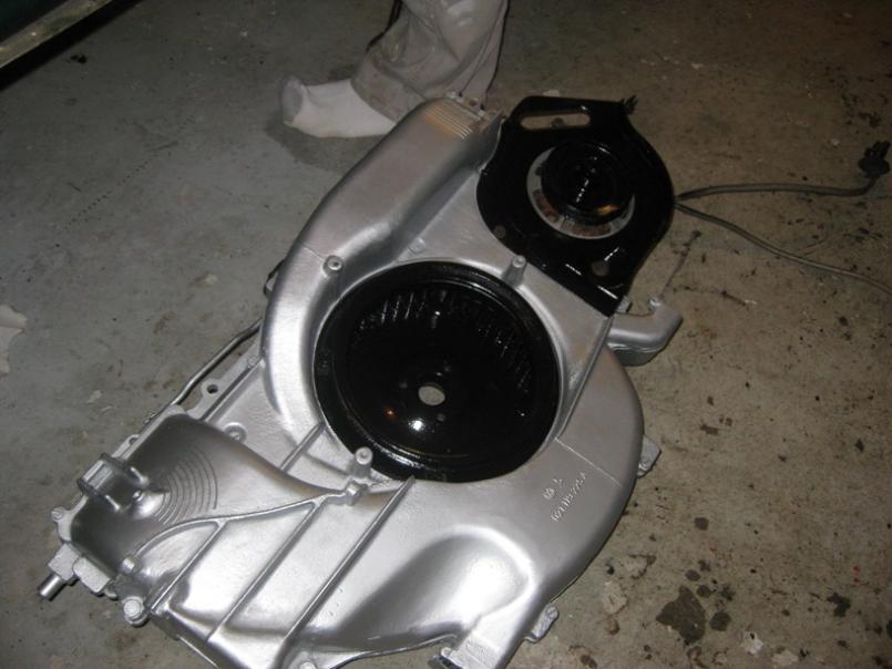

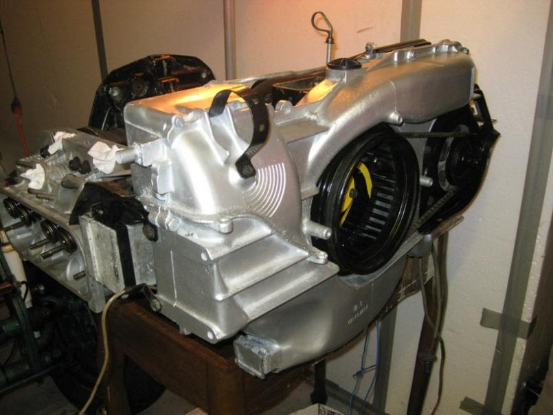

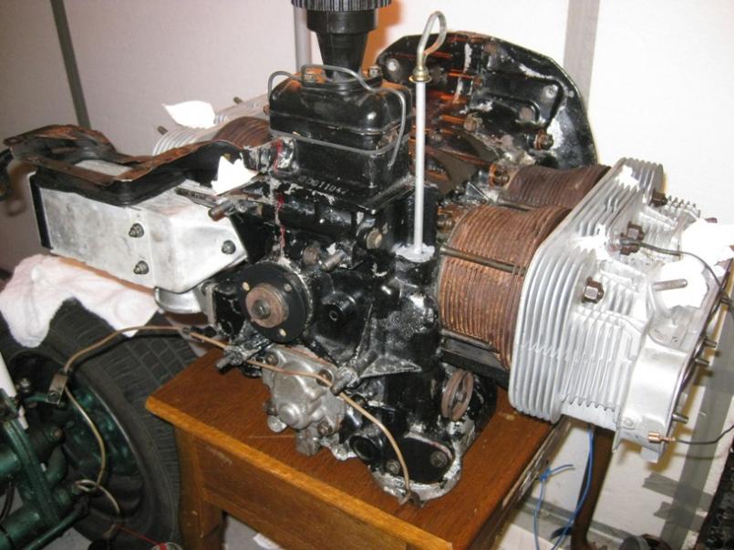

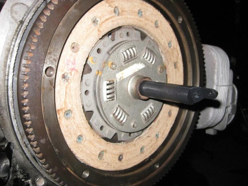

PostPosted: Sun Dec 08, 2013 5:42 pm    Post subject: Reply with quote
Some cool pictures from a guys build on the 914 world forums...
I love how beefy the stock type 4 rods are.
Stock type 4 valves are similar in size to large aftermarket type 1 valves.
Stock 215mm clutch can take a lot of abuse and will fit into any 12 volt bell housing...
European Motorworks exhaust for stock cooling shrouds.
And a short video showcasing the European Motorworks stinger with a baffle installed.
