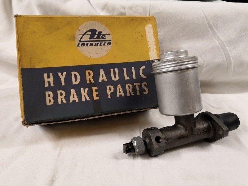

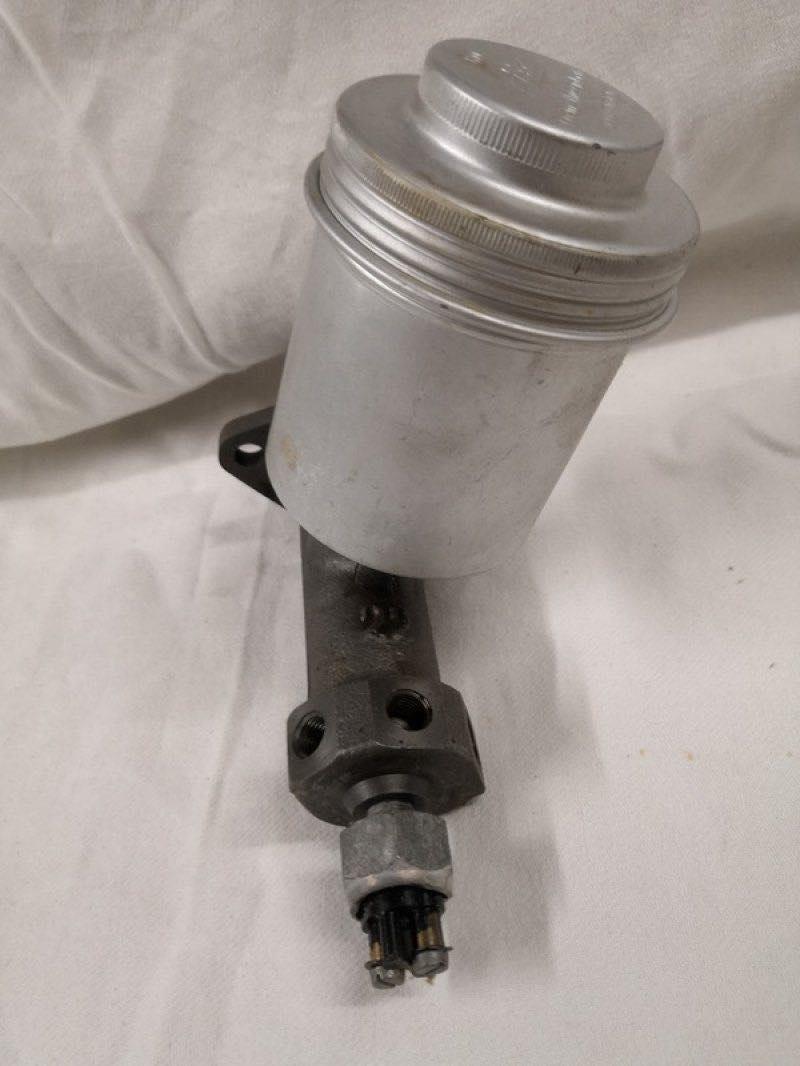

My NOS one for reference

That NOS master cyl. must be one of the ultimate BD/WB collectibles ! It should be displayed at a museum !!! It is just so strikingly beautiful ( along with the design of the original ATE boxing) Exclamation Embarassed

100% agree, stunning, get that into a display case Cool

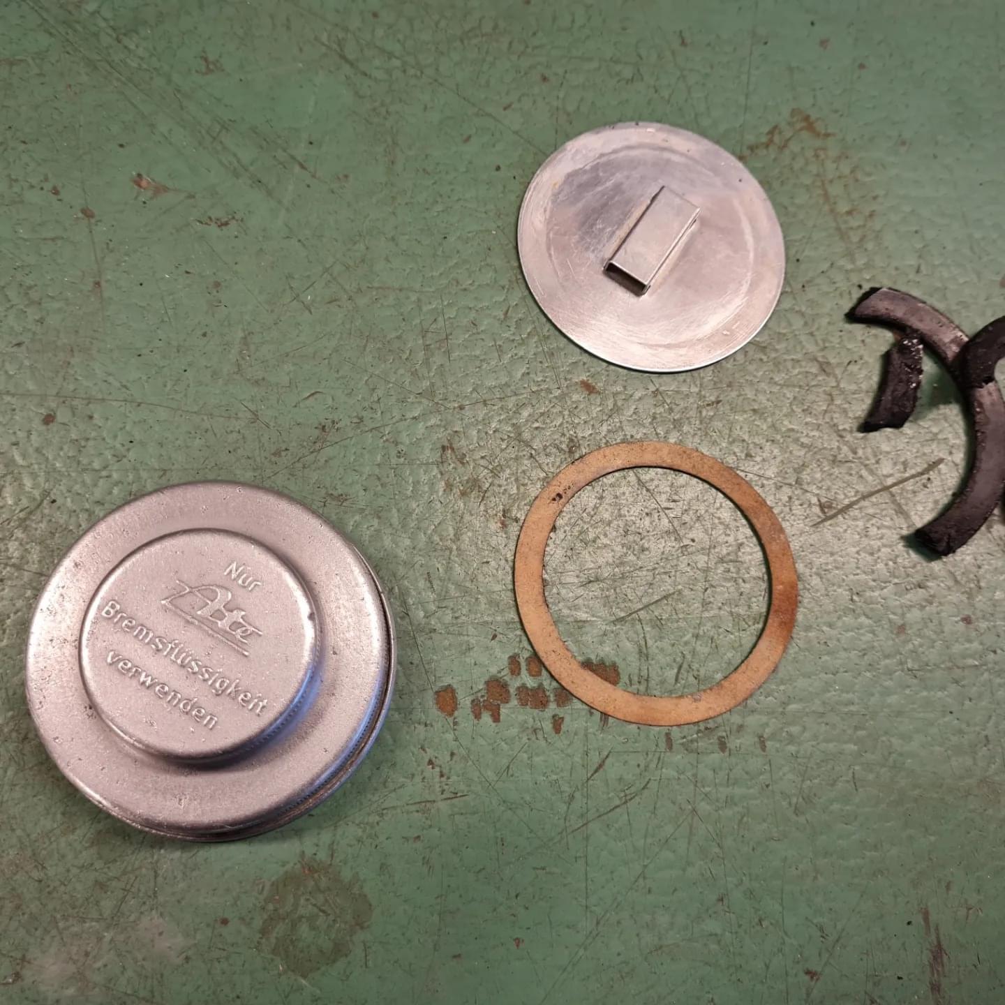

Maybe this is gasket 25…card
Part number 611 377
(Remains of rubber gasket 24 on the right?)
-StockRocks-
djfordmanjack
Joined: June 15, 2009
Posts: 2374
djfordmanjack is offline
PostPosted: Tue Feb 13, 2024 2:35 am    Post subject: Re: Barndoor brake Reservoir ? Reply with quote
that absolutely makes sense now. the cardboard will go between the cap and breather shield. When the shield and rubber sticks to the reservoir, the cap can still be undone.
From the looks of the crumbled pieces, it rather looks like rubberized cork than pure rubber, maybe. Both gaskets could be easily cut from Klingerit and rubber (cork) sheets.

But the diagram doesn’t show it in that order?
Cover c/w splash guard 23
then
Rubber gasket 24
then
Card gasket 25
The splash guard (breather shield) doesn’t want to separate from my cap.
I also have a couple of caps with no splash guards. Makes me wonder if some came without splash guards.

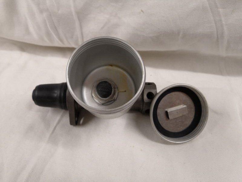

Maybe the card gasket was simply replace with the rubber seal ?
I checked Mercedes parts catalogs for similar year, and although it has a different reservoir, it has a similar illustration and say that one is replacement for the other. parts 31 and 31a
https://www.niemoeller.de/de/ponton/w120-mercedes-180/B010/422601
edit, found these pics in my files (originally from TS ad). obviously an NOS cap kit. does not have the card gasket and shield separates from cap.
