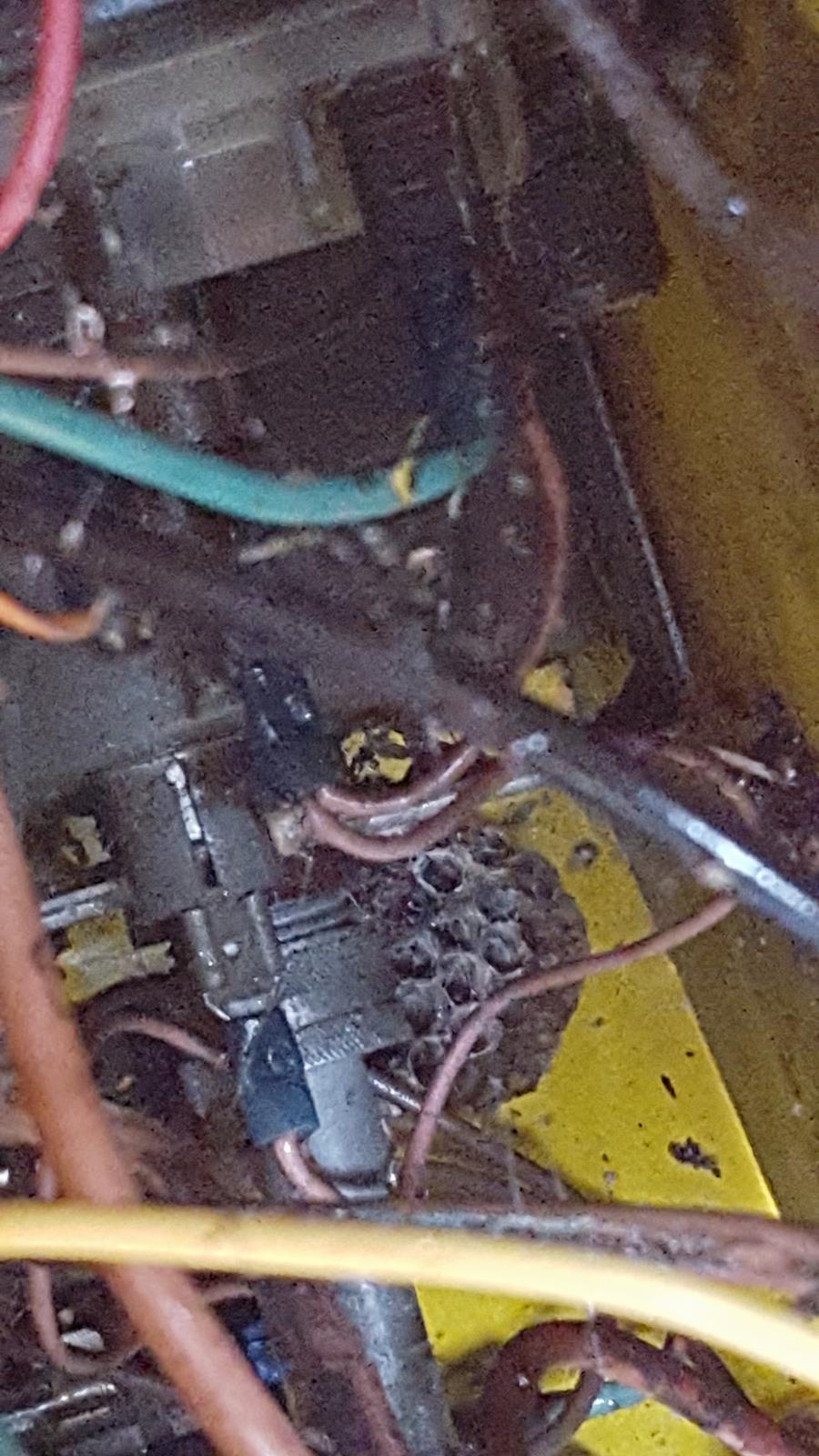

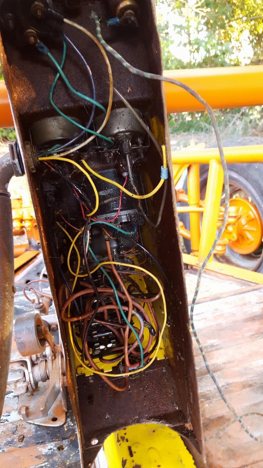

I opened up the center console (didn't know it did that!), and found a fuse block, and a mess of wires. Also, some thankfully vacant wasp nests.

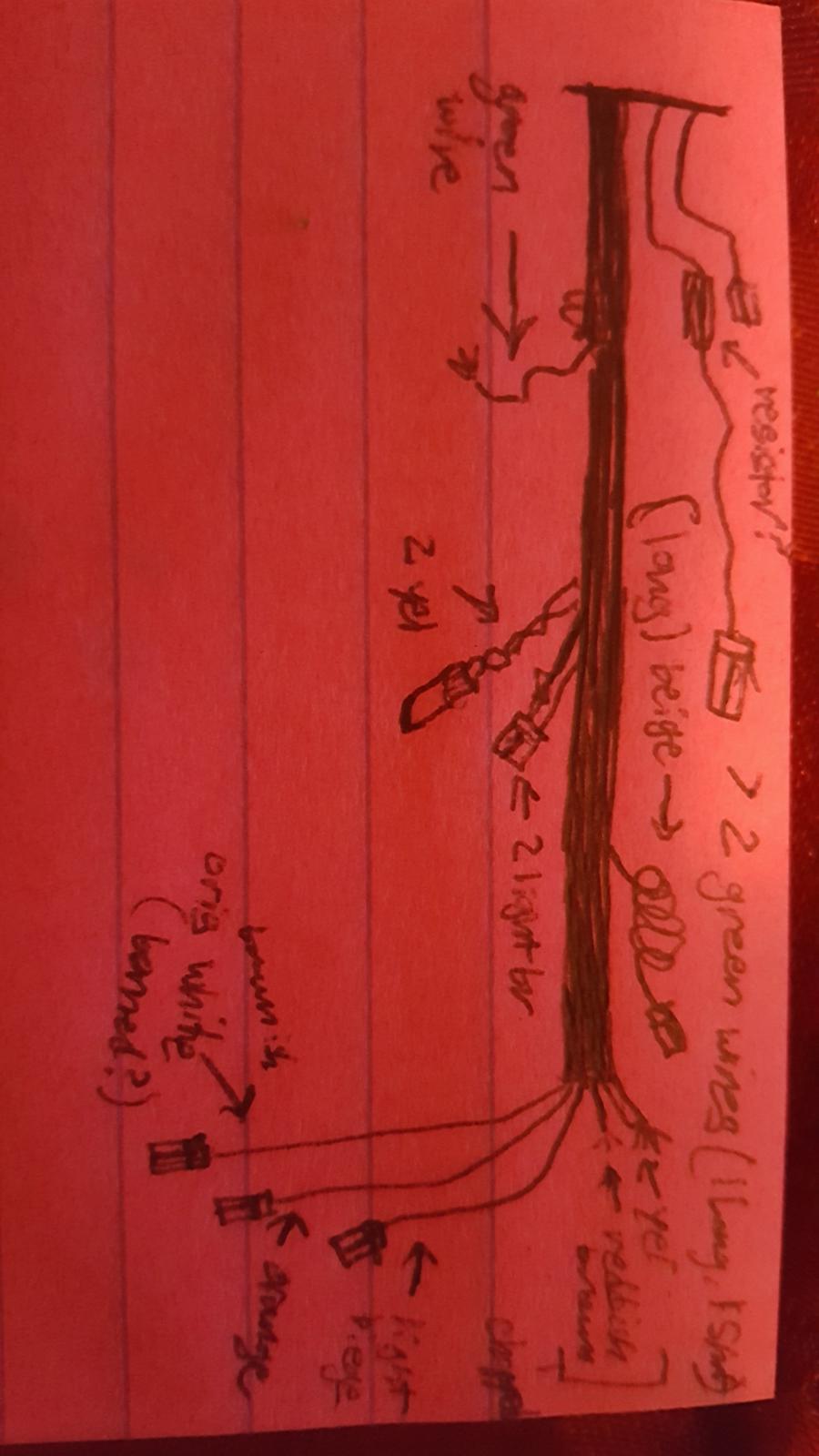

I laid out the wiring from the console, and made a little diagram:
The console has an ignition switch (3-pos?), power point/cigarette-lighter, three switches, a tach, a speedometer, an oil pressure guage, and an amp meter.

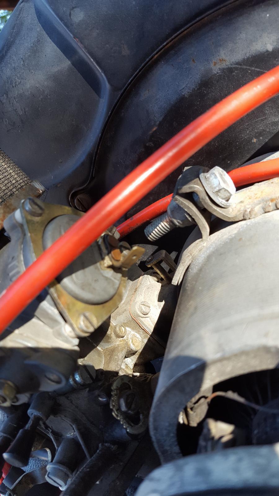

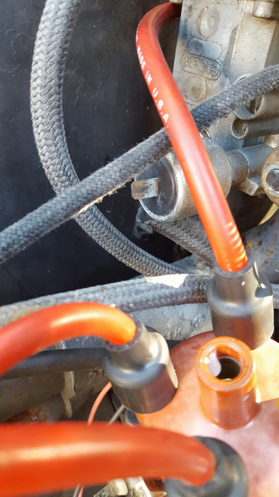

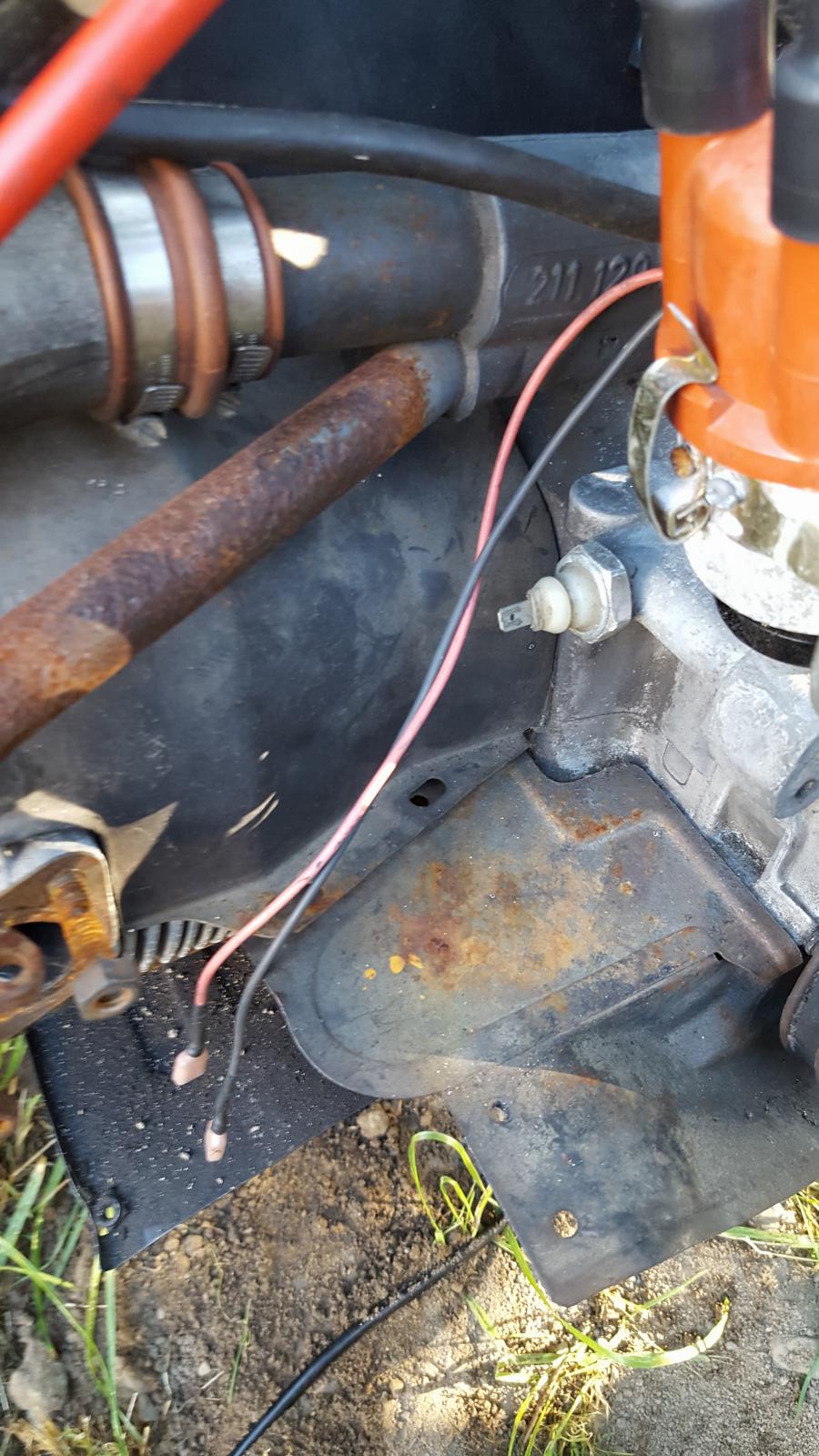

I'm trying to trace the wires to their sources, using some diagrams that I've found here, but this is my first experience with 12V wiring.
So far, I have three connections on the engine, the fuel pump connector, the hookups on the coil, and for the starter.
I guess I'm just thinking about how much of the new wiring harness I'll need. There seems to be a fair amount already here- but it needs some patching and reconnecting. I'd like to hook up enough so that it will run, and then begin to clean it up.
I'll have more specific questions once I've started to identify the different leads, but any tips or advice is appreciated as always! Thanks!

Couple of questions, How is the wiring run front to back? Are there holes drilled in the frame tubes and the wiring run through the frame? Or is there a channel for all the wires to run in? Personally I have never been a fan of running the wires through the frame. Even if there are grommets, they can still wear and you don't know what is happening inside the tubing. I prefer to run my wires inside of a clear rubber tube, then attach the tube to the frame. In your case, I would strongly suggest that you wire from scratch.
What I see is that you do not have a matching set of sending units to gauges. For example, you have an oil pressure gauge, but the sending unit is for an idiot light, but I don't see an idiot light on the instrument panel. I would start with the basics. From the key, run a hot wire back to the coil. Then from the same terminal on the coil, run a wire with an inline fuse to the cutoff solenoid and choke on the carb. Then mount a LARGE idiot light in the gauge panel, and run a wire from the oil sending unit to the idiot light. The sending unit is a ground.
This can get you running. IMHO, for off road, a tach and oil pressure gauge are secondary. Idiot lights are far more important. When you are screaming up a hill, or dodging a tree, you don't have time to look at the gauges, but a big bright light will warn you of trouble.

Multi69s- The wiring from front to back mostly goes through that rubber tube in the pictures. There are two other wires (one is chopped, though), that come directly out of the console, not sure why. Maybe they are supposed to hook up to the fuse block? Anyway, there appears to be a hole punched in the tunnel for the other end of the tube, so that it will run through it. I agree with you on how the wiring should be as accessible as possible, so I'll route it differently. I can see how the sending units have different connections, as this is a new motor- Thanks, I didn't realize that!
As for my "idiot lights", can they just be LEDs?
In your basic running diagram, would the battery connect to the fuse block, or the generator be connected to anything? Thanks for all of your help!

For the idiot light, I use the biggest brightest ones I can fit. So if the LEDs will be bright enough in bright day light, you can use them.
As far as the generator and power connections. The generator output (8 gauge) and field windings (14 gauge) will go to the voltage regulator. Then the output of the voltage regulator goes to the battery (8 gauge). From the battery run a heavy (10 or 8 gauge) wire to the fuse block. However the ignition and starter are not generally fused, so from the connection point, run 12 gauge wire to the ignition switch. Then from the switch run a wire back to the coil (12 gauge). Then from the same terminal block on the coil run a wire with an inline fuse to the carb cutoff solenoid and the choke.
I hope that is more clear then mud

14 ga is plenty for the ignition switch to coil.
Since power to the oil pressure sending unit comes through the idiot light, it is best left as an incandescent light to handle the down steam current need. VW used a wire that is somewhere between a 16 and an 18 for that though.
But for the generator light (or alternator), the light bulb nearly HAS to be incandescent. The circuit depends on the resistance of the bulb to function. One CAN put a resistor in parallel with the led for it to work. But you need to know the value of the resistor and how to wire it in. I expect you can learn how to do this, but I recommend that you keep it simple and EZ.

I appreciate the advice guys, but I'm a little confused on what to do with what I have. I'm using a wiring harness from Moore Parts, and the diagram includes a lot of stuff that I don't have yet. Here it is:
I have no lights, switches or anything besides the speedo and the two idiot lights I have to wire. In the diagram, the speedometer has 6 connections! As far as I can tell, my speedo has two (running from the same wire- backlighting?), and the cable.
For this reason, I'm confused as to how the fuse block is involved at all. Besides the hot wire from the battery, I don't know what other wires would need to connect to the fuse block.
I don't have either 16ga black wire running off of the ignition switch to the fuse block or speedo. I also ran the green oil switch wire directly to the ign switch.
Will this setup work? It looks kinda like what was previously installed. I'm surprised that the coil only needs one 16ga wire to power everything.
Also, grounds! I have the battery cable to chassis ground, but I don't have any idea what else needs to be grounded. The only grounds I see are for the headlights, of which I have none.
My idiot lights are for a 12V setup, and they have two black wires each. Hot and ground? Power in/out?
I know this is a lot of info, but I'm struggling with the wiring, and it's slowing my progress! I do have Dale M's dune buggy wiring diagram, but it's a little too simple, and the Moore Parts one has more than I need.
Any help is appreciated! Thanks guys!

PostPosted: Mon Jul 11, 2016 5:46 am    Post subject: Re: Sand Rail Resurrection Project Reply with quote
Don't let the entire diagram scare you. 1 thing at a time. K I S S. I put a large 60a fuse between my alt and the fuse box, then pulled everything off the fuse box with appropriately sized fuses for the load I was drawing. Neatness counts, you may be the next guy to work on it. Lay everything out you plan on using, then run a extra wire or two. You may want to add something later. Don't forget the tetanus shot first Laughing
