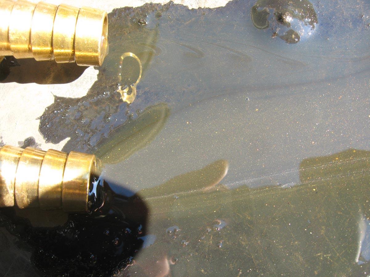

Yeah, I understand. I kind of like the Idea of that filter catching anything loose in the engine during first Run Cam Break-in.
This is what came out of the filter after First Start on my Bus Engine.

PostPosted: Sun Apr 03, 2016 3:40 pm    Post subject: Re: Building a Stock ish Type 1 engine for the 1971 VW Bus? Reply with quote
No doubt. The run I did was not a break in. Just saying that a cooler and filter aren't needed unless you do a long run. Keeping that in mind though... you could always do the break in run and then put a few hundred miles on and then change the oil filter. The screen will catch anything big.
