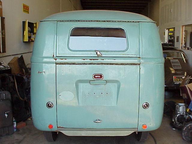

I noticed on Mark Merz bus, the optional hatch looks to have a stamping around the edge. Look closely. UZI is this hatch like yours?
mine is smooth

all the rear hatches i have seen dont have that press round the edge, you could also get the rear hatches without a window, mabye that is one of thouse that has had the window pannel added. Confused
