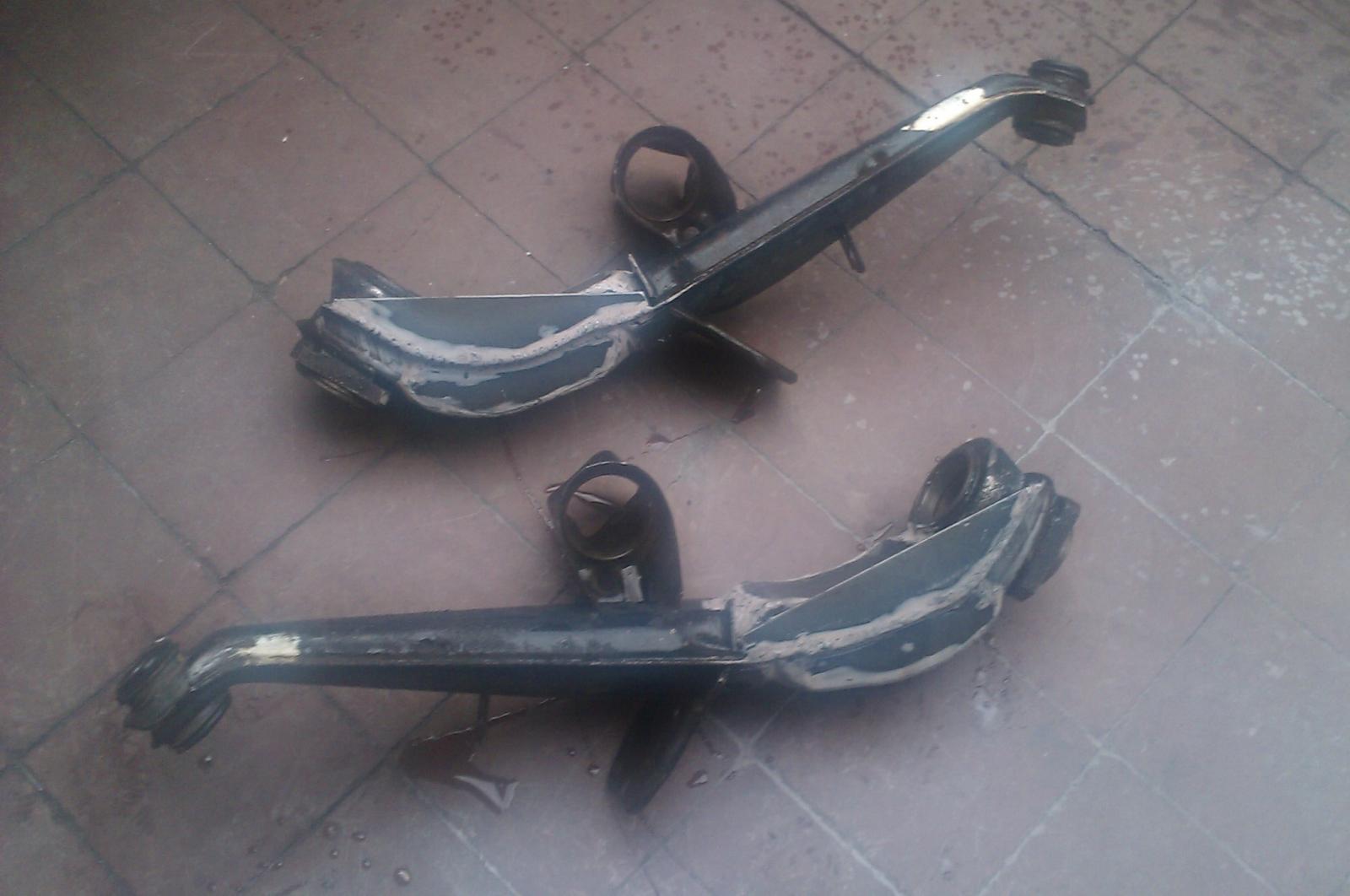

Extended stock IRS trailing arms to 3x3, 3mm flat metal plate. In the pictures pre MIG welded final work.

PostPosted: Fri Jun 24, 2016 5:12 pm    Post subject: Re: stock IRS trailing arms longer work advice? Reply with quote
Pablovent,
The arms look great Very Happy and you sure work fast. Also, any luck with your 010 trans?

PostPosted: Mon Jun 27, 2016 3:03 pm    Post subject: Re: stock IRS trailing arms longer work advice? Reply with quote
Yes your trailing arms looks great. Baja looking good too.
I would recommend adding some kind of material (round tubing my prefer) from the inner pivot point to the far end if the trailing arm to keep it from bending.

PostPosted: Wed Jun 29, 2016 5:56 pm    Post subject: Re: stock IRS trailing arms longer work advice? Reply with quote
Unless he was going to beat the snot out of it, his bracing looks pretty good. The arms that I have seen bend, usually twist in the area of the bearing carrier.
However, since he has plated that area, I don't think it will bend there.

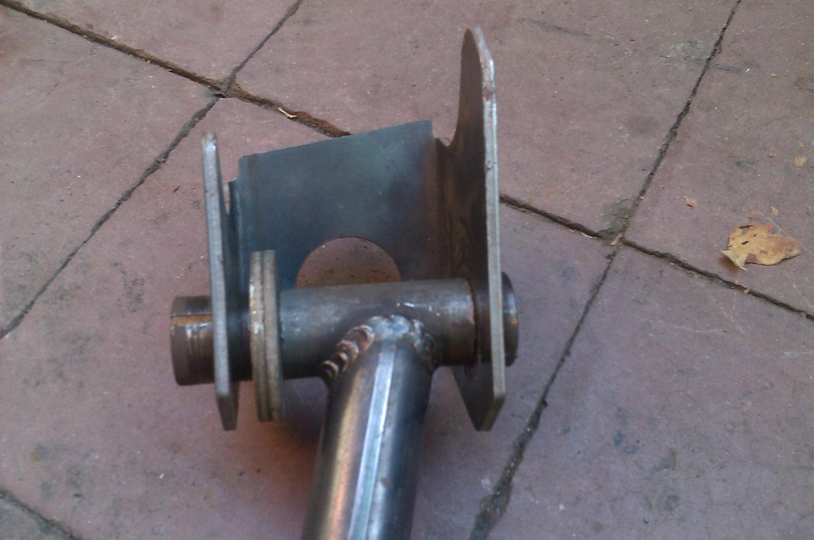

Where can I get a fixture like the one pictured?
Tim
Multi69s
Joined: January 24, 2006
Posts: 5560
Location: Lefty, CA
Multi69s is offline
PostPosted: Thu Jun 30, 2016 9:51 am    Post subject: Re: stock IRS trailing arms longer work advice? Reply with quote
You have to make them. I have one and don't plan on building any more arms. PM me if interested.

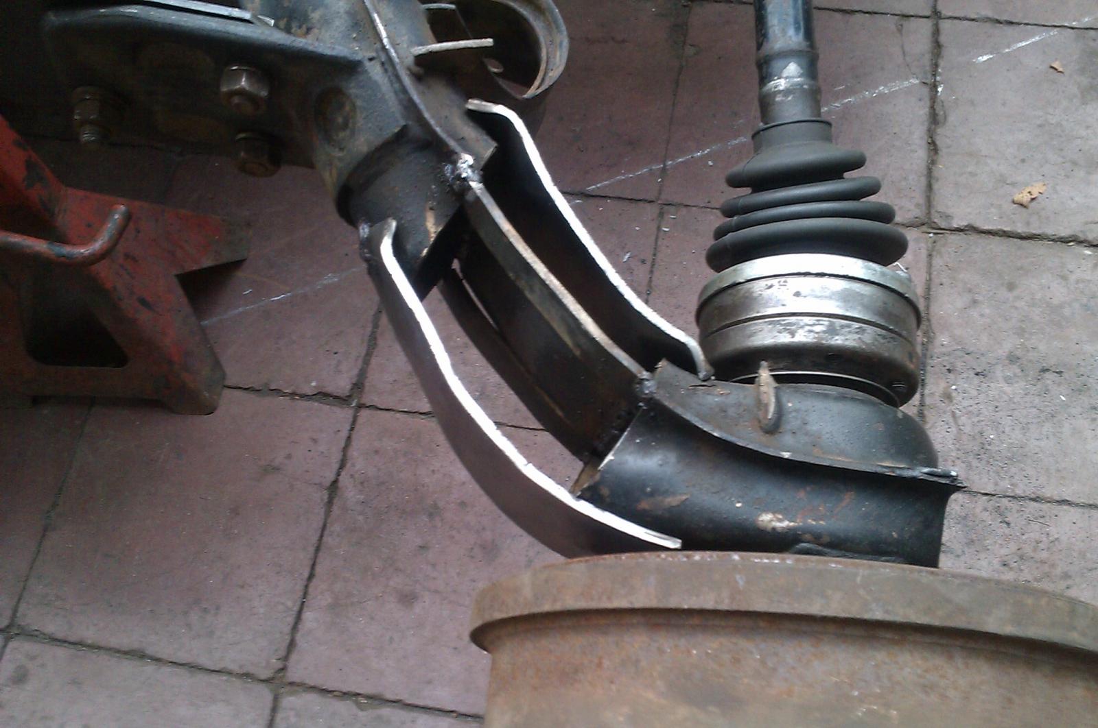

After seeing many trailing arms bent from stock bugs to race cars, I going say it again, the arms need more strengthening to hold up to being extended. Even stock arms need reinforcement when used off road. Since I started playing with buggies in the 1970 I seen all kinds of things happen to trailing arms that were not reinforce. I even seen on one race car where the piece that is welded to the trailing arm where the spring plate attaches completely rip off the arm.
This is what I did when I lengthen a set of arms 2in
For stock trailing arms this how I reinforce them. Hi Jumper/Prowlers use to sell kits to do this. Mine are a copy of them.
Joseph

PostPosted: Thu Jun 30, 2016 5:37 pm    Post subject: Re: stock IRS trailing arms longer work advice? Reply with quote
I agree very strongly with Joe. Pablo's arms may look nice, but the gusset ending at the spring plate bracket concentrates bending force right there. Even street use is likely to bend those arms.
Yo pienso fuertamente con Jose. El tiene razon. Los brazos de Pablo pueden tener un aspecto agradable, pero las cartelas que terminan en el soporte de placa de muelle concentran fuerza de flexion alli mismo. Incluso el uso de la calle es probable que se doblen los brazos.
The tubular reinforcement as Joe shows is just what I had in mind. The arms may still be reinforced just like Joe's.
El refuerzo tubular como se muestra Jose es justo lo que tenia en mente. Los brazos todavia se pueden reforzar al igual que los brazos de Jose.

PostPosted: Fri Jul 01, 2016 6:41 am    Post subject: Re: stock IRS trailing arms longer work advice? Reply with quote
Another to agree with the need for additional braces
Mine broke right past where his reinforcement is
