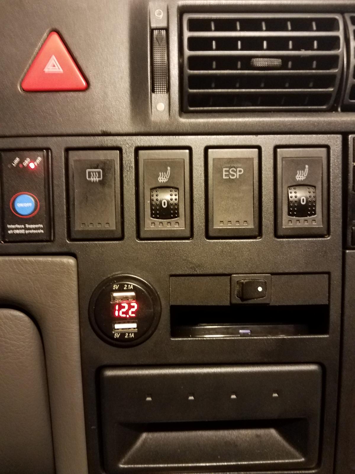

I posted this elsewhere, but couldn't remember the thread.
The trans temp reading on our vans via Torque seems to require a delay in connection or something. Almost without fail, Torque will give me pretty much everything but trans temp at startup. Then, if I turn the bluetooth thingy off and back on to make it re-connect, trans temp comes right up.
I know others have had this issue and installed OBDII cables with an inline switch so they don't have to unplug and replug the adapter all the time. I found an adapter that has a power button on the face. You see it in the top-left slot on the pic. Also makes it so you can turn off the adapter since the OBD port is always hot.

mkscott2, I have exactly the same issue you describe in order to get my trans temp to display in Torque. But, I have to unplug/plug my scanner. So, I'm very interested in upgrading mine to one similar to yours. Does your OBDII scanner auto start when you turn on the ignition? I've seen other scanners on amazon that have a power button, but it seems it's main function is to turn it on after it has auto shut off. I'm assuming it can also cycle on/off the scanner in order to get trans temp working.
Where did you get yours? And did you custom fit it into the dash?

Bigfoot- answers to your questions:
1. the adapter does not auto-start, I have to push the on/off button on the dongle to get it to start reading
2. purchased off of Amazon. Of course the link I posted previously does not work, and I can't find the exact same one on the site.
3. Yes, but only had to modify the dongle slightly. Just trimmed a little plastic off the top and bottom, then hot-glued it in place from the back.
