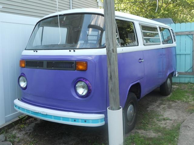

PostPosted: Fri Jun 02, 2017 11:51 am    Post subject: Re: DIY Painting Reply with quote
DIY Painting update:
Well, I took the plunge and tackled the project with roller in hand. Maggie is happily back to wearing her original 1972 Texas Yellow.
If any one is thinking of doing the same, I'm happy to share a little bit of what I learned. First of all, you have to manage the expectations: you are NOT likely to get a "showcar" quality job with a roll-on DIY project (but, does anyone really expect that?). That said, if you're into driving and enjoying a fun, slightly quirky, hippie camper - you can certainly get satisfactory results. Don't let any of the elitist tell you it can't be done.
If you're going to go to the trouble of DIY roller painting, DON'T go the rustoleum route. It might look good at first, but the paint properties are not such that it will stand-up to UV exposure without chalking.
I learned was that what you need is a Urethane Modified Alkyd paint. Rustoleum makes a product called "Combicolor", but it is apparently only available in the UK. Sherwin-Williams makes a U.M.A. paint as well, called "SherKem". Their guy told me that it is very popular with farmers and municipalities for painting their equipment. What I settled on was a Benjamin-Moore product "Super Spec NP", but the main reason for that was that my brother could get me a discount from the hardware store he works at.
They did a nice job of matching and tinting the color from a sample of the original paint I brought into the store.
The entire project cost me about $100! ! (And I've also got a gallon of white, for wheels, bumpers and pop-top!!)
Apply with a small dense foam roller and use a brush where necessary. The paint dries to a very nice hard shell automotive gloss. It has some good self-leveling characteristics that eliminate all but the deepest of brush strokes and roller marks. Be forewarned however, that the flip side of that is that it dries very slowly. I mean VERY slowly! I found it still somewhat tacky in places after 72 hours!
The biggest challenge I had was insects landing in the freshly painted surface. You are going to want a pair of tweezers in your pocket while you are painting to remove them. One's that are stuck deeply in the finish: avoid the urge to dig them out, and just wait til dry and lightly sand.
Both Sherwin-Williams and Benjamin Moore only sell this by the gallon. (I think the Rustoleum Combi-Color is available in smaller cans.) I thought a gallon might be way more than I needed, but you are going to want all of that.
Here's a pic, while still in progress.
Good Luck!

PostPosted: Fri Jun 02, 2017 12:07 pm    Post subject: Re: DIY Painting Reply with quote
You should post before & after pics. I'm sure it looks better than it did & you're keeping it from rusting away.

PostPosted: Fri Jun 02, 2017 12:24 pm    Post subject: Re: DIY Painting Reply with quote
The before pic is basically my avatar . . .
I'll put up another when she's complete and buttoned up.
Oh . . . I almost forgot to mention another side benefit of the roller approach -
Those 2 little strips of painters tape you see in this "before" photo? That's the entirety of the masking that I did! (But, I was blessed with a fairly steady hand.)

PostPosted: Thu Jun 22, 2017 5:12 pm    Post subject: Re: DIY Painting Reply with quote
Just to close the loop here is a photo of my <$100 DIY paint job with Urethane modified alkyd. I started buffing and waxing the finish up a little at a time. It Seems quite durable. I'm quite happy with the results.
