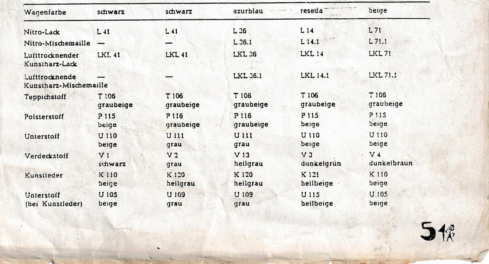

So it's been three years since I last visited this subject.. and I was pretty frustrated then. There was a lot of conflicting info out there on what would be the correct color for the seat frames, steering tube, and steering wheel (for an Azure blue zwitter)
I am fairly certain now that the correct color is L278 grey beige, but details of that color are lost. I have been getting closer with a match, and am close to spraying the seat frames.
But then this morning I got this page from Nico Kennis
Can anyone help with translations? I'm thinking it may help with some of the details..
Thanks

PostPosted: Sun Jul 06, 2025 5:50 am    Post subject: Re: Correct interior colors for Azure Blue car Reply with quote
nothing there relating to seat frame colours
the first four in the left column are relating to the exterior paint and the various types nitro cellulose through to air drying synthetic resin. then the rest are relating to interior materials:-
teppichstoff = carpet
polsterstoff = upholstery material
unterstoff = lining material
verdeckstoff = sunroof/cabrio roof material
kunstleder = vinyl upholstery
unterstoff bei kunstleder = vinyl lining material
esde

PostPosted: Sun Jul 06, 2025 2:24 pm    Post subject: Re: Correct interior colors for Azure Blue car Reply with quote
I did just figure this out also and was coming to update my question, thank you!
Thanks
SD
I've had great success with the following website for translating images:
https://www.imagetotext.io/photo-translate

Google Translate has an image translator too:
https://translate.google.com/
Click Images at the top of the screen there

PostPosted: Mon Jul 07, 2025 12:13 pm    Post subject: Re: Correct interior colors for Azure Blue car Reply with quote
hellbeige = heat beige Very Happy not bad, translation tools have humor
hellbeige = light beige

This latest source gives a color for the convertible top. How do we know that this particular page applies to sedans as well? I've seen convertible color combos quoted separately from those of sedans, and yes, there are some differences in an open car.
