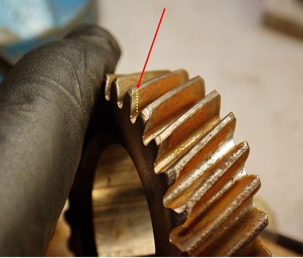

The gears:
NOTE: We already noted the swirl marks in the gears. By the way…these marks are NOT caused by debris.
These are machine marks in the original gears. Any really heavy grooves caused by debris in these end face areas almost always show a ding or chip in the edge of the gear where a piece of metal or grit was jammed between the gear face and the plate or pump body.
I measure the gears first. The driven gear in this pump was 0.0004” shorter. Not enough to worry about.
The same lapping method. Note that I marked the starting gear tooth with a Sharpy marker. These gears have 9 teeth so I used 9 axis changes and 20 strokes each (steel is harder than aluminum and takes more work)…180 strokes on each face.
Same on the 600 grit on glass
The faces are nice. I did not do the shaft side of the driven gear. There is just no way to do it right and its not a big problem.

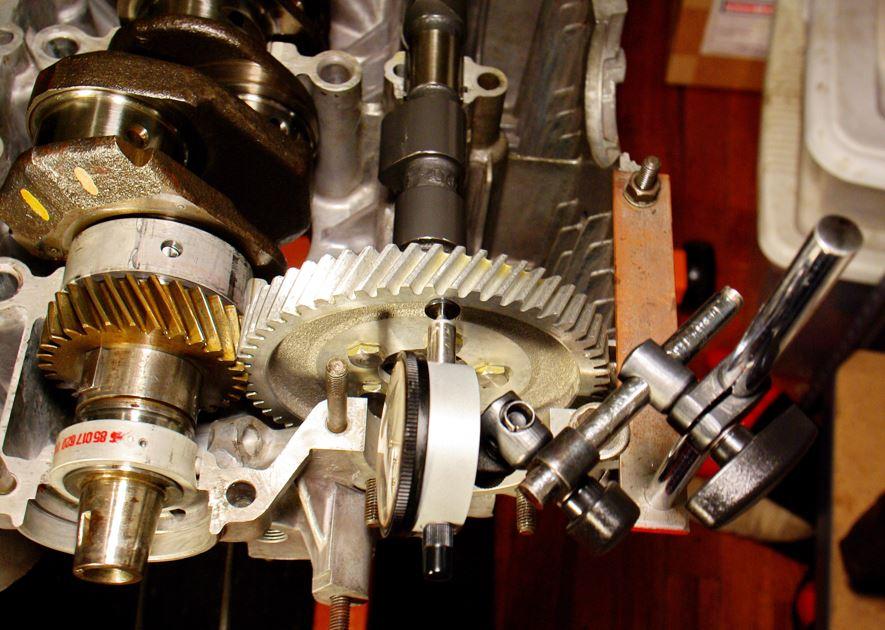

Here is the cam gear train measuring/checking:
We are checking three items:
1. Axial runout:
There is no separate axial runout for the cam gear itself…but it “should” be the same or less than the runout spec listed for the camshaft itself for the same reasons.
If the camshaft runout as measured on the center bearing of the cam or the radial play as measured at the gear flange end of the camshaft are excessive, you get excessive axial play at the gear mesh.
So….once the cam itself is measured and it passes, the gear must be checked separately to make sure its recess for the flange is machined correctly. The shaft runout is .002” max and the radial (which takes the bearing preload into account) is .00078” to .00196”…so a max axial play at the cam gear should be .002”
2. Radial runout/concentricity:
There is no spec for this one either but for all of the same reasons with camshaft axial play the maximum spec should not be above .002” to .003”. It can be slightly higher for radial play if the axial runout is also small because the radial runout is not an angular change.
3. Backlash:
The factory spec for backlash is .000” to .0002”.
The Crankshaft gears:
To start out, the owner of this engine provided me with 2 gears. One has slight damage and the other one is just fine. I am going to detail the slight damage to the gear I did not use and cleaning up the damage. This will be a great spare gear for him.
The warning here is that you should inspect and correct minor type 4 crank timing gear damage whenever you can.
Try to save these gears at all cost. Outside of rust or foreign object damage, they do not wear out….AND…they are also not made by anyone new and have not been for a while. The only NEW gears you can get are straight cut gears. Conserve parts whenever you can. There are a very few NOS available but that is not a sure thing.
The clean gear:
This has not been cleaned up yet but not the crisp edges and carefully machine chamfered edges. This is the crank side of the gear as you can tell by the large chamfer on the ID.
Note the dinged/bent teeth on the inner side. This does not appear to be from difficult removal and I will point out why in a moment. For one…virtually every tooth has some damage.
It’s hard to see from this picture but the whole backside appears to be burnished. This combination of features is what happens when something falls into the case and dings and rubs on the backside of the gear.
This gear also had a little rust from probably sitting inside an engine that got some water in it.
Here it is after cleaning up and polishing off the dinged edges. It’s actually a good serviceable gear. The yellow line in the picture below shows where the aluminum cam gear runs on it and why polishing off the dinged ears is necessary
The yellow arrow points to the polished spot. You can see a little rust pitting here but it’s not a problem unless you can read low spots during a backlash test.
You can see how well the rest of the gear cleaned up. This was done with oxalic acid.

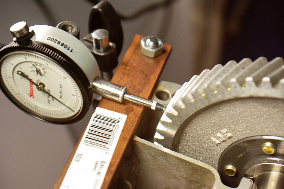

Axial gear play measuring:
The dial indicator is set up on the smooth edge of the face away from the gear teeth and 0’d.
When turning the crank to measure this…just like shaft runout…you need to put pressure on the center bearing of the camshaft…maybe 5-7 pounds to keep any of the minor amount of shaft runout you might have from spoiling the reading.
NOTE: I also measured runout of the gear while the case was together and the bearing crush was clamping the camshaft. I am doing this just to confirm both measurements.
The radial runout was .0022”. This is .0002” more than you want…but after deburring the gear edge with a green scotch brite I got that down to .0018”….and this also takes into account the small amount of shaft runout I got when measuring the camshaft itself.
This gear is quite straight axially.
Cam gear radial runout/concentricity:
This is the set up for measuring concentricity. It’s a pain in the ass. I got better readings after doing this two times by using my wide polished probe point like I use for backlash.
The gist is that you need to start checking….and get the probe point on the same spot on each gear tooth in the first place….and find the lowest or highest tooth.
Then mark it and check all of them or at least every other one, all the way around. After writing them down and comparing you can see if it’s out of round.
Tedious. I found it was right at .0017”. Pretty damn good considering there is also some suspect probe placement. It took three repeats to make sure I was getting it right.
Gear backlash:
The gear backlash was .0015”…which is pretty damn good for a -3 gear. This makes me happy because I have been worried about the fact that the cam houses…and everyone are only selling -3 gears.
They must know something.

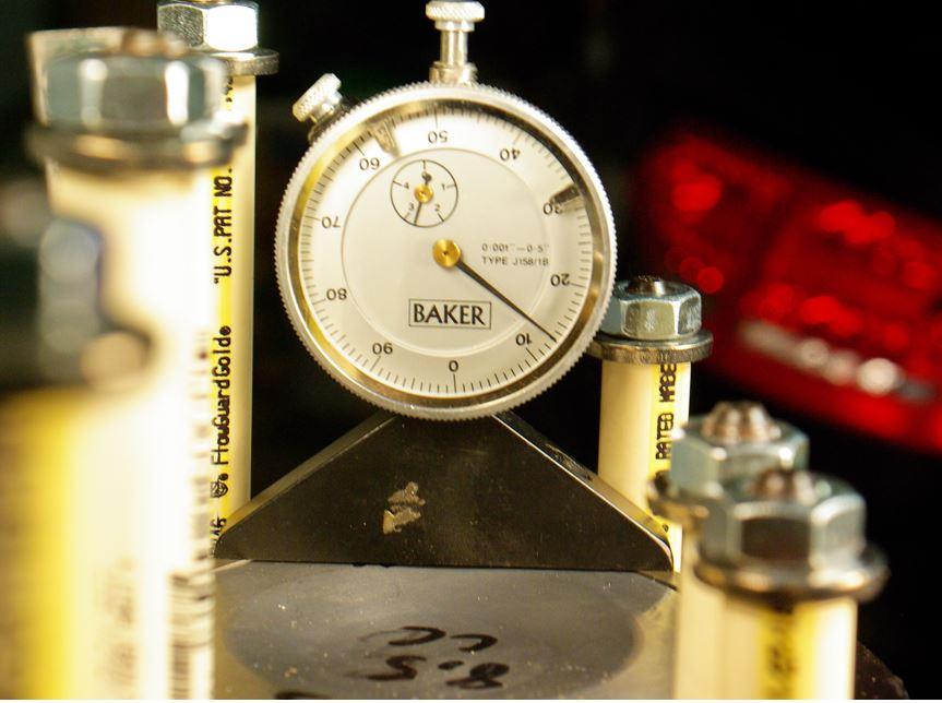

BUT....you really MUST use a rod bolt stretch gauge to install them properly.
The gist is that you apply a specific lubricant that comes with the bolts, measure their starting length, torque them specifically and then measure the length and re-torque until they stretch a specific amount.
In the past when I have installed these...I have used both a 1/10,000" micrometer...which works but is very tedious and triples the amount of time this takes to actually get accurate readings...or I have borrowed a bolt stretch gauge.
The basic gauges are not that expensive. They run from about $50 to $70 at Summit and Jegs....or to about $250 for a gauge from ARP.
https://www.summitracing.com/parts/sum-900015?seid...G0EALw_wcB
https://www.summitracing.com/parts/arp-100-9941?se...tjEALw_wcB
Those costs are directly reflecting the cost and quality of the dial indicator. The Summit and Jegs basic gauges use a 0.001" dial gauge...probably Chinese...but good enough. And the ARP gauge uses a 0.0005" gauge...better for serious work.
If you look closely at the Summit branded gauge and the ARP gauge....they are the same tool frame...simply with a different/better gauge. That gauge is probably only $50 in the price difference....and the ARP name is probably the rest of it Laughing
So....I decided to make a rod bolt stretch gauge. I used my existing Starrett dial indicator gauge...which is 0.0001" tolerance with jeweled bearings and a 0.200" range....and chunk of 1/2" mild steel plate I had laying around, two drill bots and one tap...and a good amount of angle grinder, drill press and bench grinder.
I spent about 1.5 hours making it. The two 3mm screws cost me $1.10, the plate was probably worth $1, the angle grinder cutoff wheel was about $2....so maybe $4.50 and some spare time.
Not bad.....I have gauge that is more accurate even than the ARP gauge and I got it done for under $5 Laughing
You will notice below...that ARP machines dimples in each end of their bolts specifically to be able to use a bolt stretch gauge.
A bolt in the gauge. In operation the bolts will be on the rod. I will be checking and correcting clearance of the gauge when the bolt is on the rod later today.
Its interesting. At some point lately...at least for rod bolts made for Porsche...maybe all of them...ARP changed their packaging. I am sure this goes over much better...actually listing a part for Porsche....will drive sales! Laughing
The blue package on the left is the new one. The one on the right is my set from about 1999....which are finally going to get used this year!
I will post the pictures and method for checking bolt stretch next week.

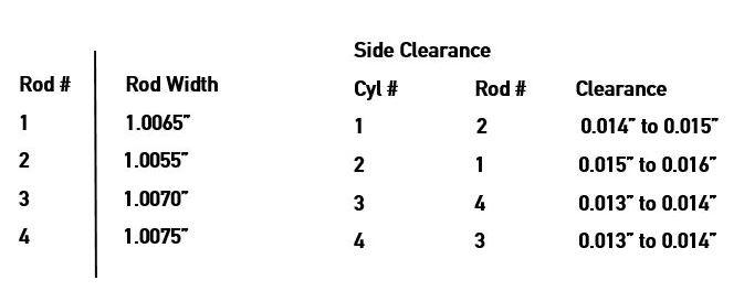

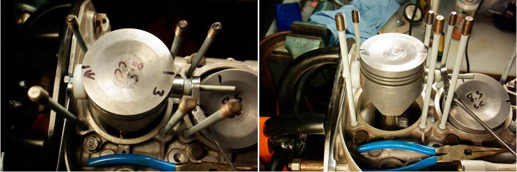

I just got the connecting rods back from the machine shop. It’s a pretty good machine shop! Almost strictly American cars and racing equipment but great tools, chassis dyno and very busy. Nice people, decent costs and they take instruction well.
The big end journal bores…while they originally were not that bad….they are all now round within about .0001”. So if you look back to the first page and note the rod “map”…all measurements are with .0001” to .00015”. They look very nice as does the deburr work on the sides.
The big end side measurements after deburring:
Rod # 360: 1.0079”
Rod # 081: 1.0078"
Rod # 602: 1.0078"
Rod # 895: 1.0057”
This leaves all of the rod side clearances right around mid 3/4 range of max tolerance. Which is just fine. Nice and smooth t00.
They also installed and set with a stretch gauge, the ARP rod bolts.
The small ends…the pin bushings…from rod to rod…are very consistent. All four are dead on 0.9452”.
BUT….That’s not perfect tolerance wise…and this set of piston pins are about .0001” smaller than normal. I noted this when I picked the rods up. The pin fit is slightly loose….but was good enough to walk out of there with. I have had this problem with more than one “domestic race” shop when talking tolerances and “push fit” for full floating wrist pins.
As I noted….the bushings that were in these rods were worn about .0001” to .0002” oversized to the pins. By that I meant…to where the tolerance of pin bushing to pin…..needs to be MAXIMUM. So the pin bushings that were replaced….were getting right close to .0009” to .001”….which are still…technically…in tolerance.
More on this “tolerance” in a minute.
So right now…these NEW bushings look like this:
Pin bushing bores: 0.9451” to 0.9452”
Pins: 0.9445”
So the tolerances are: 0.0006” to 0.0007”
Better? Yes. In spec?...yes…..but…not what most are used to. The pins fits smooth as glass and are a dead fit with no play. But they slide out under their own weight in about 1.5 to 2 seconds (lightly oiled).
In reality what most people consider a normal tight push fit…where a little too much hand warming can make a very tight fit…. is right at and below the minimum factory tolerance limit of 0.0004”.
A range of 0.00035” to 0.00045”
Does a tolerance of 0.0007” average mean that these are too loose? No.
And…by the way…the top end allowable factory tolerance (0.0016”) should be IGNORED. No wrist pins should ever be that loose!
I have built many of these engines with 0.0006” to 0.0008” pin fit…and never had an issue….but I would like them slightly tighter.
It’s not an issue because I have several sets of pins. I have a set of KS pins either new or very low miles that are pristine…with an OD of 0.9448”….that bring the average tolerance down on these rod bushings to 0.0005” to 0.0006”…which is noticeably tighter and increases the “slide out” time of the pins under their own weight to about 2.5 to 3.0 seconds.
Also interesting is that the Kolbenschmidt pins are slightly larger OD and slightly lighter.
So…back to the tolerances. I HATE the available books on type 4 and Porsche 914 engines. The specs are all over the place!...and TYPOS too!
Examples:
From the Haynes 914 book:
0.02mm to 0.04mm (0.0008” to 0.0016”)
Hayne 411/412 book:
0.01mm to 0.04mm (0.0004” to 0.0016”)
And the 411/412 book…has a TYPO in that inches number!...Listing 0.004” instead of 0.0004”
Haynes Bus book:
Porsche 914 tech specs book:
0.02mm to 0.03mm with a wear limit of 0.04” (0.0008” to 0.0012 with a wear limit to 0.0016”). This is properly stated. The wear limit should be the maximum number stated everywhere.
Without guesswork book:
0.01mm to 0.03mm (0.0004” to 0.0012”)…with a wear limit of 0.04” (0.0016”)
So really…. I would say the REAL…. FUNCTIONAL…. tolerance range should be between 0.0004” to 0.001” MAX!
Operating tolerances anywhere between 0.0004 and 0.0008” should be fine. Perfect tolerance being right between .0004” to right at 0.0005”…with a max of 0.0006”
I make that last statement….because…….if I left these bushings and pins the way they are…roughly .0002” more loose than I consider perfect…would it be a problem once they are in the engine and the engine warms up?
Well….while I have never had a problem running them this way.…I decided to put a rod and pin in the oven at 350° F to see.
This increased the stiffness of the pin fit….I would estimate…by about 20-25%. The pin takes about 3 full seconds to slide out under its own weight. With the 0.0001” larger KS pins…it has to be pushed out with very light finger pressure.
I think they will be fine either way. I will decide on whether to use the slightly larger pin set at final assembly time.

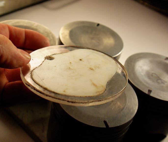

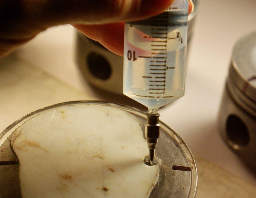

CC’ing piston dishes:
I CC’d these with a calibrated syringe (that just means it’s for actual medical use and not a dime store Chinese syringe…so it has decent certification).
I hate using my burette unless I have a lot to do that needs it. I use a syringe mostly…a good syringe.
I should go through how to accurately read a syringe. It can really help those who cannot afford a burette just for occasional use …but once I explain (and there are MANY videos and article for this on line so don’t just take it from me)….you will go…”oh yeah….I watched the nurse/doctor one time and wondered why they did all of these things”
1. The syringe is read pointing straight up.
3. The top mark you see here is EXACTLY where the liquid should stop…not filling up the area in the conical top. It’s very difficult to get it exactly on the line…so from above…looking like this is normal.
So…for example… if you want 20 cc…you pull in about 23-25 cc’s. Hold the syringe straight upright and level….and pull the plunger back to pull in an air bubble until the liquid hits the top line.
Then read the bottom line on the plunger head. If you have too much…push the plunger up to expel some liquid and then pull it back in again so the liquid is at the top mark to read the level again.
What you are seeing the nurse/doctor do when they tilt the drug bottle over sideways and push the plunger to expel excess liquid back into the drug vial….what this is doing…is allowing the exact size “reading” bubble that is up in that conical top area…. to float back to the plunger so you do not expel any of it.
This is so that after you expel liquid and then tilt the syringe back upright again…the same amount of air is back in that conical top…placing the upper liquid level right back at that top line so it’s ready to instantly read without having to adjust the amount of air again. When you tilt the syringe back vertical and that already properly sized air bubble floats back to the top….you can get an exact reading again without tinkering.
It’s very hard to get an exact line on the top line without some surface tension creep into the conical area. This is normal and is about 1/50th of a CC or less.
This is my Plexiglas CC plate. It actually my 90mm cylinder CC plate:
That white plastic plate is a .015” thick polypropylene insert used simulate taking .015” out of a 1.7L combustion chamber when CC’ing. You take a round piece of flexible plastic. Put black Sharpie around the edge of the chamber…drop in the plastic and burnish it down. It will now have the edge shape of the chamber dish.
Then glue it to the Plexiglas disc….and with an Exacto knife…trim away the edge and peel it off. Now you have a flat plate with a .015” thick shim that fills .015” of the dish so you can see the actual effect of fly cutting on head CC’s.
Silicone grease
So at first the piston dishes were all 9.5cc on the money. Rolling Eyes
But….I made a mistake. I got 9.5cc. Did it twice on each piston. I was having trouble on #3…getting the water to flow in an even stream without forming bubbles and blocking the hole….when I realized…I forgot to break the surface tension of the water…by adding 50% IPA. DOH!
On #4…with 50/50 water alcohol….I got a dead on 8.5cc. Re-did all of them…..8.5cc. Yes….the surface tension makes that much difference in that thin area right near the edge of the dish.

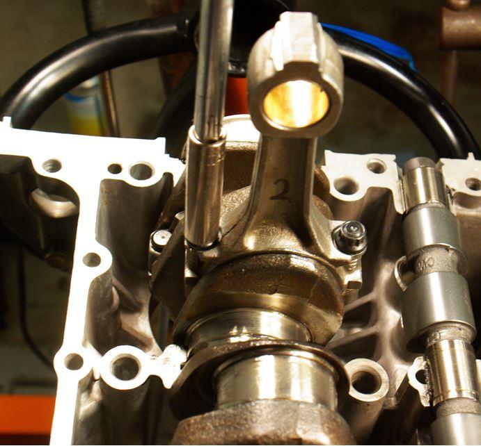

Rods mounted on crank. I did not torque them 100%. These are ARP bolts so I will check with a stretch gauge again when fully torqueing them down on final assembly. They are at about ¾ torque right now.
By the way…the rod and crank machine work so far seems excellent! These rods take about 2.5-3.0 seconds to go from the 9:00 position to the 6:00 position under their own weight….and of course the measurements are spot on.
Measuring rod to crank cheek clearance (side clearance):
The books show to measure at the narrow area at the top of the cap. The highest amount of wear is here and at the opposite end so it will be widest here. I measure this area and on the sides.
Here are the rod measurements before installing and the side play measurements on each crank throw. Since there is small variation in the rods and some variation on each crank throw…I will mix and match later to get the best fit I can in each spot.
For now I simply numbered the rods 1-4 with no real location planned yet to see what each rod gives.
Below is the rod big end width measurement on the left and the journal per each cylinder with a rod on it with side clearance noted. The wider measurement of each two is at the top thin area at the end of the rod cap.
So for instance….from that chart…moving rod #4 to journal #2….in place of rod #1 will give a 0.001” reduction in side clearance to that journal. While all of these are close to the top of the tolerance range….they are nowhere near the wear limit and its pretty much par for the course in used parts.
While they will lose a little oil pressure….keeping the rod bearings tight near the bottom of the normal tolerance range will offset that decently.

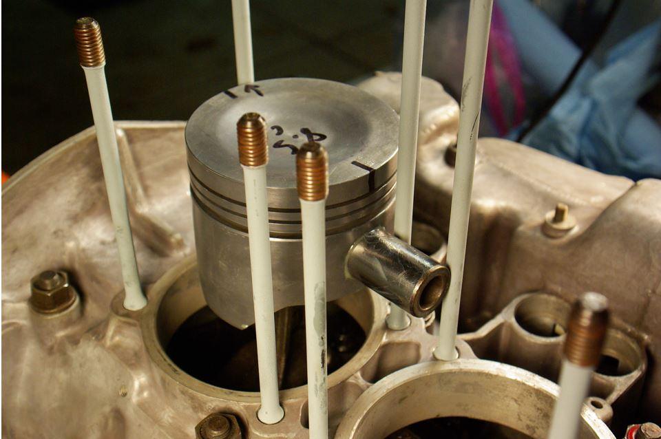

Assembling the pins on rods and pistons…no clips and no rings:
First thing…note where the arrows to point to flywheel are stamped…and then mark them with big visible arrows.
Button up and torque the case six main bolts.
Then with a hard plastic mallet (if needed) I tap each pin into a piston so it’s just protruding enough to register on the bushing.
BUT FIRST…plan the directions you will need to have the pin installed in the piston
Mount the piston on the rod. This is #1 I am starting with.
I made a nice little pin pusher tool so I am not whacking around on things. It’s a piece (several lengths actually) of 5/16” threaded rod, some UHMW or nylon bushings to center the rod in the piston pin, a thick disc of any slick plastic (I used UHMW) on the pull side and a disc of UHMW smaller than the pin on the push side…3 nuts and two steel washers.
Here it is working on #1 pin:
Here is the tool position on #4:
Piston #3 was a little trickier. I used the shorter threaded rod and the locknut combo was right up against the case but it worked fine.

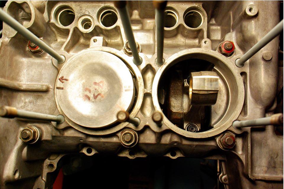

The cylinders were oiled and installed on the 3 and 4 case half. I carefully put each cylinder on each set of studs…no sealer and no shims.
One quick observation makes me happy! Notice how tight the deck is. I was hoping and wanting it to be too tight so I can shim to what I need and have a nice tight deck!
Locking cylinders down:
I have a little kit box with eight 3.625” pieces of thick wall PVC pipe and eight pieces of 1.625” pipe, 16 thick flat washers and 16 10mm x 1.50 nuts. All clean and just for this so I am not piddling around with hardware that may be dirty.
I find they get plenty tight enough for this step with no gaskets or sealer and less risk to cracking a fin with steel tubes.
I have both a depth mic and a dial depth indicator. To start off I like using this gauge.

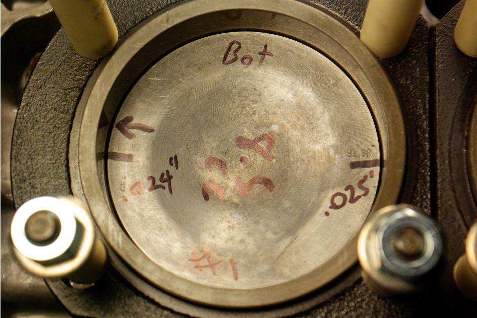

And….this is where the problem reared its head. Nothing I can’t fix. In fact it may not be anything that needs “fixing”…yet.
These are listed outside of cylinder first and inside close to adjacent cylinder second:
Deck piston #1: 0.024” and 0.025”
Deck piston #2 0.023” and 0.024”
Deck piston #3 0.017” and 0.016”
Deck piston #4 0.017” and 0.017”
So….betting that with a bit of tightening and cleaning I can get #1 and #2 to read within a clean .001” of each other….call it .024”….the 3 and 4 side is a consistent 0.017”…meaning a hard .007” difference from left to right.
This is pretty much indicative of the 1 and 2 side:
This is pretty much indicative of the 3 and 4 side:

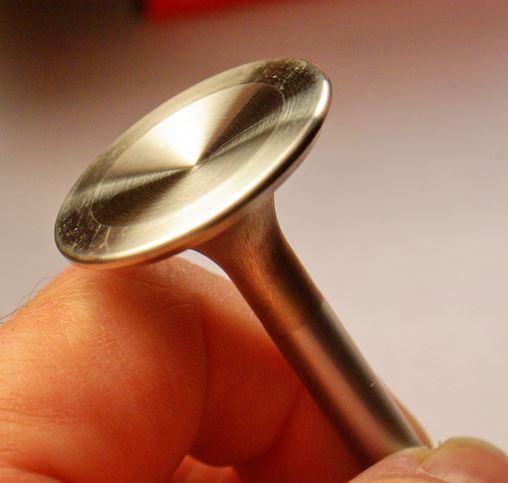

The valves:
These valves came in about 10 days ago. Very nice….Manley Race master valves. Stainless steel one piece, stellite tips, heavy chromed stems, swirl polished heads. Not actually that expensive. I think they were about $95 per set of 4 intake and exhaust with shipping. These are listed as the standard Porsche 914 1.8 and 2.0 valves 42 x 36.
Nice valves!

The deck height difference........
So with a little tweaking....mainly just checking cylinder base to case cleanliness and retorqe with a slightly different pattern to the six case bolts ....I was able to get the right side (1 and 2) to pretty equal 0.024" to 0.0245".....call it even....kt will go up and down by .001-ish in this stage when measuring in line with the pins and crank because there is no flywheel (flex plate).....and at the moment....no flywheel shims.
So the slight fore and aft movement of the crank can produce the +/- movement by as much as .002". You just have to know its there when measuring.
So I am happy with seeing how equal the 1 and 2 cylinder decks are.
And.....in that same respect.....the 3 and 4 cylinders are also within that same .001" ....I got rid of that .016" measurement......and the tolerance in line with the pin fore and aft on each piston.....so I am happy.....ish.....with those as well....except that......they still are 0.017" for deck. That is .007" from side to side.

I will be removing pistons and rods again.....and rechecking the rods from top of big end to bottom of little end. I checked them when they came back from the machine shop....but things were crazy about that time so anything is possible.
I need to double check to make sure that the big end was not offset down or up and the little end moved to match......not explaining that right.....but hopefully I can show you. The shop who did the rods was an excellent racing machine shop and they took great care. I highly doubt its the rods.

In other words….looking from the top….the flywheel end of the crank is about .001” closer to #3 and the opposite end is the same amount closer to #2.
Using my crude but effective piston pin puller/pusher tool to remove the pistons.
Actually the garage temp wear nearly perfect today and I could simply push the pins in with some effort….but getting them out is easier with this.
So here is the 3 and 4 side of the case…the one with the 0.017” deck height… with the dial depth gauge centered in the center main bearing bore.
And after the gauge is “0”…I switched to the 1 and 2 side center main bore…..and….there is the 0.007”. Its .007” shallower than the 3 and 4 side.
And here is the flywheel end main bearing bore on the 1 and 2 side….0.006” more shallow. The crank is at a skew angle by about .001”
NOTE: I buy most of my measuring tools new. I’m not rich so I save up or trade work for tools. But I have bought a few “ebay” tools.
Most are never as well kept, clean or accurate as advertised. I prefer pawn shop tools where I can check the action.
But…this Baker dial depth gauge set was worth every penny of the $45 I spent on it on Ebay. I bought it just for this type of work…doing main bearing saddles. It has paid for itself many times.
This is the 1 and 2 side of the case and how much more shallow the bores are.
With a granite plate beneath the spigots they are all level within that 0.001” we see end to end with the crank skew.
I have a diamond lapping plate I may surface the case openings with to get it dead even. It’s just not enough to make it worth decking the case when it’s this close. It’s flat and parallel.
I will have to see what I can get for shims. It may be worthwhile to lap the 3 and 4 side down to an even .015” deck so shims are easier to get spot on.
More to come! Ray

So the owner sends heads to shop…and instead of shop thinking….412 or 914…they think “bus”. It’s possible they never asked.
So…they put in new guides, valves, springs…and a minor step cut. This is NOT the normal step cut of .028” to .032" that you see newer head castings with.
This is a thinner 0.011” step….with the chamber floor flycut at a slight cant/angle…to increase deck volume while not taking much out of the bowl.
This GREATLY increased the chamber volume.
They did a few things quite well though:
1. As you can see in the picture below…they shaved the boss on the cylinder side of the head. This is good…in the respect that there is not that much room to go fly cutting in these heads before the cylinder fin contacts the head fin. And with the variations from cylinder make to make….that can get risky.
Here is why shaving that boss is good.
The lip on these 1.8L cylinders is 0.278”.
The same lip on my 1.7L Mahles is 0.275”
The bore depth in the 1.7 and 1.8 heads is normally about 0.250”….which means that had they not shaved the boss…the fly cutting that was already done would cause interference between cylinder and head fins.
Right now from the step to the machine outer boss is 0.226”. That leaves me 0.052” to play with. They will machine 0.026” from that leaving 0.024” between cylinder and head fins. If I need more I can shave a little more.
2. The seat work was good…not perfect…but good. The valve job is just basic…very good…but with a single angle on the exhaust. The seats could have been blended at the port slightly better.
3. It appears from the new machinists comments (and markings on the head)….who are used to building some very high end engines so they think critically about everything they measure…even on simpler engines like this….that the throat of the exhaust bowl was milled slightly during seat install…”throat cut” as it’s called. It increased the exhaust bowl to valve diameter ratio to 91.3%...which is a little better than average for the street.
So far all that has been done in this picture is some minor floor smoothing, CC’ing ports, chamber and bowls and measuring everything.
The valve bowl throat sizing will be done again as the exhaust valve is brought out to 36mm. Keeping as close to 90% as possible is excellent for a street engine the machinist stated. They know far more about heads than I do.
An important key will be sourcing valve seats that are correct for the valve size and have as much open center area as possible. This is a common problem on cheap replacement seats….that may fit say…a 34mm valve….but end up being so thick in cross section that they restrict actual “valve curtain” or seat flow diameter to as small as 25mm….before even subtracting the stem diameter.
4. The hardware on these heads…the springs appear to be Iskenderian brand. Good quality.
Retainers are stock replacements. The valve guides are accurate....technically..…but not perfectly smooth inside in the whole length.
Machinist stated that this is pretty common and has to do with the type of hone used. It’s actually a type of diamond “broach” as it was described to me…that…wobbles a little through the guide while expanding it. They have better equipment.
These springs have a few very small rust blemishes. They are going to be REM polished and checked. If they don’t pass…I have a brand new set of Crower springs that came in a cam kit for a very similar cam from the Type 4 store.
Valve guides are critical on everything…but much more so on air cooled.
The valves are not slouchy….but just basic good replacement level made by Ivam (Italy). Stainless with hardened tips. Very thin chrome on the stems. Not bad...not great.
In this picture you can see the thin step. The surface grinding to the floor and around the valve seat was the current machinist removing a small amount of metal…so he could see how the seat was installed. It was the install method that they were not totally happy with. It was noted that it appears the seat was slightly counter sunk and then the surrounding metal was peened in…which is “A” way to do it….but it could be better.
So…what is coming up:
The biggest problem…..is that the fly cutting that was done…has left the chamber volume with the step…at about 54cc. That’s huge.
And….with no other changes of additions…..meaning no cylinder shims or seals…that would leave the .024” deck we currently have and the 8.5cc piston dish and the .011” step….which means a compression ratio of 7.53:1.
While that IS better than the miserable 7.3:1 this engine came with….which ran hot….it is also the absolute extreme of deck that you can use in an engine like this…that also runs hot. Risky.
So….I am shooting….ideally….for
1. New 1st oversized guides from Automobile Atlanta are on the way.
2. Manley Racemaster 42mm x 36mm arrived a few months ago. 5 angle valve job.
3. New seats and proper minor unshrouding and matching
4. Fly cutting to remove the step of .011”…and a further 0.015” for a total flycut of .026”.
This will give a deck of .039”…and I will add right at .001” for sealing compound. So deck will be .040”.
In a perfect world that will give a chamber volume of 47.5cc (doubt it)…which will give a compression ratio of 8.12:1.
More likely we can hit a chamber volume of 48.5cc. With the .040” deck that is 8.01:1. Far more respectable than 7.3:1.
It may improve also because the larger valves and new valve margin will dump a ½ to ¾ cc…maybe.
Here are my cheat sheets for compression ratios if anyone can use them:
More to come! Ray

A short update- 12-19-2019.
My apologies to the owner I am building this engine for that this is taking so long. Really it’s stalled on the heads.
The heads are moving along but they were kind of an in between job at this very busy but EXCELLENT machine shop and between me being in and out of town and traveling internationally from about April until my largest contract ended in November…whenever the machinist had time…. I was out of town. Whenever I had time they were in the middle of a production push.
OK…so some of the last pictures I posted will be re-posted to point out some details. I took some pictures last week with the valve seats pulled. The machinist has had some questions and concerns. There is nothing wrong with these heads and the castings. They will be excellent. However the degree of detail from when these were rebuilt about 10 years ago…..is disappointing (considering who the shop is)…and it’s what we will be correcting.
The gist is that these are 1.8L heads for a 412/914...and were remade for a bus.
The issues:
1. It appears according to the machinist….that either generic valve seats that are smaller than stock in the ID…...or even 1.7L valve seats were installed.
These seats were then “throat cut”…basically plunge cut or hand cut through the ID…to open them up. It left a VERY thin margin on the OD. With the type of metal these are…..which “appeared” to be a ductile iron seat…which are not ideal for air cooled…this thin margin (not much mass in the seat)…makes it hard to keep the seats in the head over time.
With the seats still in:
Seats out:
2. The machinist noted….that this is one of the common mistakes people make with rebuilding air cooled heads. Trying to get off cheap or not so much cheap…but with less work/effort…and not wanting to really machine seat ledges oversize. Yes…it is a concern…. realizing that its a critical operation because there is not much meat in these heads. Its one of the common reasons why seats fall out with heat cycling.
But putting in an undersized ID seat and throat cutting …is poor form. Cutting out excessive material….changes the temper and surface tension of a seat that has been installed with an interference fit. It will technically “loosen” the OD interference fit as the head and seat heat cycle.
3. To add to this, the ledges should have been cut with a chamfer in the corner to collect any chips or swarf that collect as the seat is pressed in. It appears that the intake seats still have the original factory chamfer but the exhaust were not cut with a chamfer.
The alternate and more common method is to chamfer the outer corner edge of the seats to leave a space behind it. Some shops do a little of both and work hard to keep the seat bore walls smooth to minimize the issue. The exhaust seats had a sharp edge.
So what level of workmanship do I expect from this shop? I am also putting in some pictures of my heads done by this same shop back in maybe 99 or 2000.
Mine are on the left. Next to them on the right are a set of stock, low miles head cores with stock valve size from a 1.7L out of a 412 so you can see what’s been done.
These are my old heads that will be rebuilt for my engine next year, are 1.7L heads but have 42 x 36 valves with high nickel alloy seats. These heads have had minor porting and valve unshrouding. They really needed to be flycut.
The unshrouding and port work created about 1.25 to 1.5 cc of extra volume. With the removal of the head gasket and shim I kept right at 8.0: or 8.1:1 compression ratio. A little low…but with everything else I did…web 73 cam….injection tweaks and better ignition and exhaust…it still ran fantastically. When I redo them…and do a little piston and deck work it will be 8.5:1.
Note how well the exhaust seats are blended
This is the intake seat detail. That thin shiny line is not a ledge sticking out. It’s the visible edge of a chamfer on the inner edge of the seat ledge.
Another view of the intake seats and intake unshrouding. The nicks from installing valve guides are not from this shop.
At about 70k miles I had a pushrod problem and had to have guides replaced on one head. It was my mistake and not a build quality issue. A different shop in Dallas installed the guides and left the marks.
This is a factory core head. Look at the big nasty ledge under that intake seat.
Undercut visible on both intake and exhaust factory seats showing that they were hand deburred before seats were installed.
Anyway…enough about my stuff. These pictures are just in this thread to illustrate what better workmanship these 1.8L heads will have.
So….we were speaking about valve seats last week. What to put in them. Yes….the stock factory seats were good. The high nickel alloy seats my heads have were harder, stiffer and machine smoother and handle a little more heat.
It was noted that on the 914’s and 911’s they have worked on (and yes those were for road racing)….they like to put in seats that can handle over 1400° F….that are cast to the proper ID and OD sizes so they do not have to be cut excessively risking changing the shape.
ACVW and Porsche are already a high heat application potential….mainly high constant heat. Not like a top fuel car or something…but they have their own heat issues.
Of course it was noted that when they use titanium valves…in a perfect world they like to use beryllium copper alloys. Pulls more heat out of the titanium which does not conduct heat as well as stainless.
Of course…we are not using titanium valves but are using damn good valves. And…Beryllium copper would be nuclear weapon level overkill …and a pile of cash…..and totally unnecessary. However it was mentioned that they have been having very good results in 914’s with some special alloy seats from CHE precision.
These alloys have a few percent beryllium copper but are a proprietary nickel, silicon, chrome and copper alloy (which is actually/technically a “bronze” seat).
They have been documented to pull heat out of stainless valves at a rate of about 2X that of normal nickel or iron seats…and therefore keep their expanded size better and require a little less interference fit. A bit more expensive but it’s what we are going with. They are cast in the correct size…only need a little ID blending. They should be arriving around January 12th…so I hope to have the heads ready to final flycut to set compression ratio by the third week of January.
So this is what we decided we are getting for seats. The exhaust and intake will be different alloys. They list them as their B-1 and B-2 alloys.
So in short…the work done to these heads about 10-12 years ago…was better quality than the factory….machine work wise. However some of the techniques….while adequate….are less than what SHOULD be used. The parts used (valves, seats and springs) were probably about equal to or slightly better than factory.
The machine work to put the step in….was not needed for this application and not correct for this application…and could have been a little smoother but was just fine.
The Manley valves we are putting in, type 4 store spring kit (possibly....although the springs already in these are pretty damn good) and the much better seats with better machine work should make these stellar heads.
More to come! Ray
