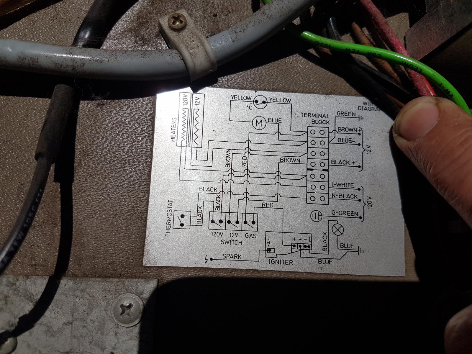

PostPosted: Sat Jun 09, 2018 12:16 pm    Post subject: Re: Dometic Fridge - no red light = no piezo/spark? Reply with quote
I had a look in Bentley camper wiring diagrams and an online 182B service manual but didn't see the fridge auto spark system. I'm sure more detailed info on the auto sparking system is in this forum but that system aside......
The piezo tip needs to be clean as does metal near it. It's not uncommon for that tip and burner to get dirty and/or corroded. So speaking of "grounds", without a clean path between piezo tip and burner (fridge frame metal), no spark.
As was mentioned, the wire between the switch and piezo itself can be an issue. On my 182A on my first Westy, that wire wasn't properly crimped to terminal that enters the manual sparker switch.

I posted the troubleshooting manual for the electronic fridge in some thread. If you really need it, let me know and I'll look for it.
If the sparker is working on 110 but not 12V, that might indicate a loose wire or less than ideal connection in the 12 volt wiring. I would check everything from the battery to the fridge. Undo the connections and clean them, also the fuse behind the driver seat. But you could also try starting the van to see if that higher voltage provides enough current to get the sparker going. That would confirm that you are just not getting enough current to flow to the electronic sparker or the sparker is just wearing out internally.
In the end, you may just need to replace the electronic spark box, but just cleaning up the connections everywhere may do it. You can leave the fridge sitting in the van to test just the sparker after clearning or before putting it all back together. Just hook up the power plug without all the other stuff connected and see if it works.

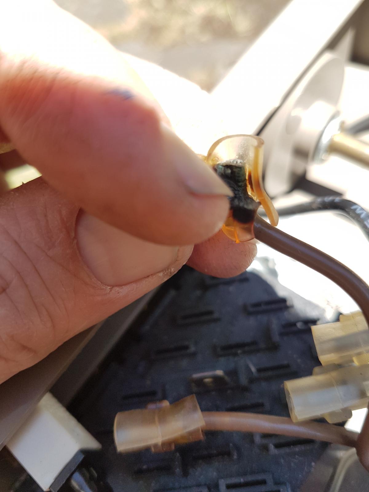

Here's what we have:
Based on what I see and what you have told me on this thread, I will now do the following:
1/ replace burnt electrical connector
2/ replace ignitor (it could be that doing 1/ only will fix everything, but I've bought the replacement part already and its non-returnable)
3/ Check and clean the spark electrode.

PostPosted: Sat Jun 09, 2018 1:24 pm    Post subject: Re: Dometic Fridge - no red light = no piezo/spark? Reply with quote
It looks to me like that brown wire is part of the DC heater circuit so it's not related to the LP system that I can see.

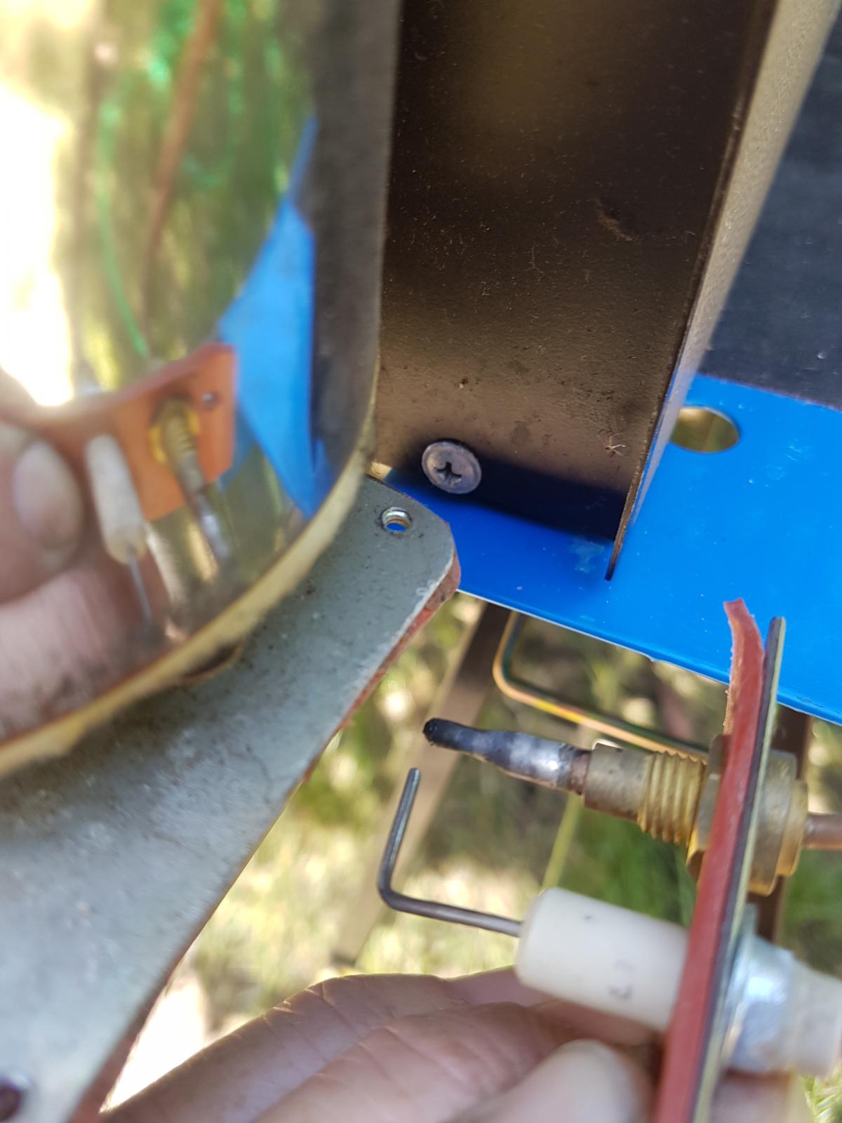

PostPosted: Sat Jun 09, 2018 1:53 pm    Post subject: Re: Dometic Fridge - no red light = no piezo/spark? Reply with quote
You are right. I followed the wire. It is connectedto a red braided wire that goes in the chimney and disappears there. Not related to LP apparently. I tested the resistance of the brown wire, it's par with the other ones next to it. Ill just add dielectric grease and leave it be. I don't have 90° crimps anyway, and besides the burnt plastic cover, the crimp and wiring seems in good shape.
Vanagon Nut wrote:
If you don't want to take apart the combustion box assembly, if you use the piezo hole as an access, it might be possible to clean the metal at or near the burner flame vent (where spark should "connect", ground) with some medium or fine emery cloth on a narrow wood dowel (chopstick?) but there's a risk that dirt could get deposited inside the burner. Really, it would be best to open up the combustion box to do any related work. Given the spider webs I see, its entirely possible the combustion box has never been cleaned.
It couldn't hurt to clean the connectors associated with the sparking system.
If the auto ignitor is dead, since there's a push rod visible at air pump, could the older style Dometic Piezo could be retrofitted w/o too much hassle?
Neil.
I removed it all, one of the electrodes is black and had some kind of dust/web around it (not visible on picture, gone with the wind Boo hoo! ).
I cleaned both with fine sandpaper. I'll blow the s Twisted Evil t out of the burner box and put it all back together. I'll then change the ignitor, just because I hav new one, although I suspect this one is working just fine.

PostPosted: Sat Jun 09, 2018 3:02 pm    Post subject: Re: Dometic Fridge - no red light = no piezo/spark? Reply with quote
I cleaned everything, changed the ignitor.
Neil, I'll find a way to test it on the bench later, to see if it still works or not. I'll keep it as a spare then I guess...
Thanks for your help!

Well finally got off my butt and decided it was time I got my fridge to work on propane.
Yanked it out to check for spark action in the fire box.
Probably needs cleaning anyway.........
Shocked
Working great now
