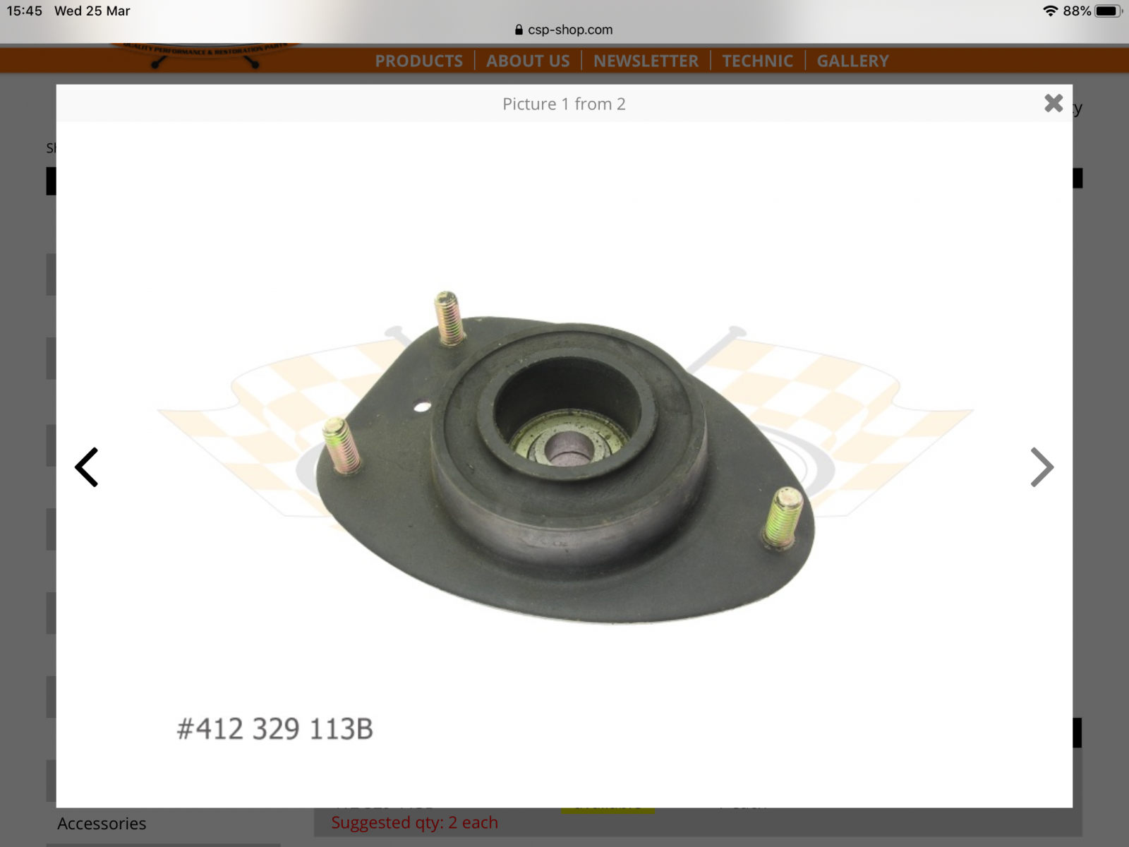

Hello Ray,
Thank you for the reply. You mean these then? Rob.

PostPosted: Wed Mar 25, 2020 9:27 am    Post subject: Re: Rear springs type? Reply with quote
Those are bonded rubber bushings. They are technically for the middle years super beetle.
Let me explain that:
One would generally say that super beetle only had an early and late.....most people calling those bonded rubber bushings with the much higher quapity ball bearing.....in your picture....early.....and the ones with the replaceable bearing/bushing cartridge or.....sperate bushing and bearing cartridges depending in what company made them......as "late".
What the middle and late units had in common with LATE 412.....is the mounting plate having an "assymetrical" bolt pattern like the one in your picture.
The difference being that all 411 and the early 412's had a strut mount that was just like that one in your picture.....same bushing and bearing......except that the mounting plate was completely round.....and the 3 bolts were exactly 120° apart. This is also what I call early super beetle.
There were a very few of the earliest super beetles.....that had the round plate, bonded bushing strut mount with bolts 120° apart.....I have only seen two complete cars in person.....but actually found a pile of about 5 cars worth of struts....about 30 years ago.....in a MASSIVE VW salvage yard in Oklahoma called lexington auto salvage.
I was thrilled....because at first glance I thought they were 411/412 and I needed the bushings. I quickly found....because some of the struts were still attached to ball joints and control arms.....that they were type 1. But.....the bushing/mount assembly was the same so I got four of them and it kept me going for about 3 years.
But.....that is the total extent in my lifetime of seeing super beetles having the same round symmetrical, bonded bushing/bearing assembly as the 411 and early 412.
I can only surmise....that these were from first year, early production....1970.....super beetles. Since the idler arm bushing was also from 411....it would not be out of the question that starting off an existing part # for strut mount was used on some supers as well.
In the two super beetle cars I saw with the round strut mount.....the mount fit the holes perfectly and the hole pattern was symmetrical....so there is no chance these were supers using the earlier bushings by being modified.
So if you have a 411....and need the early bonded rubber bushing....the assymetrical bonded bushing in your picture.....from what others have noted....can fit inside of your strut tower. Personally.....I found that the mounting plate needed a little grinding on the corners.....and of course you will have to drill perhaps two holes at a different spacing.....to use that bushing.
The later super beetle strut bushing.....with the replaceable insert bushing and bearing assembly......has a slightly shorter plate....so will fit inside of the strut tower with no grinding to the corners of the bushing plate.....but the center hump of the metal plate is larger in diameter.....IIRC.........and that is when you need to trim the center hole metal a little. I will have to look that up though to be sure.
At this link:
https://www.mtmfg.com/vw/3289/Volkswagen-Beetle-Struts-Strut-Parts
You can see the bonded bushing you are showing is for super beetle 71-73
Below that you can see the later one for August of 73 to 79. The difference in the mounting plate size is small. But IIRC....the difference in the center hub is the issue. Its not a huge difference either way.
If you are looking at my front strut "book".....do not be confused by what you see done to mine. There was a long train of mods done to the strut mounts over ahout 200k miles.
1. The first thing I did was slot the mounting bolt holes for the original round, bonded, symmetrical bushings. This was an attempt to get more castor angle into the front suspension.
I drove daily in high cross winds at 70 mph for many miles and the lack of castor was killing me. It only had about 0.9° from the factory.
Finding that was not enough....it got me to about 1.2°.....which WAS an improvement and pointed out that I was on the right track.....but I could not get much more.
2. As I was starting to develop the Audi strut cartridge mod around this time.....I also was running out of bonded strut bushings. This was pre-internet....and bonded, symmetrical 411/412 bushings were unobtanium.
But I could get late 412 bushings easily. However the fit required a little grinding.
So since I was going make modifed struts anyway....and was looking to get just,short of an inch of lowering.....and try be able to use the late 412/super beetle assymetrical mount.....and did not like how high the late platd rose up or the fact that I would be grinding AND drilling holes.....and the fact that the nifty plastic strut top covers my 412 had....would no longer fit.......
I just decided to make the hybrid welded version that installed the dome from the late 412/super strut mount onto the early, round symmetrical strut mount.
Not being very good at welding yet.... Laughing .....the hybrid strut mount ended up a little fatter than I planned so ....I had to grind out more of the center of the strut tower than I planned. However it all came together well.
So there are several ways you can go.
Personally.....even though bonded bushings are now readily available....I would never go back to a bonded bushing. Ray

Thank you for your comprehensive reply. I get it now. I think I was getting confused reading your book. Ideally any modification should be safe, but future proof, (AUDI shock absorber inserts and non bonded bushings), look the same as the original set up and use as many of the visible original non wearing parts, as possible; to look right.
The confusion set in as I am trying to separate the experimental parts of your “book” with what I currently have (1972 411) set up and the fitting and modifications required to install the KYB 365008 Gas/Oil shock absorber inserts.
I like to keep things looking as original as possible with all my cars, but I know that modernising improvements are a worthwhile route to take with safety critical components as any new/original replacement parts are either unobtainable or NOS parts degraded by age.
Thank you for sharing your research results. It is much appreciated. Rob

PostPosted: Wed Mar 25, 2020 11:31 am    Post subject: Re: Rear springs type? Reply with quote
Hawker wrote:
Hello Ray,
Yes.
Actually that how to book has a few parts that need to be clarified.....and it has been on my desktop (actuallg in my jump drive) for sbout a month.. I am cleaning it up an res8z8ng pictures and will upload it to the samba in a mucj smaller, easier to download file.
With a 1972 411.....I would say it would be worthwhile to go to a junkyard and get one of the bushing mount steel shells.....from a LATE.....through 1979 super beetle......and see what little it may take to fit it into your strut tower.
Bear in mind that so much work I did was so long ago.....a lot of what went into my document was from my notebooks. Lots of little things change shape in new parts.
Or measure the hole in the body where the top of the strut mount comes through....and I think I have measurements of the diameter of the 1973-79 part in my document.
If the late super strut mount will fit the center hole.....it may be as simple as drilling the extra stud hole(s). Ray
