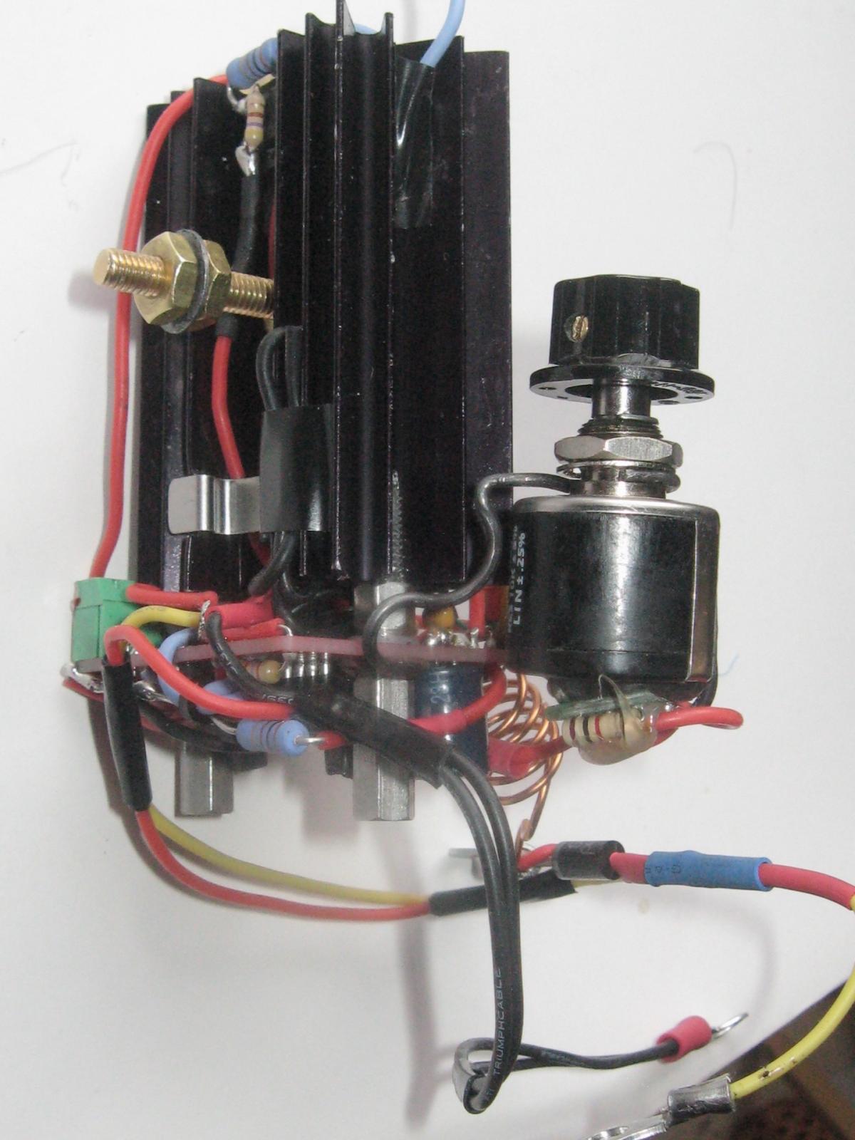

Hi, I just did a 12Volt one: Here it is:

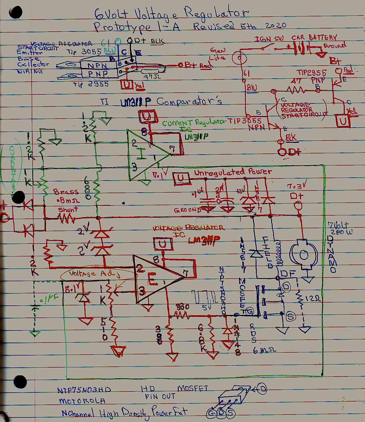

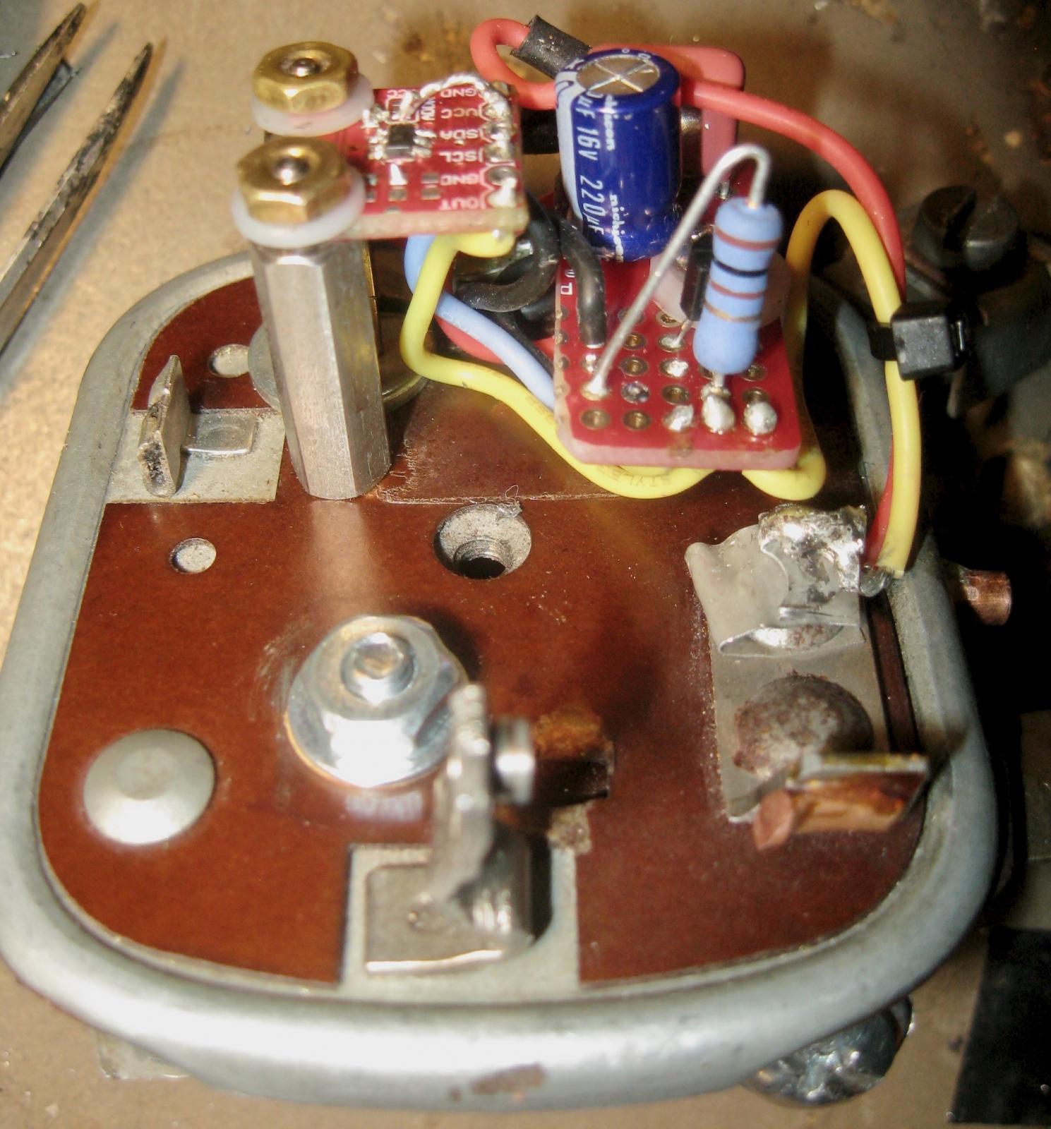

The 6 Volt regulator installed in the 1960 Beetle in a Bosch mechanical regulator housing failed the other day due to a screw coming loose inside. It was a difficult repair however I have it going again apparently it had only burned out several wire connections on the circuit board:
UpDated Schematic Nov 15 2020: (Note! the Start Circuit is yet to be installed, currently unregulated is feed from the ign coil 6 volts and The Reference voltage is not connected at start-up yet this may be why it's reluctant to start charging when cold.) (Also the Field Resistor may be removed from the design or at least tried without it as it may help with tighter voltage regulation to remove it!)
Installed in the 1960 Beetle:

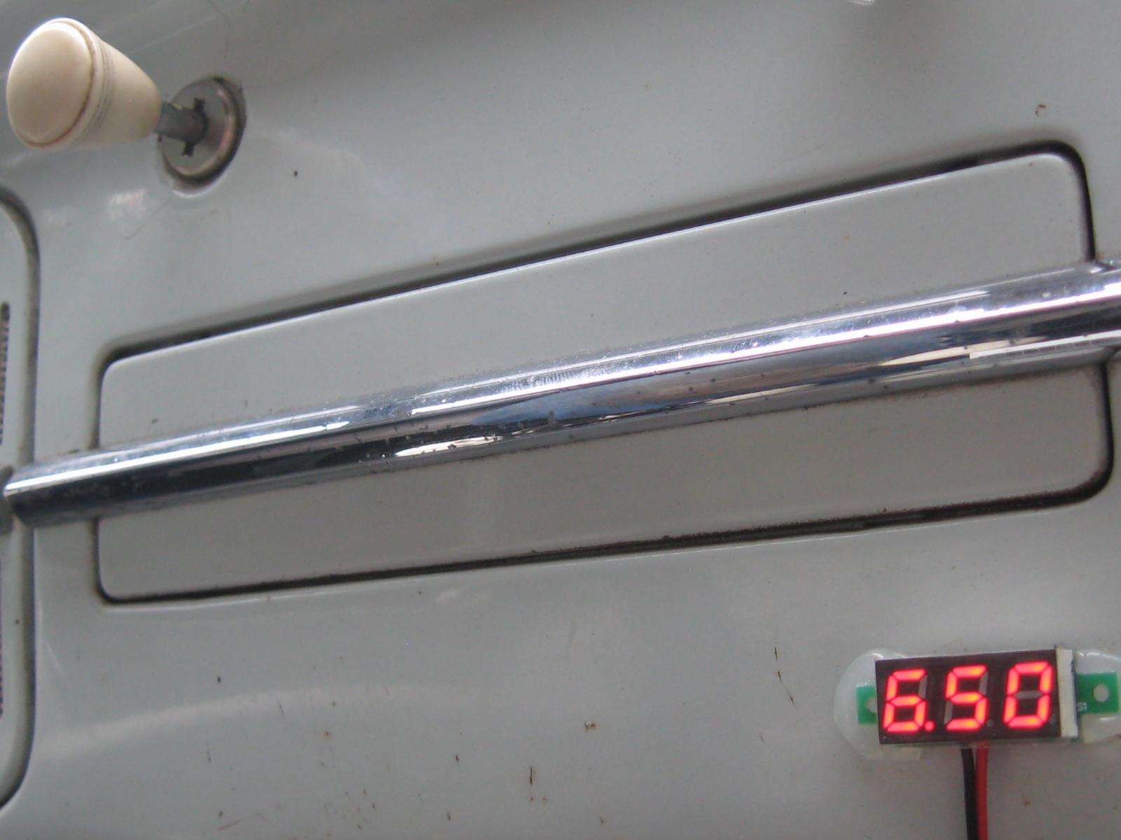

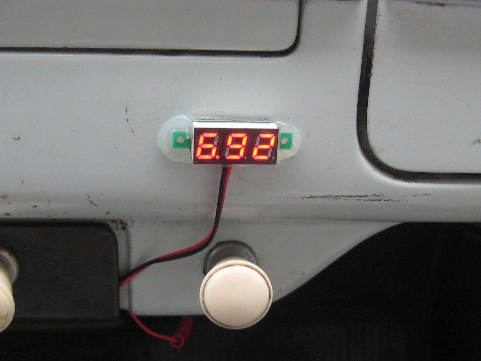

Charging Voltage at Ignition Switch Lights On:
Charging Voltage at Ignition Switch Lights Off:

PostPosted: Tue Nov 10, 2020 11:54 am    Post subject: Re: The New 6 Volt Voltage Regulator Reply with quote
Drop of blue Loctite on those screws , Dan

PostPosted: Tue Nov 10, 2020 12:22 pm    Post subject: Re: The New 6 Volt Voltage Regulator Reply with quote
Cool! Yeah, a good Idea, Not sure Thread locker works on brass but I guess it would work because it screws into steel standoffs.

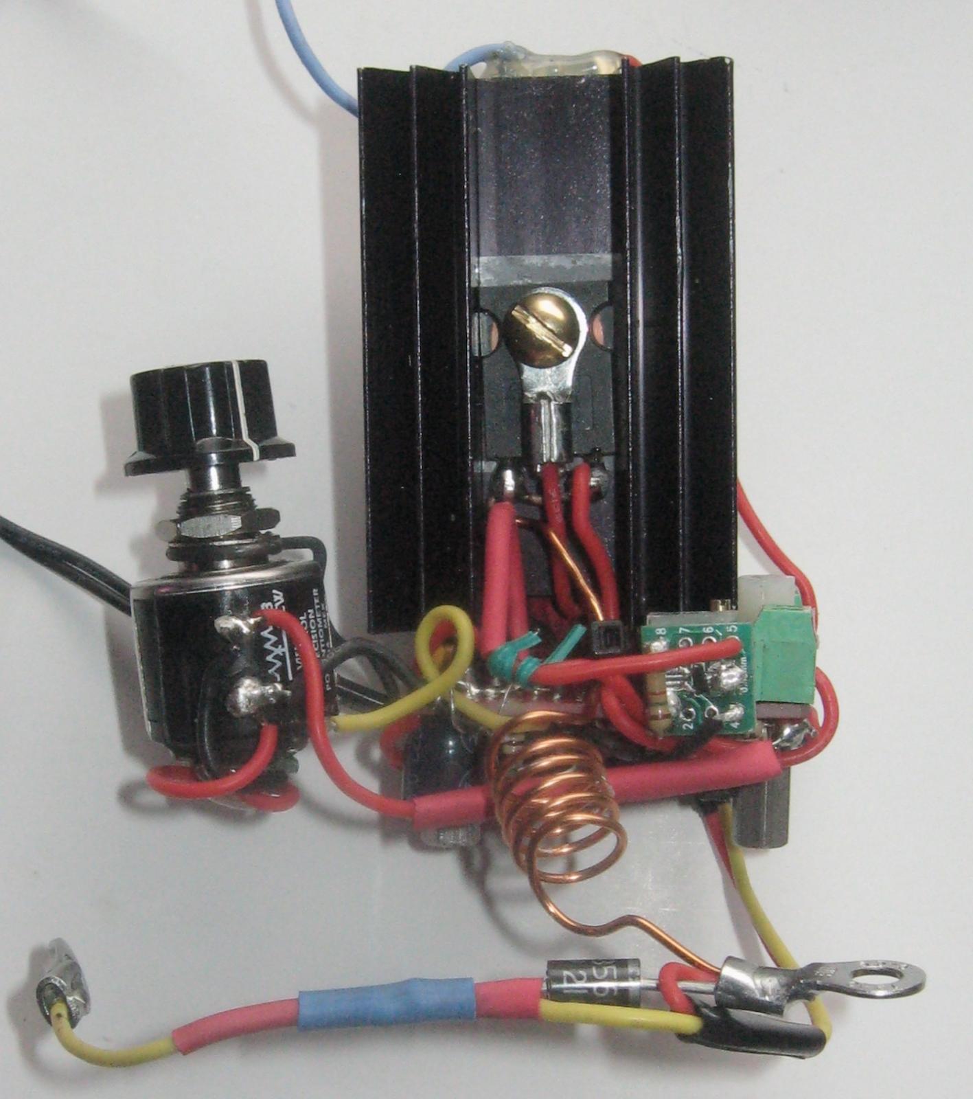

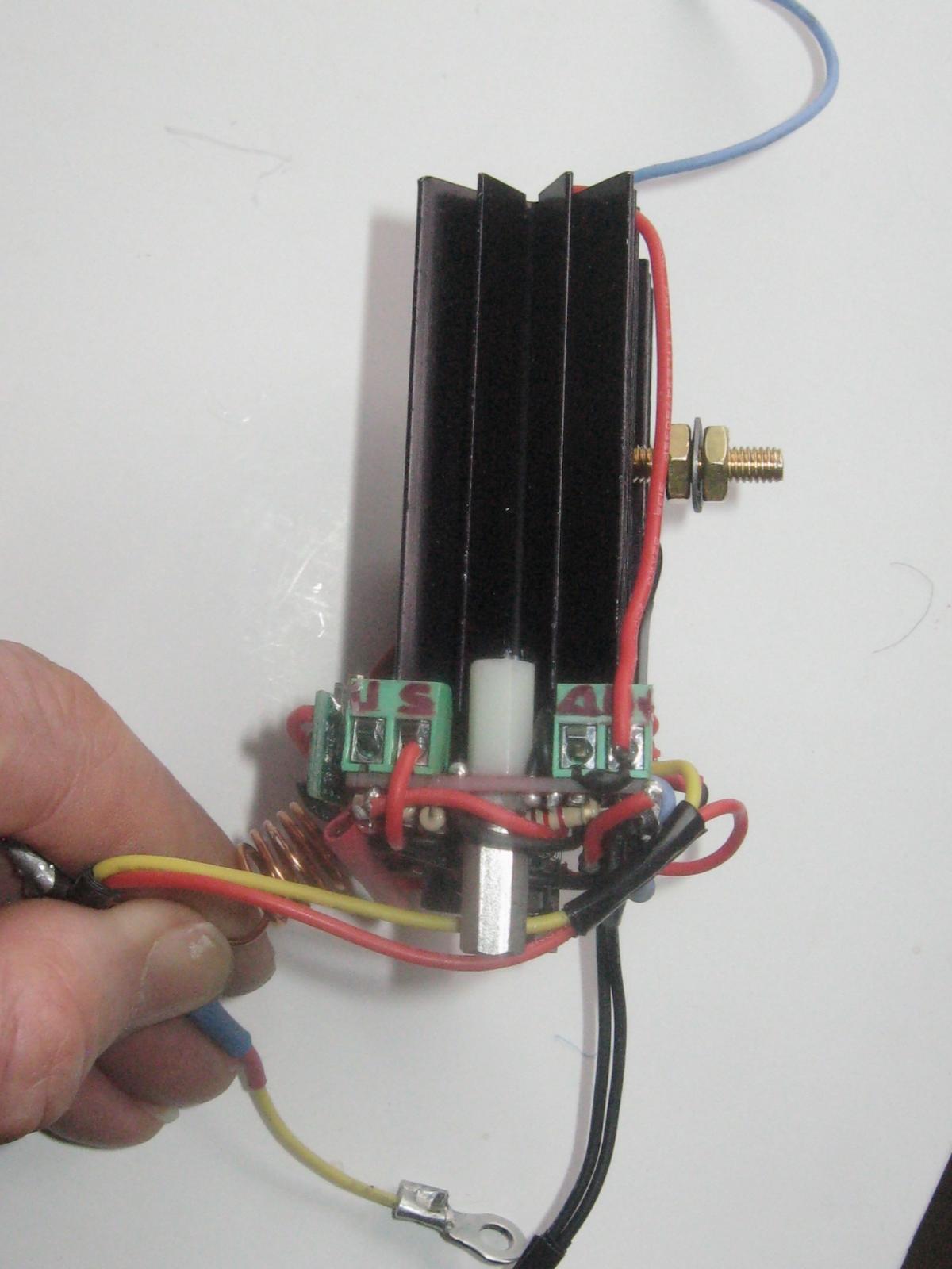

This Voltage Regulator Design keeps changing Here is a photo of the latest Prototype:
Mock-Up
Prototype Wired:
UnderSide simplified:
Latest Ideas:

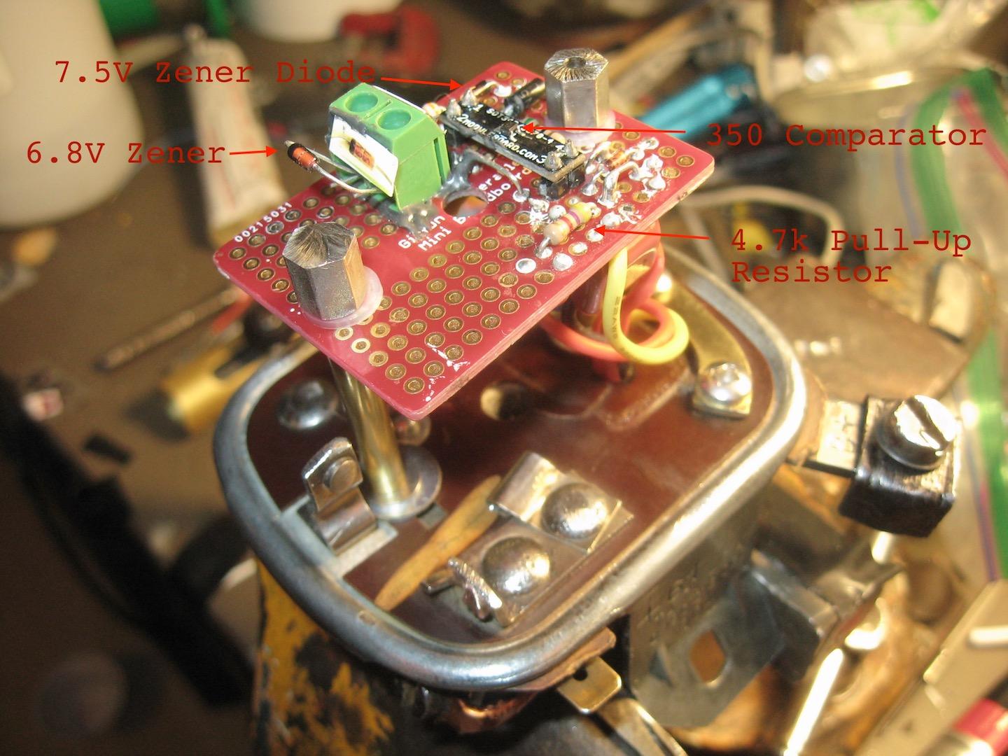

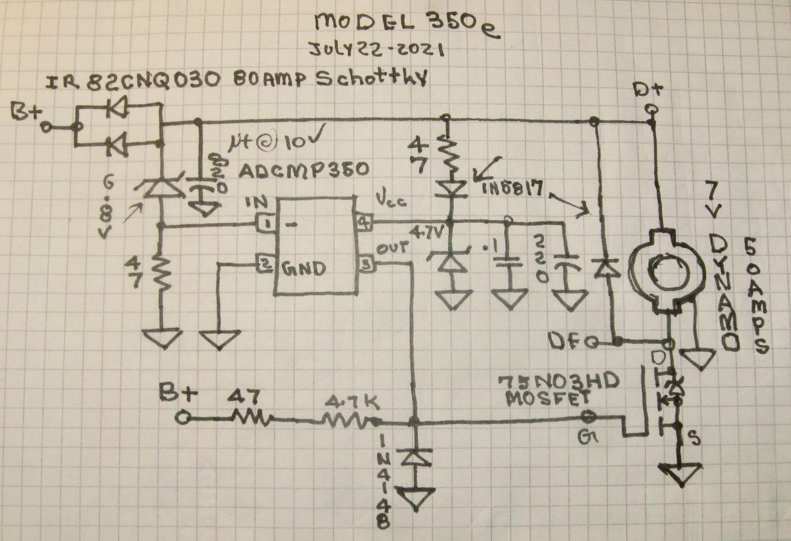

PostPosted: Thu Jun 17, 2021 11:33 am    Post subject: Re: The New 6 Volt Voltage Regulator Reply with quote
Yes and e-bay!
"Beefto" here made a circuit board for the 350 model voltage regulator which has proven to be the best one, the Lt-6700 and some others have not worked as well.

PostPosted: Mon Mar 31, 2025 5:59 pm    Post subject: Re: The New 6 Volt Voltage Regulator Reply with quote
Changed out the 350e 6 volt regulator the other day because of an intermittent over charging problem. I think i found where the MOSFET gate was shorting to D+ but in the mean time I have gone to the 393i 6 volt regulator prototype changing (the i and e) zeners to 2.5V and 7.2V zeners. Here is the schematic for it. This regulator starts charging easier and has the ability to current limit the power from the generator.
