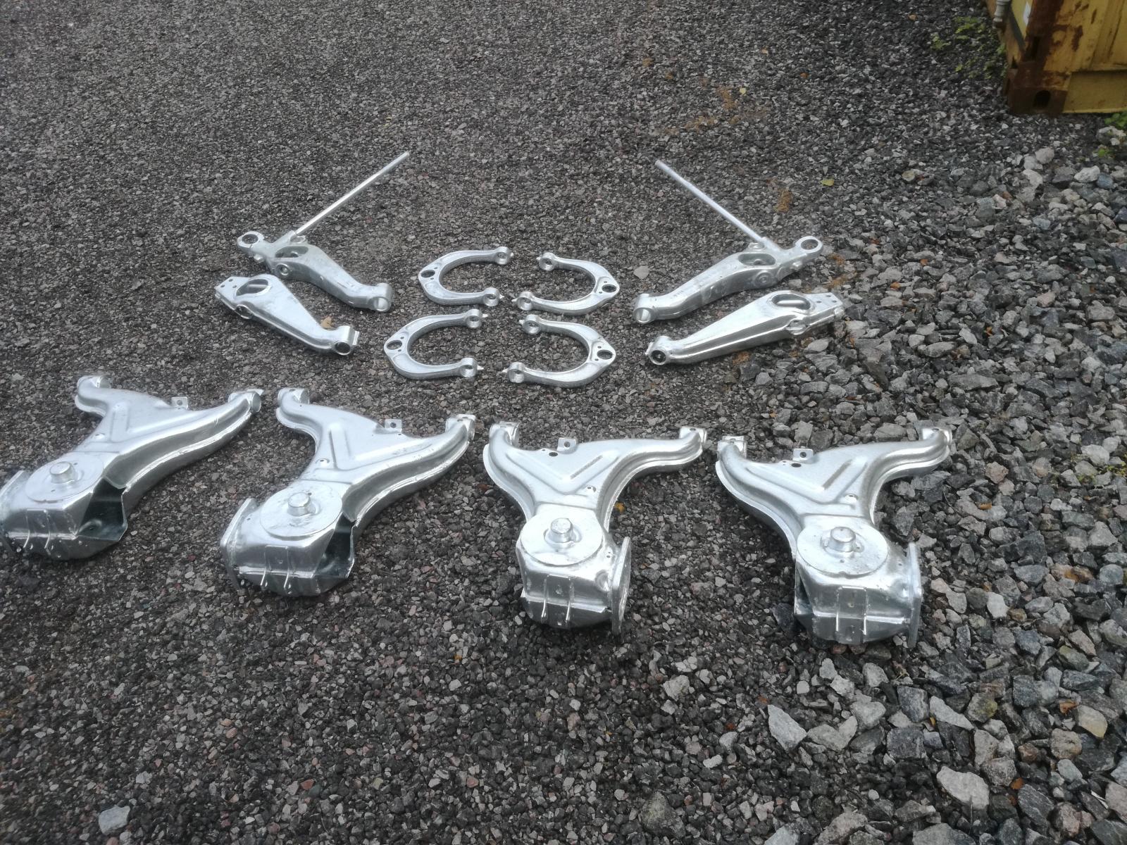

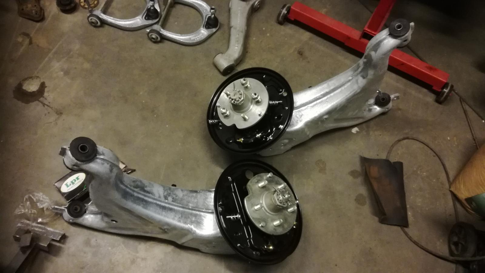

When I Built my AHL TDi syncro I zink dipped the suspension and subframe components. a few pictures of that proses with the parys first sandblasted and then welded where problems arose and then dipoed in melted zink. Well I made two sets back then and today I started to put togather the other set for my Restoration project (The TDi was more of a restomod) where this pipe O have been asking for is also going.

This was the slightly faulty subframe as there had obviously been some shit in the pipes wich boiled out so I have to fix that small misshap, thats the stains on the subframe. The rest of the component are luckily perfect.

Cool project! How did the Hot Dipping of the rear control arms work out? I’ve been thinking of getting this done. How did you protect the threads while you did this? Or did you re-tap them afterwards? Any issues with extra material on the mating surface to the rear wheel bearing housing?

I did not protect the tread in any way but opened them afterwards with taps.
No problems with the extra material, but obviously bearing surrace component where not hot dipped. Busching surfases is quickly rounded of with the sandpaper flap and good was l, rubber givs away. in the front I took it of a bit more as the upper control arms had metal frame buschings. Zink is slippery so it alows for slightly tighter fit so some can be left on the surface.

PostPosted: Sat Mar 07, 2020 7:04 am    Post subject: Re: Osku's Vans Reply with quote
The Bearing housings them self where electro sink plated and then painted. The same threatment was given to the fron upright, as it was a bearing surface. The bearing surface it self was not painted but left on raw electrosink plating and that was just fine. If one would want to zink dip them one would have to re-mill them and even then it might be questionable do you hit the old hole spot on.

PostPosted: Sat Mar 07, 2020 7:07 am    Post subject: Re: Osku's Vans Reply with quote
The company that did the zink dipping said one could also get the sing of the outer threads with heating them with a torch, I did not do this but I gues it could work too. I used the Tap as mentioned.

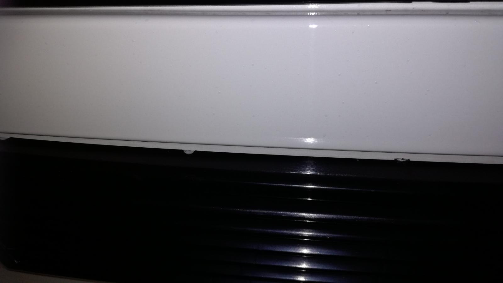

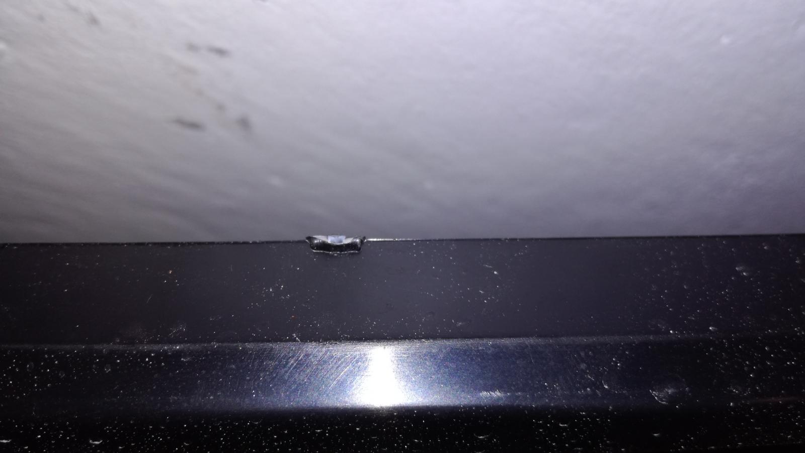

It seems like the lower grils that all the supliers sell for the T3 come orginally from Spain and are of substandard quality. The problem is the injection ports where the plastik is injected in manufacturing are not trimmed nely but rater twisted off. This results in a variyng degree of fault ranging from best case just a white dot to the averag pothole to worst case like in the photo below.
I called several companys in Europe and the all selled the same shit this one came from Serial Kombi.
This aplies only to he lower grill. Theupper grill wich was OEM VW was of superb quality.

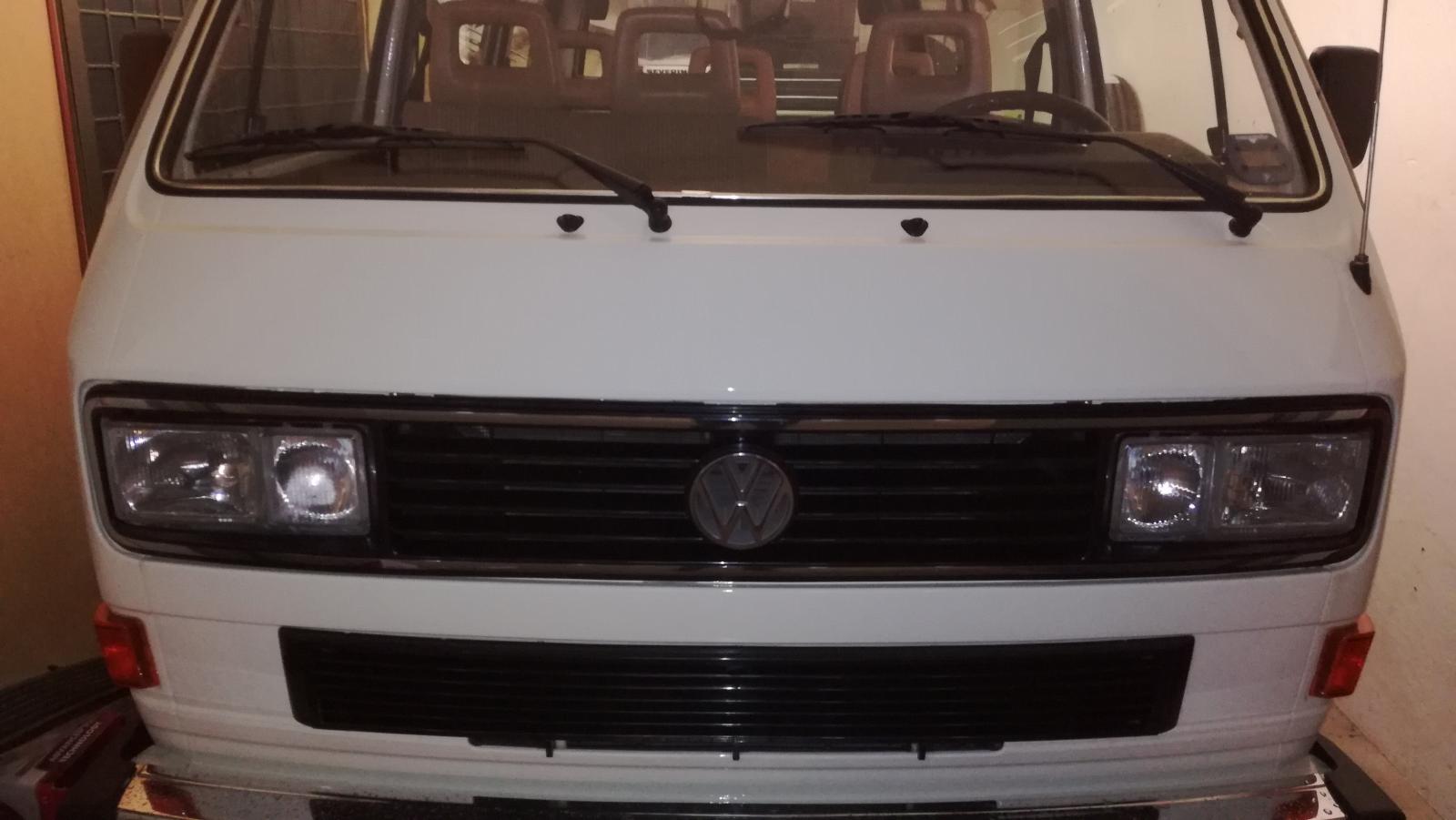

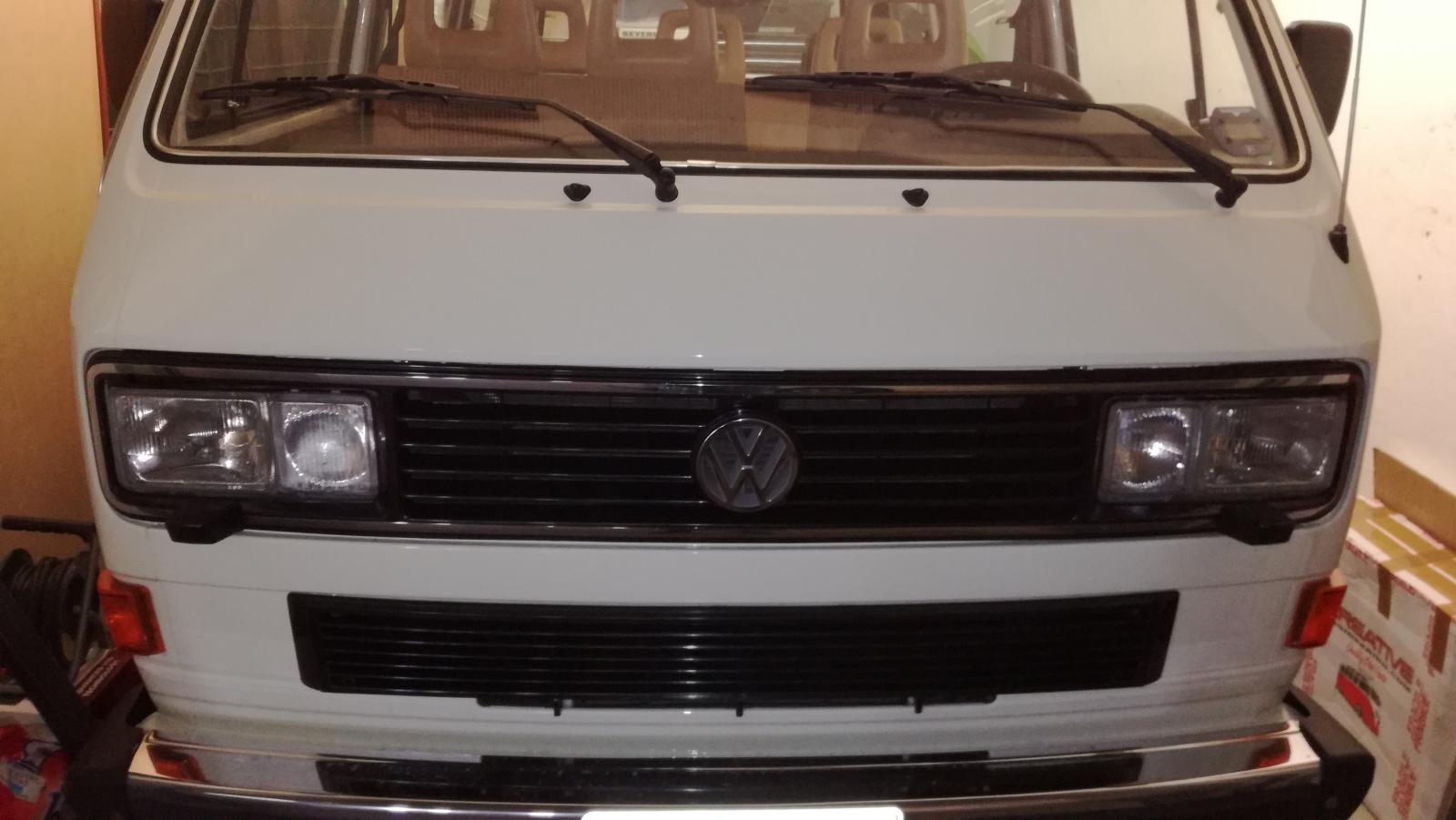

I got the lower grill Touched up today and I also installed the orginal headlight washers.
Yes I know the do nothing but once agin some details that was on the car orginally.

PostPosted: Thu Mar 12, 2020 11:51 am    Post subject: Re: Osku's Vans Reply with quote
Here is some pictures on the problems on the lower grill before I fixed it.
