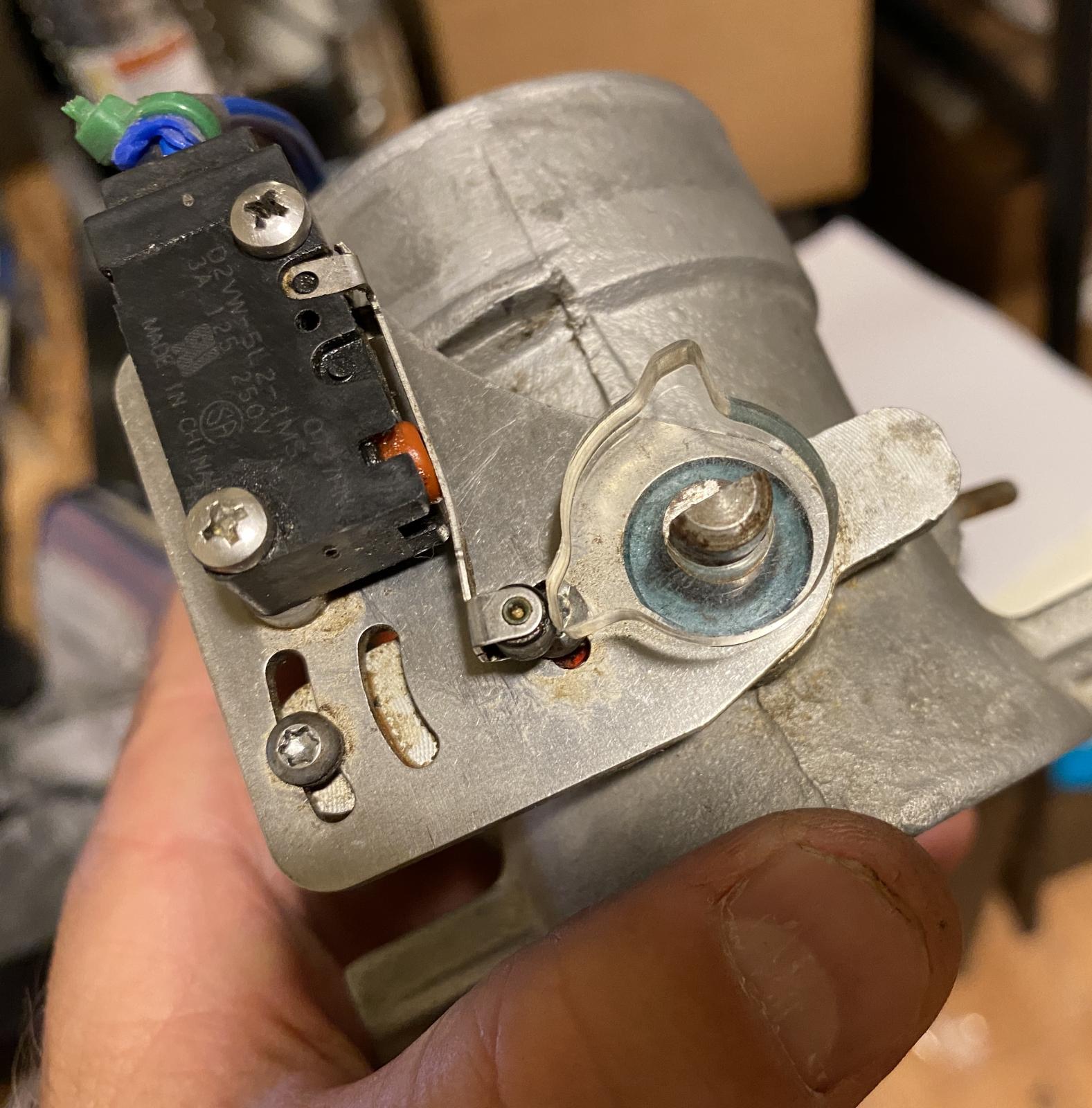

I also have the go westy throttle position switch. I cleaned it, tested and made sure it is adjusted correctly. The plastic piece seems to be 3D printed.
Anyways, should I cover it with something or leave it exposed?

Well crap. The 3D printed part of the throttle position switch from Go westy just broke.
Make a duplicate from laser cut acrylic.

PostPosted: Sun Aug 02, 2020 7:55 pm    Post subject: Re: Digifant fuel pump relay question. Reply with quote
Made my own part.

It was ok until i messed with it. It's possible it fell apart from the throttle body cleaner but i did notice it was not setting the switch when in the fully open position. Should work ok now, at least the switch.
I still need to put the whole intake back together then I'll be able to start the car and see what's going on.
