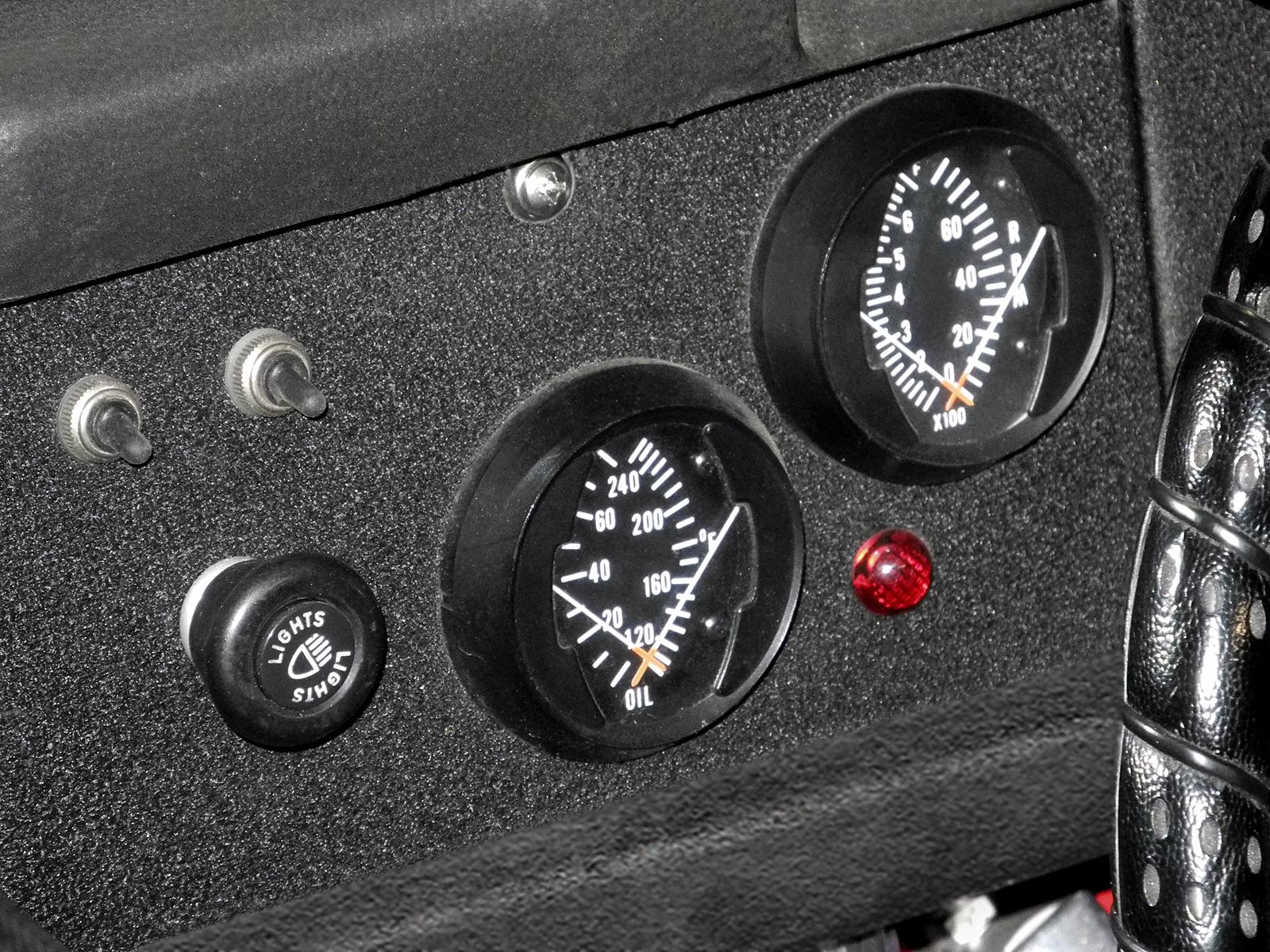

PostPosted: Wed Oct 28, 2020 4:07 pm    Post subject: Re: Any accurate NON digital readout cylinder head temp gauges? Reply with quote
My Westach quad, as shown earlier in this post used a thermistor for OT, a transducer for OP, and a thermocouple for CHT.
Some of the very old Westach quads, seen on eBay from time to time, have two "Amphenol" style connectors on the back; rather than the Molex style pins. I believe these are TSO, but the availability of senders could be a problem, especially considering that Westach no longer supports that stuff.
I wonder if Westach is "on the way out".

Hmmm...., never thought about a different level of illumination.
How did you go about painting the face? Is it an open gauge, or did you disassemble it?
A very sharp permanent marker and a steady hand. The gauge is fully closed, but it's very easy to disassemble.
Here you can see the difference in brightness between the CHT gauge (on the far left) and the rest of them. It's not terrible, but it is definitely noticeable:
When I switched all my dash lights to red LED, I had the same problem with the speedometer- it didn't have the same level of brightness as the rest of the gauges. The solution is simple: just paint the case a reflective silver and stuff more lights inside it, so I'll probably do the same to the CHT gauge as soon as I get around to it.

raygreenwood wrote:
And...the square pattern mounting was difficult for me to get my head wrapped around. I figured if I bought one ...I would trim off the ears and find or make a round bezel.
Yep, that's what I did- trim the ears off the square bezel and fit a round one to it. It was a lot easier to do than I thought it would be.

crocteau
Joined: March 31, 2005
Posts: 1238
Location: Philaburbia
crocteau is offline
PostPosted: Thu Oct 29, 2020 10:11 am    Post subject: Re: Any accurate NON digital readout cylinder head temp gauges? Reply with quote
raygreenwood wrote:
So....since we are on the subject of TC compensation...
https://www.digikey.com/en/products/detail/analog-devices-inc/AD8495-EVALZ/11483518
So...there are 4 models for different TC types. If they can work for what you need....$59 may be worth it. Ray
Just wondering if it would be feasible to use something like this CAN-EGT module https://www.diyautotune.com/product/can-egt-8-channel-thermocouple-interface/ to get the desired thermocouple temperature compensation and drive the gauges of choice? Apparently it's designed for MegaSquirt applications, but the description says " ...send a 0-5 volt signal based on the thermocouple inputs to work with external gauges." Its has eight inputs for K-type thermocouples, but if that's not an issue then it might provide more bang for the buck (350 vs 8x59=472). Of course it's more satisfying to personally fabricate something useful Cool
I'm with you on the scale graduations, and for me the lighting kits work fine in the custom combinations that Pete at Westach can set up.

raygreenwood wrote:
Very nice!
So what gauges are we looking at in your pictures....from left to right?
Ray
Thanks, Ray! With apologies to the OP for stretching the topic, if you think it may be applicable to the accuracy question, and if you have time to consider it, I'd appreciate your thoughts on use of the diyautotune CAN-EGT to drive non-temperature compensated gauges, maybe with a trimpot to set the signal level. I can do the simple arithmetic for ambient cold junction correction in my head, but it's taking longer as time passes Wink
Westach: CHT/EGT, Oil Press/Temp, Fuel level/AFR, Amps/Volts, Tach.
Details are clearer if you zoom in on the daylight photo below.
