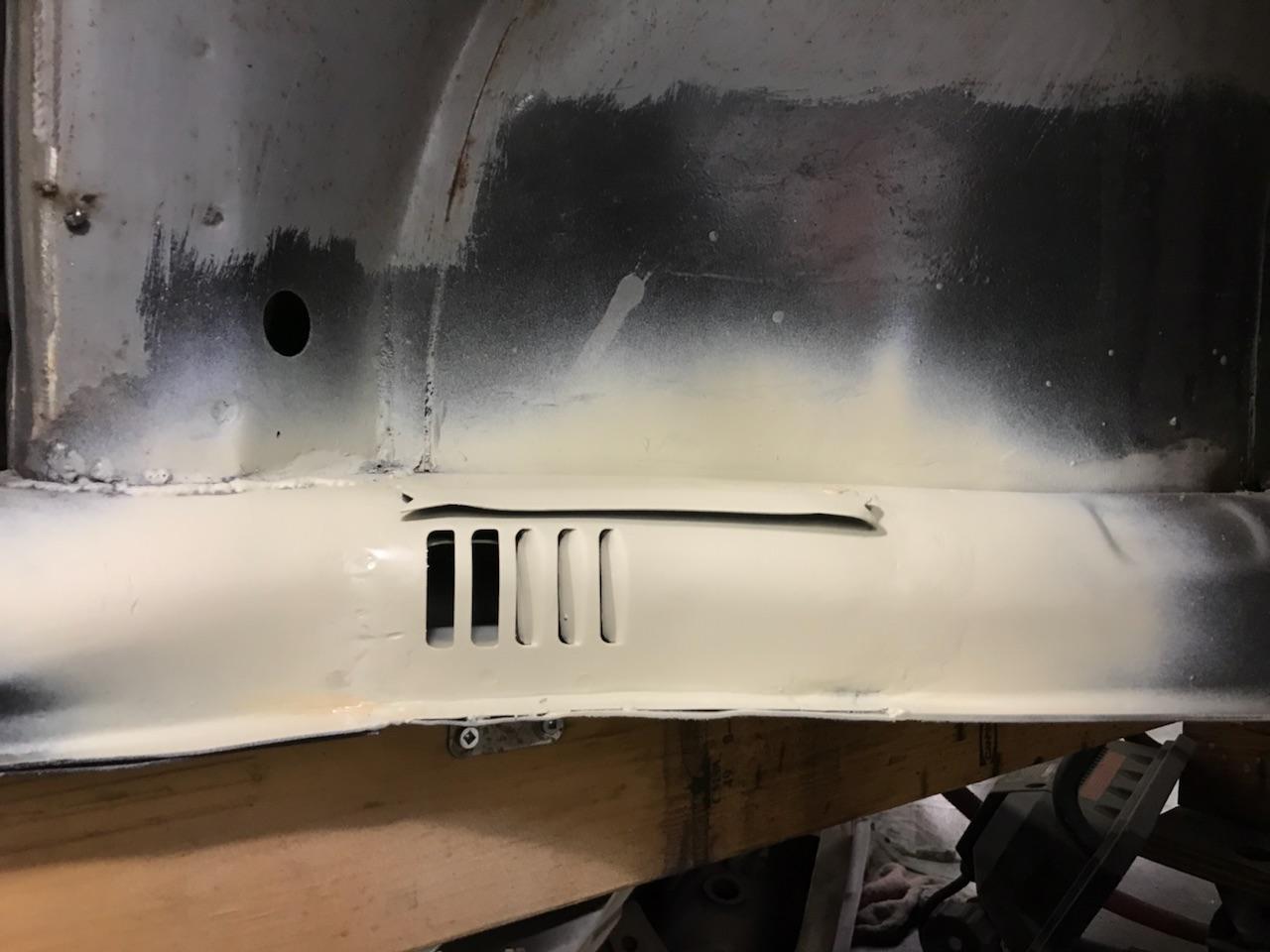

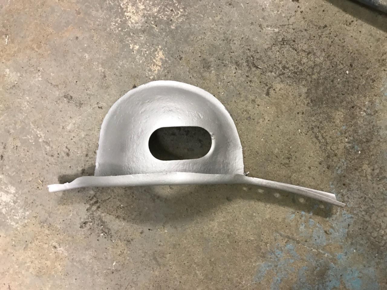

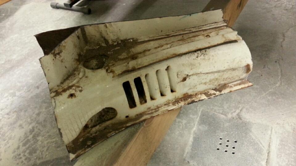

Now to get to work on making the driver's side Klokkerholm heater channel look more like a German one! This was installed by the previous owners. First step was to cut out the boxy, late model looking stamping and graph in a nice rounded panel. Much better !!
Unfortunately the pressings for the heat vents were also all wrong. Gotta fix this. I found a guy in California who was able to cut a donor section from a dry car and ship it to me. Geoff graphed it in and now it matches the passenger side. Small details but I might as well address this stuff now since I’m in so deep anyways.

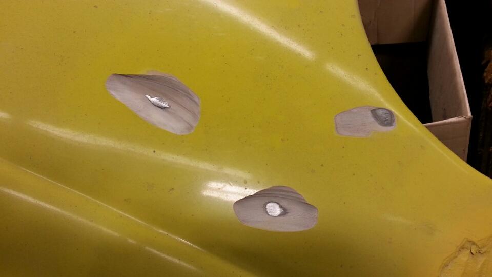

I've had a pair of semaphore posts stashed away for years. Decided if I'm ever going to use them on something the time was now. You can see that I also asked him to weld up the small door handle holes so I can run ice pick handles :

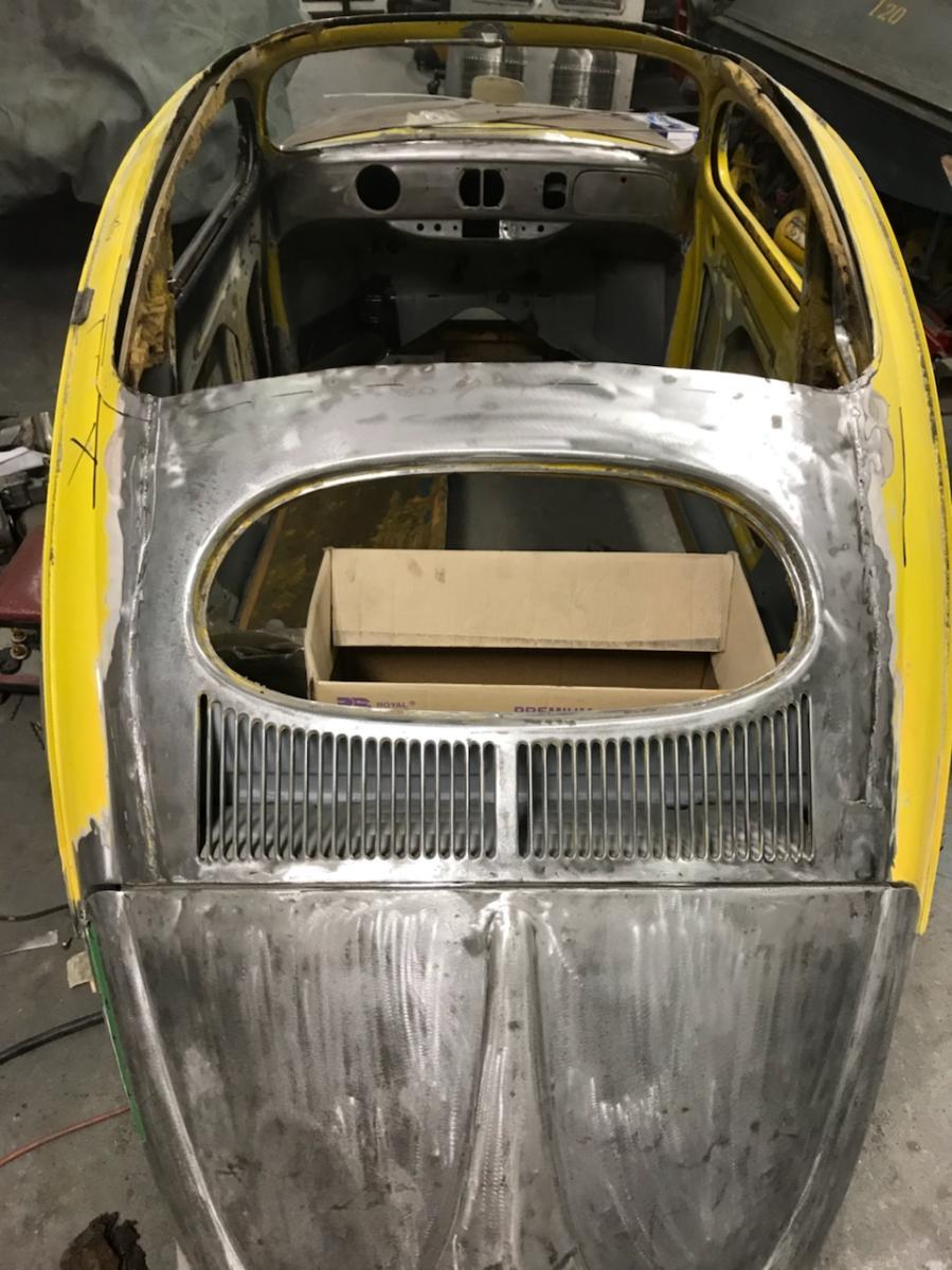

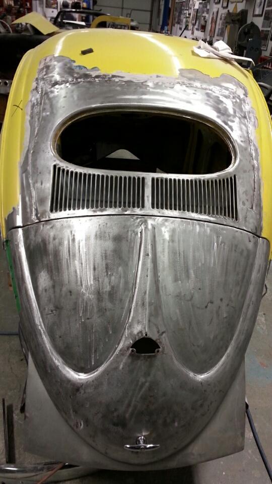

PostPosted: Fri May 13, 2022 4:56 pm    Post subject: Re: 1964 Chop Top Build Reply with quote

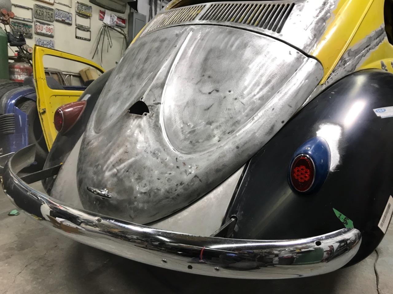

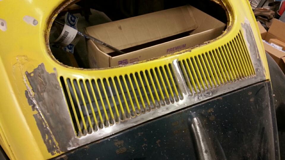

Geoff doing a little smoothing out of the deck lid and test fitting. At this point he has also cut apart my doner rear window clip and replaced the panel in behind the fresh air intake louvers :

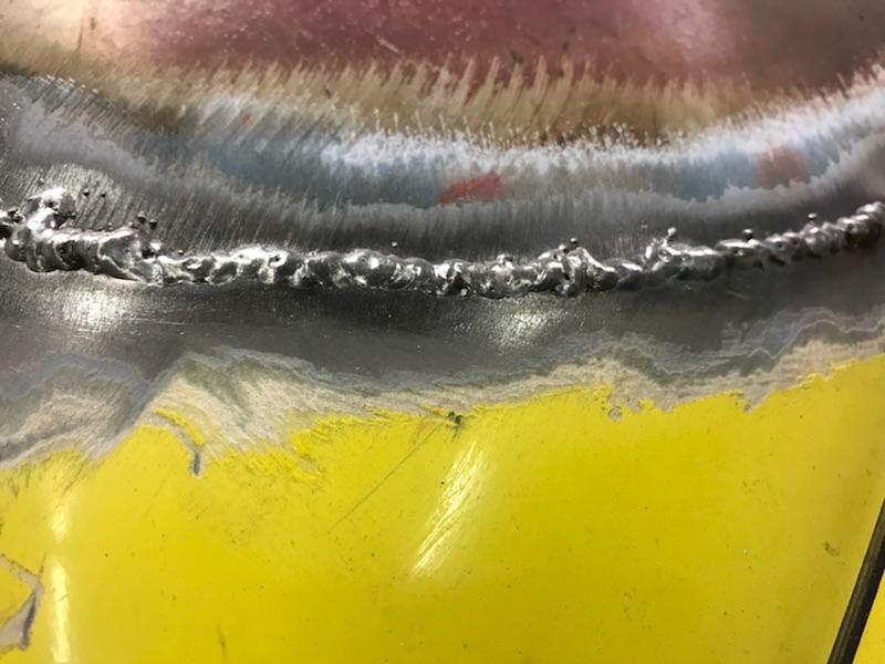

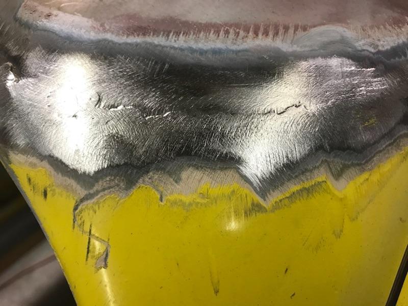

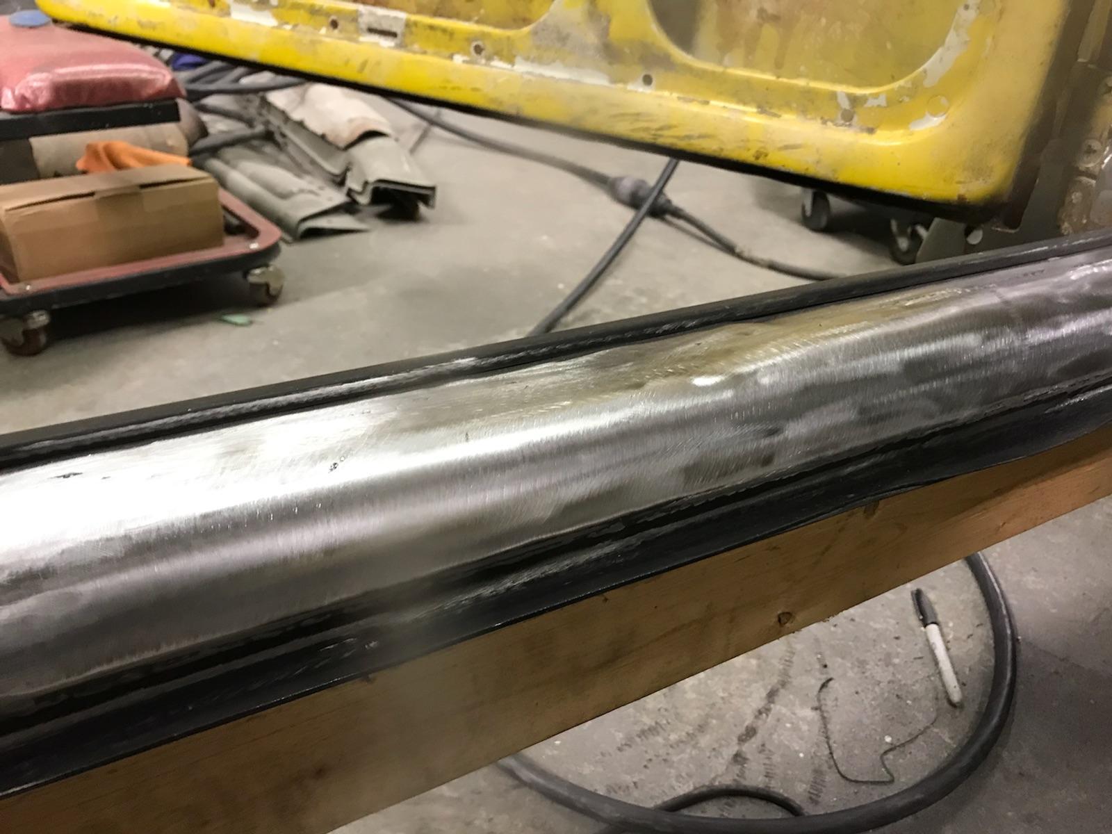

Early January of 2018 - Geoff has been grinding away the bondo to see what lies underneath. Cleaning up the old welds and drilling out old pop rivets.
Turns out everything was originally gas welded.
The bondo was a good 1” thick in some areas of the roof but we both think Clarence went way overboard with it. It just wasn’t necessary to have it that thick – good news! The metal still looks pretty ugly underneath. I’m not going to ask Geoff to cut it out and replace it. Lots of work and money. I’m going to wait and see that the body shop says when they see it (whoever that might be).

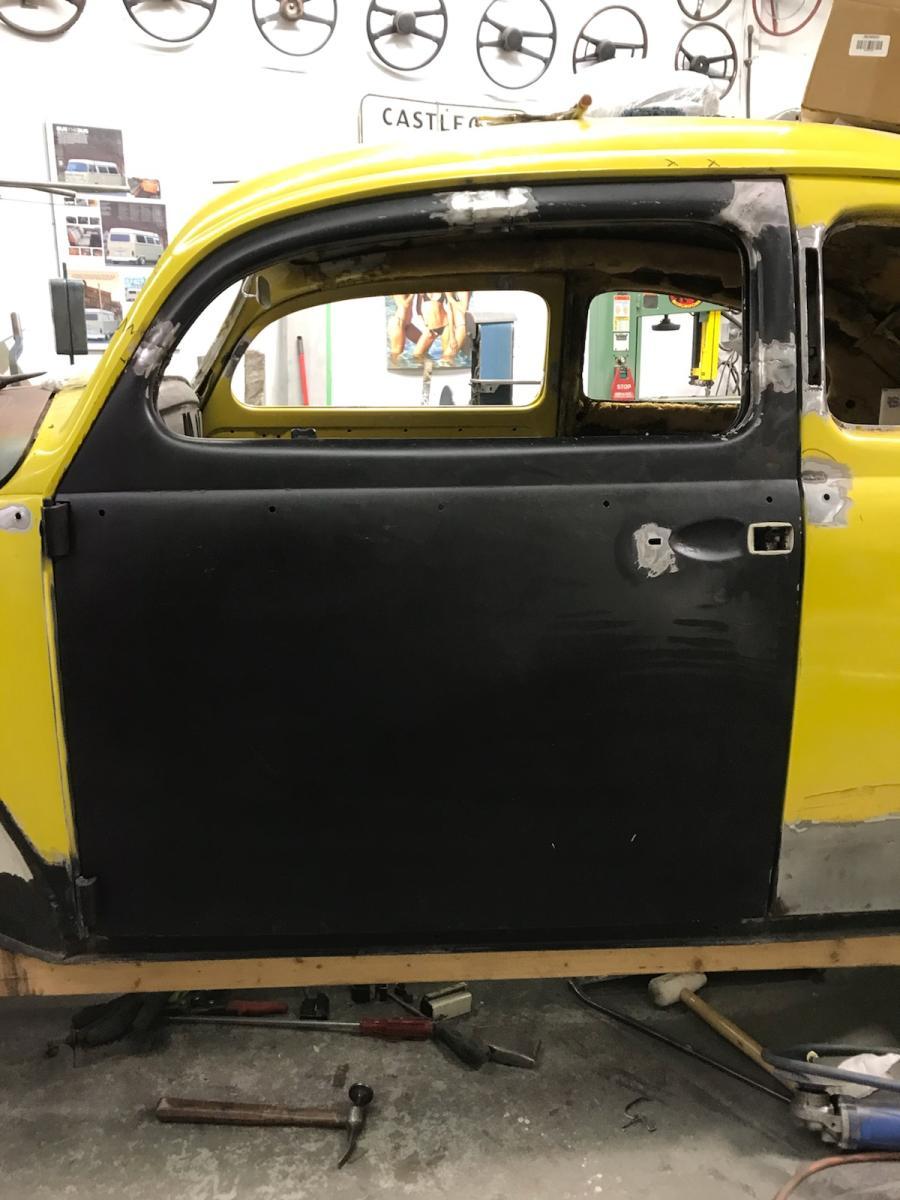

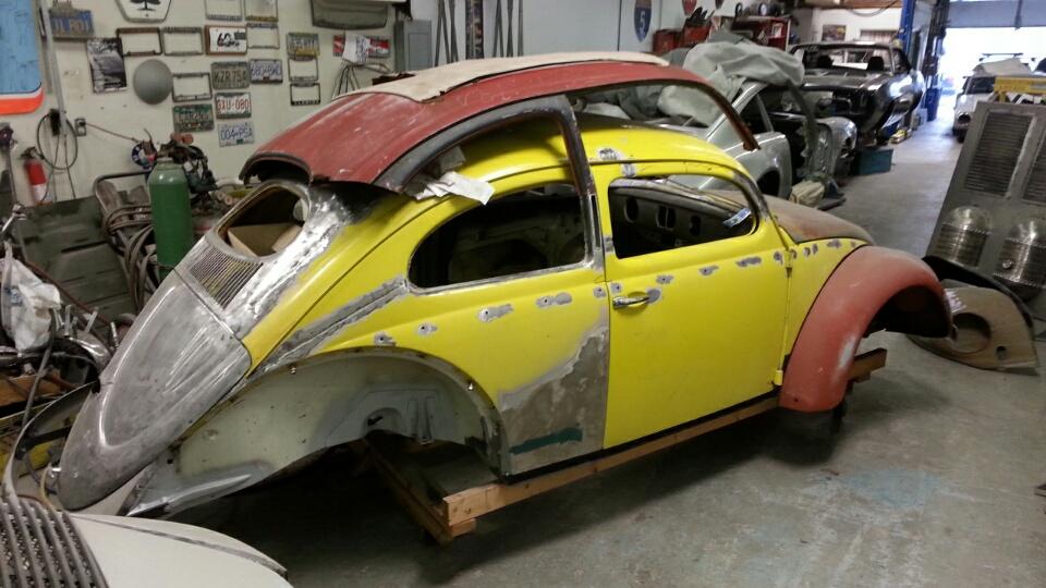

Someone got carried away with the bondo on the passenger side door! Geoff did some cutting, sectioning and welding to create some better door gaps.

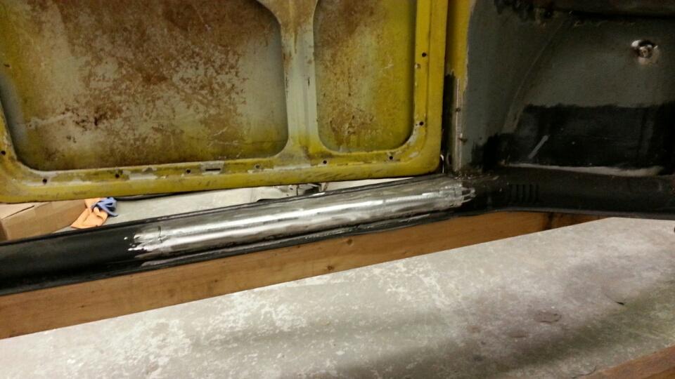

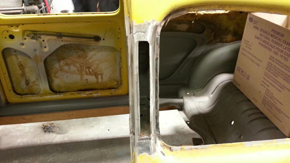

PostPosted: Mon May 16, 2022 9:45 am    Post subject: Re: 1964 Chop Top Build Reply with quote

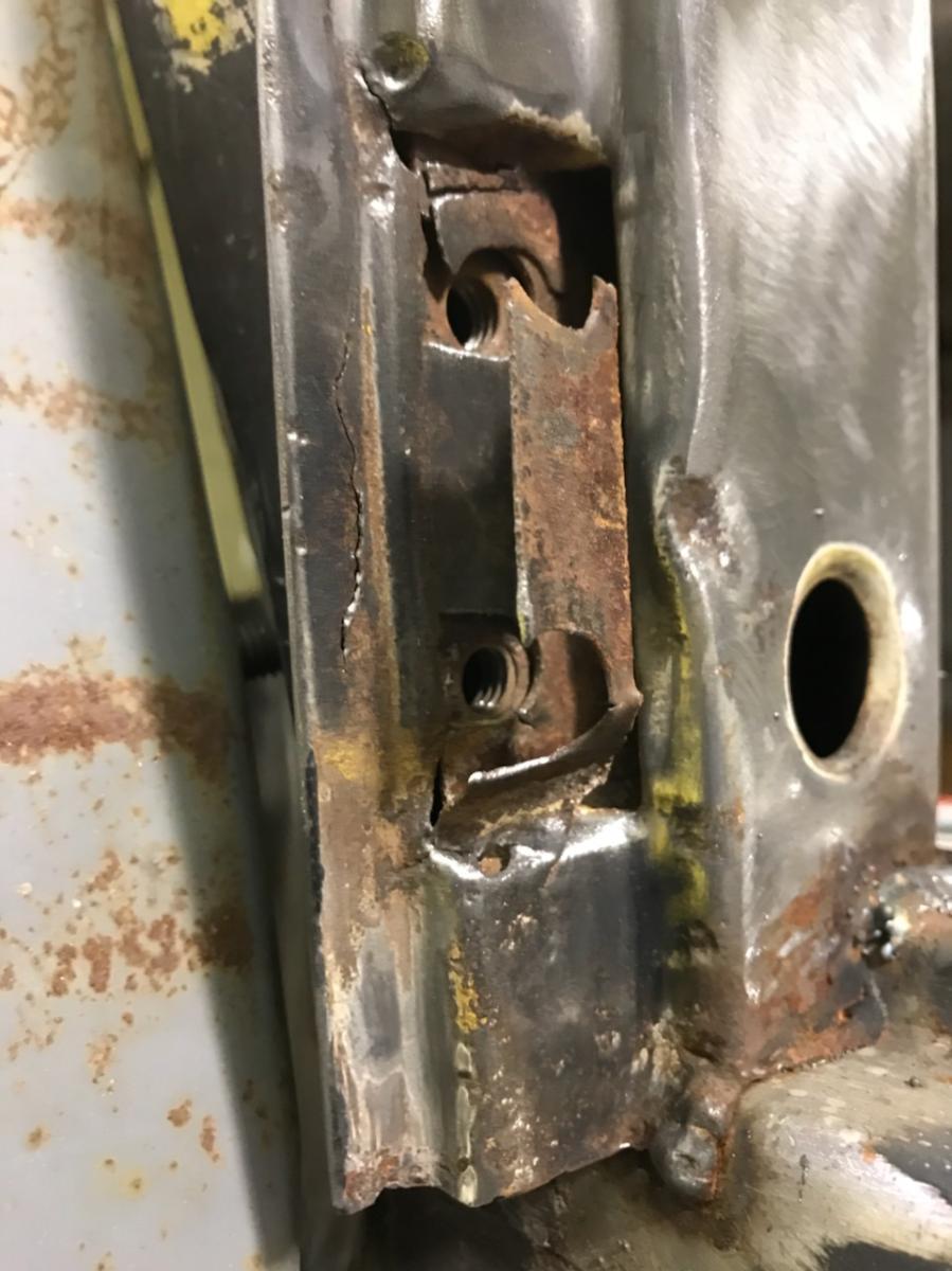

The lower A pillar on the body was in rough shape too. Yuck!
Had major issues with the driver’s side door… had to replace it! Lower hinge on the door was buggered up and the door was thick with Bondo. All solved now. I had to get 2 new doors so that he could build a new one. He said it was easier to replace compared to trying to fix the original... and Geoff’s welding is way nicer!
Geoff also replaced all of the door hinge pins on both the left & right sides. Man… I couldn’t have picked a more difficult car to build! Lots of hours going into this = lots of $$$

As mentioned earlier, because of the way the roof was chopped, the roof now sits lower into the engine compartment... essentially making the engine compartment size smaller. This means fan shroud clearance issues with the stock deck lid hinge mounting brackets. When Clarence chopped the car, he just hacked away at the stock brackets so that they wouldn't hit the shroud. They looked terrible.
Instead I decided to buy a pair of thin custom ones from Limebug in the UK https://limebug.com/product/t1-beetle-single-piece...nd-off-pr/
This should solve the problem going forward.
Other problem is that I can't use the stock deck lid spring anymore - there's no room for it as it'll hit the fan shroud. I'll have to utilize a custom prop so I bought this one from Joe Bence

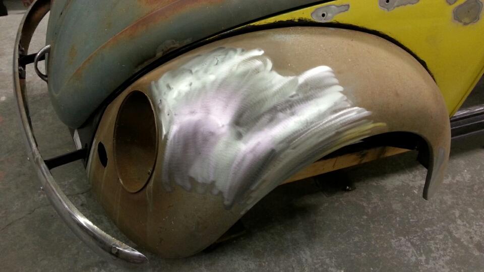

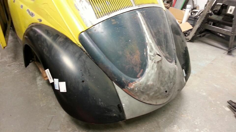

Some work done on the NOS fender. Turn signal hole welded up, some dents pounded out and sanding off the years of surface rust.

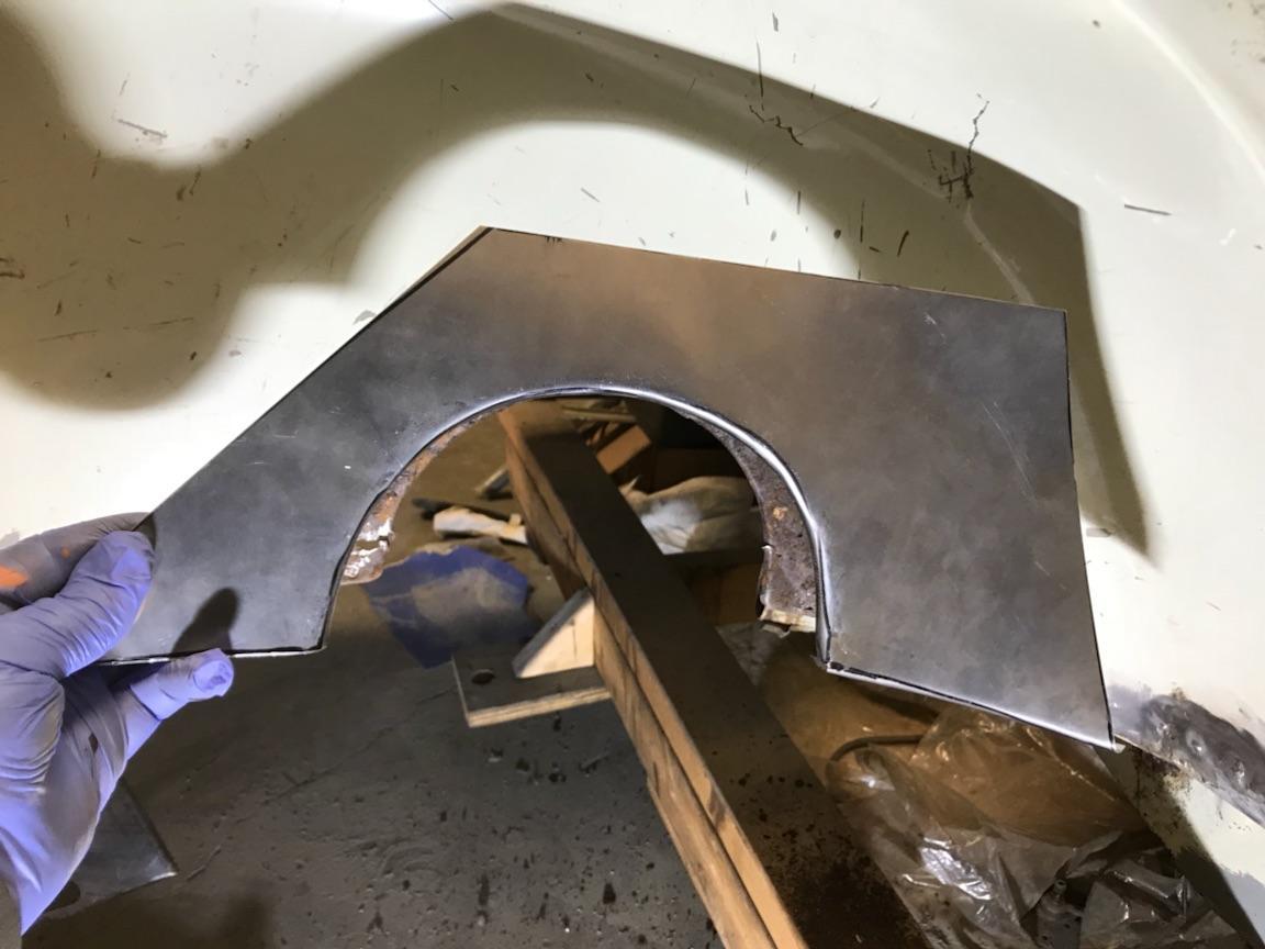

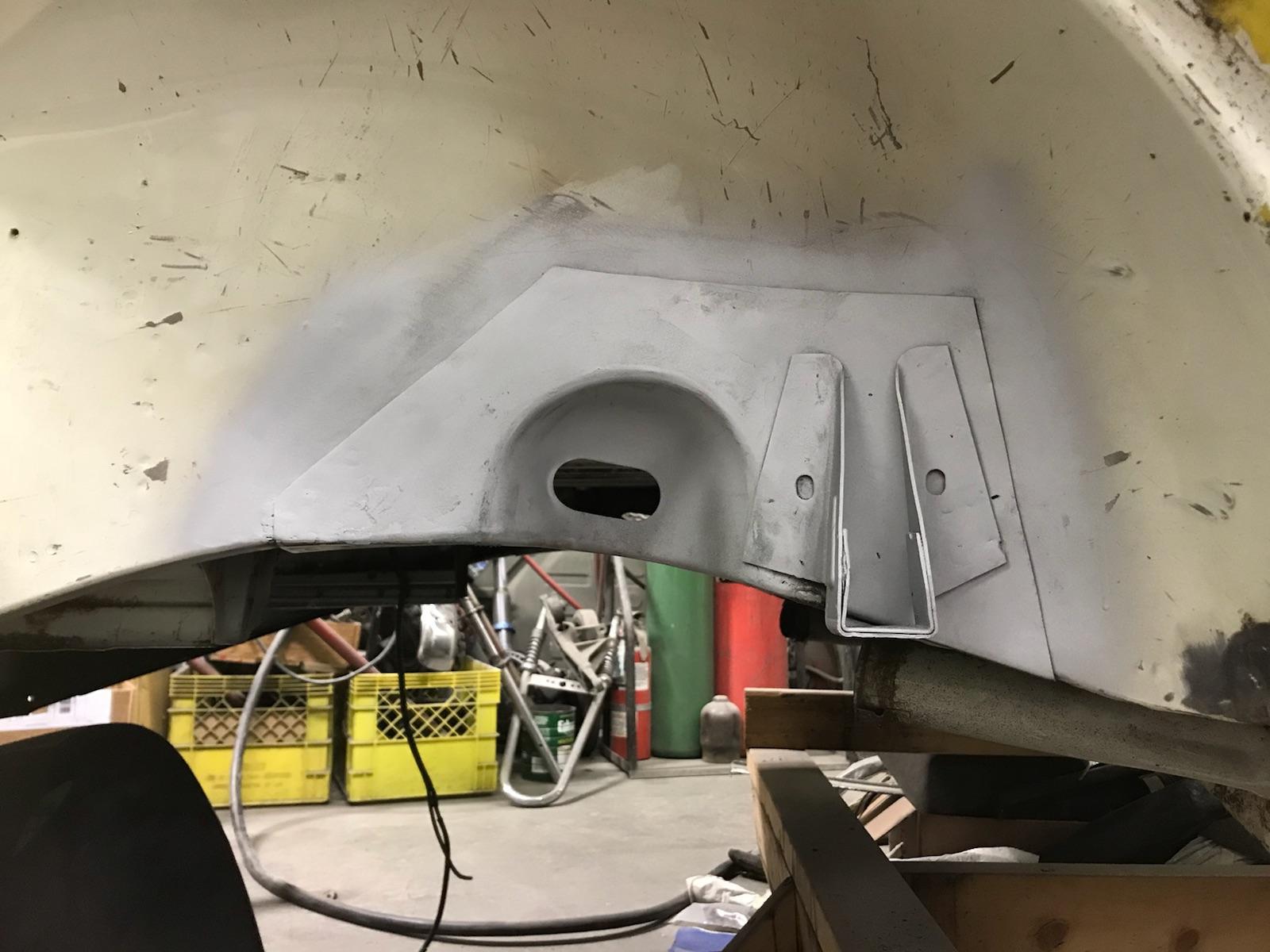

PostPosted: Mon May 16, 2022 2:19 pm    Post subject: Re: 1964 Chop Top Build Reply with quote

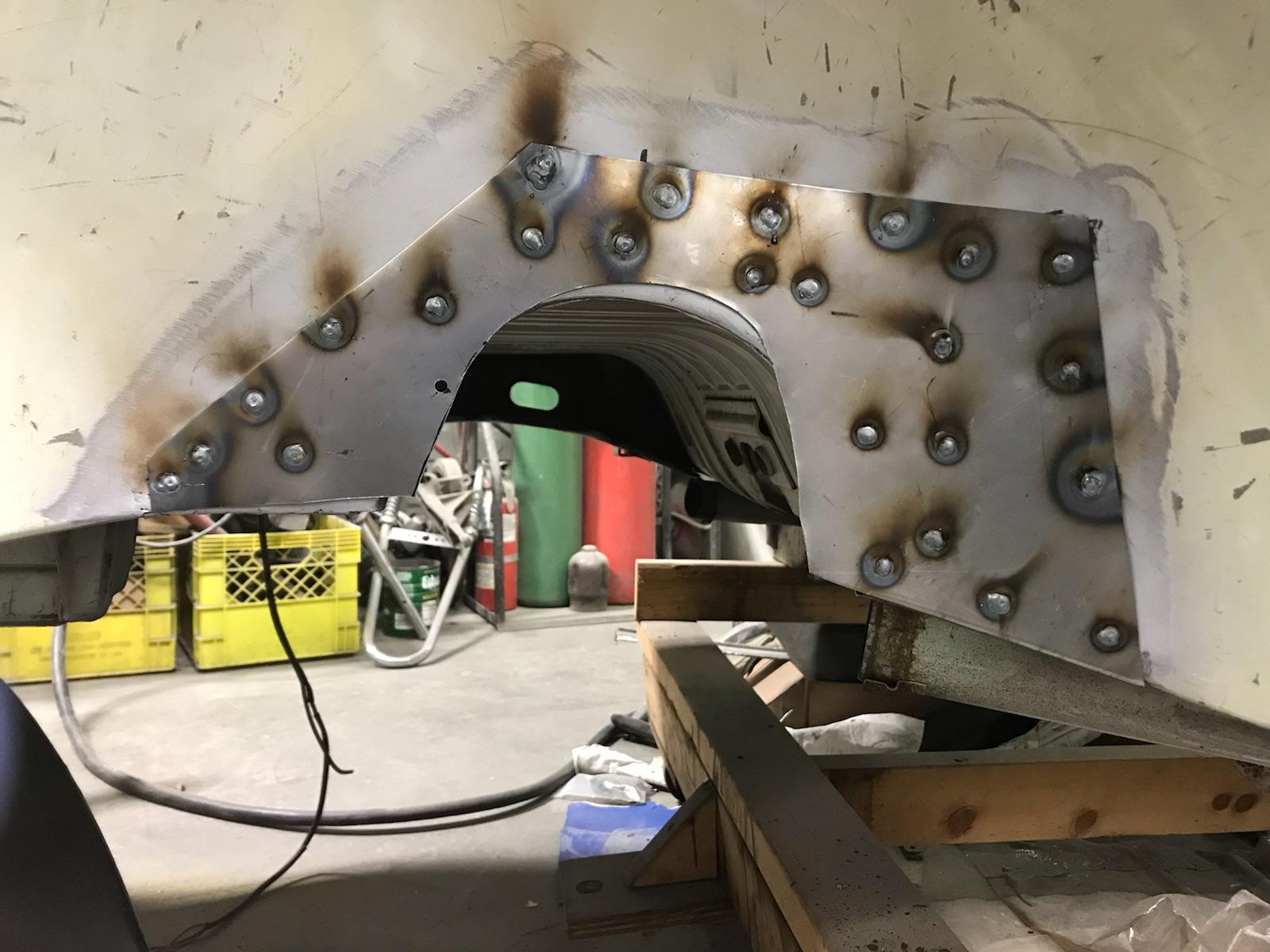

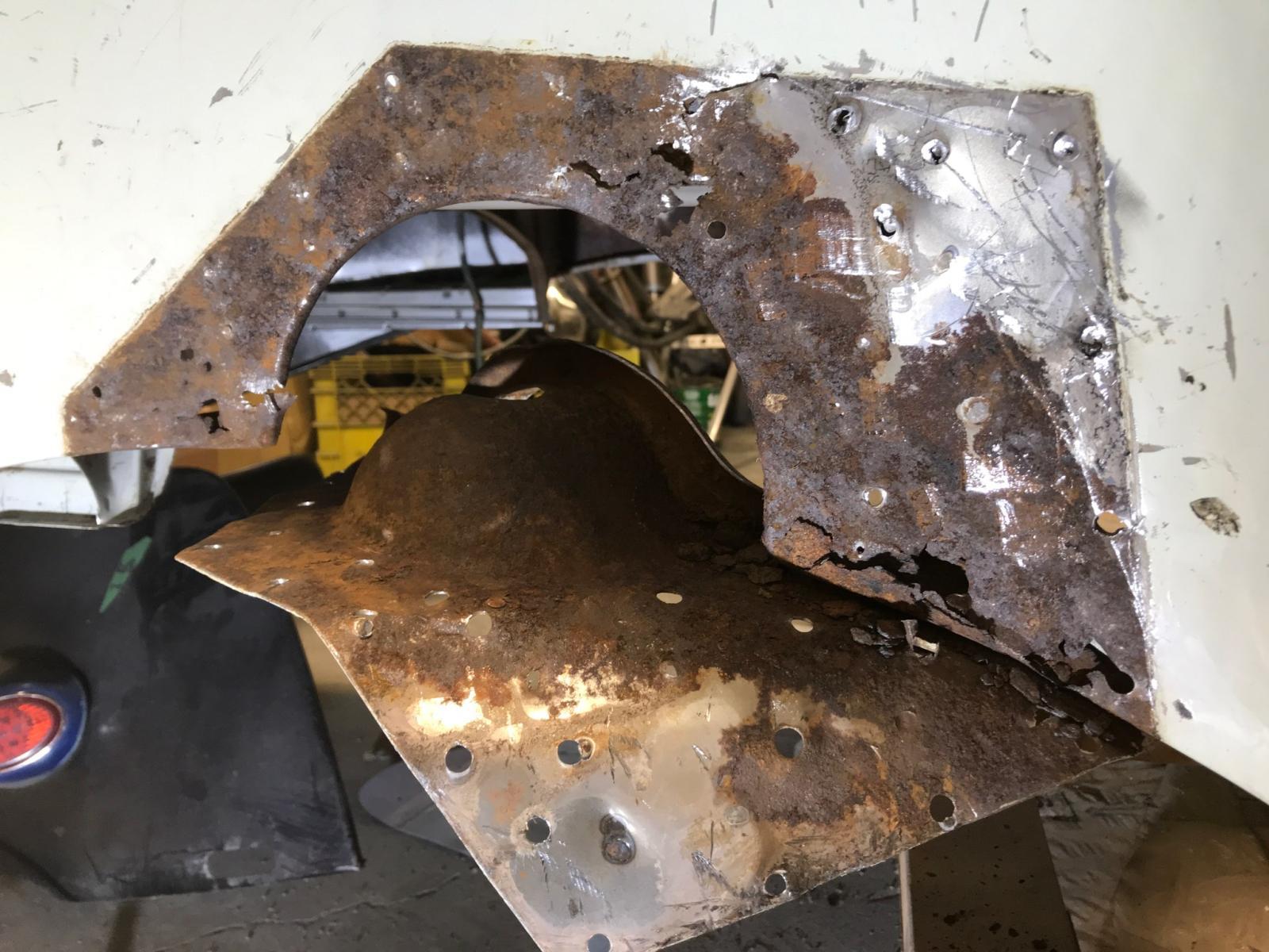

Geoff emailed me photos of the right rear inner fender well / body mount. It didn't look too bad at first - just a small amount of rust peeking out. I gave Geoff the green light to tear into it just to make sure things were solid. Surprise surprise! Ugly rust lurking beneath the factory layers of metal. Geoff fabbed up a replacement panel and made it all solid again.

banana split
Joined: January 22, 2002
Posts: 1130
banana split is offline
PostPosted: Mon May 16, 2022 2:20 pm    Post subject: Re: 1964 Chop Top Build Reply with quote
Same problem on the left rear... out with the old in with the new.

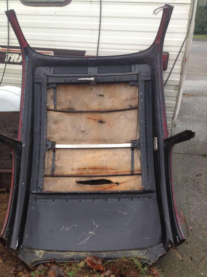

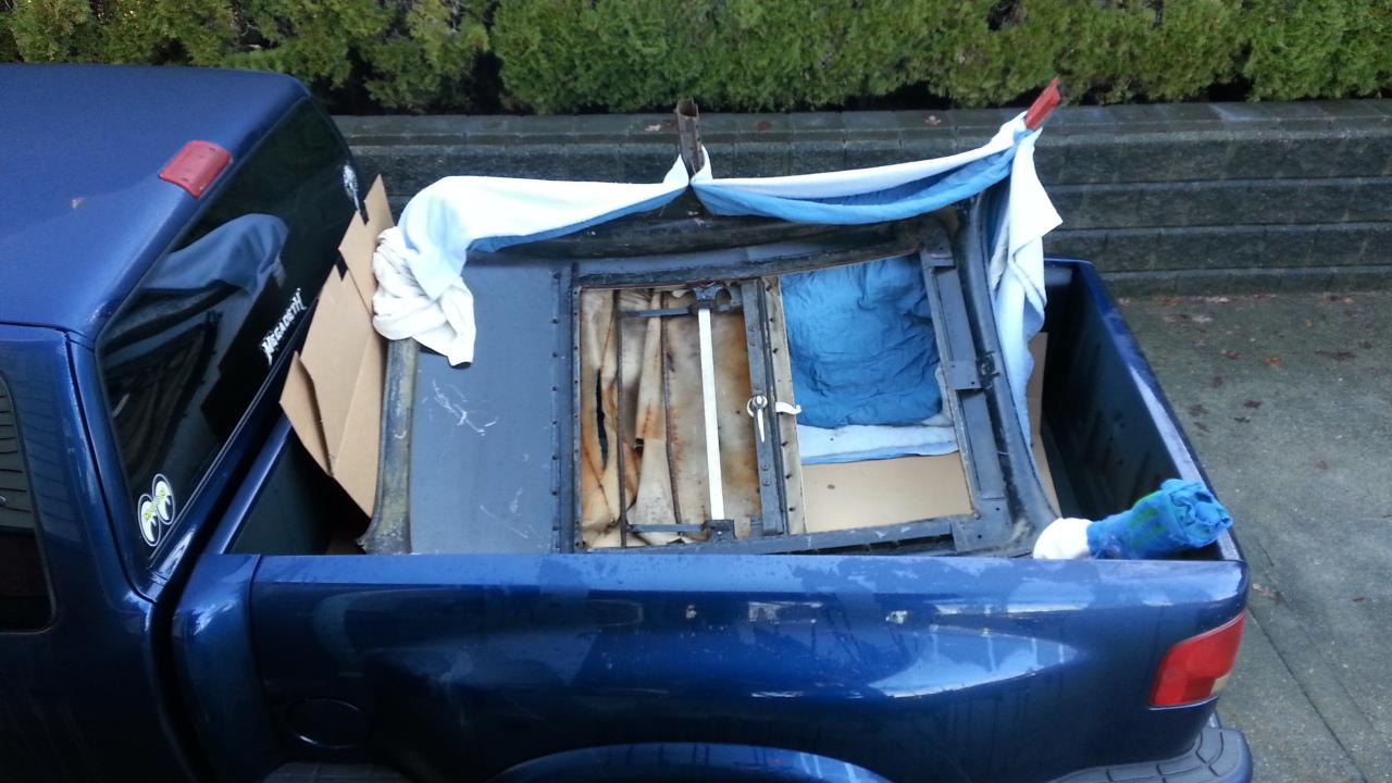

While visiting with Geoff and the Bug he says to me : "This thing would look wicked with a sunroof. Hey! Now's the time if you want to do it". I was like, ya it would be super cool but where the heck am I going to find a sunroof clip around here? The supply of used VW parts has dried up big time where I live. It all disappeared in the '80's and '90's.
Probably a week or 2 later this pops up for sale on Craigslist! And it's in the town where I live of all places !!
My Beetles :
1953 Zwitter
1964 Chop Top
banana split
Posts: 1130
PostPosted: Tue May 17, 2022 9:36 am    Post subject: Re: 1964 Chop Top Build Reply with quote
So I saw the Craigslist ad Thursday evening and sent Geoff a text Friday morning : “How serious were you about installing a clip? Is it something you can actually do?”. He said yes, go for it.
$400 later it was mine. Loaded it up and dropped it off at Geoff's shop on Sunday.

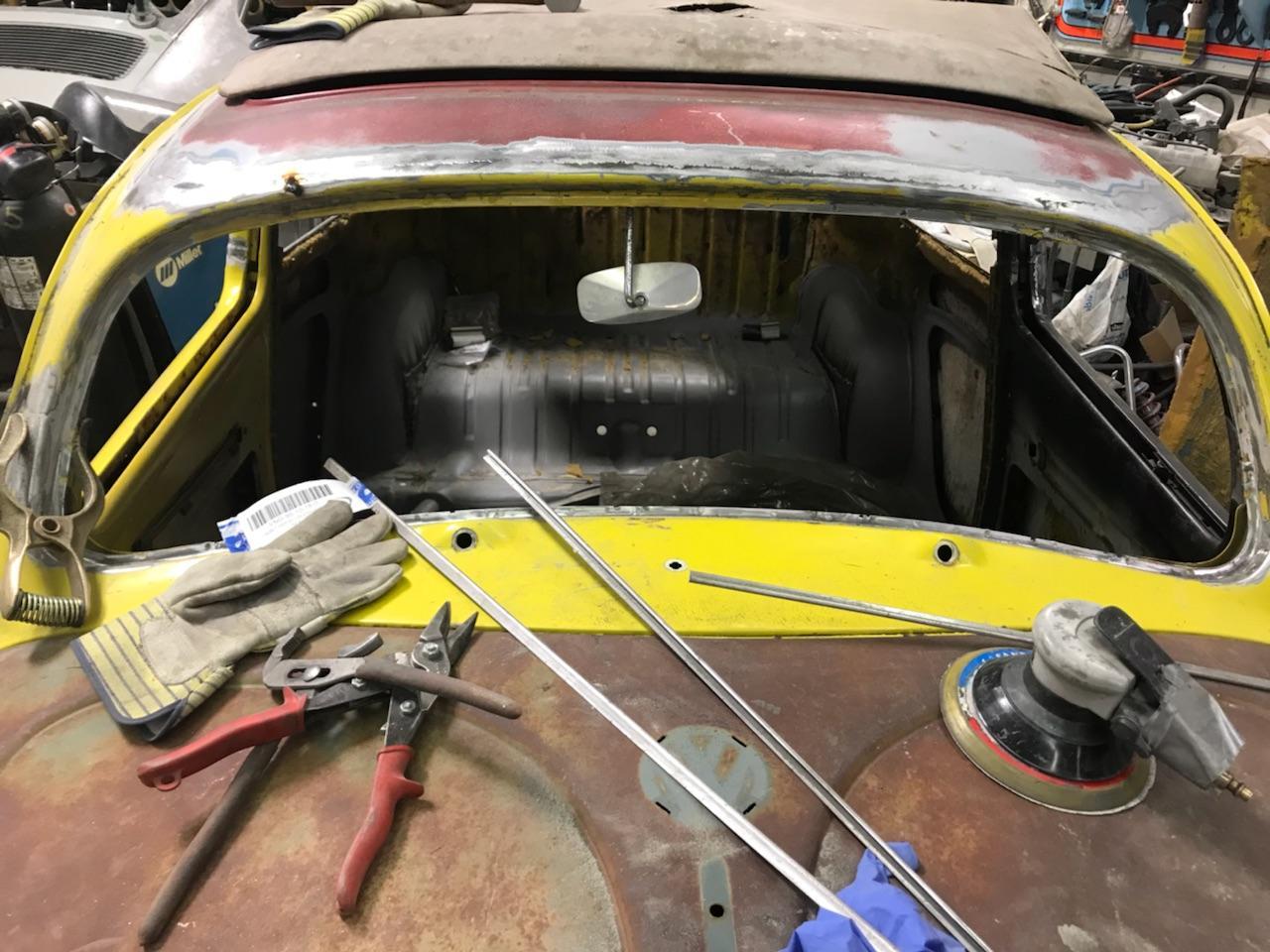

OK, moving right along... I dropped the clip off with Geoff on a Sunday and come Monday I get a text from him with some photos :
Geoff works fast !!
