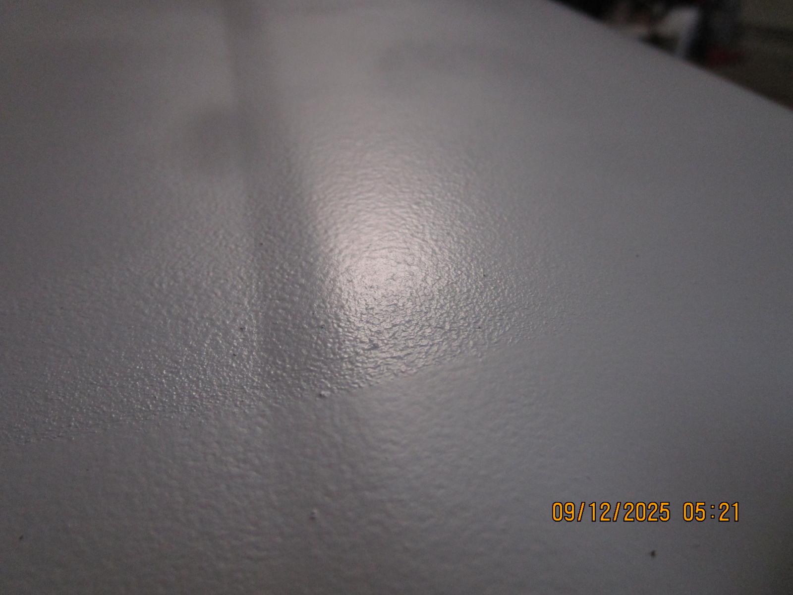

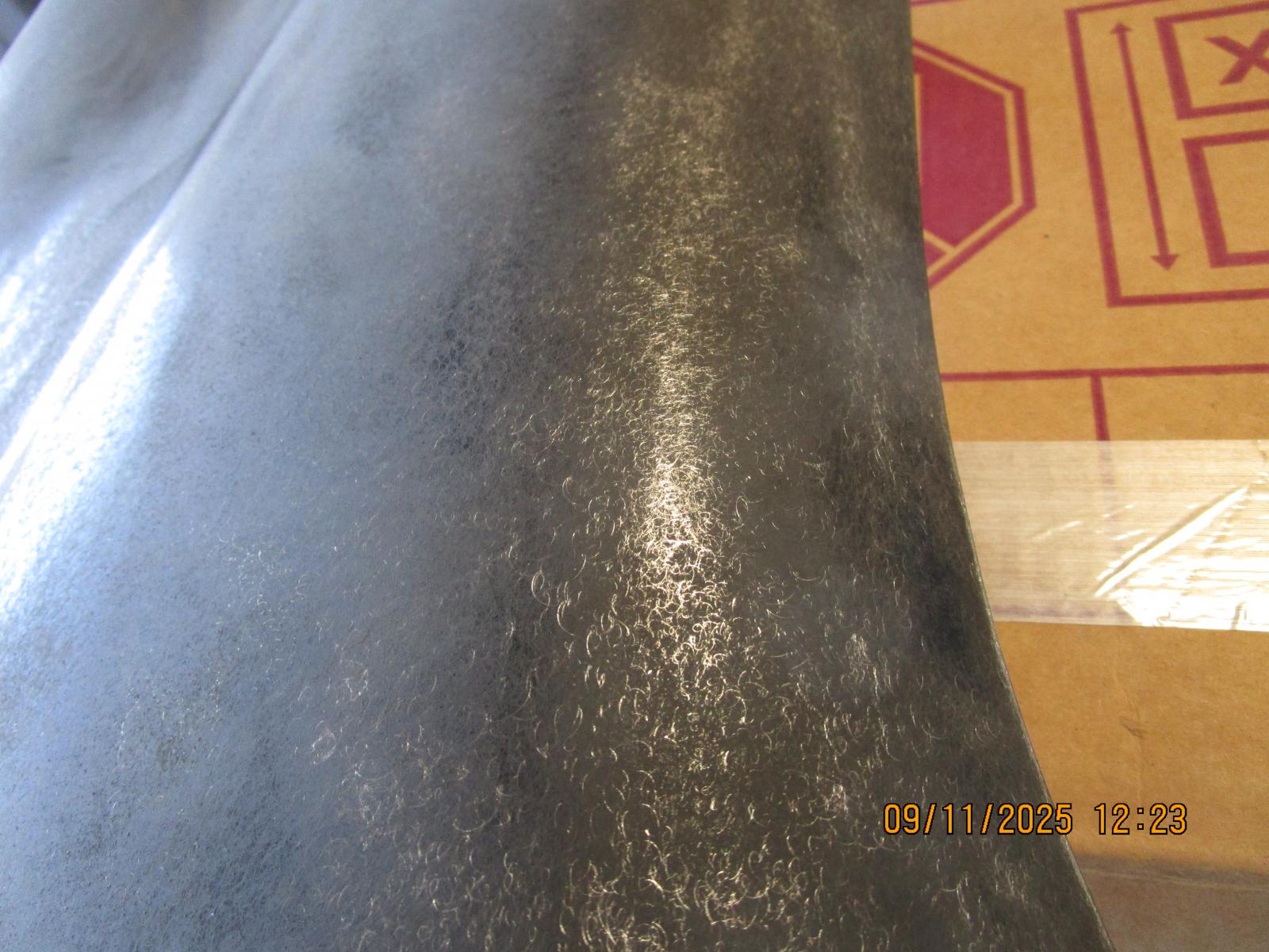

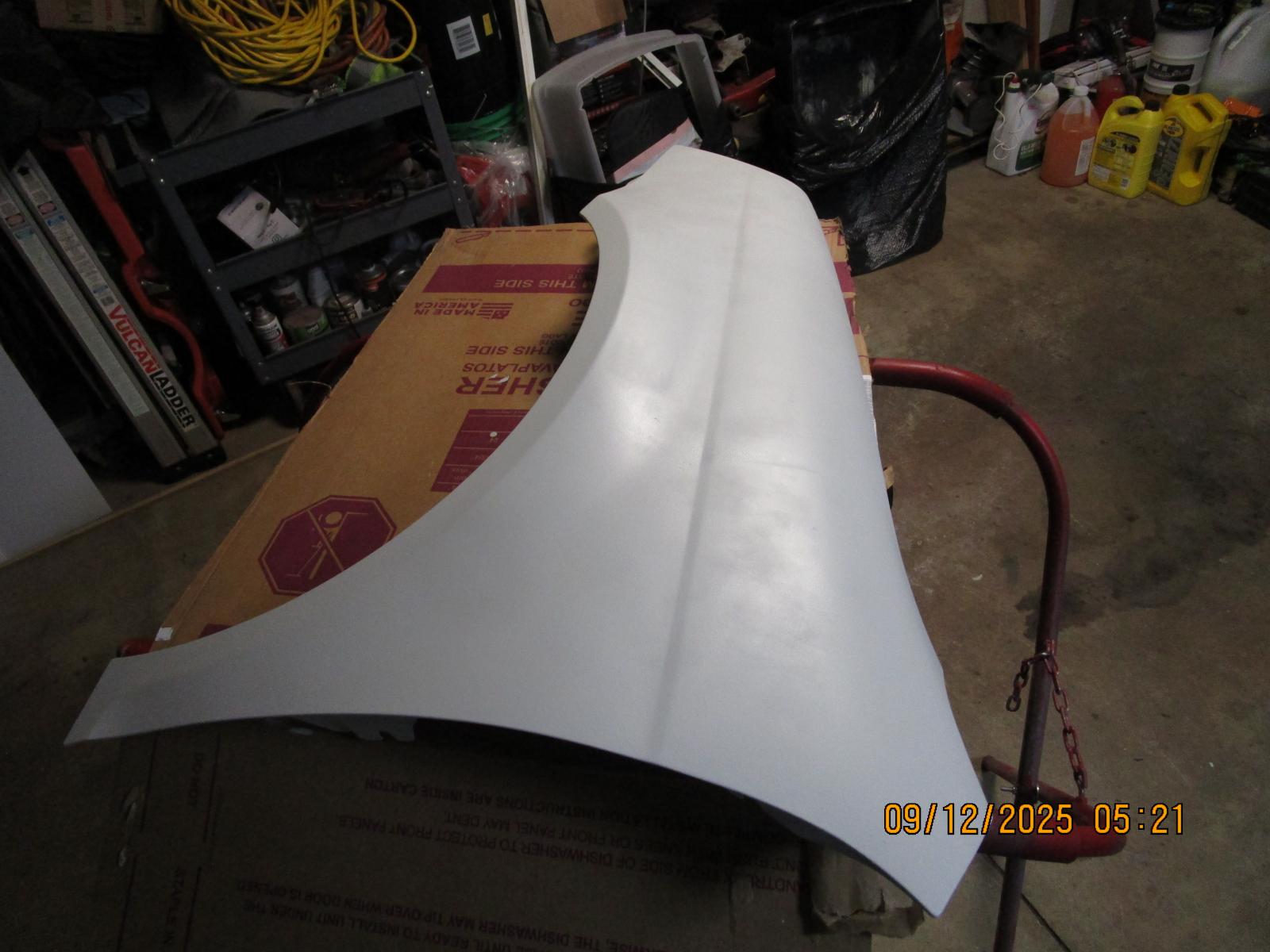

PostPosted: Fri Sep 12, 2025 7:06 am    Post subject: Re: 1967 Squareback- starting the journey for a proper DIY paint job Reply with quote
Photos of my epoxy primer application yesterday. I ran a 60 grit disc on my random orbital to scratch it up enough so the epoxy could get a grip past the black "shipping primer". Wiped it down with wax and grease remover, and then proceeded to roll on the Raptor brand epoxy. Its what I had on hand. I think around 3 coats, I did not bother pouring the paint in the tray, I just poured small amounts of paint on the fender and then rolled it on. I mixed up 5 ounces, I think I might have had one ounce left in the cup after 3 coats on the outside of the fender, and one coat of epoxy on the inside of the fender (using a foam brush).
I will run over it with some wet or dry and knock down some of the texture and ugly spots, then roll on some high build.
Doing this really doesn't save you any time, you are trading one kind of work for another. Instead of using a gun that needs cleaned, and putting plastic over stuff to protect from overspray, and all the other things associated with spraying paint, you will be sanding this texture down instead. I run 6 inch wet or dry discs on my DA, spritz it with water and it knocks down pretty quick. This photo shows what I think is the worst case texture that will need sanded down.
