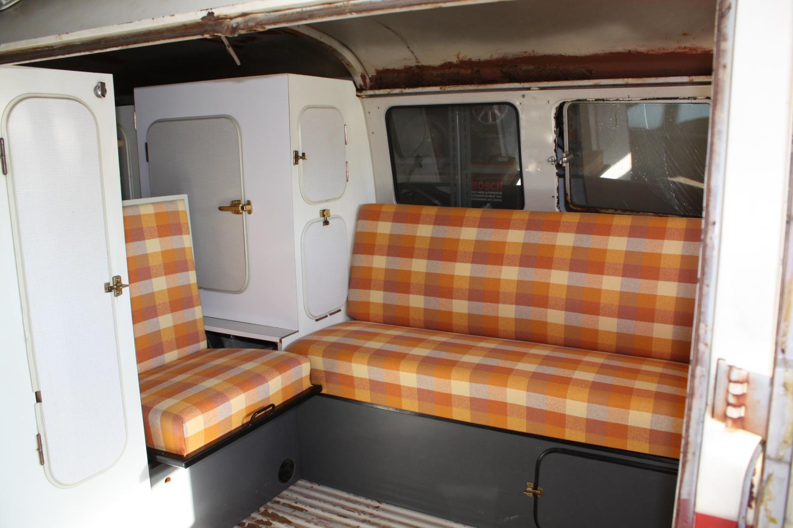

BarryL wrote:
Not to butt in but isn't this it?
That is the rear center seat, but without the steel frame to hold it in place. Kind of like having the front upper flip seat, but no flip seat arms.
Below shows seat in the frame under it:
Without:

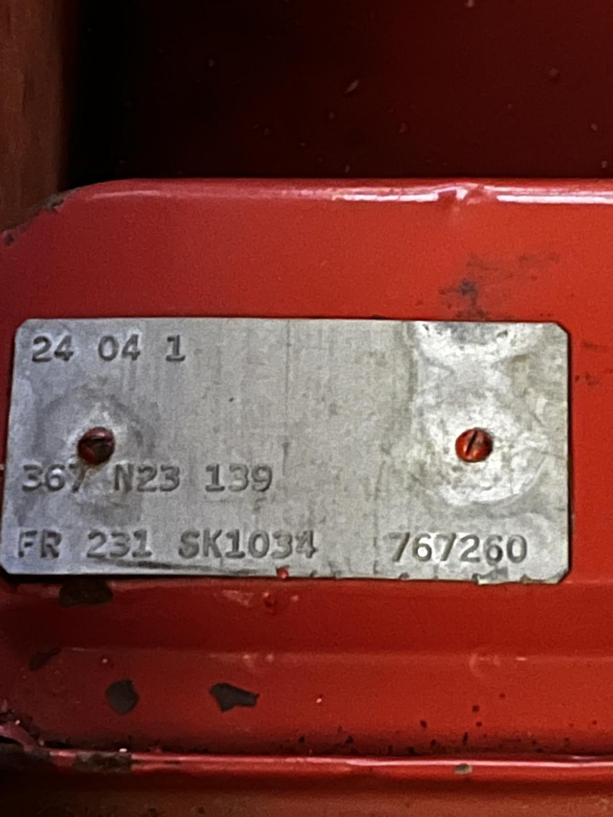

M-code plate (if it has one) will be under the front seat, mounted face up on the passenger side seat stand.
https://www.thesamba.com/vw/gallery/pix/1256843.jpg
There are other early flipseats with the "23" code, I know of one that is also a 61.
M-367:
https://www.thesamba.com/vw/gallery/pix/1699280.jpg

Here is location of M code plate, this is on a '64 SO34

Here is my mcode

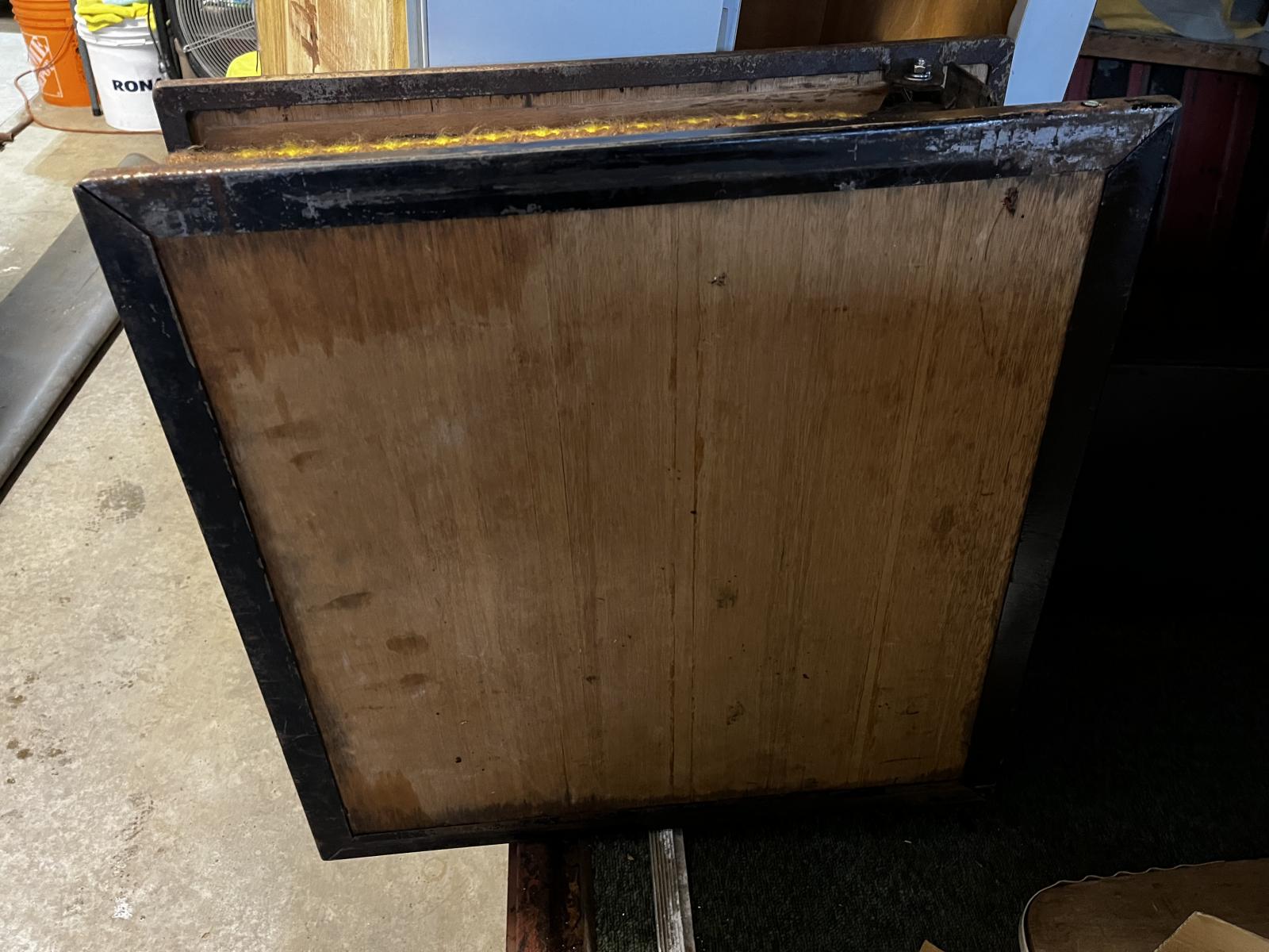

My seat and what I have for it
That bracket has been cut down quite a bit. Should not be too hard to repair back to original.
Here is my mcode
Sweet find!
FYI- the FR is for France. GR would be Greece. Either way this bus has seen some miles in Europe which is super cool to think about the sites it has seen.
Absolutely, the birth certificate says Greece as the destination

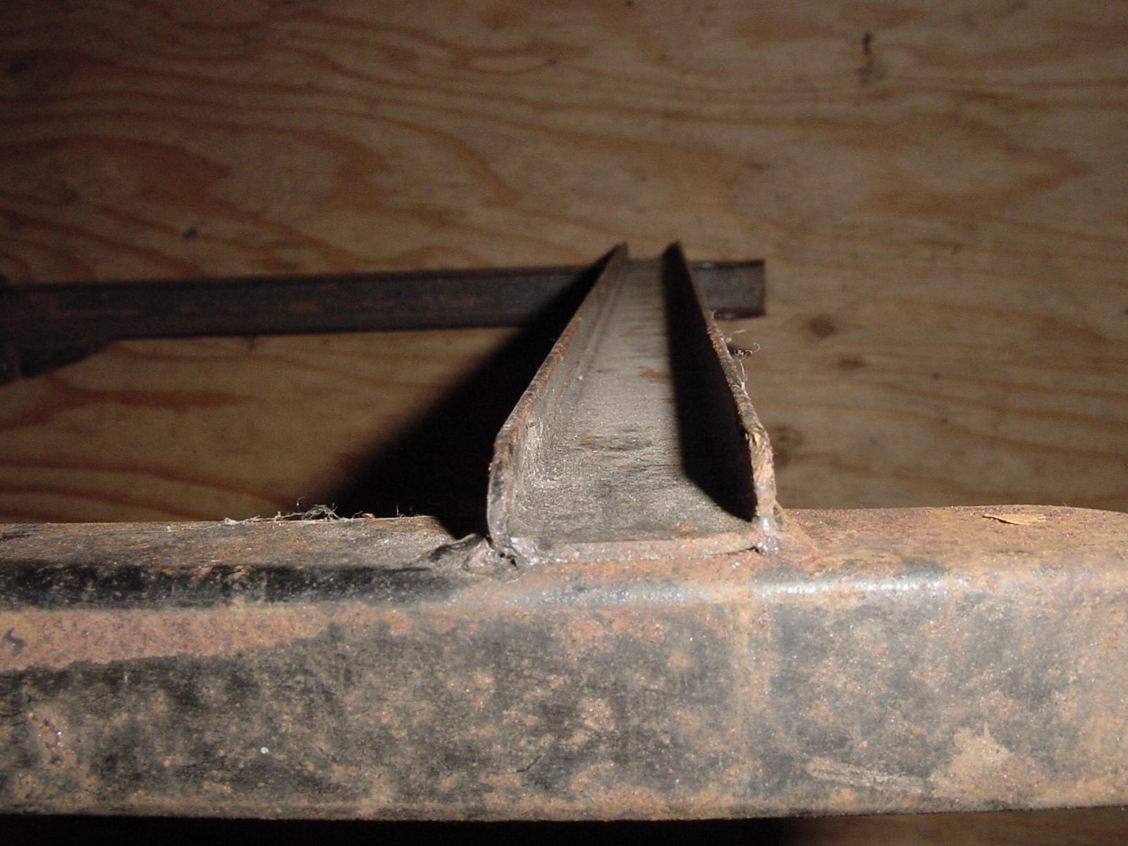

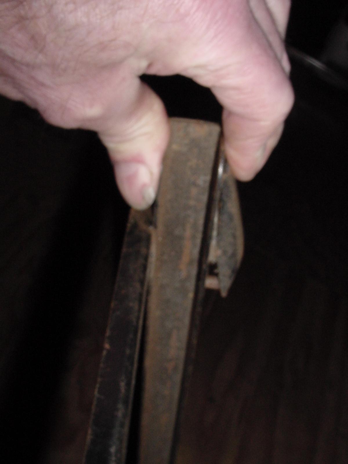

Here are some images:
Top side:
Folds up with hinges to allow immediate access to area under seat:
Next two images is of the latch that allows the seat to slide forward the two positions or all the way out:
Underside of bracket:
Front "U" channel that goes across the front, has same dimensions as the rear one.
Forward section you are missing is 371mm long. The "U" channel on the front lower is 40mm back from the very front of the bracket.
In Stereo, Where Available!
