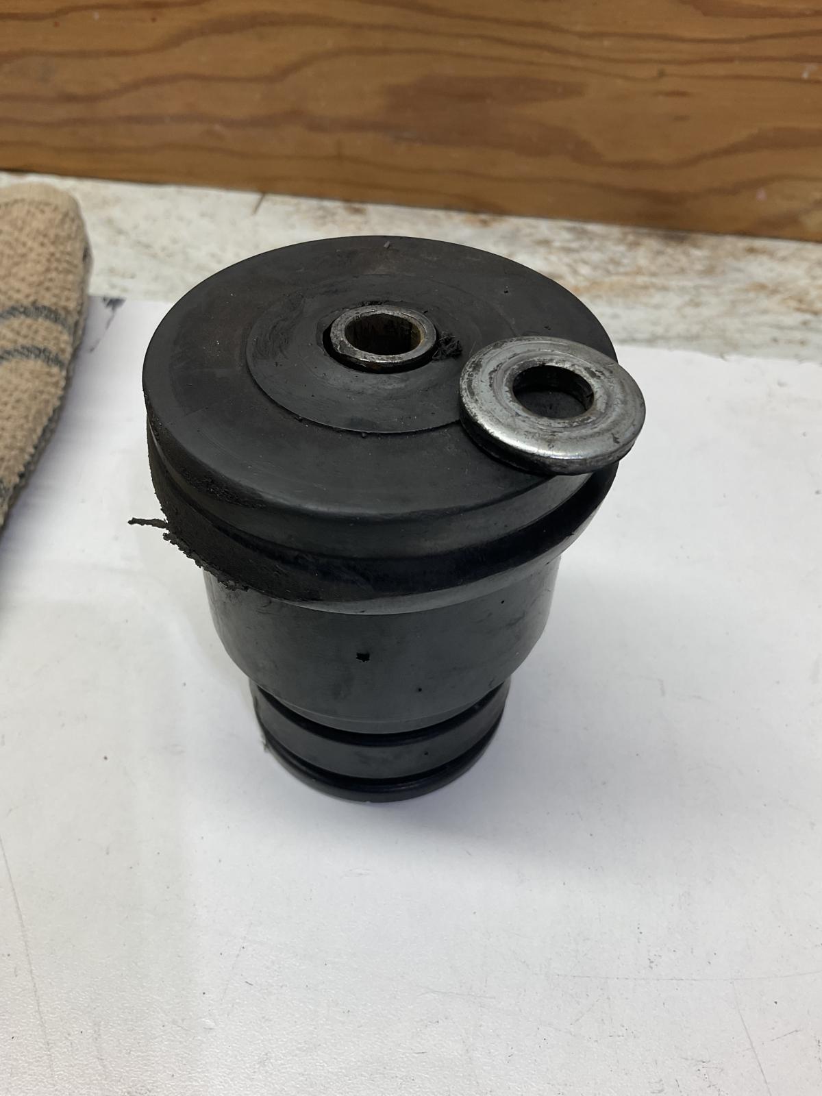

This is the top of the Bump stop.
That small washer came out of the top in the small grove. I believe that the bump stops are a very bad reproduction. I do not see any signs of the large washer. The bump stops are 4 years old that I bought from a well known vendor. I am really easy on the van.
This is the sleeve that goes over the end, luckily no damage on the shock rod. The sleeve slides down into the bump stop.

This happened to me too. The vendor gave me a refund without issue. I believe they have since updated the design. I put the original ones back in as they were still ok.

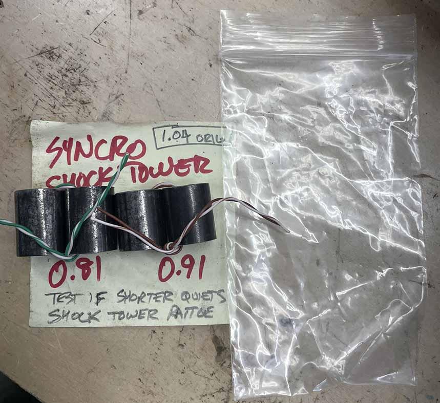

original measures .59 OD x .41 ID x 1.04 Length
And sorry I have NOT tested shortening my steel-bushings (to squeeze the rubber donut more).
I suppose I would try 0.10 reduction ( .94 length. )
I would like to try this.
Or "read of someone else trying it". Wink
I think ya gotta drive a rough road before, listen, and video the sound etc.
Shorten bushings (or exchange shorter bushings out in the boonies)
Then drive the same rough road after exchange.
I "should at least" make these 0.94" bushings and carry them in the van.... Wink

I made some shorter bushings.
Two lengths. 0riginal was 1.04". O made 0.91" and 0.81"
Carried in the van for the next time I hear that shock-tower rattle.
With luck, I can stop,
replace the bushings with shorter
test-drive the same road that caused the rattle.
.....and report back.
