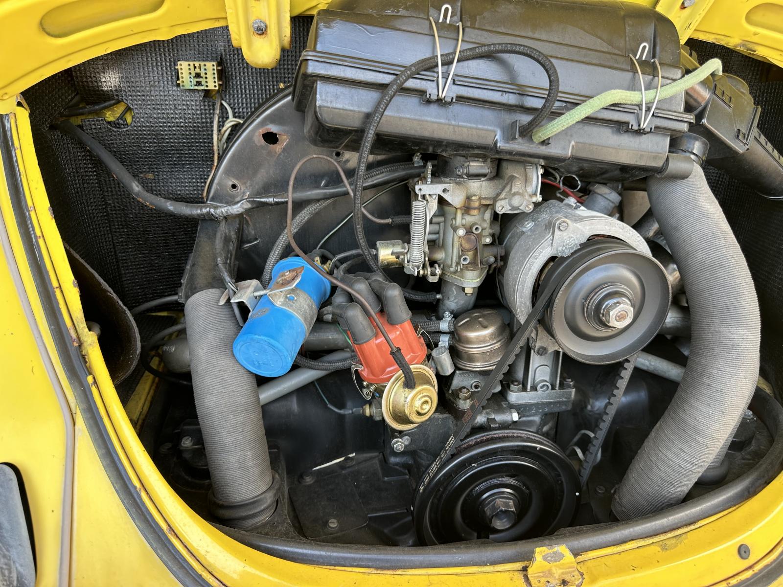

Zundfolge1432 wrote:
That's some coil mount you have there !!!!
