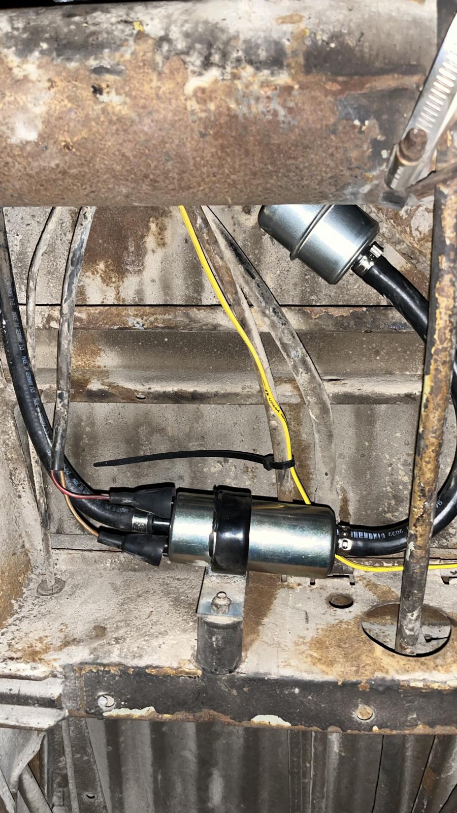

Back in the day you could just strip an electric pump off a Honda Civic, one rated to support a Civic 70hp engine with the old CVCC Keihin carb, and it would work perfectly feeding dual tiny Webers for a Type IV engine rated at 68hp.
Problem is there aren't any old Civics from 1982 sittiing in the yards. You might have to buy an adjustable fuel regulator to get to 2 3/4 psi to your carbs.
Or find a delivery pump that actually announces it s max pressure production is under >3< .
FYI what you can do is get Carter P90091 electric fuel pump (Amazon has it for $48.00) and it maintains 2.5 PSI and comes with a metal fuel filter & mounting bracket. If your bus was originally fuel injected it will mount in the original fuel pump location and you can even use the existing wiring as well. We run this on my wife's 76 Westy that was converted to Dual Weber 40 IDFs and it works great.

just an FYI that the above listed carter pump has 3/8" fittings in & out.
stretching 7mm fuel lines to 9+mm is not something i would recommend doing.
i'm sure people do it all the time. YMMV

Not exactly. If you look at the specifications on Carter’s website you will see that while the inlet outside diameter is 9.5 mm (3/8”) the outlet outside diameter is 5/16” which is not too far off from the factory barbs on fuel pumps and carburetors.
It’s also the same size as the inlet barb of the Weber IDF as well.
https://carterengineered.com/electric-fuel-pump-p90091
Looks like the perfect answer. No need for regulator, constant volume/low pressure. And nothing you'll find in the wrecking/recycling yards is going to generate under 3psi! Good retrofit.
