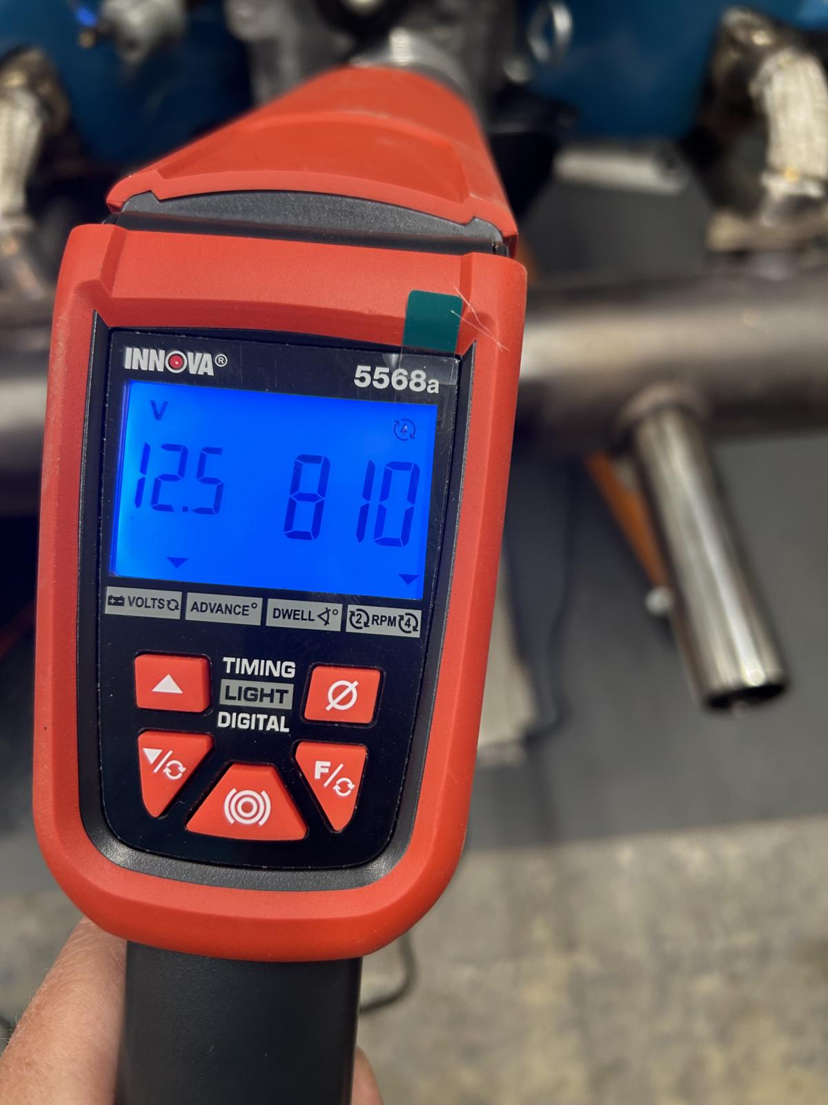

PostPosted: Sun Aug 31, 2025 2:07 am    Post subject: Re: 1776 Ready for a complete rebuild Reply with quote
Good morning Gents
Here’s the update on the 1776cc
https://youtube.com/shorts/CPWbwvt4m-w?si=xsshKR5BDlLt5WCx
I rigged up Fuel lines. She started almost straight away, and I ran her for a minute or so, and I could not hear any knock ? Before it was Very pronounced but I couldn’t hear anything.
I’m going to run her up to warmed, and monitor the oil temperature and try and listen for anything.
So, was that clutch the smoking gun ?
Dave Rolling Eyes
Edit
Warmed up and ticks over much better, checked timing, Ticking over about 800-820rpm

PostPosted: Sun Aug 31, 2025 6:07 am    Post subject: Re: 1776 Ready for a complete rebuild Reply with quote
Adjust the valves, snug up the exhaust bolts, re-sync the carbs, and set the idle a little higher to950 or so. And go over the mix screws again
Then listen to it again and see what you think.

Good morning Brian
Yes, and understood, cheers

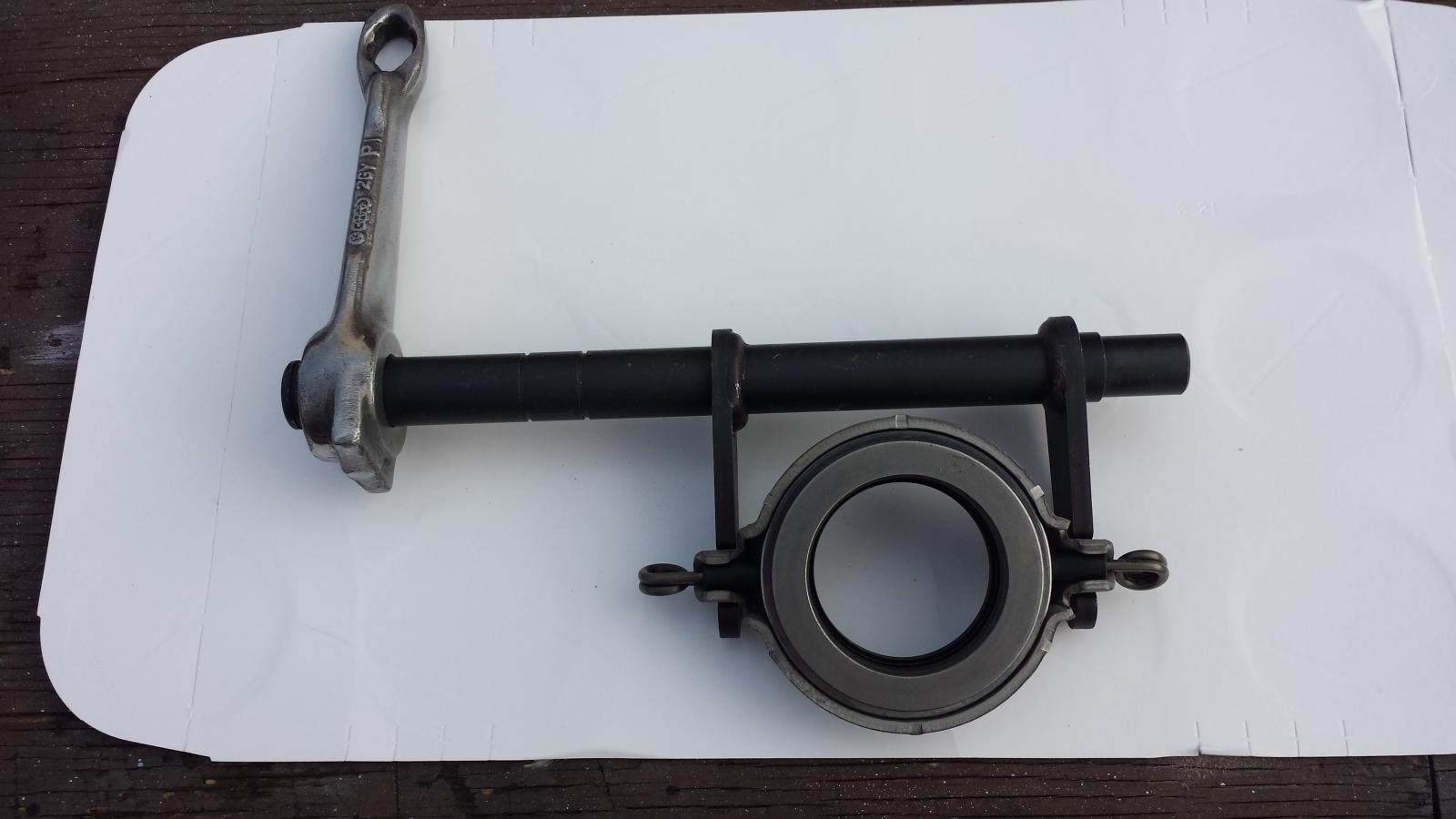

PostPosted: Wed Sep 10, 2025 8:50 am    Post subject: Re: 1776 Ready for a complete rebuild Reply with quote
Finally had a chance today to get the dusty old beetle up on my scissor lift in the Barn Laughing
She's very dirty, so will need to clean her up a bit
I have got a new TO bearing, and HD clips, so went to pull the one in her, and found this ? the clips holding the bearing in almost looked as if someone had 'cut' them ? how it was holding on I don't know, and that coupled with the wrong Pressure Plate, I'm surprised it hadn't gone bang !! Crying or Very sad
I now need to address lots of little jobs, like new engine seals, and look at plumbing up the thermostatic filter head and cooler. Once I've mocked that up, got the length of the hoses I need and sort out where the bracket will sit (was on the rear bumper bolts) I will remove the rear 'fenders' Laughing and the apron and get the engine back in Very Happy

I think those are wear marks from where it rode back and forth on the operating shaft several hundred thousand times.

Hi @Bobs67vwagen.
Yes chap, I think you are correct, the chap who installed the engine, didn’t replace the TO Bearing Crying or Very sad so I suspect that it was in the Transaxle for quite a considerable amount of time
