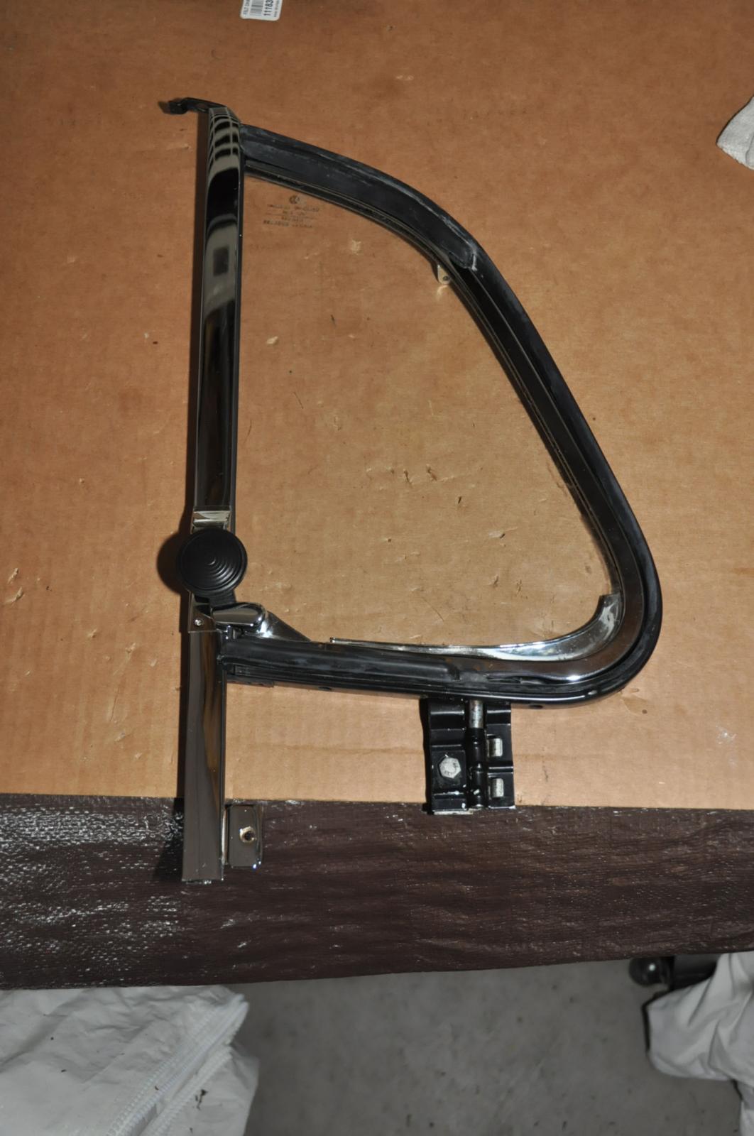

UPDATE: Vent Wing Window Assembly - Part 2

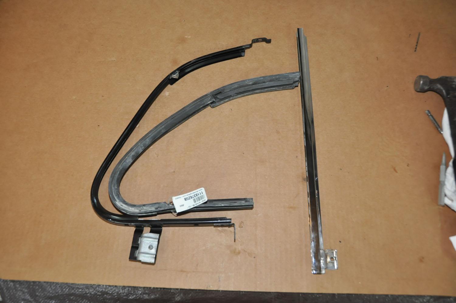

With the wing glass and latches installed, I moved to the larger frame, rubber and other pieces to complete the entire wing window assembly.
For the frames, I cleaned everything up with de-greaser and shot a light coat of semi gloss black to cover any bare metal portions. For this part of the assembly, I had to install the rubber that fits into the metal frame and also attach the chromed division bar. Here are a few pics of those pieces:

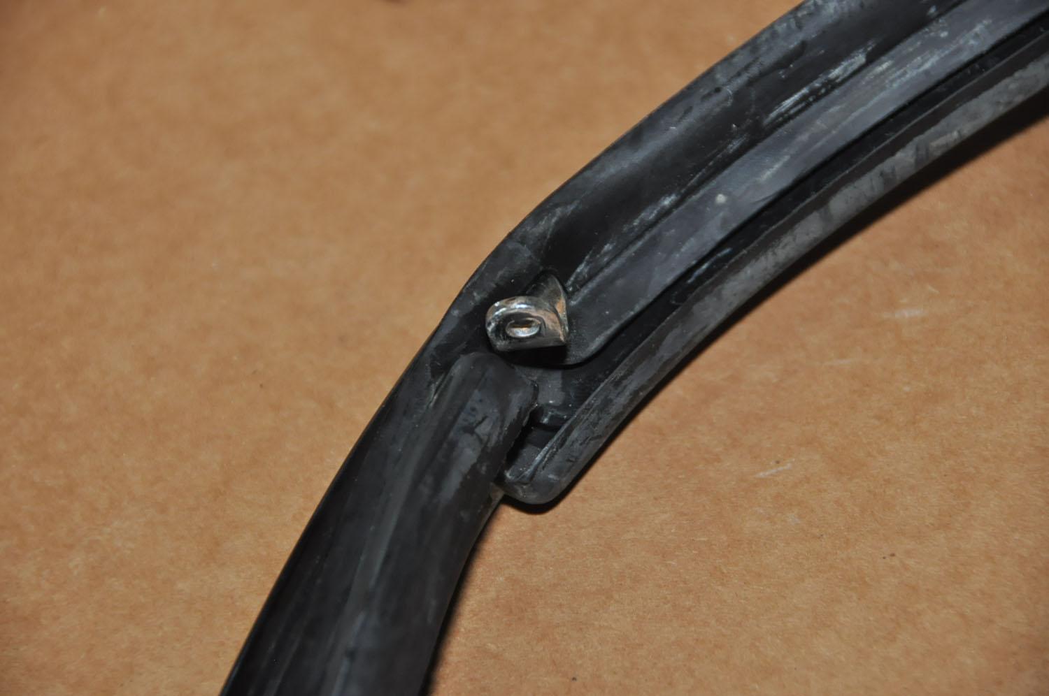

The frame rubber is from Wolfsburg West and fit pretty good with very little modification. The rubber is pre-cut for the top pivot point of the glass and the bottom portion of the frame where the glass frame shaft inserts. I sprayed the rubber with silicone and started with the top pivot point. The rubber has to twist through the pivot point so I started that first. The rubber has a groove with two lips that sits inside the frame which has a curled edge in certain portions.

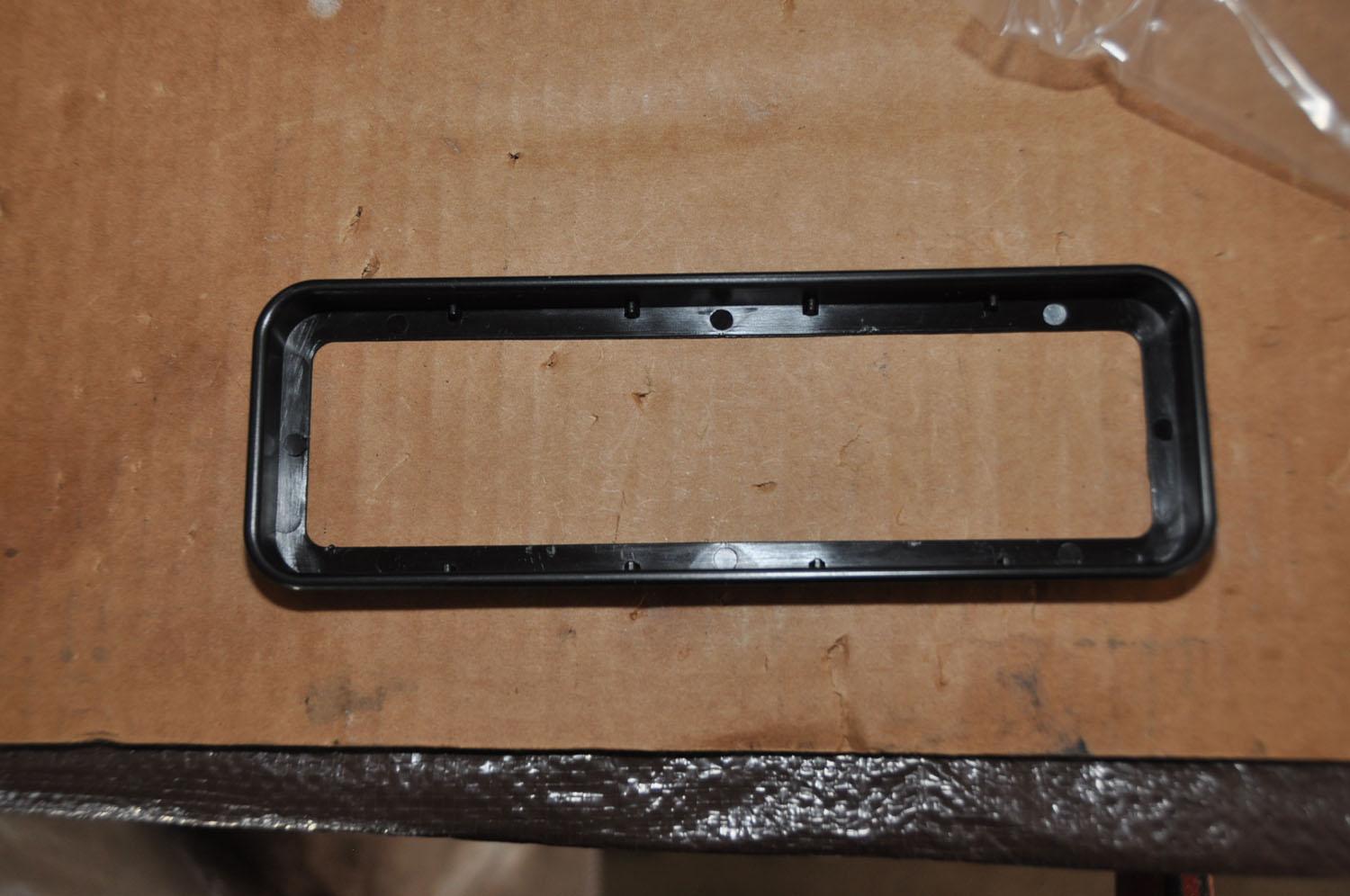

Before I inserted the rubber into the grooves, I made sure the white plastic piece that slides within the metal frame, was ligned up over the hole where the glass frame shaft will fit into. Here are a few pictures with the white plastic piece out of position and one in the correct place:
If that plastic piece is not in place the rubber will not fit properly...it has a notch in the rubber to accept the top of the white plastic piece. Once everything was ligned up I sprayed silicone again on the rubber pieces and pushed one side of the rubber in. I then used a small screwdriver to push the opposite side of the rubber in until both sides slid into the frame. I noticed there were holes around the frame, so I decided to spray extra silicone in the holes as well which really helped the rubber slide into the frame.
Once I thought the rubber was seated I just pushed every inch of that rubber with my thumbs to make sure the rubber was seated all the way. A few sections fit much better after that process. Here is a shot of the rubber installed in both frames.
As a side note, I forgot to take pictures of the rubber where it meets the end of the bottom portion of the frame. As you can see in the photo above, the ends look a little higher than the rest of the rubber which did not seem correct to me. The notch in the rubber where the frame fits into was not as deep as the rest of the rubber. I used an exacto knife to make a slightly deeper cut into that notch and the ends seated flat and straight.

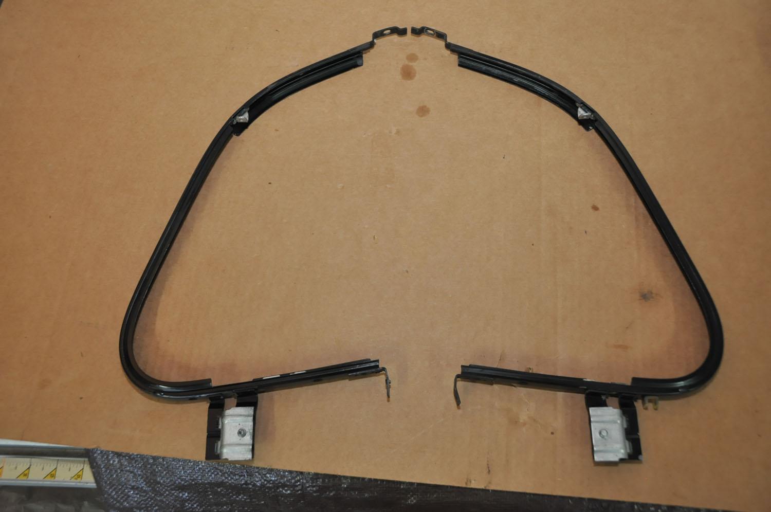

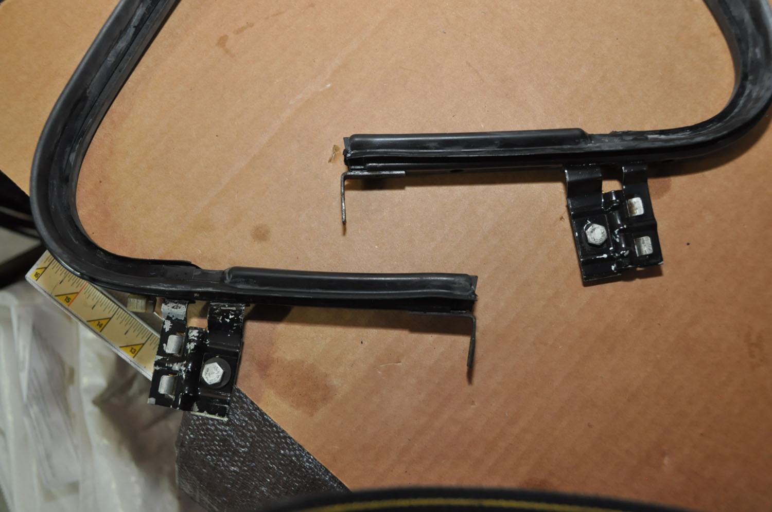

Now for the divider bar. I had that re-chromed as well as the little metal piece that wraps around the divider bar that acts as the inside latch for the wing window glass. The inside latch has a little tip one side that fits into a hole in the divider bar. The inside latch also has a little lip on one side. I just started on the lip side then rested the inside latch over the divider bar. Once that was lined up, I covered the pieces with a rag and used a small set of pliers to fold the little edges that hold the inside latch to the divider bar. I had an extra inside latch piece, so I had all 3 pieces in my possession polished just in case one of the little pieces that bend over the divider bar broke off. They proved sturdier than expected.
With the divider bar complete, I had to attach each bar to the black wing window frame. I used the 1/8" x 1/8" rivets. I installed one on top and two on the bottom.
Here is the frame fully assembled:

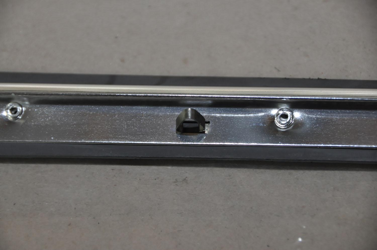

All that remains is the rubber that fits on the inside of the frame where the window glass will rest, the window glass itself and the felt channel for the door window. Here is a shot of the pieces.
The rubber for the divider bar where the glass will rest has an angled edge. See below.
I placed that angled edge so it will face the glass once installed. Installing it with the straight edge did not make sense and when I did a dry run with that edge, the glass just did not sit correctly. Here are a few shots of that rubber piece installed:

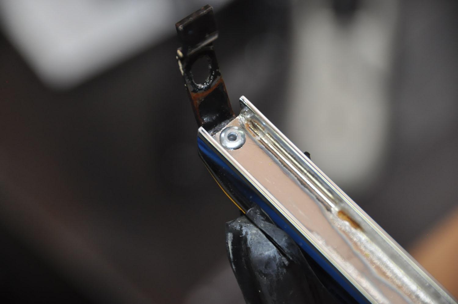

To install the glass, I used a rivet at the pivot point with a small washer between the two metal pieces. Here is a shot of the glass installed and the glass lock inserted in the inside latch.
Here is a shot of the felt piece and the divider bar edge.

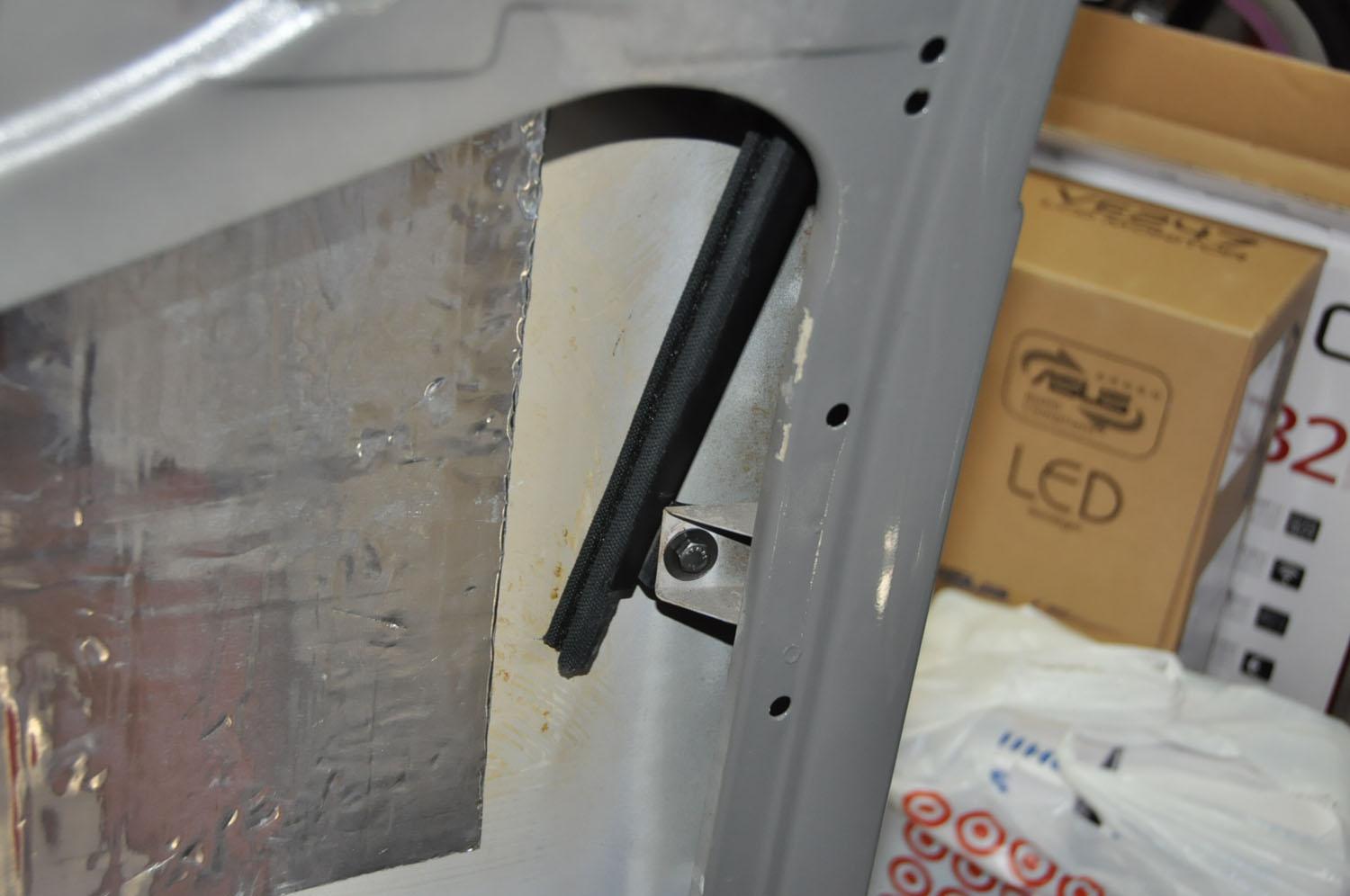

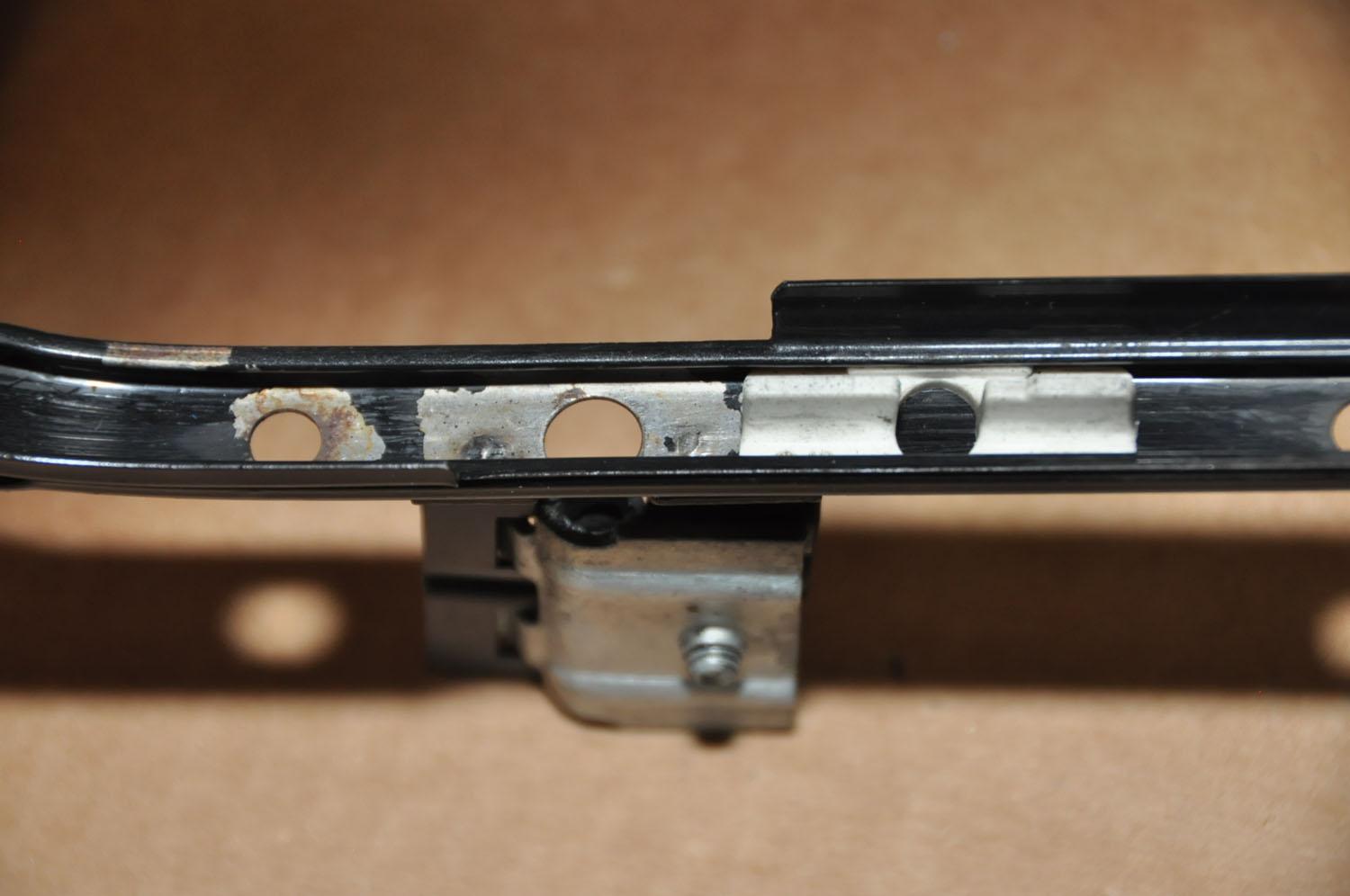

The lower window guide also needed fresh paint. The guide has a clip on one end and a screw hole at the other. These appear to be left and right so make sure you have the correct side before assembly (I labeled my guide during tear down and I only worked on the the driver side first). I cleaned it up with simple green and a wire brush. I then shot it with primer and a coat of semi gloss black paint.
Here is the piece before clean up and paint:
Here is the finished guide painted:

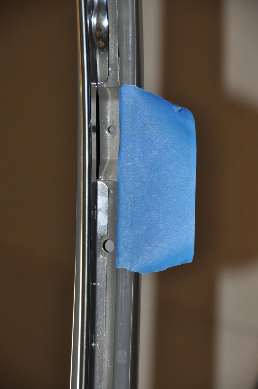

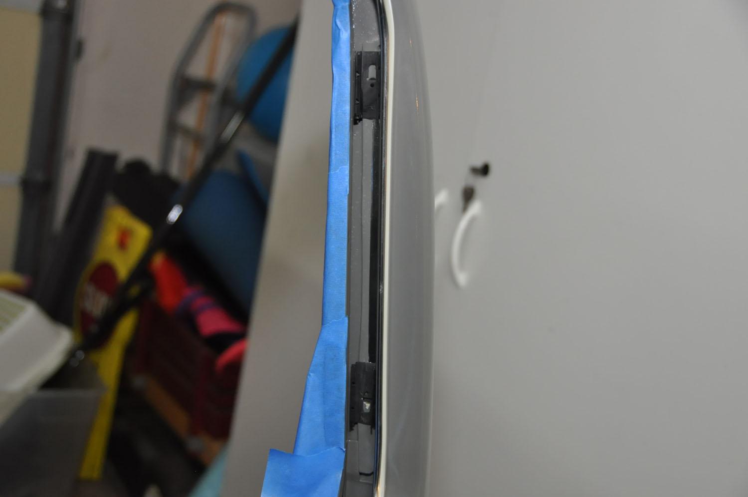

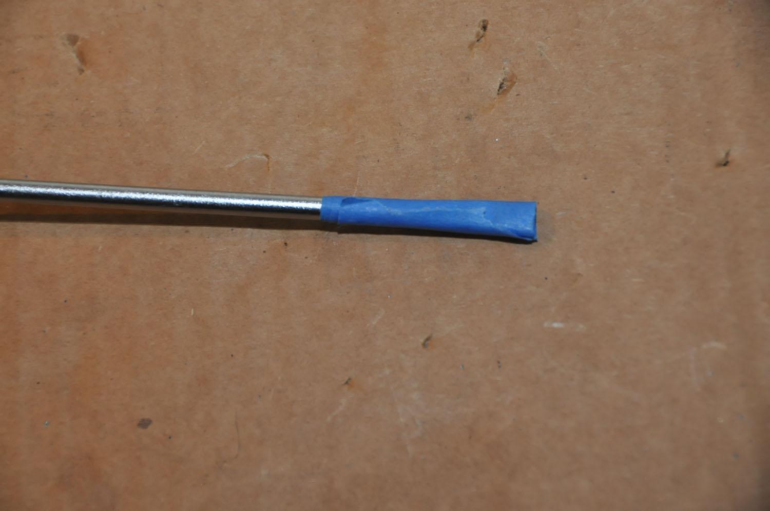

I used tape to protect the door paint and still leave enough room to snap the scrapers in. With the tape in place, I started with the outer window scraper. All my door parts were from WW. The scraper has clips that snap into openings along the inner part of the door where the window goes through. Here are shots of the front and back of the outer scraper:
Here is a shot of the scraper clips and the hole in the door where they clip into:
Side note - in the picture above, you can see the blue tape. I originally put the tape too close to the inside edge of the door and when I started to snap the outer scraper, it covered too much of the tape and it was a pain removing the tape that was covered. After that, I removed the tape that was not covered and moved it away from the edge (just a little bit) so I could still protect the paint and snap the scraper in place.
From the outside of the door, I lined up the clips and used my fingers to snap the clips in. All the clips went in with a nice snap sound and the clips fit well and stayed. After every clip, I checked the rest of the scraper to make sure it was not flapping around that much and was fiting around the door window area. The overall all fit is pretty good, but with any after market piece it is not perfect. Here are a few shots of the outer scraper:

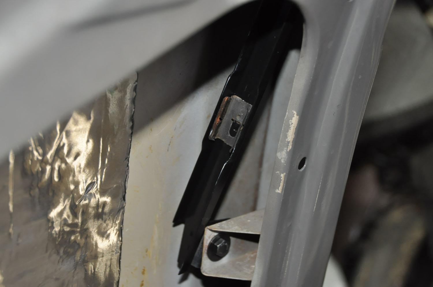

Now, I installed the lower window guide that has the clip on one end and the bolt hole on the other. This was not easy. I had a hard time trying to get it installed. It covers the door lock mechanism that is inside the door and also acts as a guide for the window glass. Well, I tried and tried. After a few cuss words, I realized that the door handle and lock mechanism might be in the way. I removed the door handle and the lock mechanism. DO REMOVE the door handle, DO NOT remove the door lock mechanism. I found out quickly that the door lock must be installed first. However, with the door handle removed, the guide was much easier to install. I had to go in from the bottom, and rotate the guide slightly to get it to clear the lock mechanism and slide the top clip into its spot. I took some pictures but they may have been over written by the camera. You will know it when you have the guide in place, just do not force it. I just clipped the guide at the top and did not screw it in just yet at the bottom.

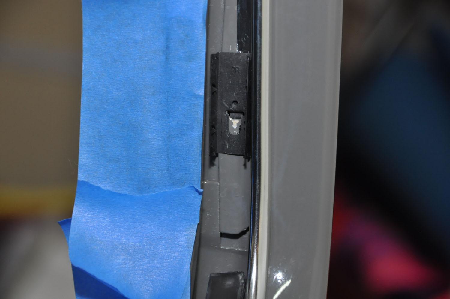

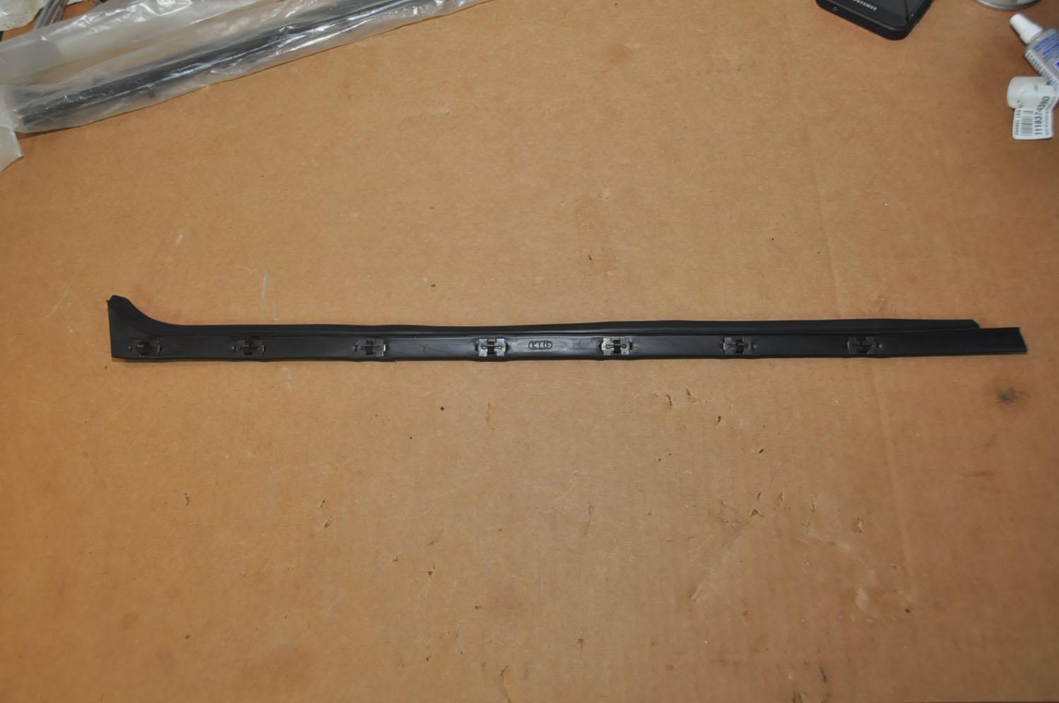

The outer scraper is held in place by clips that slide into holes inside the door frame. I purchased a new set of clips (5 clips). Here is a shot of the clips - they are much longer than the original clips:
The clips install around the inside of the door. They are used to hold the inner scraper in place and to hold the window felt. I placed a clip everywhere a hole was present to hold the outer scraper in place (6 in total - glad I kept an original clip because I was short one). To make sure the scraper had a snug fit, I used my needle nose pliers (wrapped in tape) and used that to lightly press the scraper flush inside the door frame. I DID NOT touch the part of the scraper that can be seen after install. I just made sure it was flat against the inside part of the door where the clip will go over the scraper and fit in the hole.
I would put the clip in the hole just enough so that it would stay and used my other hand to make sure the outer scraper was flush against the side so it would appear straight and flush when viewed outside the car. Hard to explain, but you will know it when it fits. I could not push the clip in with my fingers so I use a screwdriver wrapped in tape to protect the paint and just pushed the clip in. Some clips where tougher so I had to push the handle end of the screwdriver with my other hand and the clip would snap in. Again, you will know the clip is installed...mine made a good loud snap and also the little lip part of the clip goes all the way in the hole. Here are a few pictures:

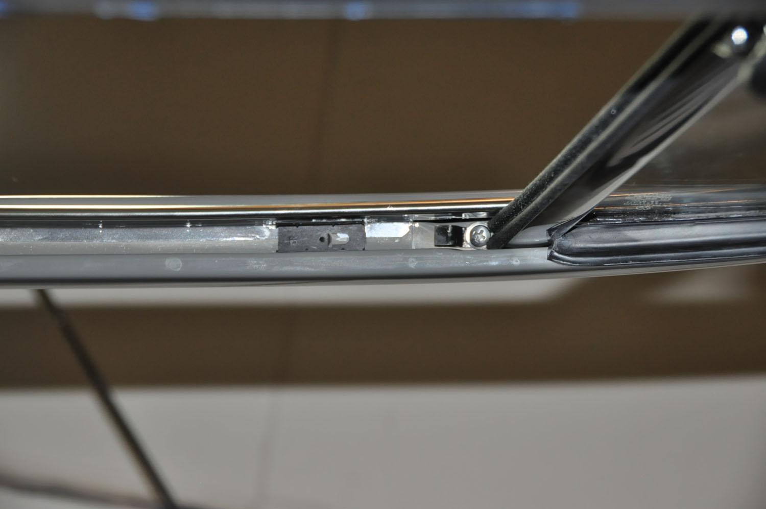

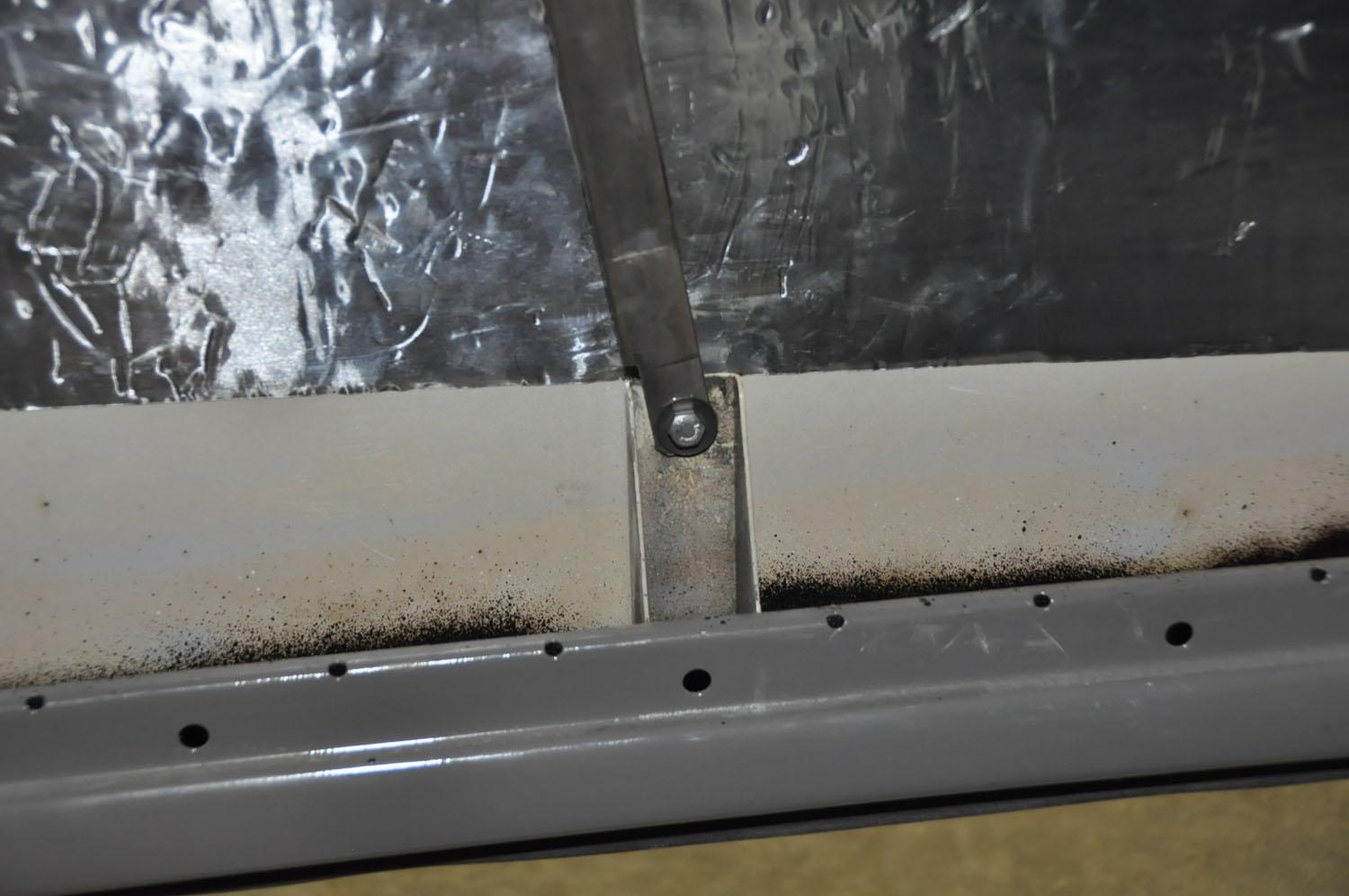

The front edge of the scraper has a little metal wing. That gets folded into a notch in the door frame to hold that front piece flush against the door. The front is also held in place by the wing window assembly.

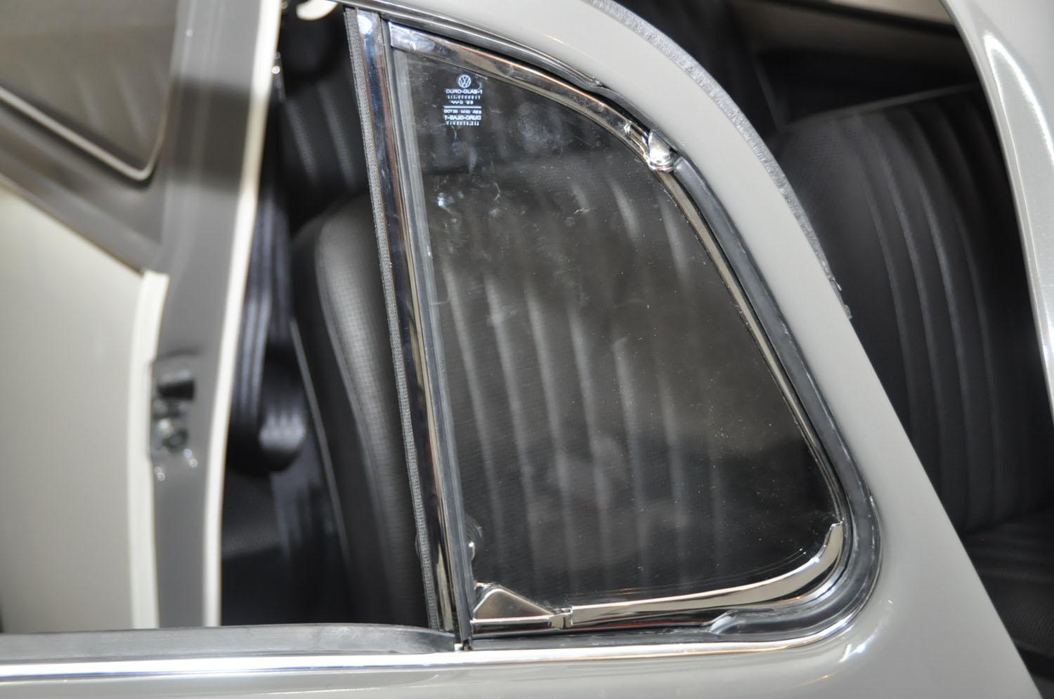

I then installed the wing window assembly. Here is where a I made a mistake. I installed the outer scraper clips I mentioned above. However, there is a spot where a clip goes that is near the hole where the wing window is attached at the top. DO NOT install this clip just yet. Wait until the wing window is installed then install that final clip. I kept running into the clip and I also did not want to scratch the chrome on the wing window.
The wing window assembly just slides into the door at an angle then once the wing window bottom post (which will attach to the inside part of the door) is all the way in, you just straighten out the wing window until it is flush with the opposite end. I opened the glass part then gave a light tap with the palm of my hand until the window was in place and the screw hole at the top and on the inside of the door where the wing window post attaches lined up. Here is a shot of the wing window assembly installed:
The hole above and to the left of the door latch is where the wing window post is attached:

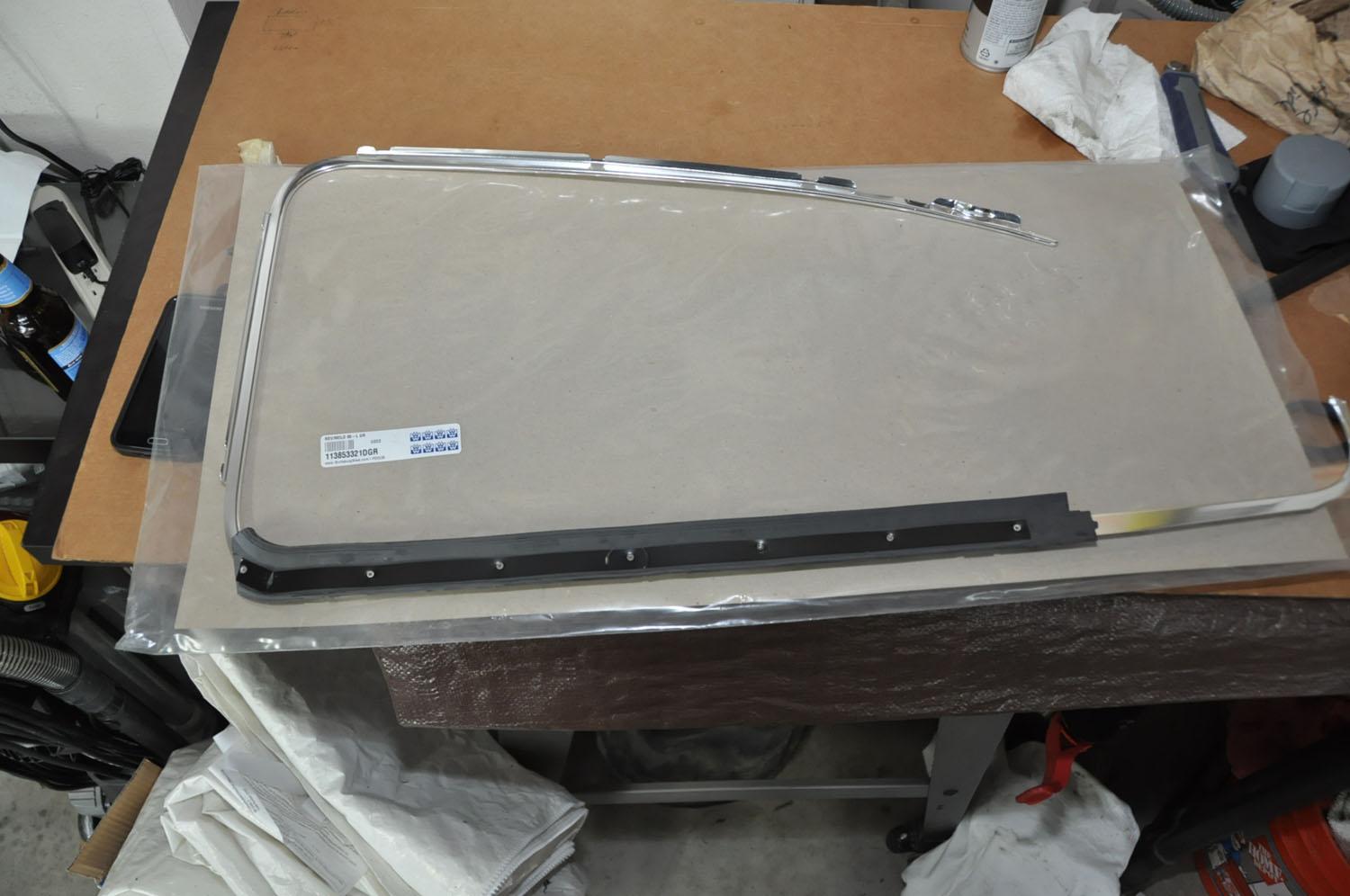

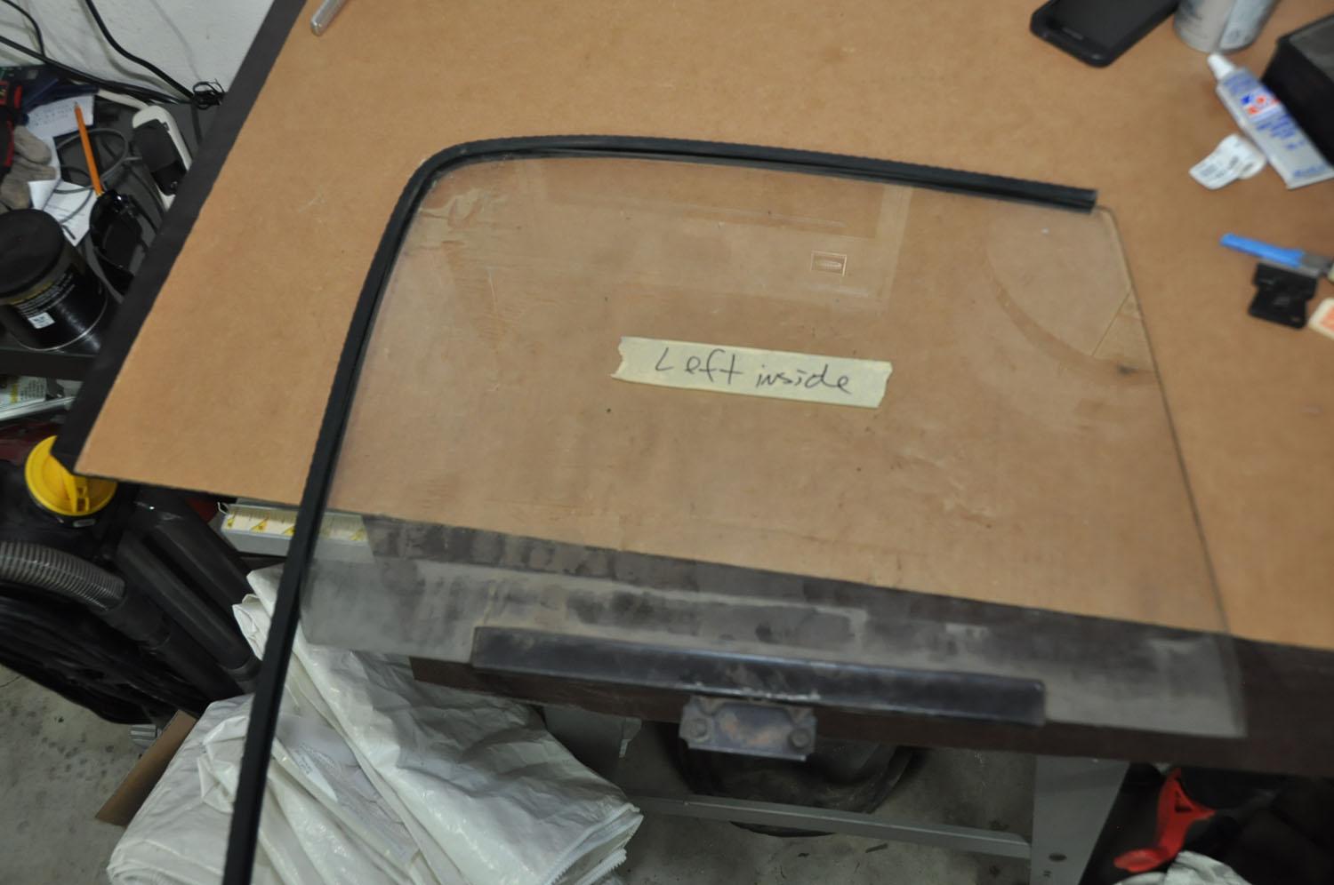

Now for the window felt that goes from the top where the wing window is, down the side and into the window guide that is at the bottom. I had not cleaned my old window up yet, so it still had the markings from the previous felt. I used that as a guide to bend the felt around the window. Lay the glass on a flat surface then insert the felt and press it tightly against the glass as you bend the felt around the contour of the glass. This really helped when it was time to install the felt in the door and to make sure the felt fit nicely into the door where it bends (facing car from outside it is the top right rounded corner). Here are a few shots:
Here are the old felt lines which I used to line up the new felt. The felt does not go to the edge of the glass since the edge of the glass will slide into the felt channel of the wing window. By using the old lines, I think it made the felt, once bent, to fit easily and more snug with little manipulation.
Here you can see that the felt does not go all the way to the top right edge of the glass.
Once the felt was bent and seemed to form around the glass, I cleaned up the glass too remove the dirt and old felt lines that were on the window glass.
I inserted the felt through the bottom of the door and out through the top, but did not insert it into the door frame just yet. I probably could have, but I did not know how easy it would be to remove from the clips so I kept it loose until I installed the inner scraper. HOWEVER, after going through this, I could not get the innser scraper to snap in where the scraper is placed close to the door lock knob and the felt. I ended up pulling the felt out (glad I did not push it in) and installing the inside scraper first.

Just like the outer scraper, it has clips and those clips are pushed into holes in the inside part of the door where the window rolls through. I must say, that this part installed without much headache and was easier than I anticipated.
Once the inner scraper clips and door holes were lined up, I started from the wing window side and using a paint stick from Home Depot I pushed the clip in with my hands. THERE IS NOT MUCH SPACE TO WORK WITH. I found it was easier to work from the inside of the door and pull the paint stick towards me which made the clips snap in easier than working from the outside of the door. I also did not want to bend or scratch the outer scraper.
Well, that worked for the first few clips but the rest of the clips were tougher to get in. Also, for the rest of the clips, the paint stick flexed too much to get any leverage. I decided to use a screwdriver on the backside of the paint stick to reduce flexibility.
Again, while pulling the stick and screwdriver from the inside of the door toward me, the scraper snapped right in with little effort. Just take it slow and watch what you are doing so you do not bend the outer scraper or chip any paint.
Now, the last clip that goes to the outermost edge (toward the door lock release knob) would not go in at all. I was pulling and pulling and the damn thing would not go in. I cannot fit my hand or fingers from the bottom working from inside the door and I could not get any thing up there to push it in. After another beer and a 10 minute break, I decided to use a small screwdriver and simply push it in using the screwdriver at an angle - almost pushing he clip straight into the door. The screwdriver was short and snapped that last clip in easily without damaging the outer scraper or the paint.
There was a little overlap for the inner scraper where the rubber meets the divider bar. There was no space to insert the rubber between the door and the divider bar so I had to trim a notch in the rubber. I loosened the wing window shaft bolt (inside of door) and slipped the rubber in. Here is a before and after. It looks better now then pictured below since I was able to push the rubber all the way in and make it flush.

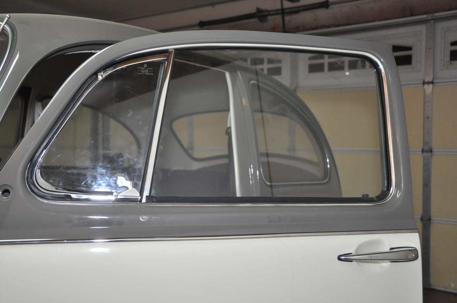

Here is the finished door with all the pieces installed:

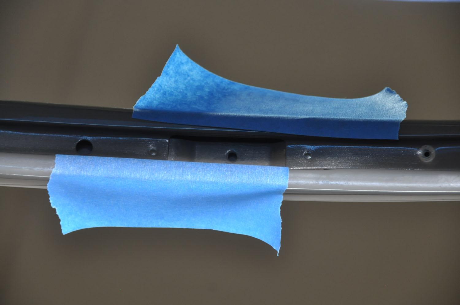

USE TAPE TO PROTECT THE PAINT

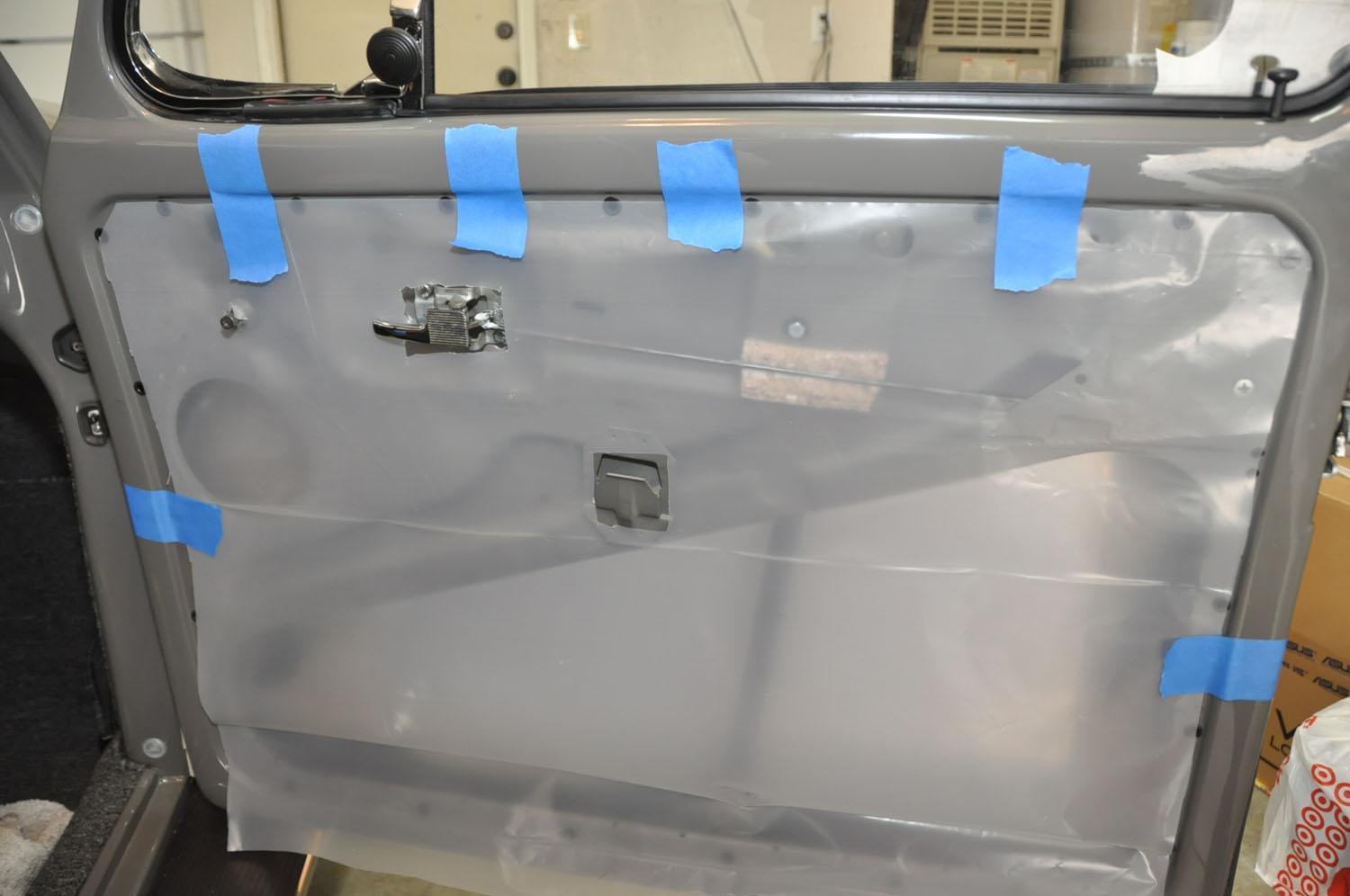

As a side note, I started with putting the glass in first, then the window regulator and other pieces. As I tried to get things in position, I was afraid to break the glass, so I removed it. Since it was easy to install last on the driver's side, I decided to take the same approach.
Taped the door to protect paint.
Removed the outside door handle to install the lower guide channel.
Here is the lower guide channel.
Clip end of the channel.
Clip end inserts into the rear part of the door in this slot.

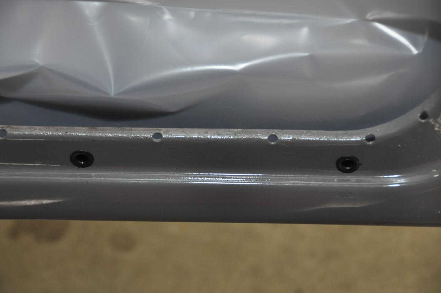

Here are the clip holes for the clips that hold the outer scraper. There are 5 clips for the scraper and a sixth that will hold the longer felt that fits into the lower channel guide referenced above.
2 for the rear part of the door where it meets the door jam.
3 clips for the top of the door.
Here is the rest of the top of door that also has the hole where the wing window will be screwed into...the smaller hole between the tape.

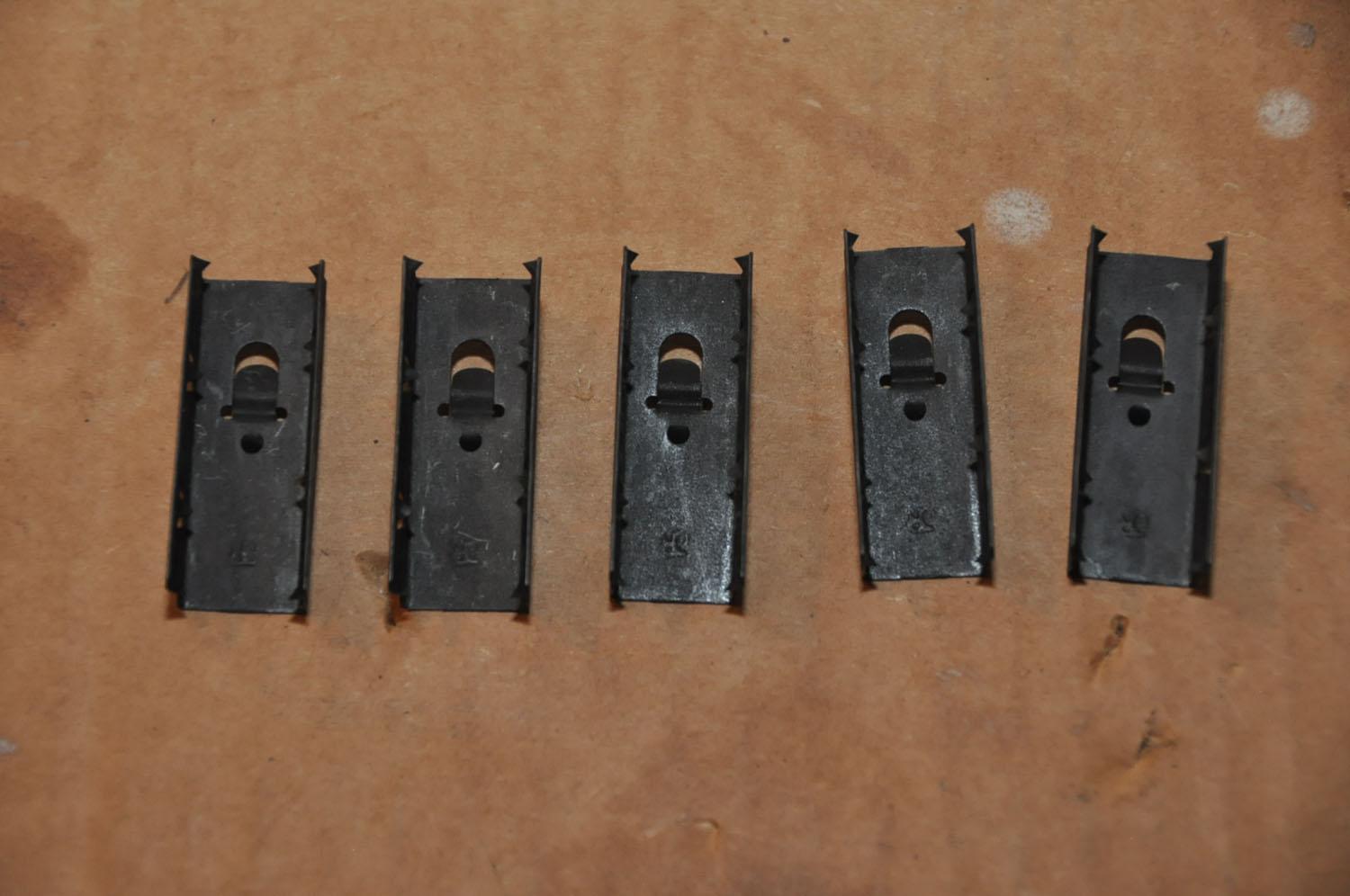

Here are the clips. Note - when I ordered them, the vendor stated 5 were needed, but six is needed if you include the clip for the lower channel guide. I used one of the original clips which I kept during tear down.
I installed the outer scraper, snapped the bottom scraper part into the door holes then added the clips. Here are the retainer/felt clips installed.
I did not install the clip closest to the wing window screw hole...put that one in once the wing window assembly is installed. See below:
Installed the wing window and screwed it to the top and the side bar to the door.
Installed the third clip.
Bolted the wing window side bar...bolt right above and to the left of the door release.

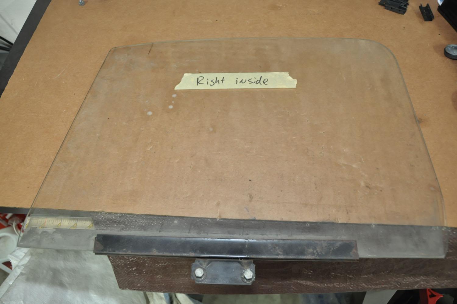

Prepare the long felt. bend it around window using the older felt marks that are on the glass prior to cleaning.
Now the long felt. I pushed it through the bottom, then started at the edge where the felt touches the wing window side bar. Then worked it toward the curve in the door and then down through the lower channel guide.
Now for the clip that holds the felt to the lower channel guide.
I then installed the window glass, slipped it through the bottom of the door, then tightened all the bolts. Here are the bolts that hold the window glass to the regulator. I attached it at the bottom of the window, the once the window is wound all the way up, you can see the bolts through the 2 cut outs. Also, the bolt right below the 2 cut outs, holds the window regulator.

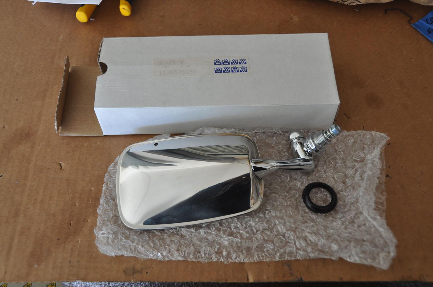

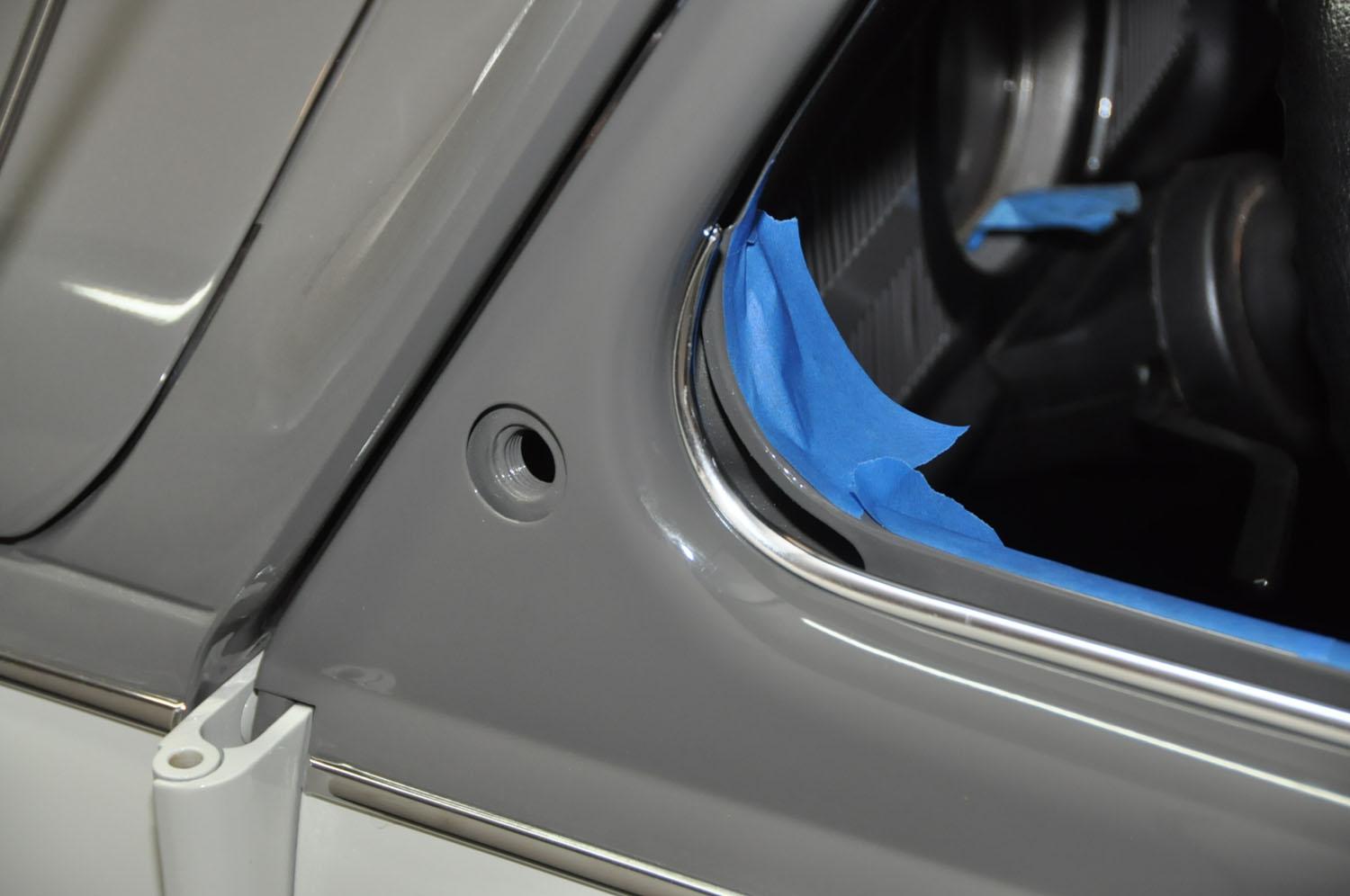

After looking around the outside of the car, I realized I only have the driver side mirror left. I waited to install the mirror until the driver door was done, in case the mirror got in the way.
I purchased the mirror from wolfsburg west. Here is the mirror.

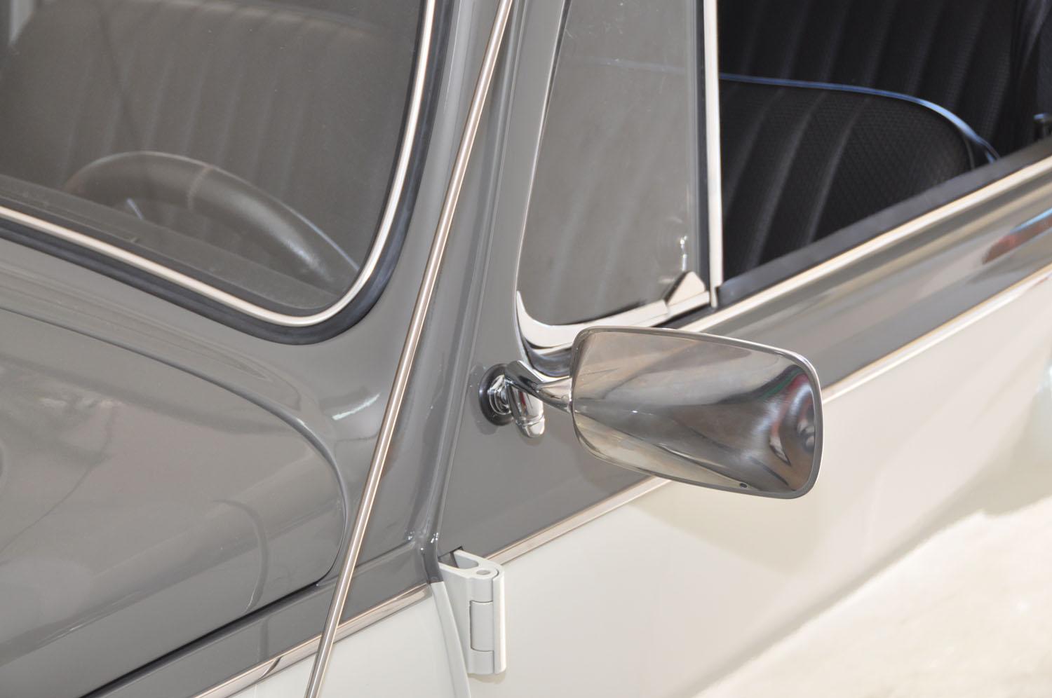

The mirror screws into the pre-drilled hole in the door. I lubed up the mirror and the threads and installed it.
I am glad to have the windows in, so I feel more comfortable driving around town with the ability to lock the car up. Stay tuned, more work to be done. Thanks.

I agree with the fit, I purchased the best that I could and it still does not fit the way it should...I would hate to see the fitment of the cheap stuff.
I should finish the doors this weekend (panels, vapor barrier, etc.) and will install a stereo system next before I finish the rest of the truck area. Stay tuned.

UPDATE: Door drains, inside door lock release lubrication, and the moisture barrier / vapor barrier.
Thanks Goldbug3318 and Attitus finch! Atticus, I am glad the thread has been helpful...this is the only way I know to pay the community back for all the help I have received.
As a side note, I still need to add talc to the new scrapers but the windows are starting to roll up and down much easier compared to when they were first installed...must be the usual break in period. I leave the windows up all the time, even if in the garage and that has helped a little bit as well (maybe because the scrapers are being pulled apart with the window in the middle and the rubber is settling in...who knows).
Now on to the update.

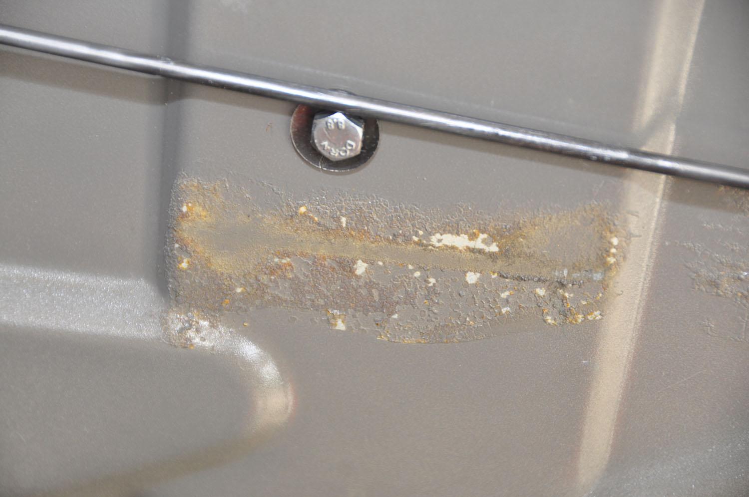

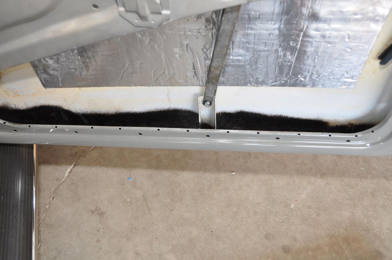

Time to do all I can before I put the door panels on. I decided to lubricate and check to make sure the door drain holes were clear. I used a flashlight from the top of the door and looked through the bottom drain hole and cleared anything that may be blocking the drain. I put rust protection in the bottom of each door, so I wanted to make sure the drain holes were not clogged with that and other debris that may have accumulated during this build. I used a shop vac and sucked up anything in the bottom of the door as well. Here are a few pictures.
One of the drain holes (there are a few) in the bottom of the door
The inside bottom of the door with the rust protection

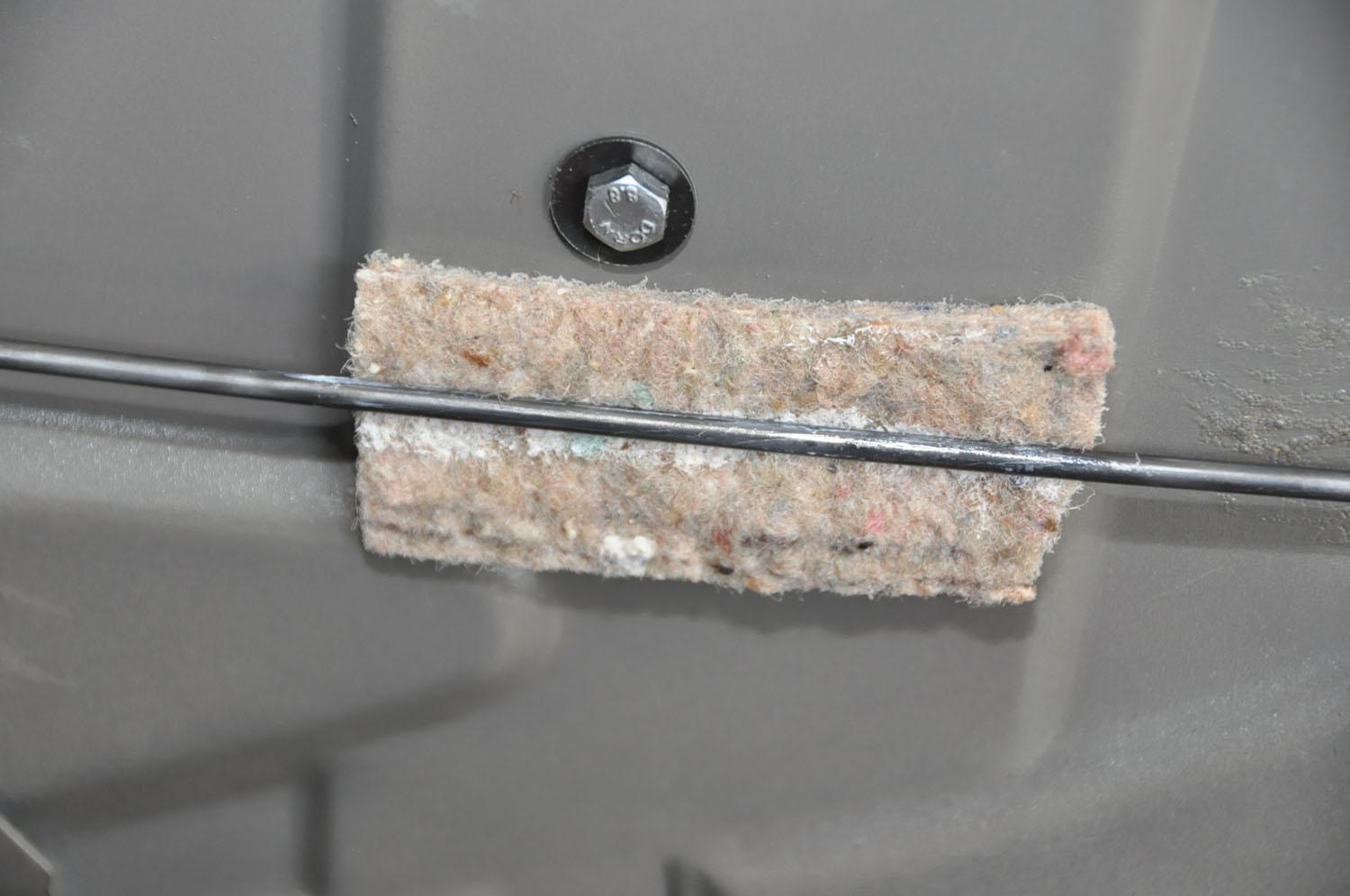

Next, I needed to re-install the vibration damper that goes behind the rod that attached to the door lock and the inside release. I am not sure what it should be called, but that rod would vibrate and make noise like crazy when I was driving around.
Here is the assembly prior to the damper or any lubrication
I removed the inside door latch first which allowed me to move the rod.
I then moved the rod up gently so it could rest on the bolt right above where the damper needs to go.
For the damper, I used scrap material that I used for the floor padding underneath the front passenger and rear foot well carpet. I just cut 2 pieces down to size so they would fit both the passenger and driver door. I try to use any excess materials to keep costs down and to re-purpose where I can.
Here is the cut material
I then glued the damper to the door using 3M 77 spray adhesive. I did not spray the door, I just sprayed the material and pressed it on. It set up fast and is not going anywhere. (As a side note, this completely stopped the rod vibration when driving).
I then determined where the rod will likely rest and then rubbed white lithium grease on the rod and on the damper material as well.
I then applied white lithium grease to the hooked end of the rod, the inside door latch loop where the rod attaches and also added grease to the other end of the rod where it attaches to the door lock (no photo). I reinstalled the door latch.

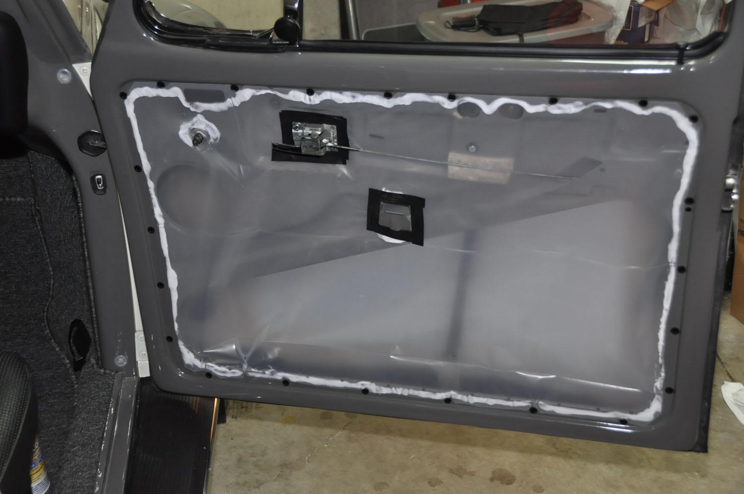

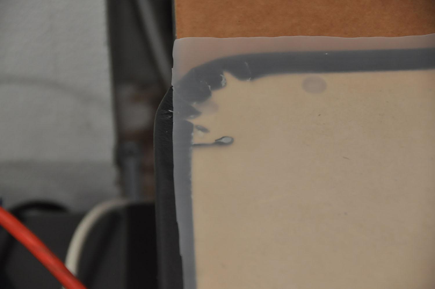

With everything lubed up and the damper in place, I moved on to the moisture barrier / vapor barrier. From what I read, the barrier IS NEEDED to keep any moisture from ruining the door panels. This includes general water sources like rain and washing the bug, but also from condensation and temperature changes, humidity and other sources that can build up over time. I want to do things right and once, so I took the extra step.
I used 4 MIL material that I bought from the local big box hardware store (Lowes). The plastic is thick enough and was not easy to puncture so it seemed like it would do the job.
I decided to use the door panel as a measuring guide. I wanted to keep as much of the plastic roll in place without unraveling it and making a big mess so I just rolled the plastic out as it came off the roll and cut it to length. Then unfolded the cut piece.
I lined up the plastic at the top then cut about 1/4 inch from the edge of the door panel. Here are photos.
I originally left a few inches at the bottom to tuck the plastic inside the door, then changed my mind which I will explain later.
Once it was cut to size, I begin the prep to attach the barrier to the door. I installed the plastic seals that will be used to attach the door panel - the door panel clips snap into each rubber seal.
I decided to use clear caulk (goes on white) to attach the plastic and create a nice seam around it. To keep things in place, I used painters tape, then cut openings for the window crank, door lock release and the hook where the door panel will rest on (the inside door pull handle uses this hook so when you pull to close the door you do not pull the panel off). I decided to attach the top half of the plastic first, then the bottom half. It really allowed me to keep the plastic in place and it did not move around at all.
Initial placement and cutting holes in the plastic
Top half of plastic folded down to apply the caulk
I tried to tuck the bottom of the plastic in the door, but I just did not like the way it was fitting and it did not seem to form a real good seal. I noticed what looked like drain holes in the inside bottom of each door which looked like it was designed to allow any water to drain through those, then drain out of the holes at the bottom of the door (first picture of this post). So, I cut the plastic so that it would fit at the bottom of the door without being placed inside the door. I also cut the plastic around each rubber door panel clip seal and applied the caulk so it would go around each seal.
Here are the holes at the inside bottom of the door
Once the top half was finished, I folded up the bottom half and applied the caulk. Once the caulk was applied on the bottom and top, I smoothed it out to create a nice seal by running and pressing my finger against the plastic and the caulk. Finally, I used tape around the door lock release and the hook for the door panel to seal everything up as best I could.
It was messy at times and took way longer than I expected it. I did get much better once I did the other door and knew the right amount of caulk to apply. Once you do it once, you will know whether you used to much. I did have way more clean up with the first door than the second.
Here is the plastic and door all sealed up and ready for the door panel install.

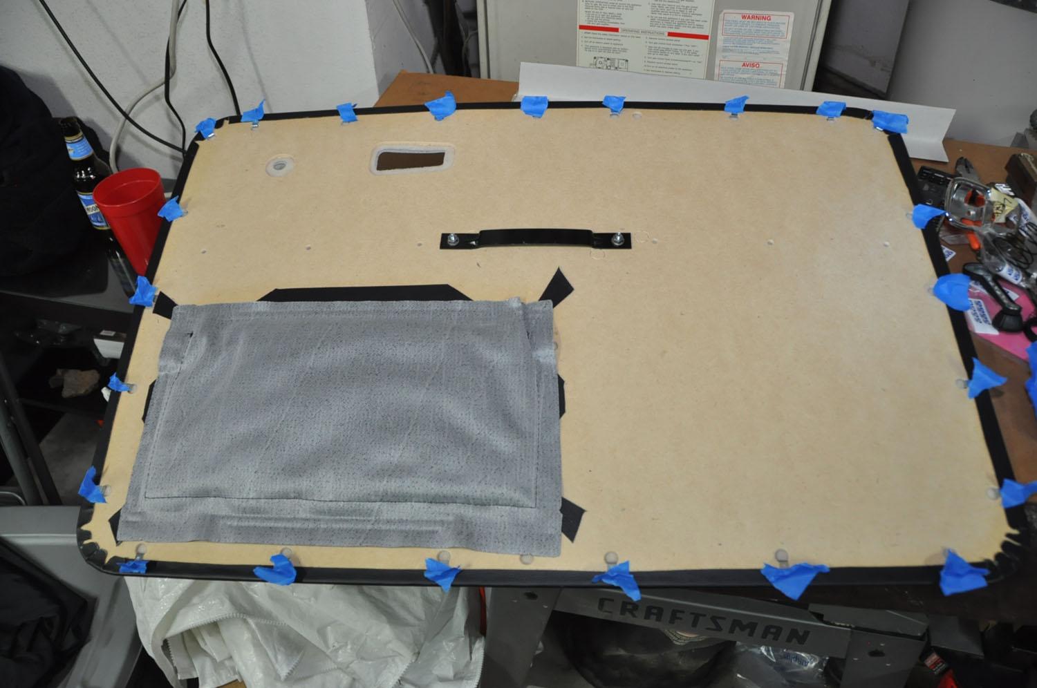

With the moisture / vapor barrier in, time to finish up the doors. I ordered the door panels from TMI and I am very happy with the quality and the fit. Again, not perfect, but they work well and they feel strudy.
Here is the vinyl side.
Here is the opposite side.
The panels are pre cut and have all the clip holes, inside door release and the window crank pre-cut. The only cutting I had to do was for the armrests...more on that later. Here are a few shots of the precut holes. As with any product, the panels are likely meant to cover multiple years so there are some clip holes that obviously did not work for my year. However, every hole in the door matched up with the clips in the door panel...no modification was required. Here are a few shots of the panel:
Here is a portion of the panel where there were two clip holes close together...just line up what works for your door.
Extra clip hole at the bottom as well.

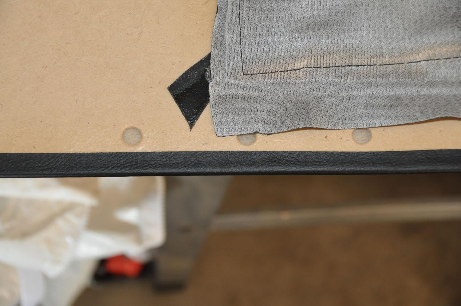

I started by installing the door clips. I installed each clip facing out towards the edge of the door panel.

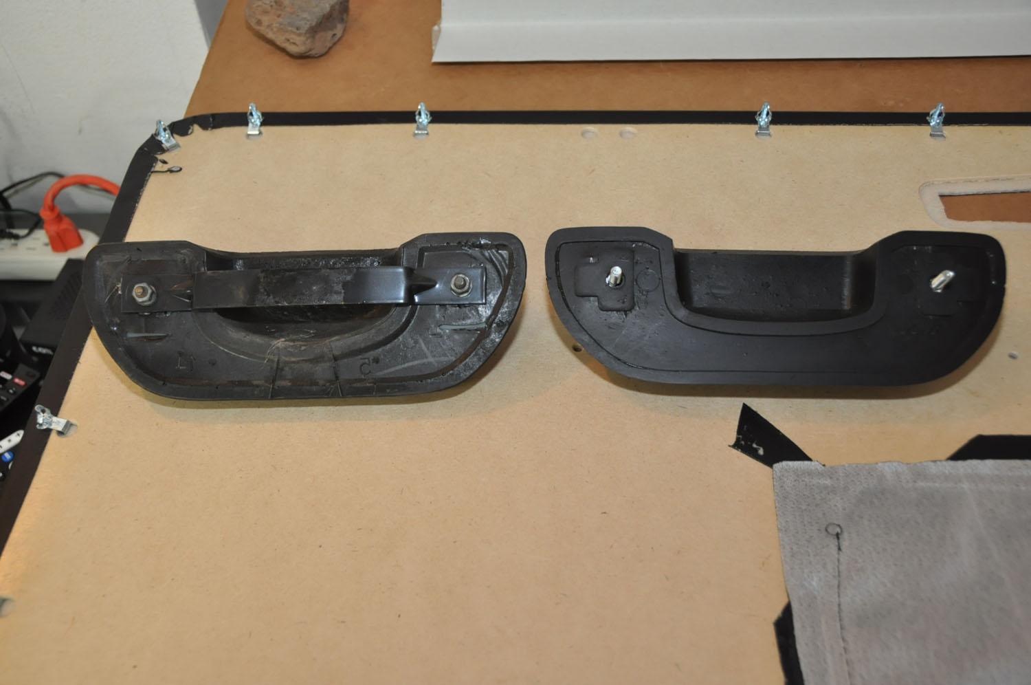

With the clips installed, I moved on to the armrest. Here is the old one compared to the new one...excellent match.
The armrest attaches to the panel via a metal bar. The armrest has 2 posts that insert through the panel then are attached with the bar, a washer and nut for each post.
Here is the bar all cleaned up.
The panel has pre cut holes for the armrest.
Using the distance between the 2 bolts on the armrest, only one set of holes lined up. To minimize errors, once I found the correct holes to cut, I shaded the holes using a pencil. I did both panels at the same time using both armrests to make sure the holes I cut were the same holes on each panel. Using the armrest holes there was no way to make a mistake.
Once I had the holes indentified, I used an exacto knife to cut out the panel board then pierced a hole through the vinyl at the center of the hole. I then pushed the armrest through the cut holes. Once the armrest bolts slipped through the vinyl and through the hole, I attached the metal bar.
Here is the armrest installed.

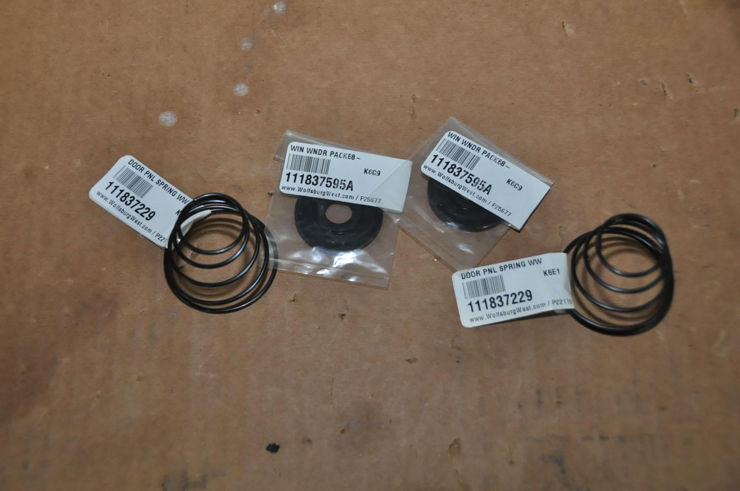

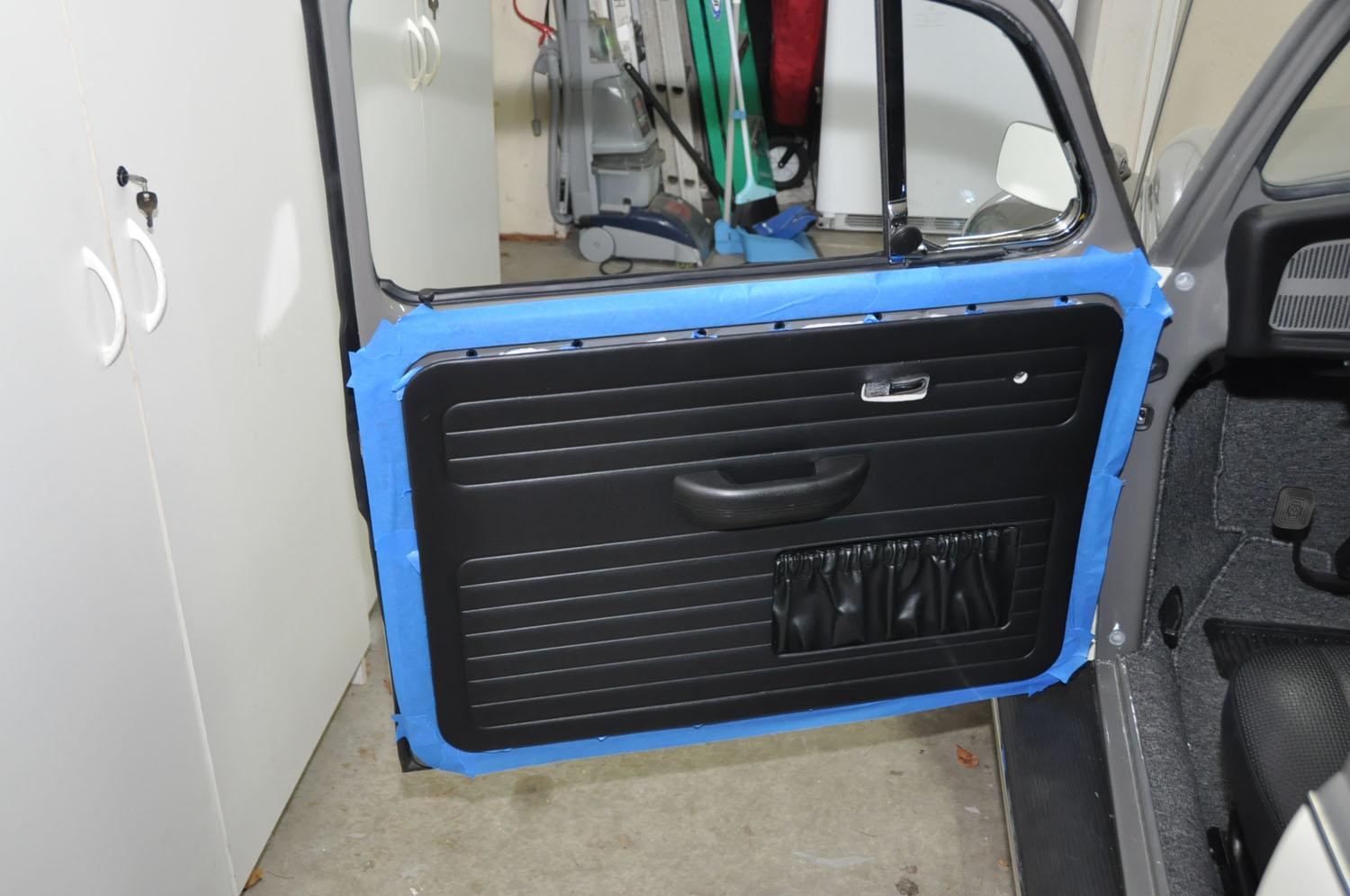

I ordered new springs, plastic collars and window cranks. The spring goes inside the panel around the window crank hole where the crank attaches to the regulator. I installed the spring with the smaller end facing the door and the larger end against the panel.
Now the panel is ready for install. I put tape all around the inside of the door to prevent scratches on the paint. The panel rests on the hook in the middle of the door. The panel bar, which holds the armrest, slides into that hook. Makes sense so that when you pull on the armrest to close the door, the panel will not pop off. So, you have to have the panel slightly higher than the hook then lower it onto the hook. This puts the panel clips directly on the door paint if not protected.
Once the panel was resting on the hook, I checked all the clips for alignment into the door seals and starting pushing the clips in starting at the top then working my way around until they were all installed. They popped in easily and were very secure.
With the panel installed, I installed the chrome piece that goes around the inside door latch pull. The photo is before I polished it up using a very soft steel wool and a soft rag.
The inside door latch slides into the chrome piece and the chrome piece is attached with a screw into the door. There is a pre-drilled hole and everything fit nice. The pre-cut opening in the panel did not need any modification. The screw is in the picture below, I installed it so I would not lose it.
Time for the window crank. The collar fits inside the window crank and keeps the crank from rubbing against the vinyl and possibly damaging it. Here are a few photos of the pieces together then installed against the panel. The collar has a circular ridge on one side that fits into the window crank. The smooth side will go against the door panel once installed.

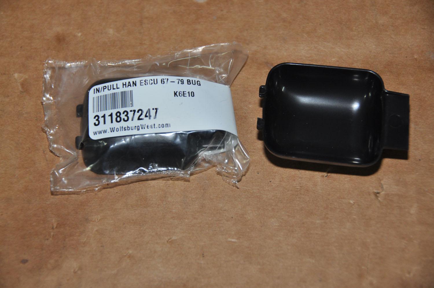

With the door latch cover and window crank installed, I installed the pull handle plastic piece next. It covers the screw and slips into the latch cover.

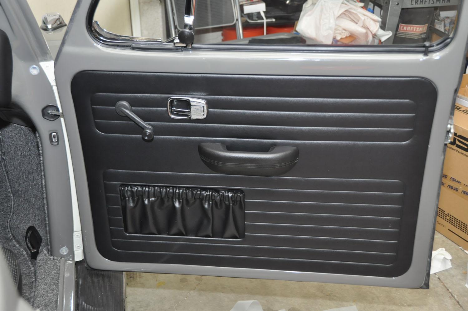

Here is a shot of the passenger door finished with everything installed. I am very pleased with how it came out...very clean and everything fit really well.
Now, I did one little thing differently when I did the driver door that I thought I would share. As careful as I tried to be, I did make a small scratch on the passenger door when trying to get the door penal to fit in the hook. There was one spot that I thought there was enough tape for, but I still butched it up. So, for the driver door, I took the time to tape the door AND also put tape over every single panel clip. The clip is what scratched the passenger door. This worked like a charm and allowed me to install the driver panel much quicker since I had more protection.
Here is the door panel with the clips covered.
I still covered the driver door with tape even with the clips covered. here you can see the tape covered clips and the door.
Here is the final install of the driver side door panel. No scratches.
The doors are officially done. Also, the window is getting easier and easier to roll up and down. I try to work the windows everyday even if I am not driving the bug.

I also purchased a radio frame from Wolfsburg West in case I needed to expand the pre-marked opening in the dash pad for the stereo. I did not want any of the pre-marked lines to show after the stereo was installed and I was not sure how things would fit.

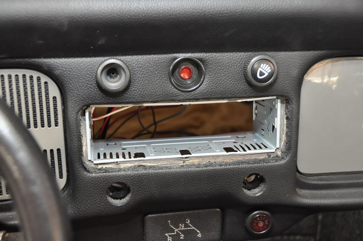

I was not sure how the dash pad and the cut out in the metal would line up. The dash opening was cut 20+ years ago for a single DIN stereo so I did not have to make any further cuts to the metal (it seemed like a good idea to cut the dash when I installed a stereo back in ’89 – oh well). So, pushing from the trunk area, I decided to use an awl and lightly push it through the corners of the dash opening. This gave me an idea of where I needed to cut the dash pad and also how the pre-marked opening on the dash pad would line up to the opening in the dash itself. I then used the awl to make a series of holes along the metal opening.
Once I had a general idea where the dash pad needed to be cut, I used an exacto knife and another sharp blade to cut into the dash pad.
At this point, I really took my time and only shaved off a little amount each time as I tried to fit the stereo sleeve into the opening in the dash pad. I did not want to make the opening too big and end up in a situation where the stereo frame is not big enough to cover the cuts in the dash pad. This really did take a while. Cut a little, see where the sleeve was getting resistance, and then cut a little more. I wanted to stay as close as I could to the pre-marked cut out in the dash pad. Finally, I was able to get the sleeve to slide in. However, when I installed the stereo with the trim ring that came with the unit, the pre-marked areas of the dash pad could still be seen since the pre-cut marking was larger.
So, I decided to use the trim ring I purchase from WW, which required me to cut the dash pad more until the WW trim ring fit flush against the pad, covered all cuts and also the pre-marked part of the dash pad.
Here is the WW trim ring installed. It was bowing a little on the top middle, so I did cut a little more in that area and it straightened out (forgot to take picture).
Now that I was going to use the WW trim ring, I needed to make the stereo would slide into it. The WW trim ring opening was too small. I used my Dremel and slowly made the opening larger until the stereo with its own trim and the faceplate all fit flush. Again, I just shaved off a little at a time and make sure I went around the entire opening to make sure nothing looked cock eyed once installed.
Here are shots of the complete unit with sleeve and without to check the fit before I lock things into place.
How it will look from the front once installed.
Once everything was ready, I re-installed the sleeve and bent the tips in the body of the sleeve so the sleeve would stay in place. Once that was ready, I slid the stereo in, checked the fit, made a few slight modifications to the WW plastic ring, then installed the stereo so it was flush with the dash pad.
I like the look with the WW trim ring and the fact that the pre-marked part of the dash pad is not visible and neither are any cuts to the opening. Here is what it looks like installed in the dash.

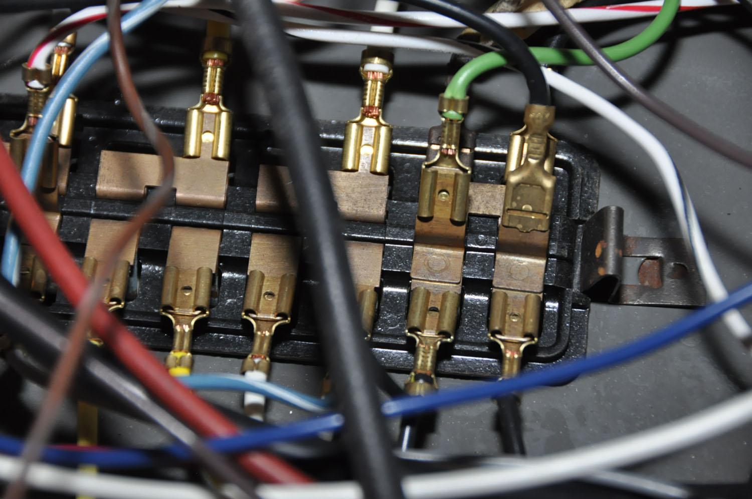

The most important tool for this is a multimeter of some kind to determine where to connect the wires that need power – either constantly or when the key is turned on. Here is the meter I purchased when I installed the main wiring harness which was worth every penny. I also made notes in my build notebook of the stereo wires, what they are used for and my notes as to where I was going to connect everything. I used this as a road map so I knew what I was going to do before I started.
Working in the trunk, and looking at the fuse block, I used the multimeter to see which fuse had a constant 12 volts on both sides of the fuse WITHOUT the ignition turned on. Wiring diagrams showed that the fuse on the far left (again facing the fuse block from inside the trunk) was for the radio. That fuse did not have any connections to it – see below.
Both the top and bottom registered 12 volts so I knew I could use that for the Yellow wire which needed constant power. I worked my way across the block to see if any other fuses had a constant 12 volts just to make sure. I used the one designed for the radio. Next was to find a fuse that would receive power once the ignition (key) was turned on. Working my way over, the second from the right would receive 12 volts when the key was turned on and did NOT register anything when the key was turned off. I decided to use that one for the Red wire which would turn the stereo on once the key is turned. It is the green wire on the fuse block pictured below.
I scouted the rest of the wire connections then proceeded to wire everything up. First step, was to disconnect the battery now that I identified where the wires would connect.

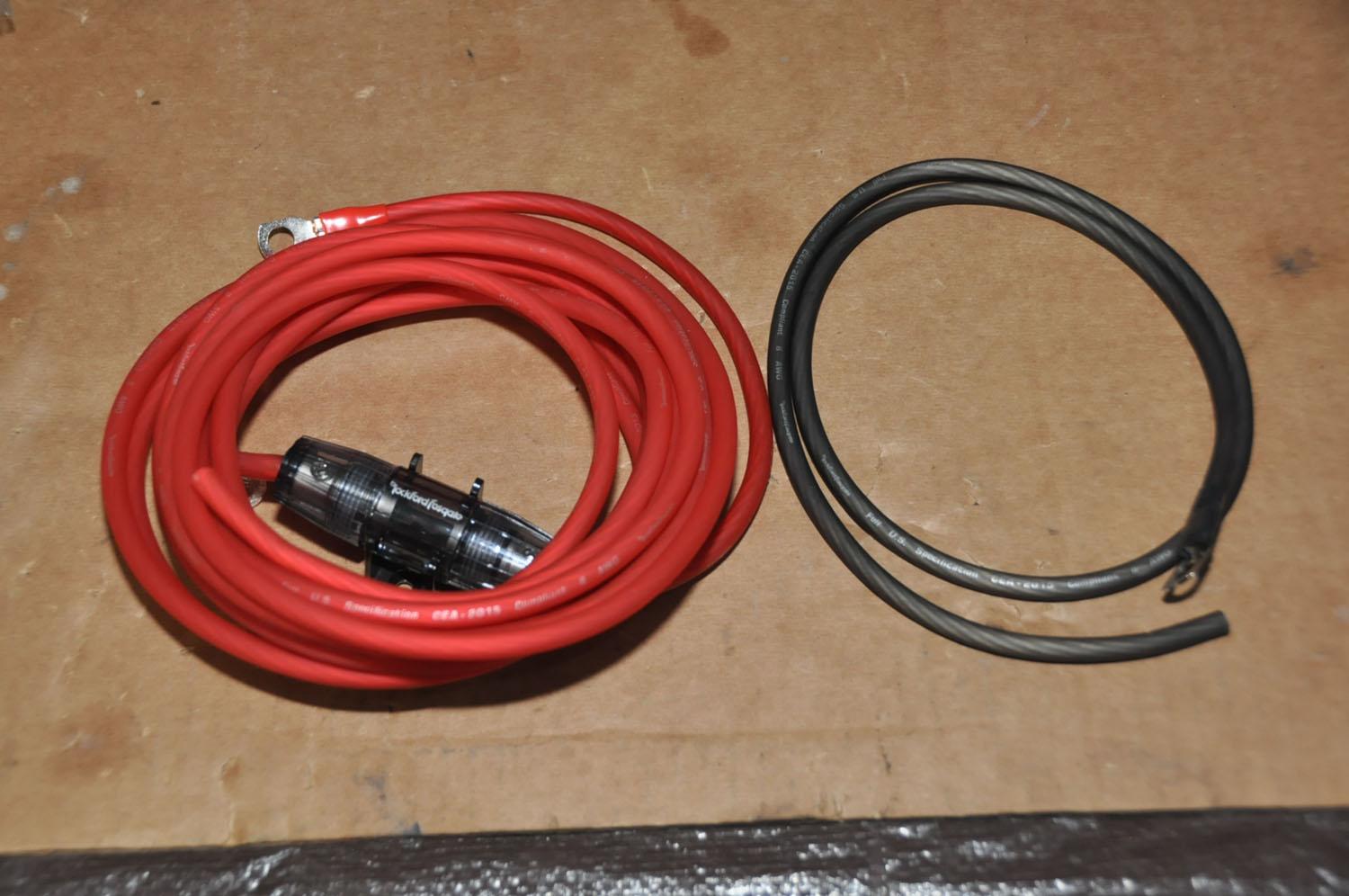

Now for the amplifier. The amp will receive the RCA cables and blue wire from the head unit. The amp also needs power and a ground as well. I purchased a wiring kit which had heavy gauge wire and an in-line fuse to connect everything. The wires also have end connectors which fit over the battery connection bolts which made things easy. Here is the kit.
The wire length in the kit provides way more wire than needed for our bugs, especially if the amp is in the rear of the car. I ran the wires from the amp to the battery to determine needed length, the cut the wires as needed. This may be overkill, but once I cut the wires, I soldered the copper ends of the wires. I used 2 block as a pair of “helping hands” to solder the ends.
I then connected the RCA cables, blue remote wire, power wire and ground to the amp. I then zip tied them together then ran them under the rear seat to the battery.
So I can work my way rear to front, I then cut speaker wires to length, soldered the ends, then hooked up the speaker boxes.
I then moved to the front stereo wiring before I connected everything to the car battery.
I added connectors to the stereo wiring harness for the black, yellow and red wires. I added white wire to the orange wire to add length. Since I knew the black wire would be used with a screw, I used a round connector.
With all of the connectors added, I hooked up the harness to the stereo then began wiring everything up. I started with the yellow wire. Here is a shot of the connection:
I then hooked up the black ground wire to a screw that is screwed into the metal bracket that holds the wiper motor. There was already a ground wire there, so I just added the extra wire then screwed it in. Hard to see in picture, but it is the black wire that is above the stereo and behind the stereo metal holder strip.
That left the red wire and the orange wire (with the extra wire added on). These wires had to be added to other wires that were already connected. When I gutted the car, I kept most of my parts. I was happy that I kept the connector splitter that was used with the old wiring – I had 2 which I needed. Here is a picture.

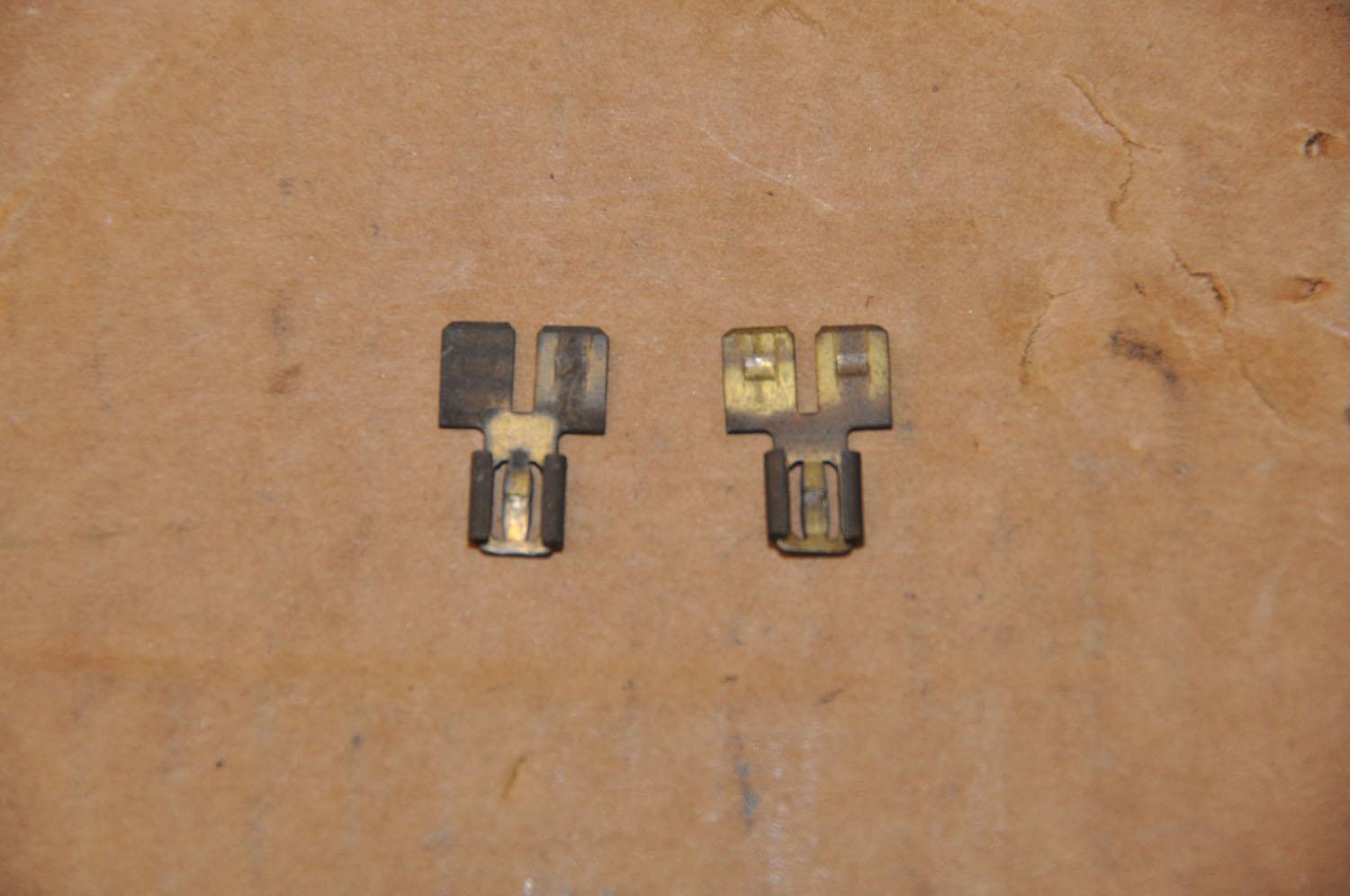

I cleaned them up to ensure a good connection. Here is a before and after of one of the connectors.
Using the splitter, I connected the red wire (ignition) to the fuse block.
That left the orange (with white wire addition) wire for illumination. I connected that wire to one of the lights for the speedometer. I unplugged the bulb connector, attached the splitter, then connected the wires.
The blue remote turn on wire from the wiring harness connected to the amp which was already pictured. Now that everything was wired up, I moved back to the battery to hook up the red wire from the amp to the positive battery terminal and the ground wire from the amp to the negative battery terminal. The negative battery terminal has a wire that goes to ground, so it was easy just to hook up the black wire to the battery. Once power was restored I turned the key and the stereo turned on with no sparks, no smoke, no flashes…pure relief. I re-installed the rear the battery terminal cover, the rest of the interior pieces then tested everything out.
Here is the stereo turned on and working.
