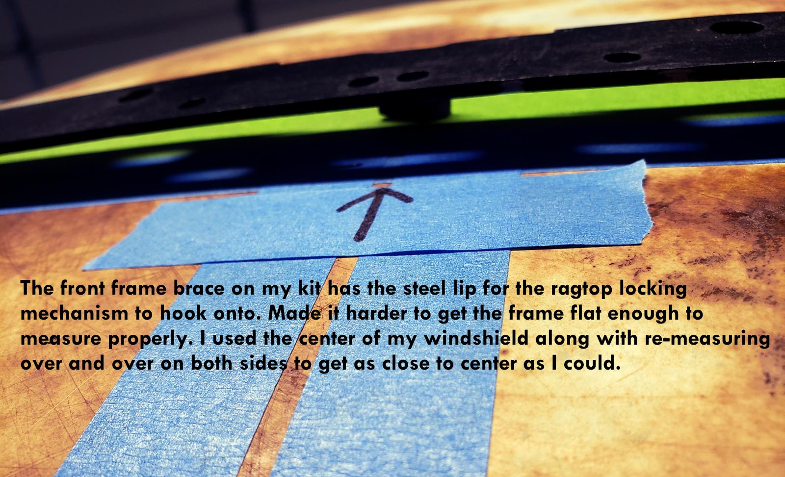

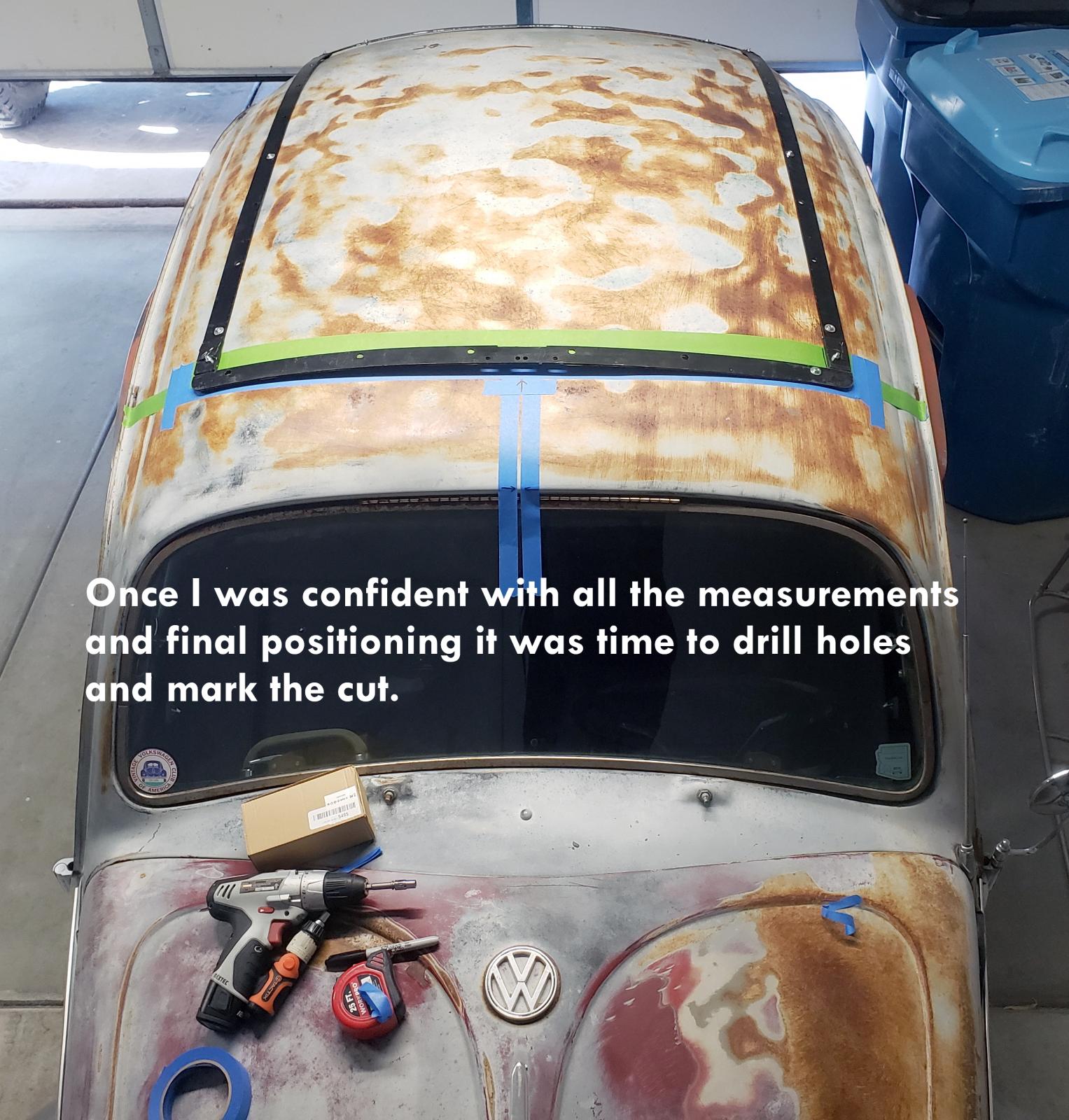

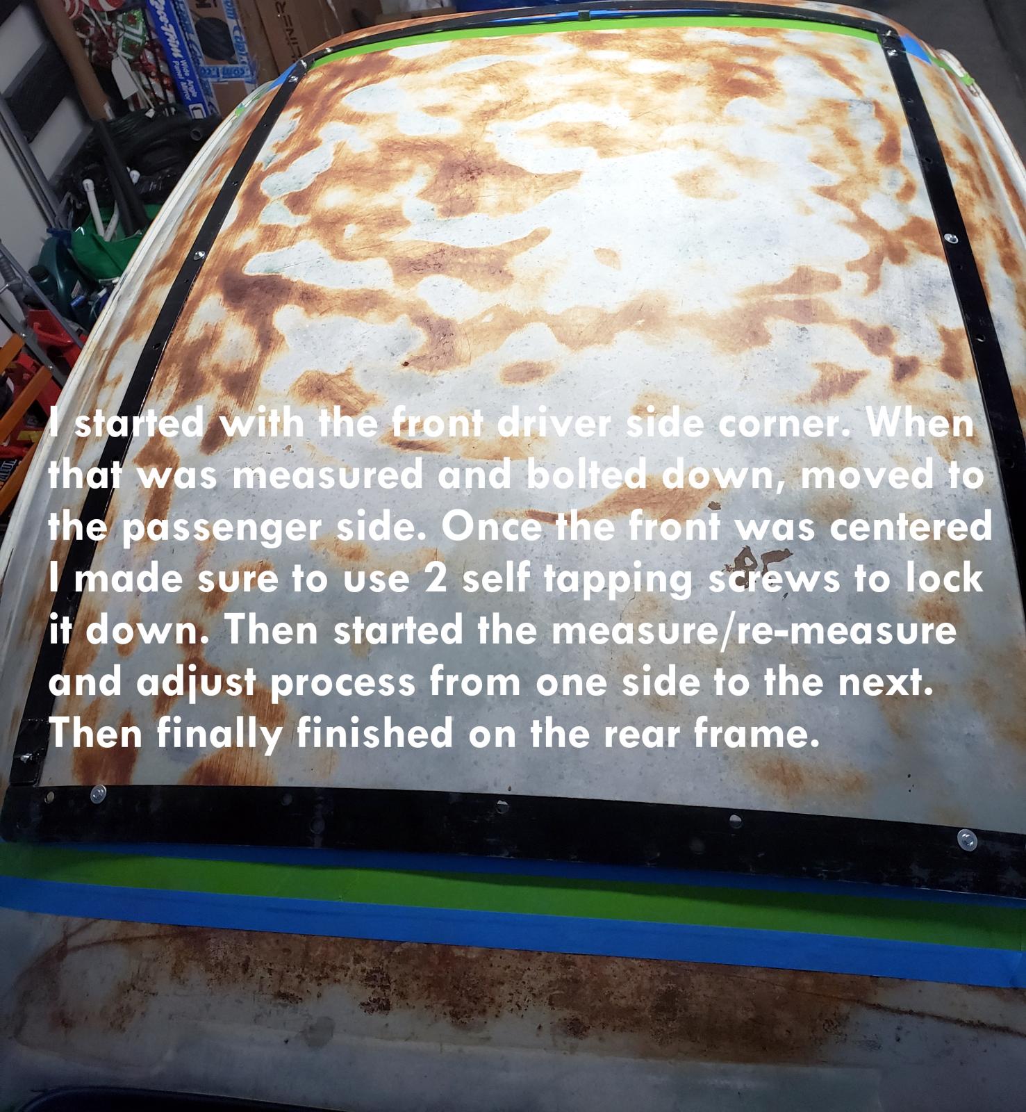

Not a bad weekend project. The key is to measure and measure and measure some more. Another tip would be to cut well outside the line you trace within the frame.
