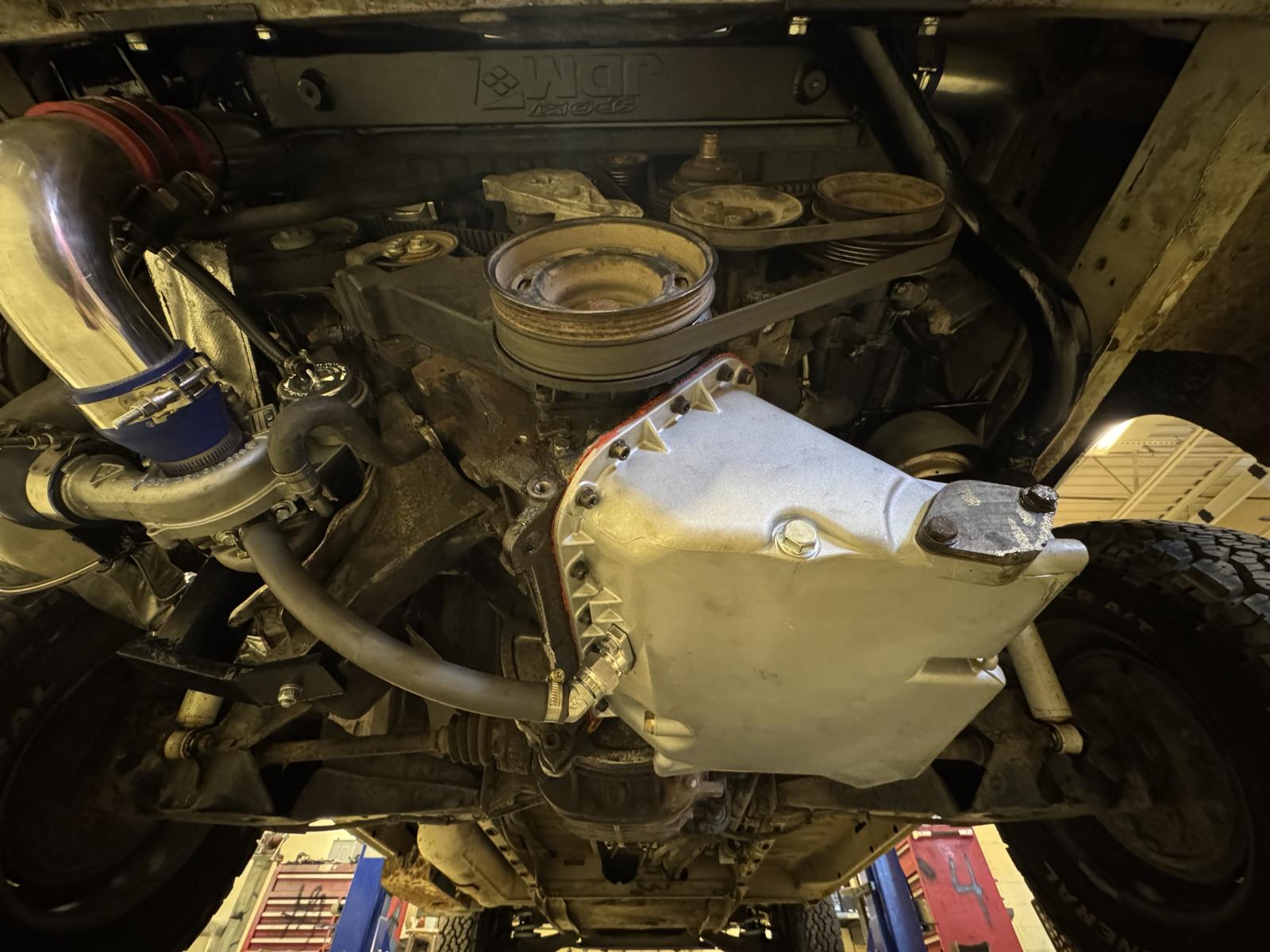

Okay- got the motor mount made out of metal by taking some 1/2” plate and welding on thick tubing as spacers to put bolts through that go into the block. It’s all steel now.

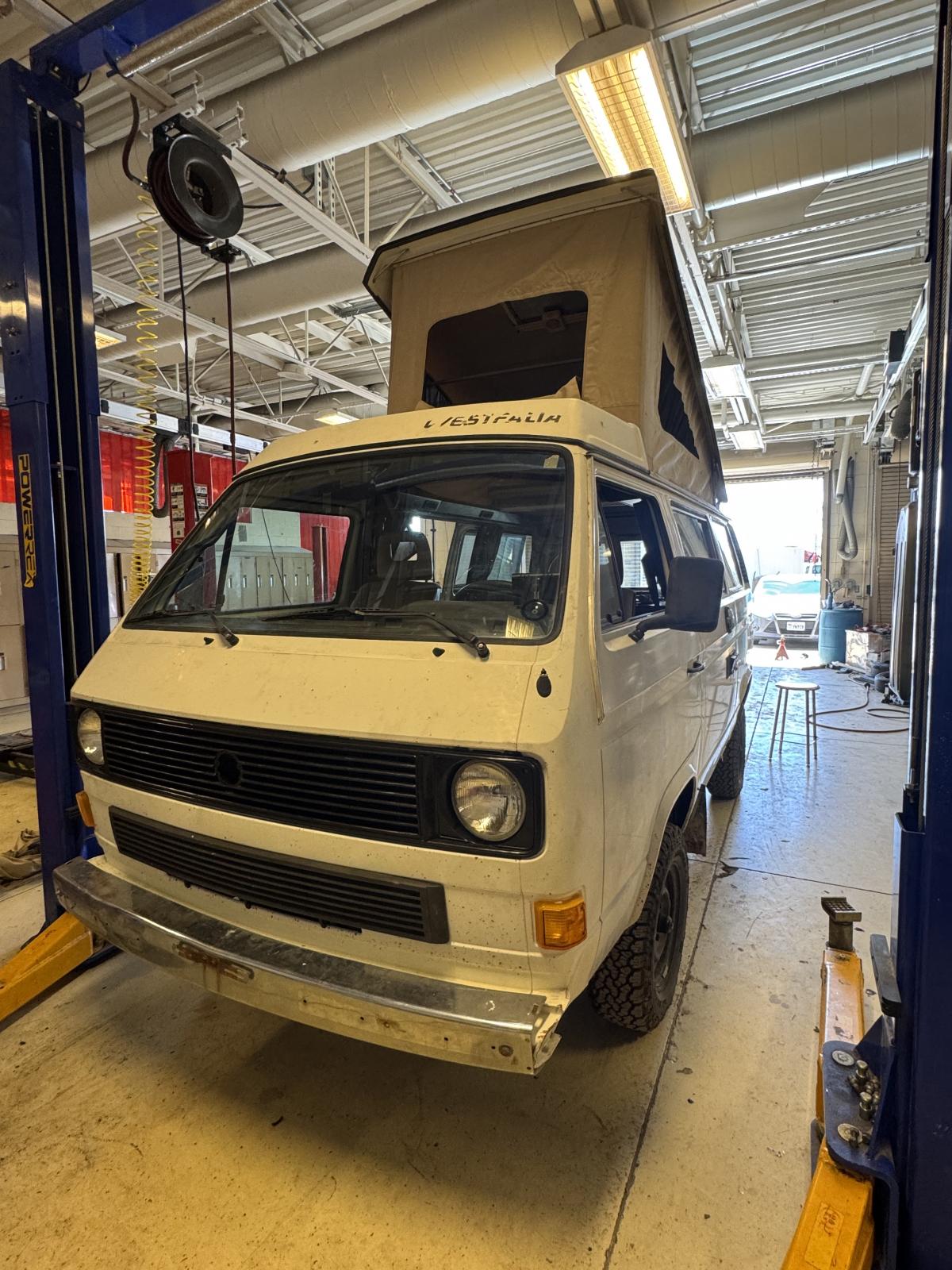

Got a 1.5” GoWesty coil spring lift kit on it with the longer ball joints. Those ball joints did not want to come out, it took an air chisel to get them to lift up out of place. I also put two half inch spacers on either side in the rear just for a bit more clearance of the motor and I’ve heard the rear springs from Gw can sag with time. I like how it looks, handling a little different but I’ll get used to it.

Took it a little off-road and it was so much fun! I really don’t think there’s anything else for me to do on it except take it out for some adventures! I’m sure some more adjusting and re-working things will be in order as time passes but for now I’m very happy with how it sits and I’m ready to put it to the test.

Shots of the motor:
