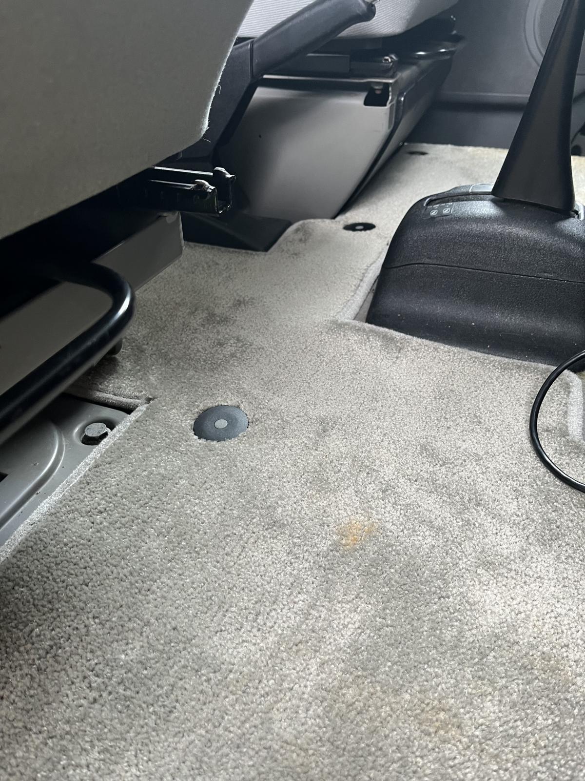

With the 2002 EVC slated to transition back out to the western U.S. in a couple of weeks finally, I'm taking care of a few small items that have been on my ToDo list. One is to install grommets into the Lloyds 1-Piece Front Cabin floor mat (purchased through EuroCampers I think?? ... a few of the typical vendors market them).
Anyways, the Lloyds mats are great but they come with odd tie-down strips that don't function at all with the stock OEM VW floor mat posts.
Used a socket and a torch to bore through the mat in spots that line up with the OEM VW posts that are already in the cabin carpet -- then installed aftermarket 2-piece grommets in the holes. Now the mat sits nice and flat and won't move. If you have a 1997 or prior van that didn't come with posts, you can get screw in posts as part of a package with grommets.
