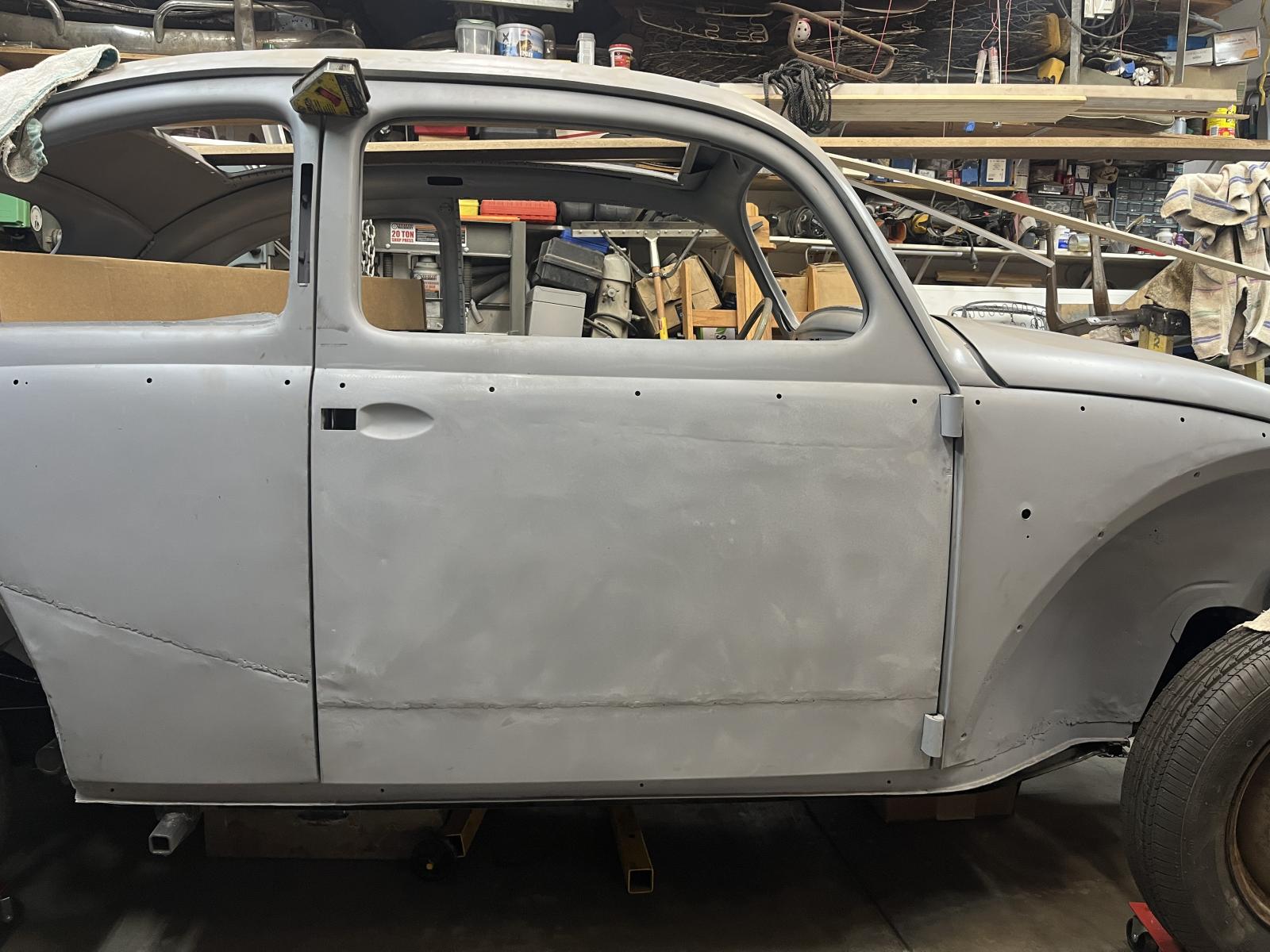

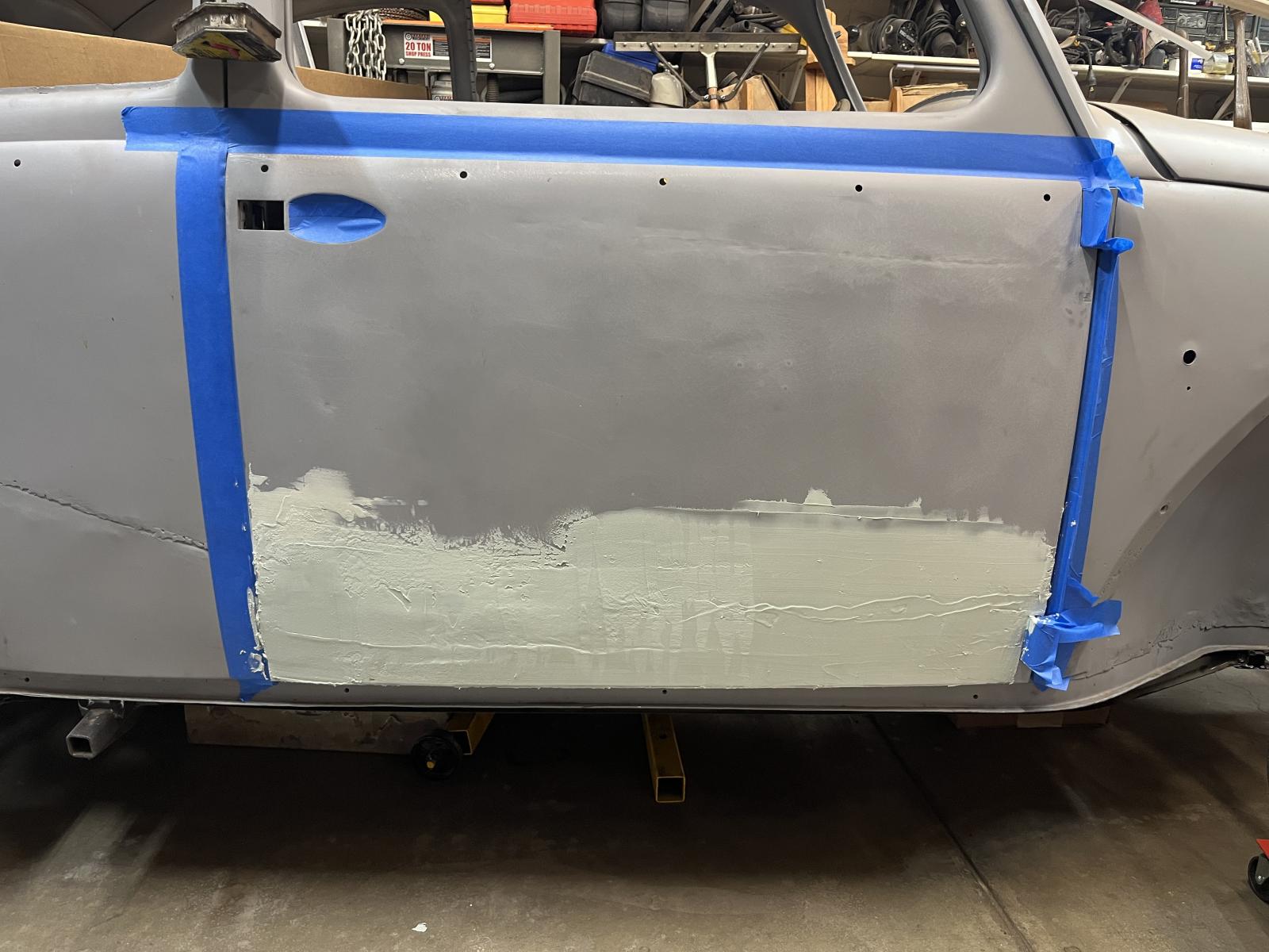

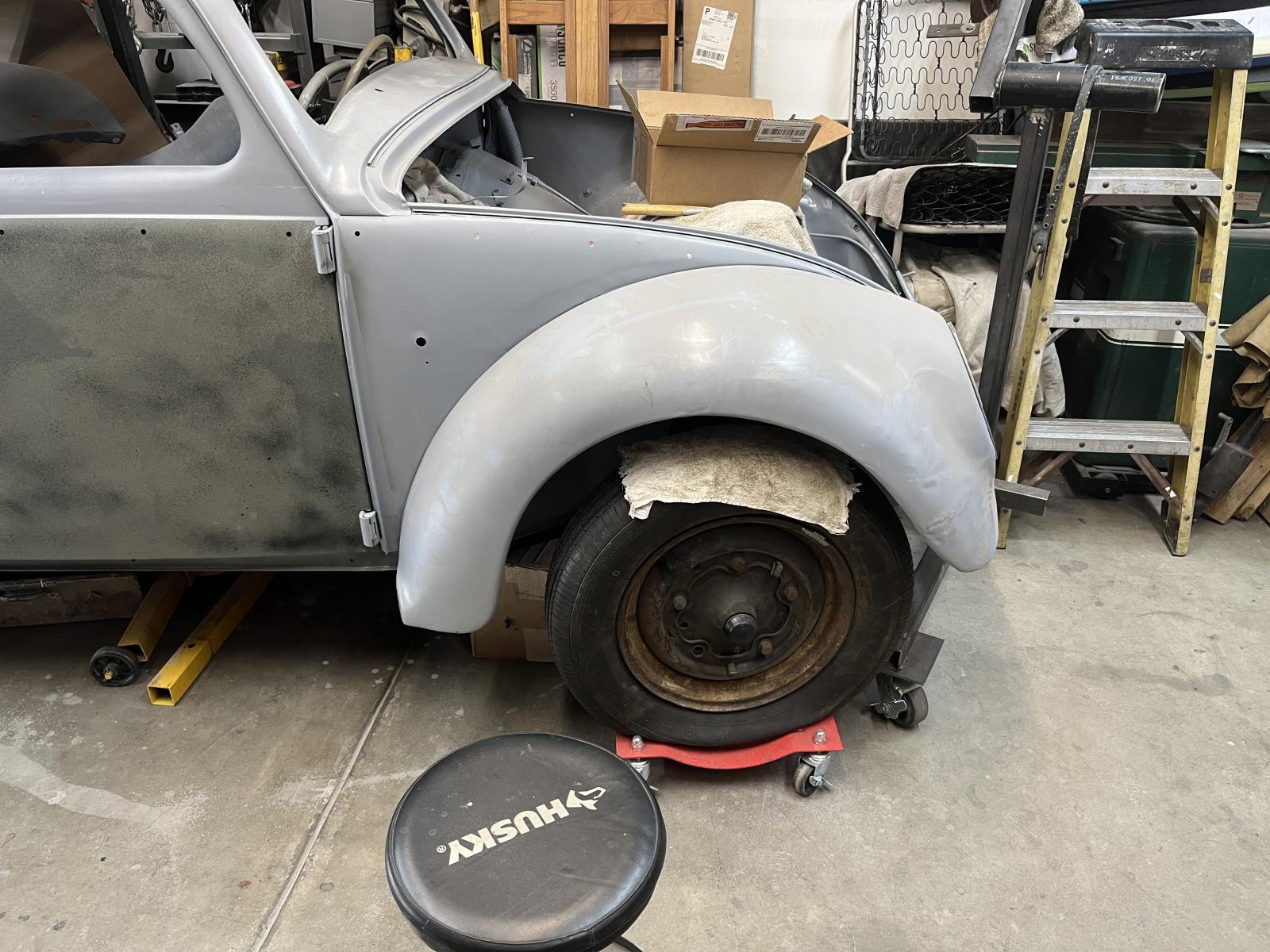

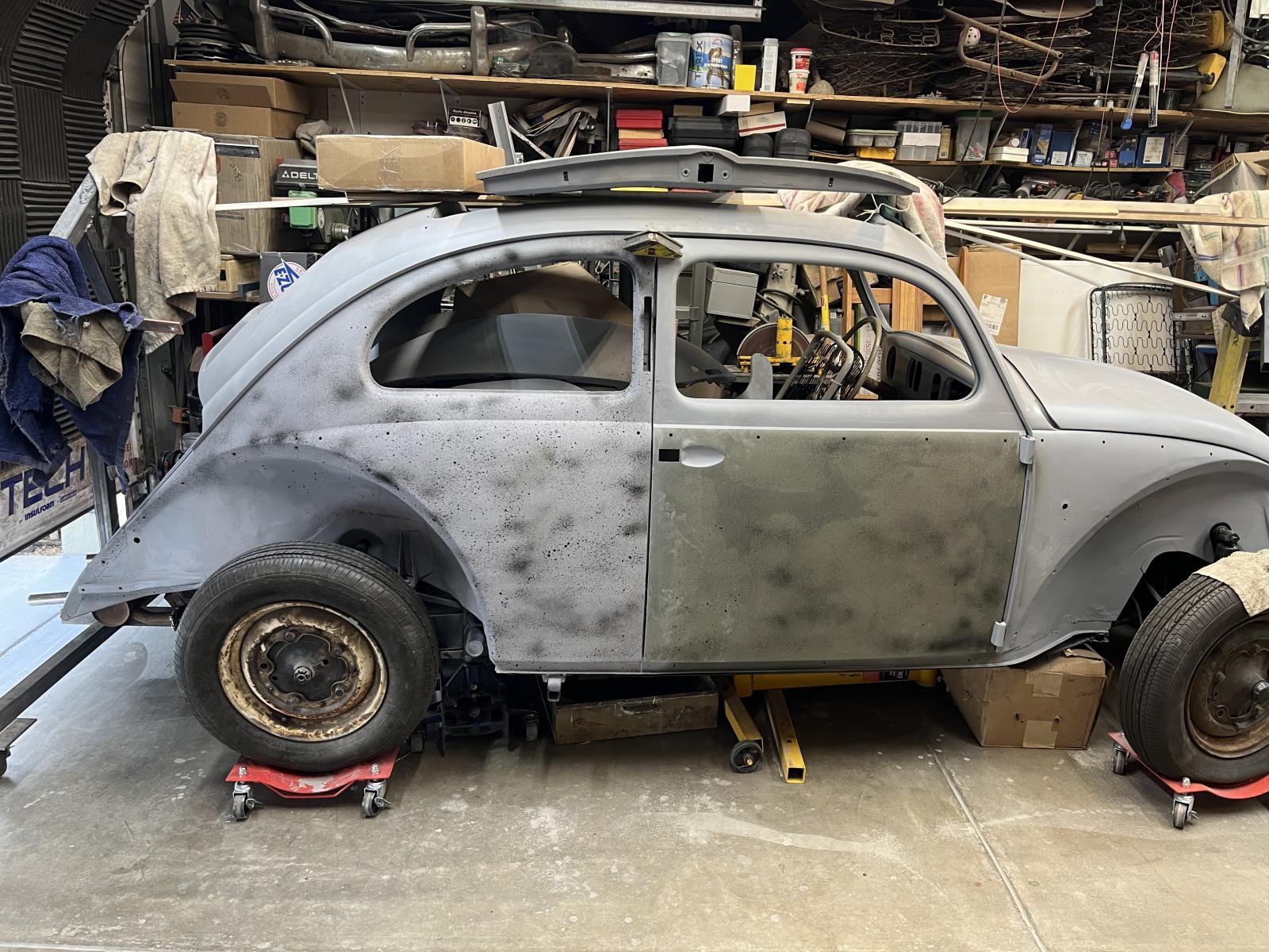

Got in another 4 hours! Got the first layer of plastic filler on the passenger door! Woot! WOOT! Guess I am starting on the next phase of the project, SANDING. Have I mentioned that I despise sanding! As a kid, my one job that I had was to sand all of the cabinets that my father would build. He built them, and I would fill the nail hole, sand out the faces and finished ends, being sure to ease all of the edges! I have years and years of experience sanding wood. But I can tell you it is very much the same!
Here is what I started with.
I had semi adjusted the door. Just something to verify that it fit still and would hang correctly in the opening without spending a ton of time playing with it! Gaps are good, sitting an 1/8” too low, but still has room to adjust that amount.
I then ran some tape around what I was going to work on. Then took my open hand, laid it on the door skin and felt the entire surface, mapping the surface issues with that hand. I then filled the bottom in and sanded it to shape, or as close as I could get without removing to much material!
Followed that up with spreading more Xtreme filler onto the door skin, building on top of what I already laid down and hitting the spots above that area. Then sanded it all. Then filled it all again, followed by more sanding!
It finally got to really close, so I shot a light coat of primer on it and then speckled some black on top of that!

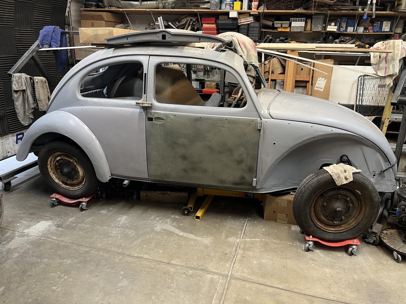

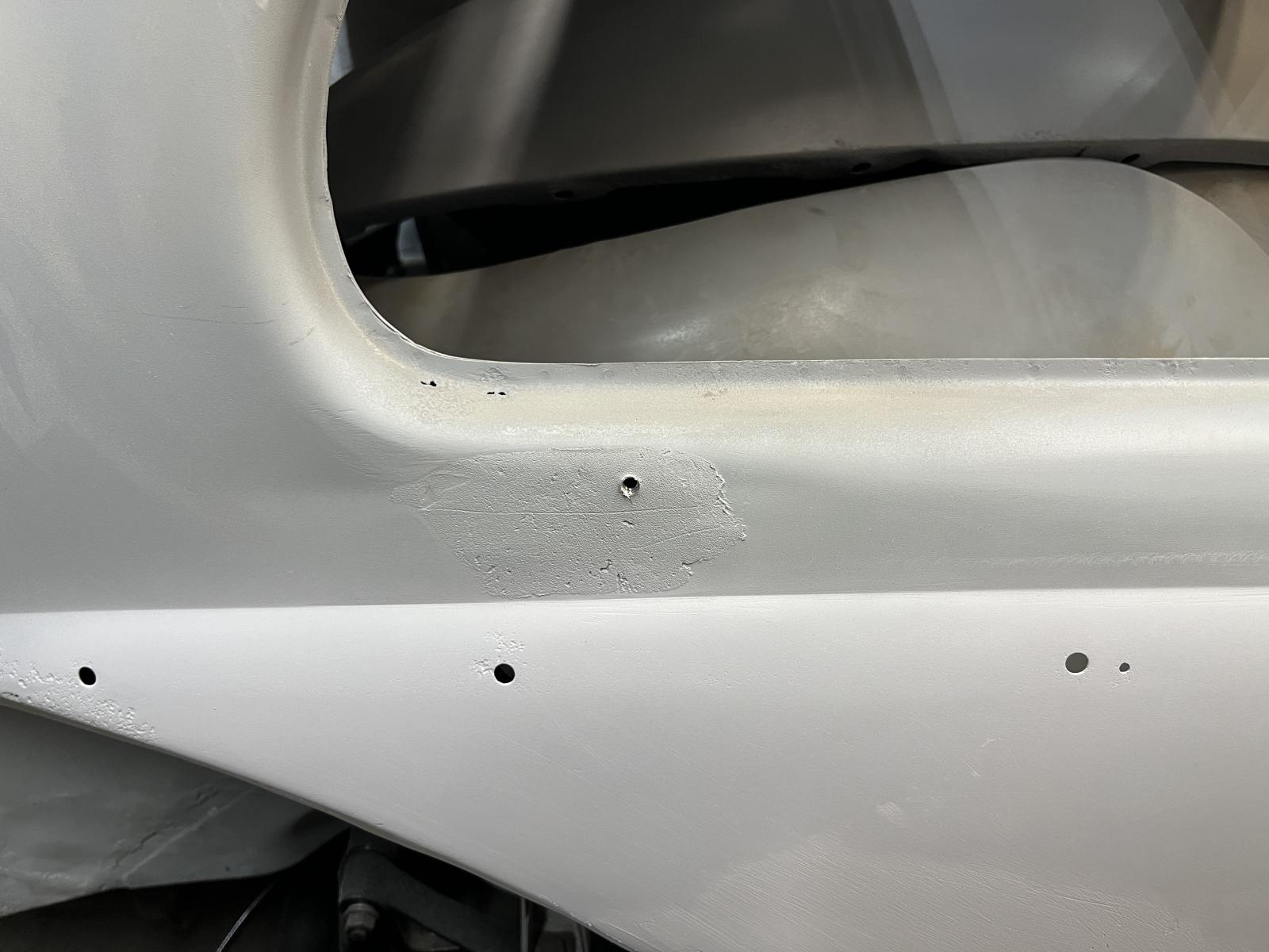

Got another hour in after work yesterday! Managed to spread some filler. Sand it down to within reason and prime it up again. It will require a little bit more filler, but is about 80% there!
And the best part is I can no longer see my weld seam! The rear quarter panel was the first piece of steel I replaced, if I am remembering that correctly! Felt great! I should have a few minutes this weekend to finish this panel off.

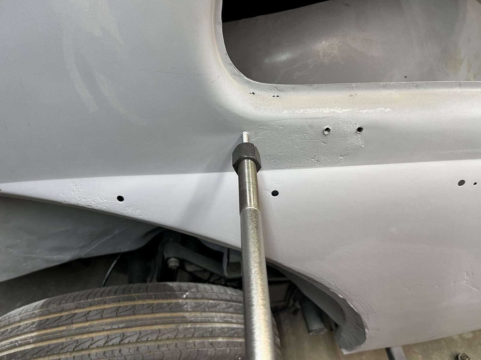

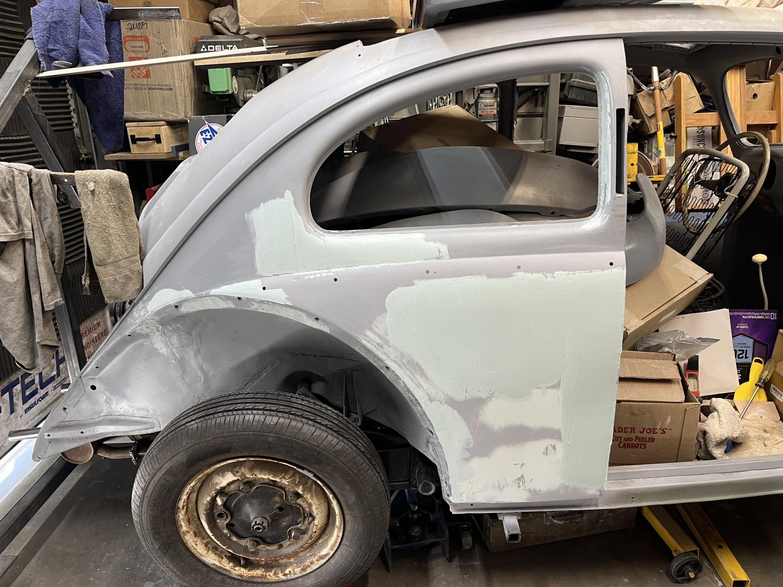

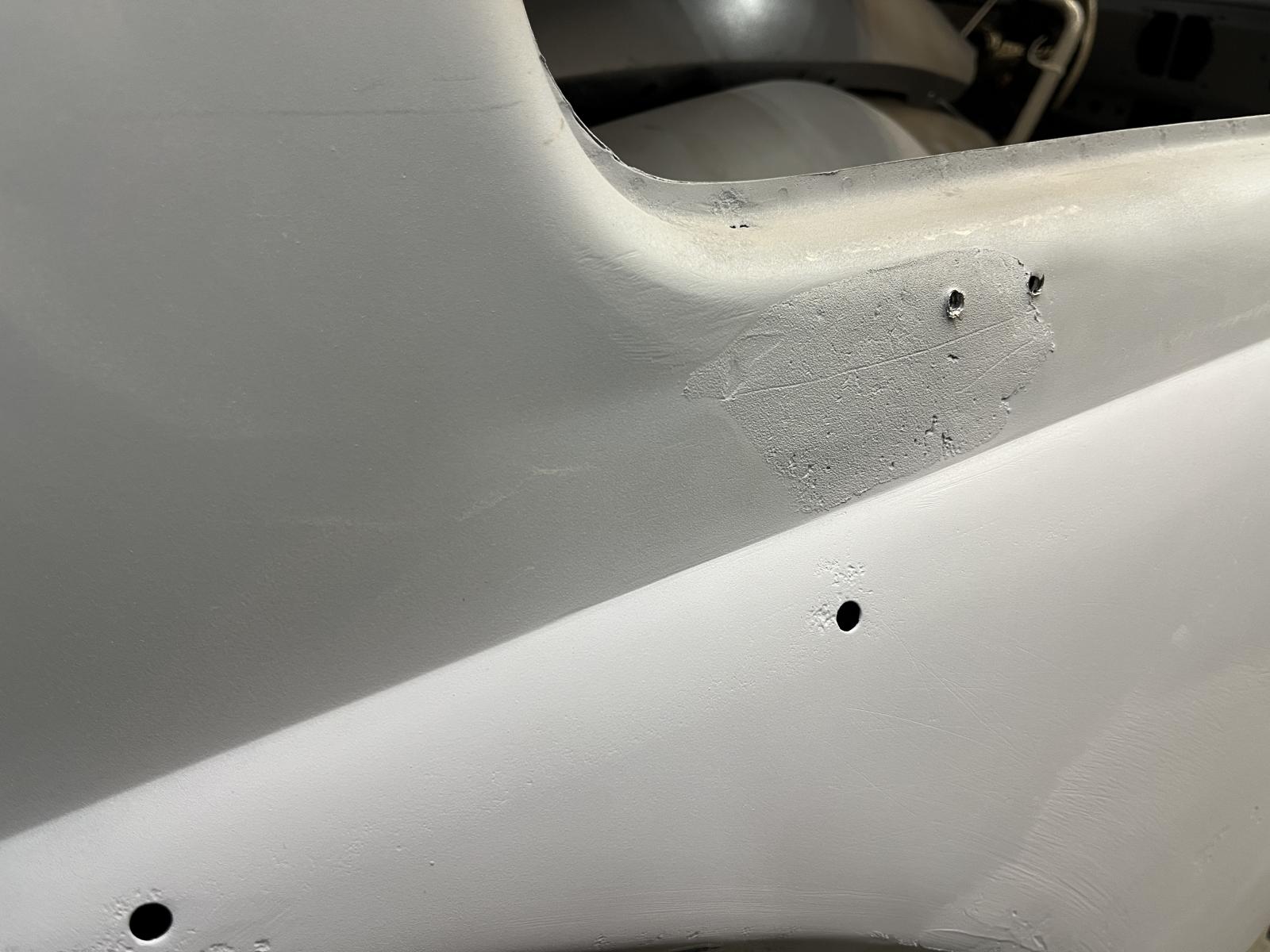

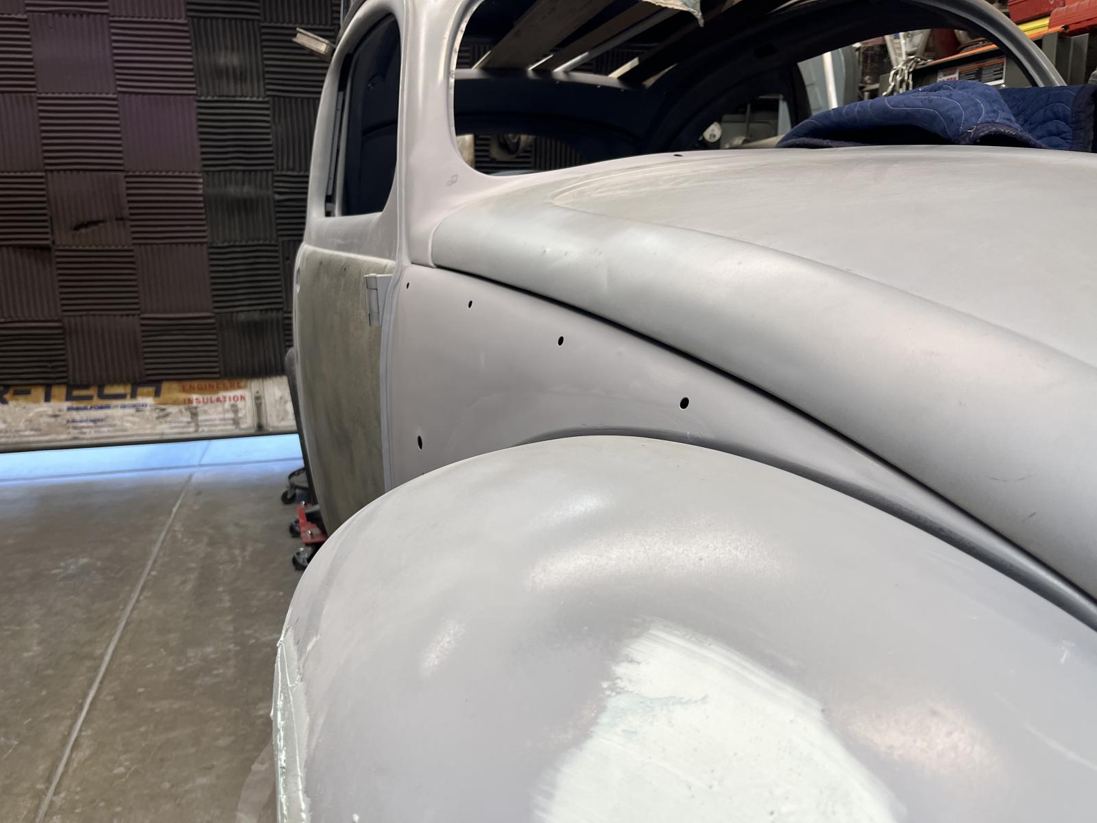

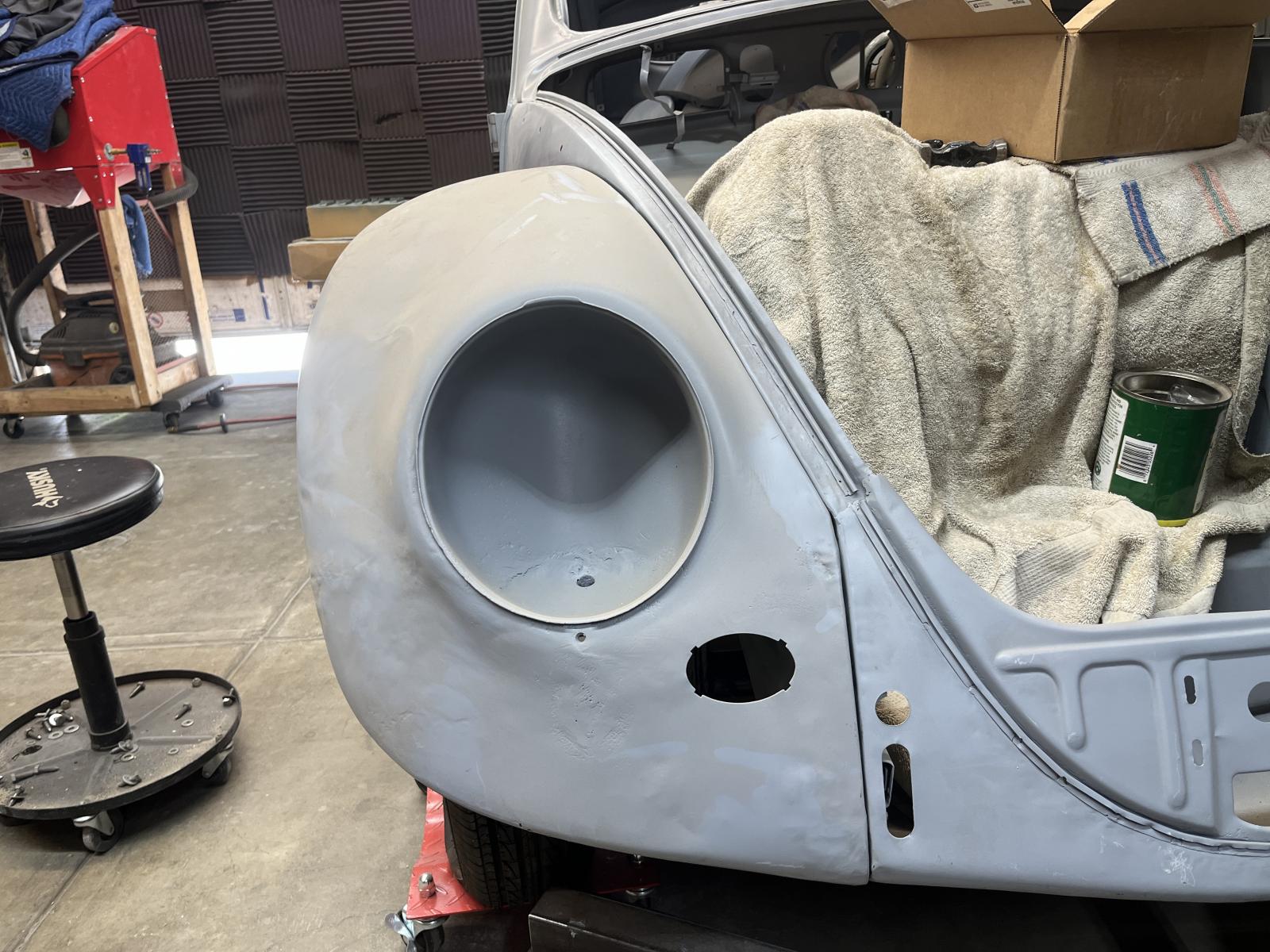

It was a Good Friday here in the temple of the Bug! Got in another 4 hours!
Finished off the roughing in of the rear passenger quarter panel. How it was left from Thursday. There is an old leaded patch right below the window. I have no inclination to remove the lead, as it seems like a solid patch. It just failed to cover all of the damaged area.
So, I decided to pull that crease out a bit while hammering out the opening a tiny bit. The curve was just off along this area, and I knew if I could stretch the steel out away from the opening, I would be able to hammer the high spot down in the window rubber area, which the pop-out window would need to seal against.
So, I started drilling and popping, while hammering along the crease!
One.
Two.
Three. Can you hear Sesame Steet’s the Count, counting?
4, 5, 6, 7, 8. There are 8! 8 holes along the crease in the panel. Let count them again, together…. You all get it!
With the counting done, it was onto the Duraglass filler. This is a missed step in many builds. If you know plastic fillers at all, you understand that they are sponges! They absorb water and hold onto it. Then the steel, which the sponge is attached to, gets hot, expands a bit and the plastic does the same thing. The moisture within, gets hot and starts getting free, from the expansion of the plastic, and wicks its way back to the hot steel, because that is just what happens in nature. Once the moisture hits the steel, the process starts. Say it with me, OXIDATION! Or rust, the 4 letter word we all do our best to control! (Ha, laugh with me on that one! More like denial.)
Anyways, that layer of fiberglass is a vapor barrier between the 2 hemispheres! Without it, the open holes in the steel would leech moisture. But now they will not! Thanks to the Duraglass filler! And here it is all smeared in!
After the filler cures, I use my dull razor blades and scrap down any high in the Duraglass. Then sand it lightly with 36 grit and apply the Rage filler on top of it.
Then sand that down with 80 grit.
I then rubbed the panel, marking the low spots. Refilled them with Rage, sanded, repeat. By the 3rd time it is as close to good as I can get right now. So I primed it. It is ready for a good sanding to show where the glazing putty can go!

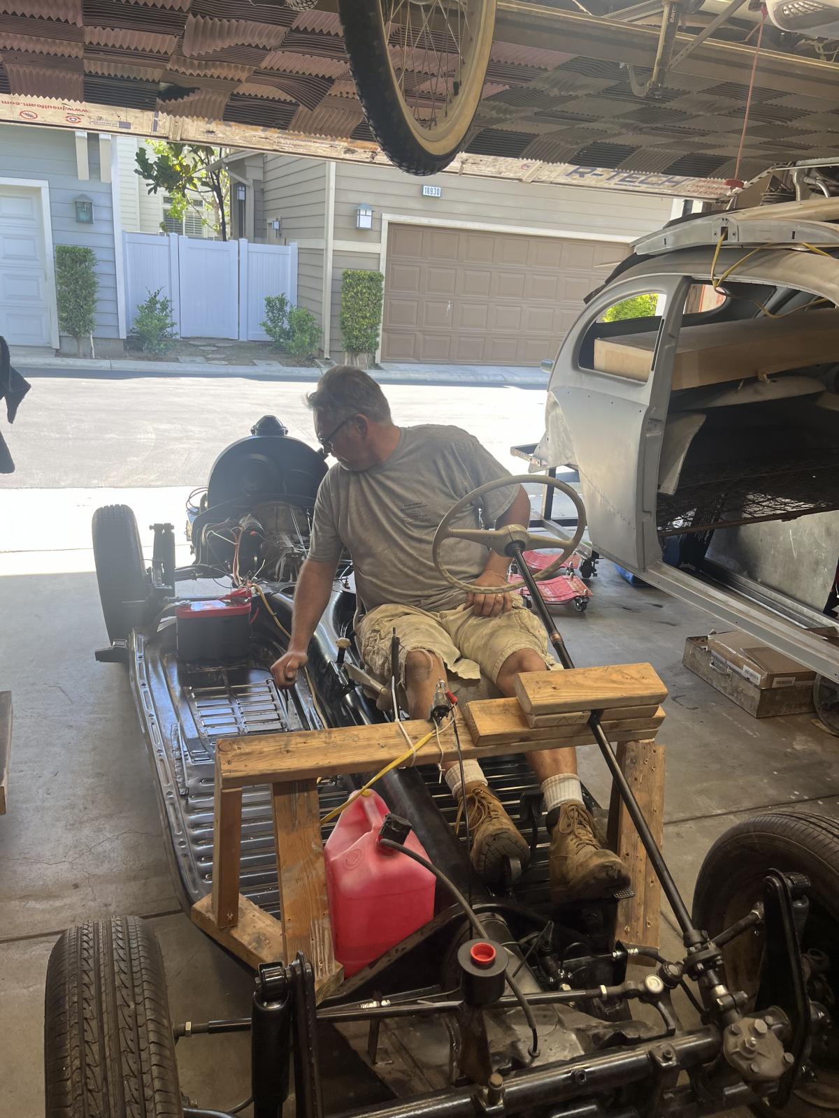

Thanks Matthew! It was fun and short lived. I have a few oil leaks to attend to, down the road. But it did run!
The neighbors, well the friendly ones, came out and were amazed that it finally moved out of the garage!

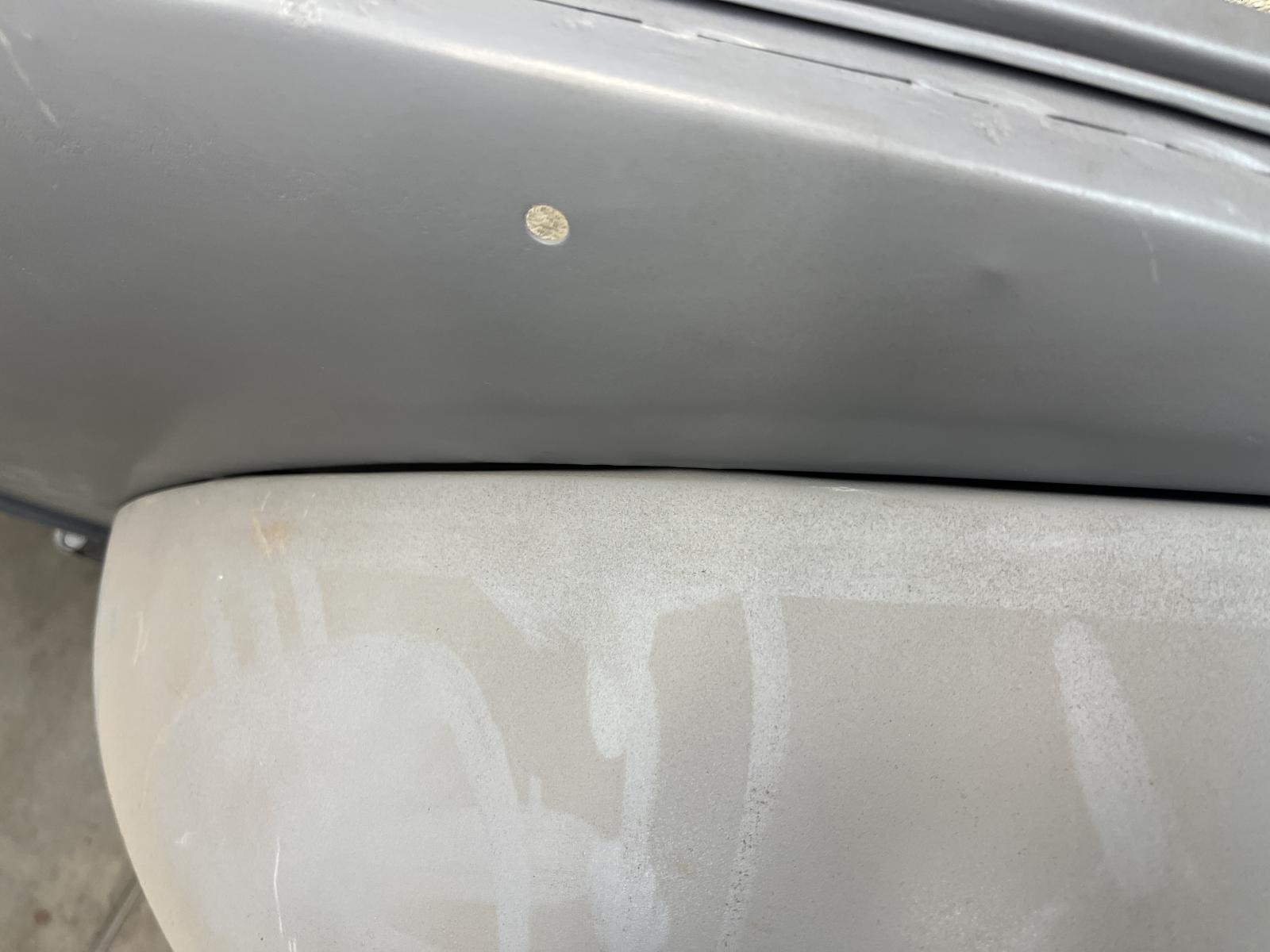

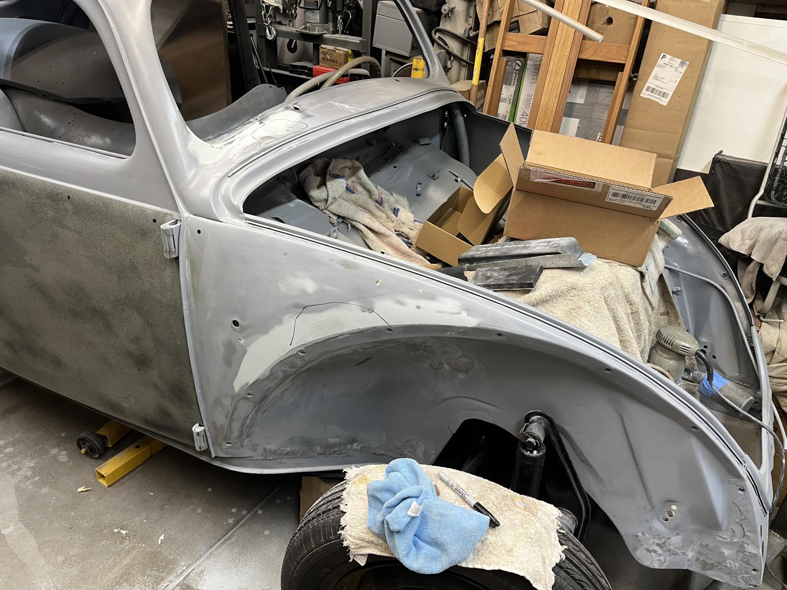

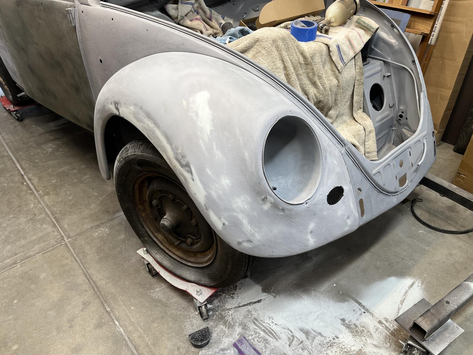

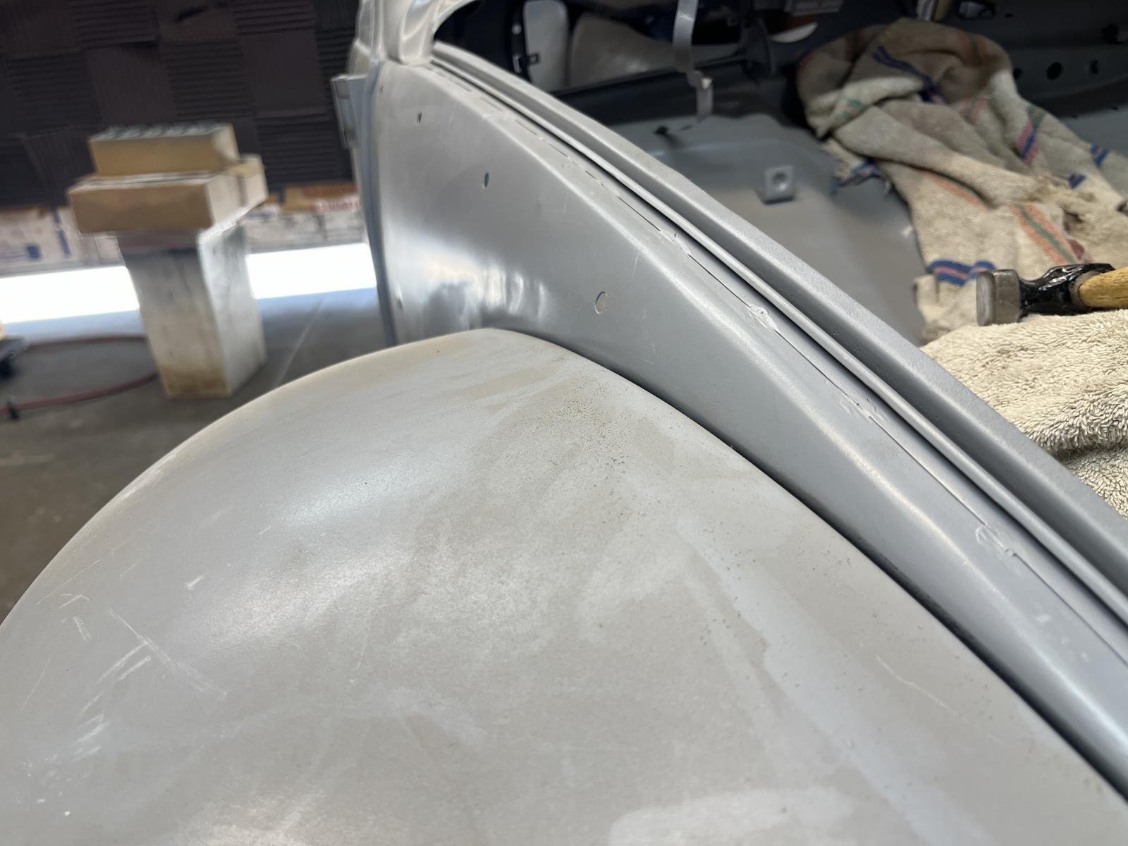

It was another day off and another day of filling and sanding.
Moved sideways to the front quarter panel! Started with how it sat the last time I spread Duraglass and Rage onto the shell. I did install the fender first!
Had to get up close and personal with the body, peering intently at the body lines where the fender meets up with the corner panel. This corner is okay except for 2 low spots. Not huge but enough to make me take notice.
Those 2 areas where the beading will sink a tiny bit. I will need to fill a tiny amount. Then there is the front. Actually that is not too bad. Maybe a few bumps with a hammer will knock it out!

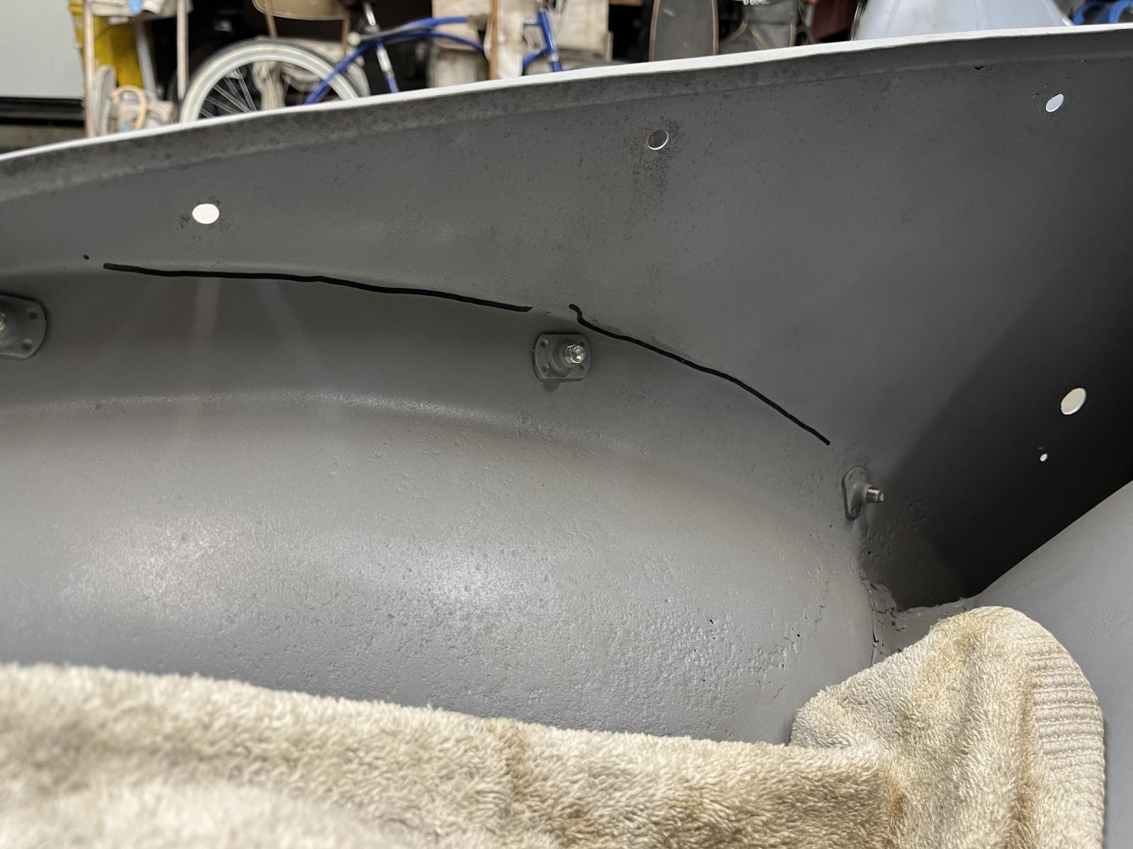

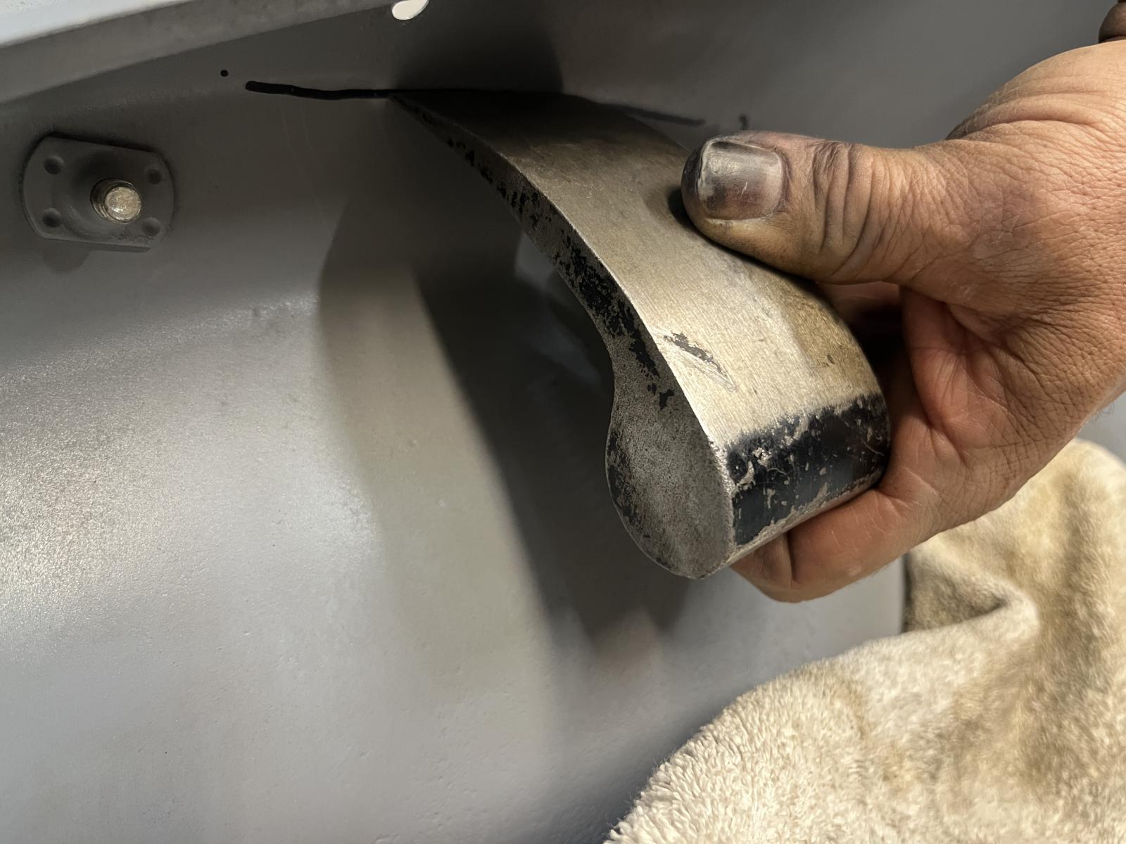

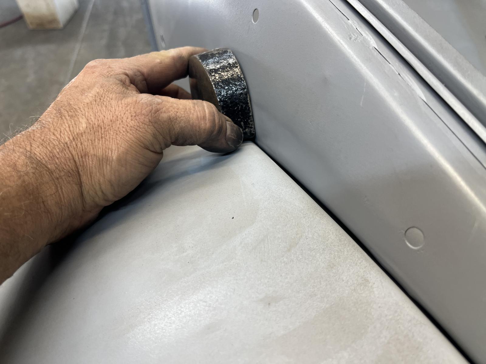

I forged ahead by marking the fender bead line on the inside of the trunk.
I then took one of my Dollys and set the pointy end into where the stamping is on the quarter panel, which outlines where the fender rests. I then hit the dolly, pretty damn hard, with a 32oz. hammer! It pushed out the panel a bit. I might have less than 1/16” of filler to have to fill now. The positive keeps going. Loving it!
While I was taking care of that, I was reminded that this area has a ripple along this same area. Let’s see if I can document it.
Can you see the ripples? Really odd. It is like someone was trying to shrink the panel. There is a uniformity to the markings. Never seen that before. Oh well, let’s beat on it and see what we can do. Smoothing it out may help those adjacent low areas, since the metal will stretch a tiny bit. I may be able to use that in place of filler!
That made a tiny bit of an improvement. I can more feel it than see it, but if you have a keen eye, and I get the picture taken well, you might have a shot.
Nevermind. You can’t make it out at all! You would need to feel the difference!

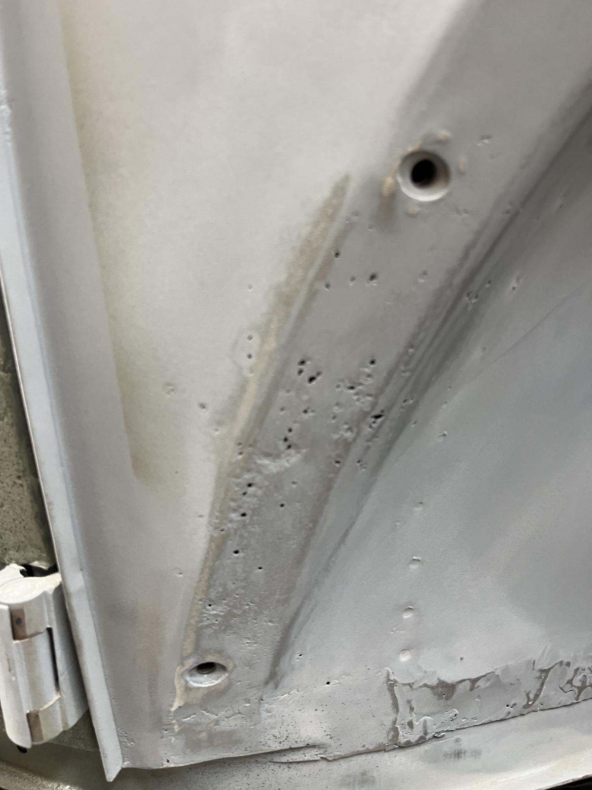

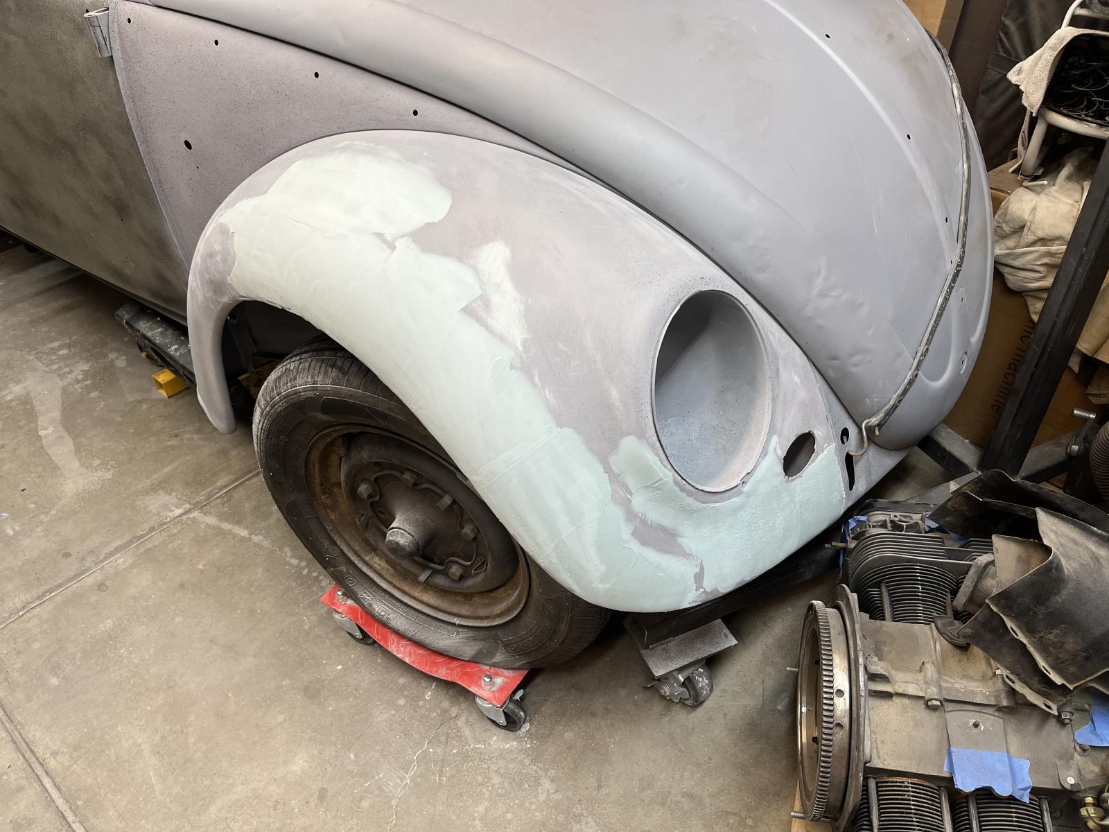

My bad! With those areas bumped as well as I can do, it is onto fiberglassing the pin holes. I then grabbed the sander with some 60 grit spinning on it, to give the fiberglass something to tooth into!
Then I smear a thin layer of the Dura glass over those areas, tapering off the ends as I push that material through the tiny holes.
I also hit the fender.
Then I sand that down with 80 grit and smear Rage over it all. Well, I did that 3 times, building up the areas slowly. You never want to much filler in one swipe. Leads to a series of bad events! Ask me how I know!
Sand that all down with 80 grit. Rub it and feel for the low spots. Smear another layer, sand feel, fill, sand, feel, etc….. You get the picture. Then a coat of Filler Primer, so that those 80 grit scratches get filled!
See, no more ripples!
Onto the fender! (You could probably see the filler in the previous photo.
And that is when the steam ran out. Tomorrow is another opportunity for advancement!

Had another 4 hours this afternoon to work on the old Bug! Got back into the front fender. Got straight into sanding down the filler I spread on yesterday.
This layer got way closer to the mark! But it was still a little bit off here and there, plus a few high spots showed up during the sanding. So, first, I smacked those down with my body hammer. Once I was happy with the spots levelness, I rough it up and primed it all again. Then speckled it with black primer.
I let that dry, more or less and then sanded it again, this time really focusing in on how the body lines go. It got SO MUCH closer!
I then did a light coat of filler and was waiting for it to kick off, when the clock went off. It was time for dinner with Mrs. Jimbo!
Until Saturday! It time to go make money again!
Jimbo

Question for you. How do you decide when to fill pin holes instead of replacing the metal? What is the tipping point?

matthew henricks wrote:
Nice progress for a day.
The pin holes I am referring to, ARE from replacing steel. I am
not laying product over compromised steel. These are mostly the welded seams between old and new steel. Pin holes are unavoidable welding sheet metal together. Just a byproduct of not being able to lay a complete bead of weld down. I have seen several repairs on other cars with “patches” that have been only tack welded into place. They then go back and bondo over that “patches”. Crazy!
I try and sink a tack weld sequentially along a seam, overlapping the tacks by 50%. I have found that, that process makes for the best welded seam I can get with very little being missed in between the pools of molten steel. BUT, the pools sometimes do not take to one another 100% and then we get what is referred to as a “pin hole”.
I have continually returned to my past patches, while the welder was in hand, and tack in a few thousand of these through the project, but there are still several awaiting me after grinding the mass down. I am sure someone more experienced could make it 100% the first pass, I am not that guy. But, I am not dumb either.
So, we know moisture will gain access to anywhere and everything! So, how to mitigate what we know is there but cannot be seen and will soon be covered? Maybe even covered with a sponge like structure material, like Bondo! We isolate the product! We make the back side impervious to water intrusion and the front, we do the same thing! Sandwiching the sponge! No air to carry moisture in, no oxidation with steel is possible!
Hope I answered that question!
Jimbo
