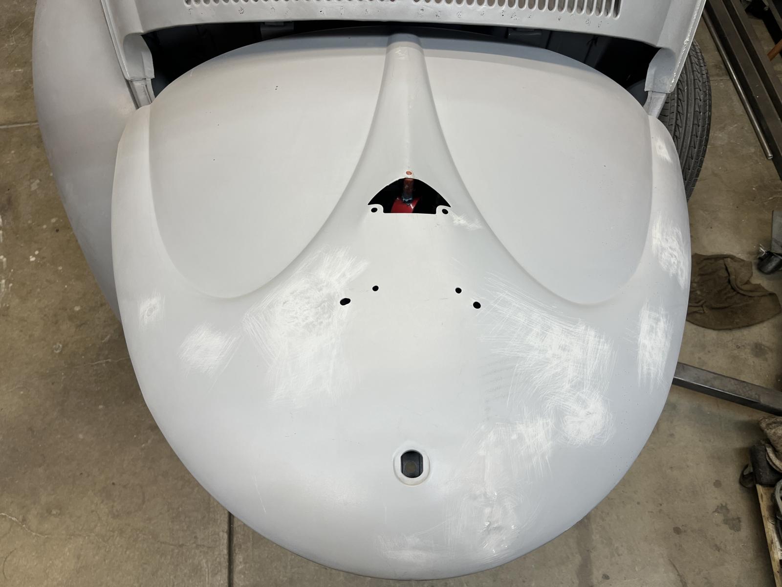

Got in four more hours. Finished off the front fender on the passenger side. I then turned the car around so that I can work on the drivers side.
I meant to take a front end shot during the day, but time got away from me! So you get a night time shot!

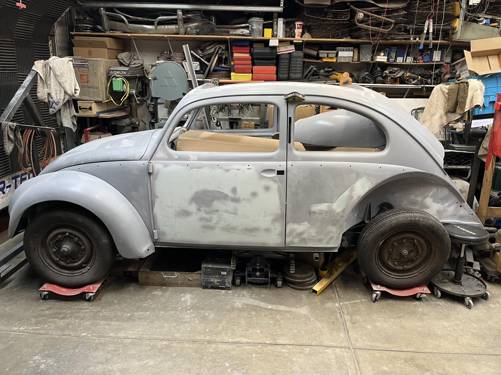

PostPosted: Thu Apr 24, 2025 9:34 pm    Post subject: Re: Jimmy V's 54 Oval Project Reply with quote

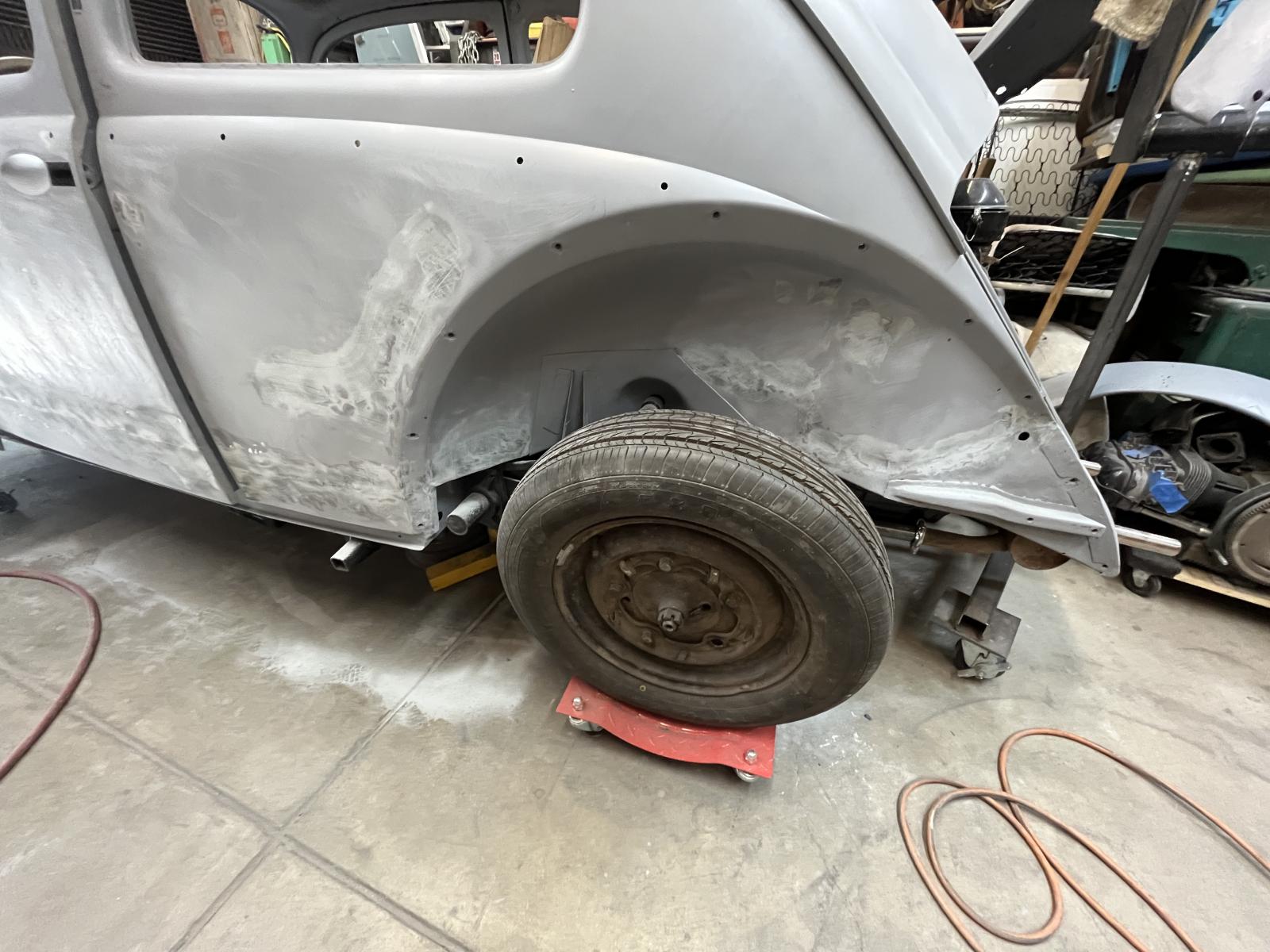

WOW! I spent another 8 hours working on the Bug! Got me some more shitola done. Baby steps!
Dove straight into the drivers side door and rear quarter panel. They are the worst of the remaining panels needing work, so, might as well knock them out! I started by removing the epoxy primer to expose the steel, at all of the weld seams. I need to glass all of the weld seams up, to keep the moisture at bay.
I hit the side, the front window corner, a weld spot on the front quarter panel, the door, the rear quarter panel, the rear wheel well and this side portion of the rag top.
I immediately followed all of that glassing with a coat of Rage Extreme. Took me 5 small batches to cover everything I exposed.
I then moved into sanding. I used 36 grit to take everything down quickly.
I followed that up with spot priming the bare metal that came out from the sanding. Afterwards, I pushed the Bug back into its spot! I needed to apply another layer of filler on the door, rear quarter panel and the front corner of the rag top, but ran out of time. Maybe I will get back to it this weekend. Hoping to have this side done by Sunday, with all of the repairs back in epoxy primer!
Until next time!

PostPosted: Sun Apr 27, 2025 7:13 pm    Post subject: Re: Jimmy V's 54 Oval Project Reply with quote

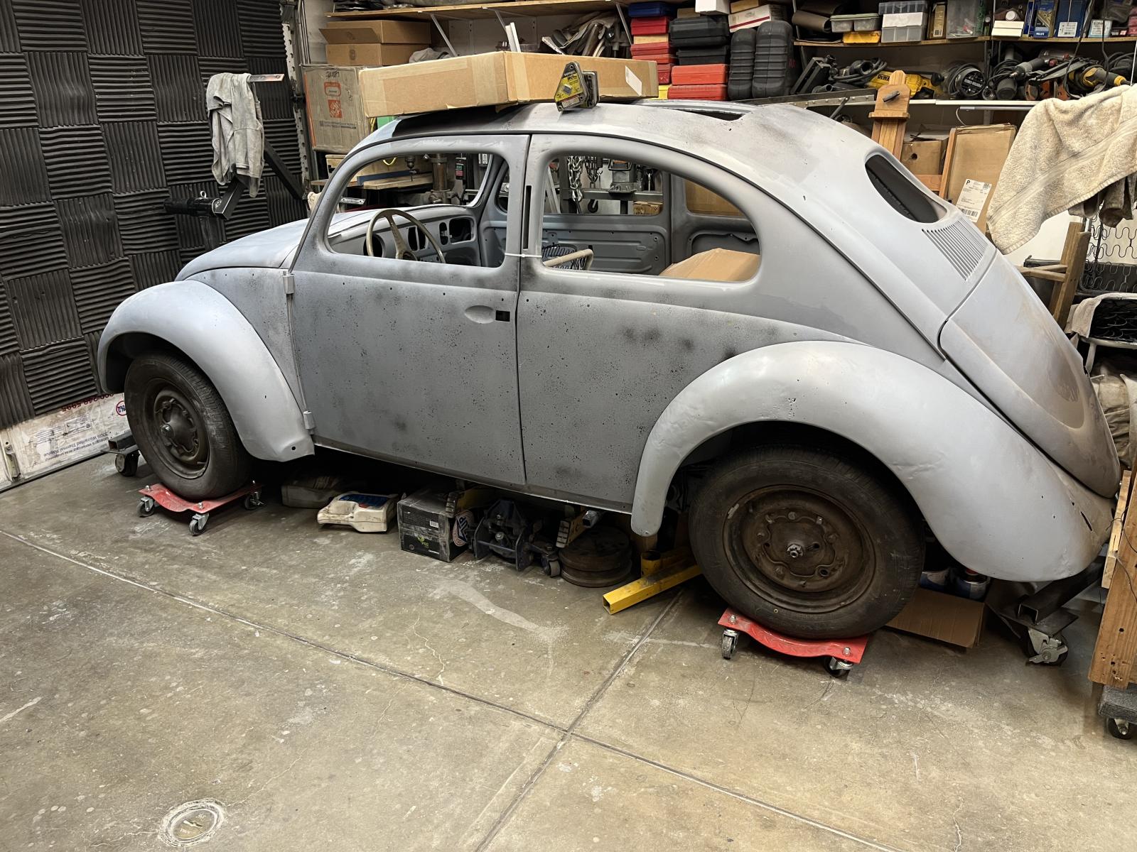

Had me a free day today! Another 5 hours!
Pulled the Bug out, sanded the last round of filler, then laid in three more rounds, which produced an almost perfect door and quarter panel!
Addressed the weld seam on the side of the hood and the front fender turn signal hole that was made by someone, at some point, in the car’s past.

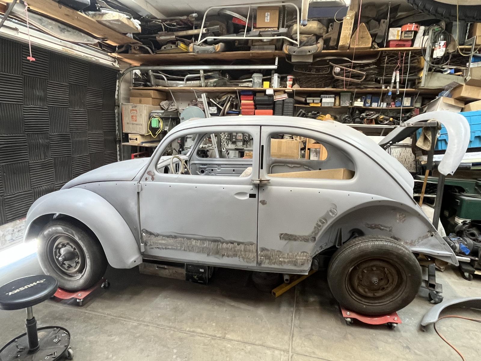

Here is the front fender I knocked out last time.
I then filed in between the welds at the ragtop. Did as much as I could reach.
I just have to finish this one area at the rear corner.
Until my next day off!
Jimbo

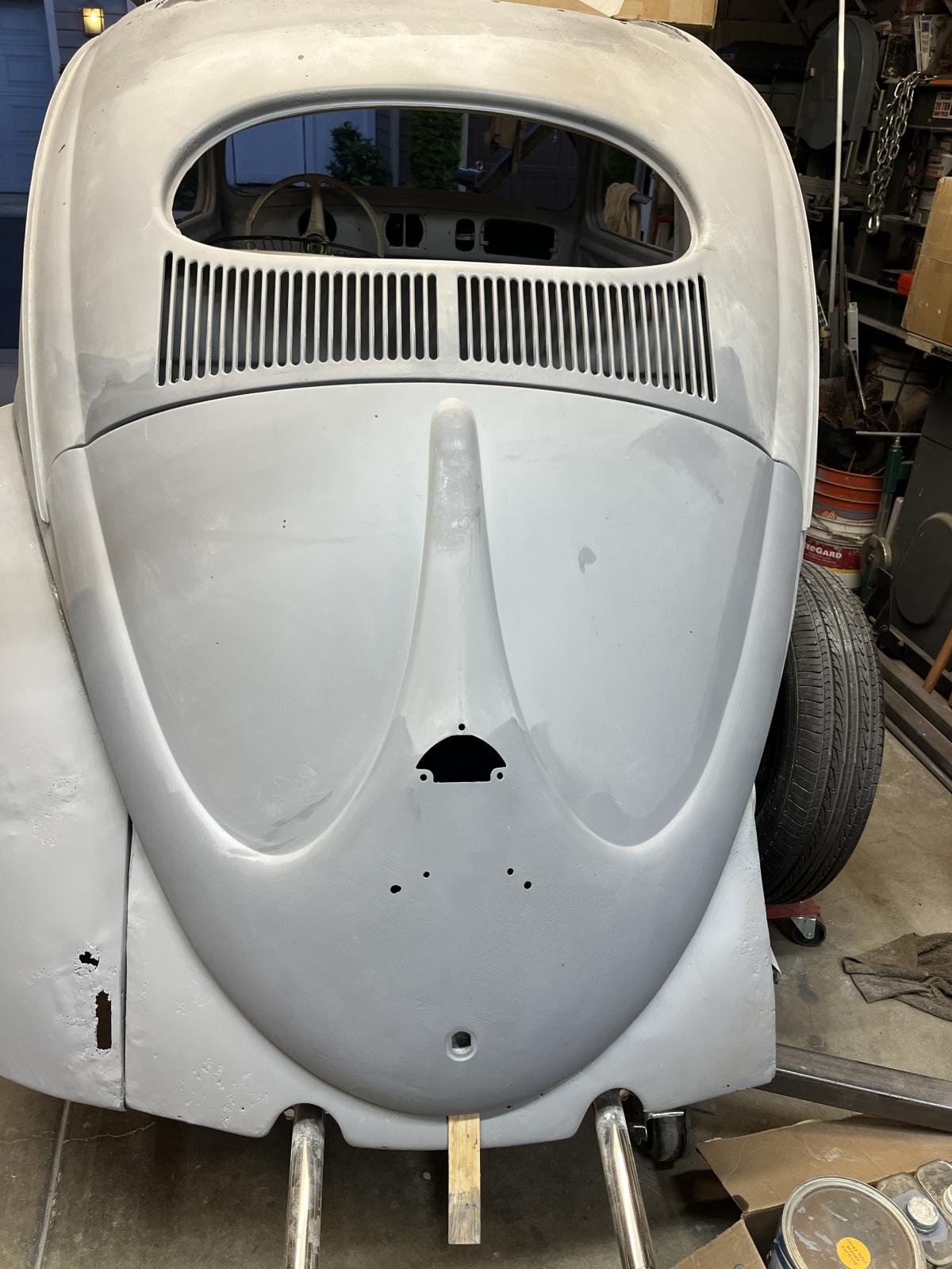

PostPosted: Wed Apr 30, 2025 8:35 am    Post subject: Re: Jimmy V's 54 Oval Project Reply with quote

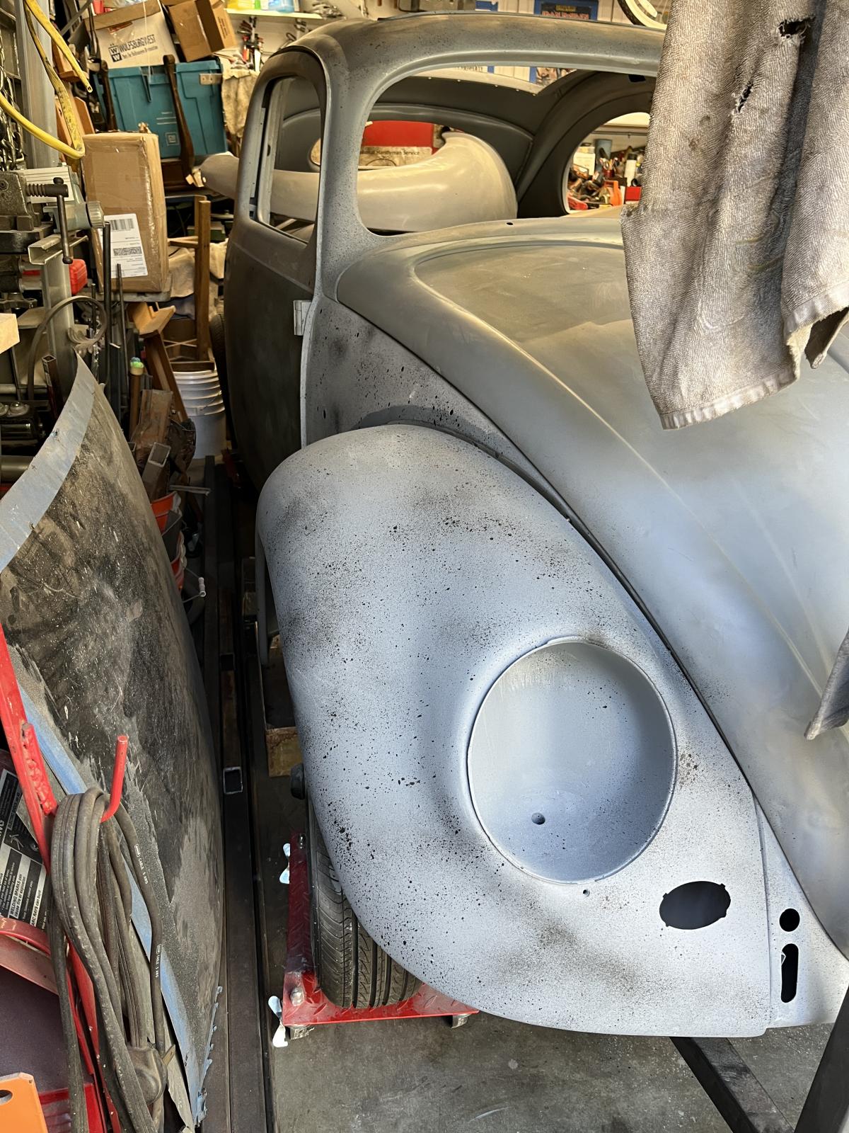

Got home late last night and no one was home! So, I went straight out into the garage to find the bolts to hang the decklid. Took a few minutes but find them, I did! I then attached the decklid and then set the rear fender.
Now, I am all set up to smooth those 2 pieces out and finalize the way they integrate with the surrounding body panels!
It is starting to look like a Bug again!

PostPosted: Wed Apr 30, 2025 10:54 pm    Post subject: Re: Jimmy V's 54 Oval Project Reply with quote

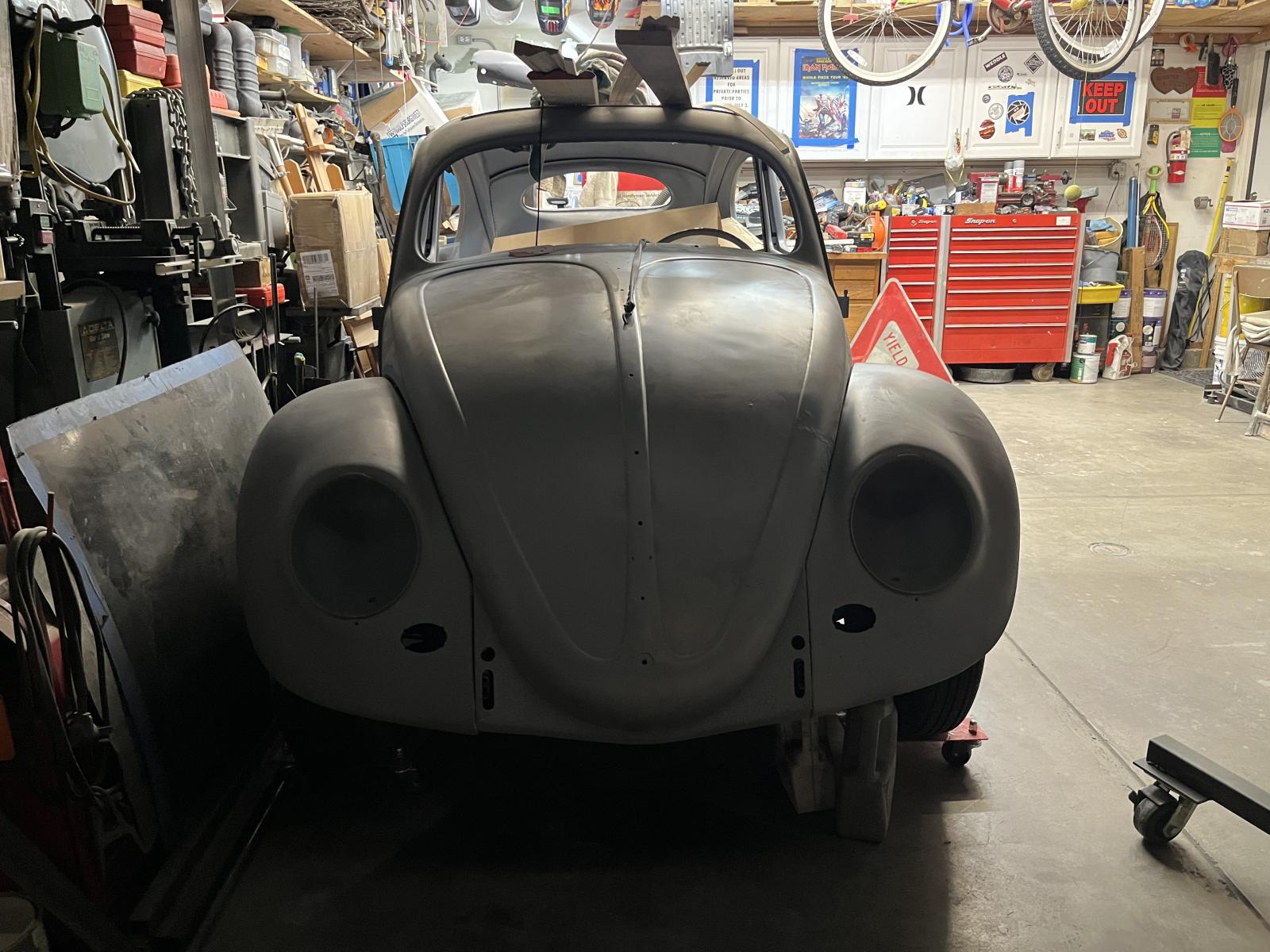

Got another 4 hours in today! Thanks to a short work day! Love it when shit goes smoothly!
So, after lunch today, instead of going back out to work, I walked out into the garage and played with the Bug! Dove straight into the decklid! Propped it up and started feeling it for damages.
Then I penciled out the problem spots. Then followed that up with some 36 grit to the cured epoxy primer.
Mixed up some Rage filler and smeared it all over those marked areas, keeping the thickness to 1/8” at most through the centers and easing the edges all around. Then some sanding with 36 grit.
Repeated those 3 steps two more times. This photo is after sanding the first coat. On the second photo those darker areas are the low spots. So, I will need to add some more filler. It is then onto sanding it. On the fourth time around it all came out perfectly! So , I rolled some epoxy primer on it all!
Until next time!

Have not settled on a paint brand. I really am unfamiliar with the paint scene for automotive finishes. In cabinetry and furniture, Valspar is top dog. I know they have an automotive line as well. I just need to research it a bit and talk to some people, to get a decent education! You know - TIME! Of which I have a limited amount of.
Any input? I am all ears right now!
Jimbo
