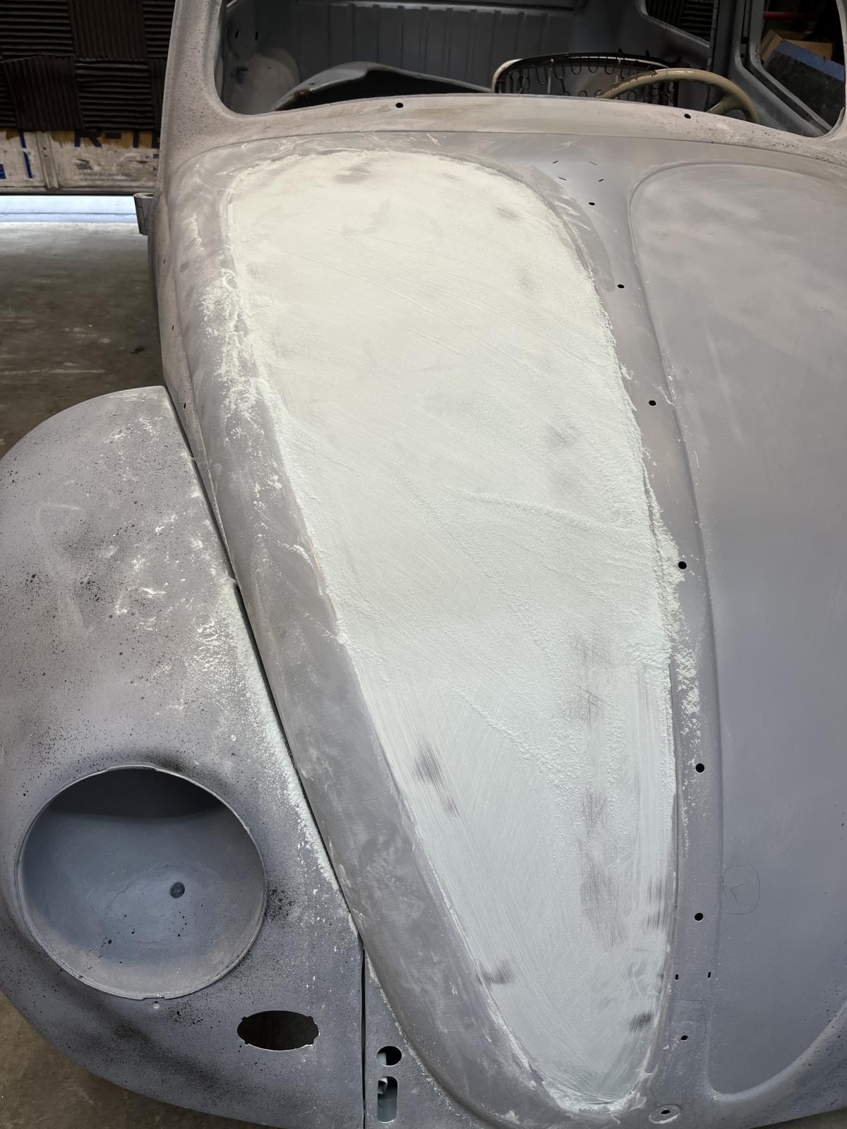

PostPosted: Wed May 21, 2025 8:28 pm    Post subject: Re: Jimmy V's 54 Oval Project Reply with quote

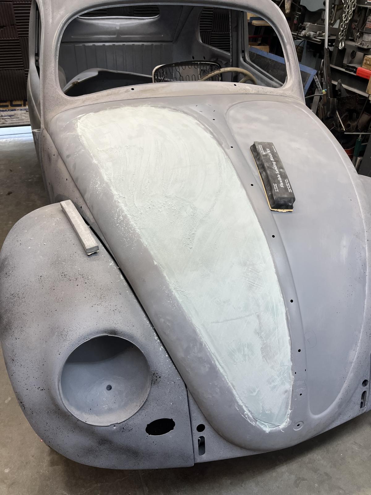

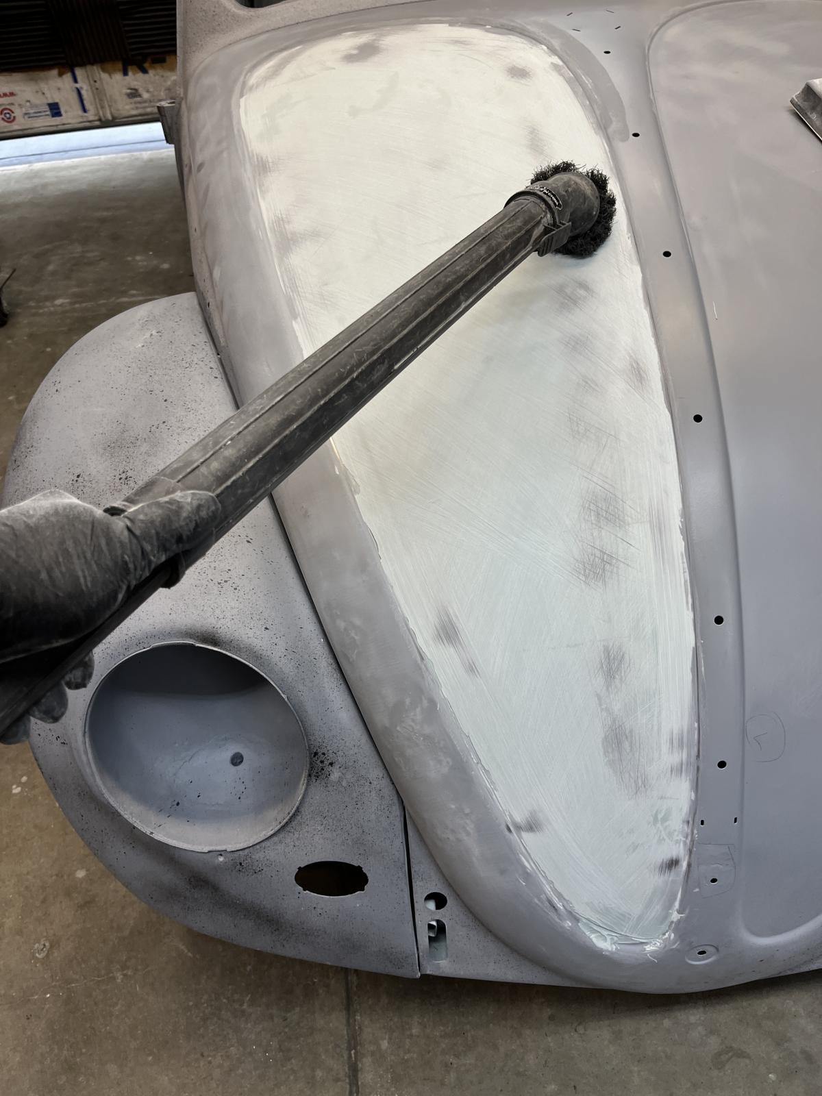

Had an opportunity to work on the Bug this afternoon! I have been training a new subcontractor on “how I like shit done”, during the work days. I added to it, “This way pays money, the other ways, DO NOT!”. Let’s see how it goes.
Anyways, got done earlier than expected. So…….
Out to the garage I went…..

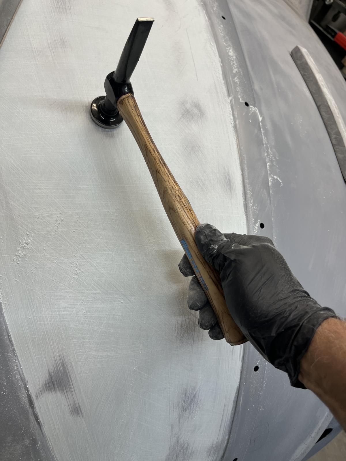

Going to try making the hood look better. I tapped on the steel for several hours over the course of the last few weeks. Most of the dents and dings have been hammered flat, except for a few. Nothing needing filler over 1/16 to 1/8”, I would guess. My goal today is to knock out one side of the hood. Only got a few hours!
Grabbed the 36 grit block and gave the area I will be filling, a good scraping. I immediately vacuumed the dust off. Then mixed up some Rage filler and laid down a layer.
I then sanded the filler down to a close finish with 36 grit.
Vacuumed all the dust off! You got to vacuum it all up or else it goes everywhere! Plus, it keeps you from breathing it.
Then, I knocked a few high spots down with the new Milton hammer! Man, I love GOOD tools! Better than those Chinese hammers by a long shot!
After hammering, I smeared another thin coat of filler over the area and sanded all back down. There were 3 spots that ended up lower than I wanted. So, that extra layer worked its magic! I then sanded it all down with 36 grit till it was really close. I then switched to 80 grit to finalize the shape.
It is so pretty! Grabbed the primer and reducer. Mixed it up and rolled 2 coats over the area!
That came out super sweet!
Jimbo

VW_Jimbo wrote:
…Then, I knocked a few high spots down with the new Milton hammer! Man, I love GOOD tools! Better than those Chinese hammers by a long shot!
I love a good hammer!! A few years ago, I let myself spend some crazy money and buy a 24oz dead blow ballpeen off the tool truck at work, after decades of regular steel and hickory. Hands down it is my favorite tool in my bag!
I also got a body hammer off the truck, a cross pein I believe. Again, lots of money, but such a sweet balance and feel! There is no comparison to the hammers in my “body kit” I got off Amazon ten years ago.

scrivyscriv wrote:
Totally agree. Growing up in the construction trades from the age of 5, moving on to being an ASE Master Technician back in the
90s at the age of 24, to now utilizing a variety of different hammers. I 100% agree that a good hammer is a great investment! My favorite hammer is my Eastwing 32oz hammer. Hands down the best tool in my arsenal. The
Next one is the 40 pound Makita demo hammer, with the 100 pound Bosch jack hammer right behind it. But my ALL TIME favorite is the 2380 Bobcat hammer attached to the tractor! Now, that is fun AND I do not suffer from Tennis elbow after using it! Only TA (Tired Ass)!
Jimbo

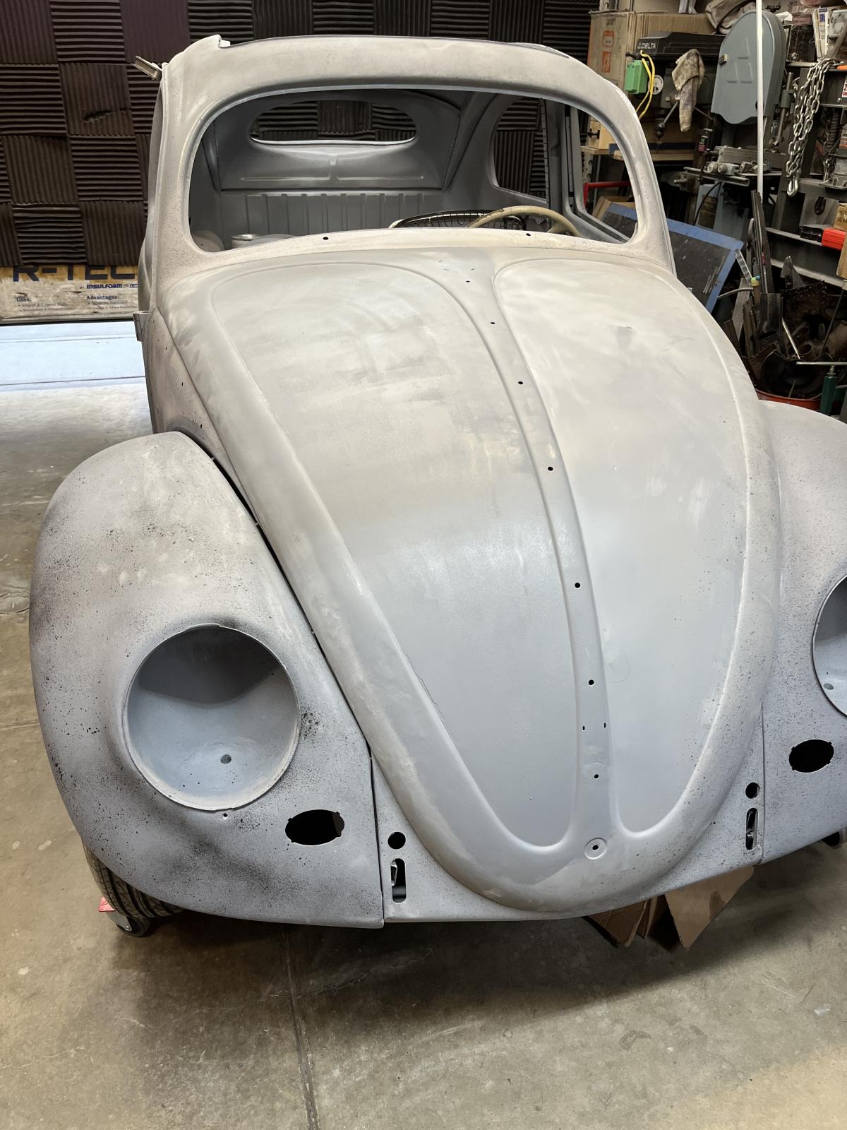

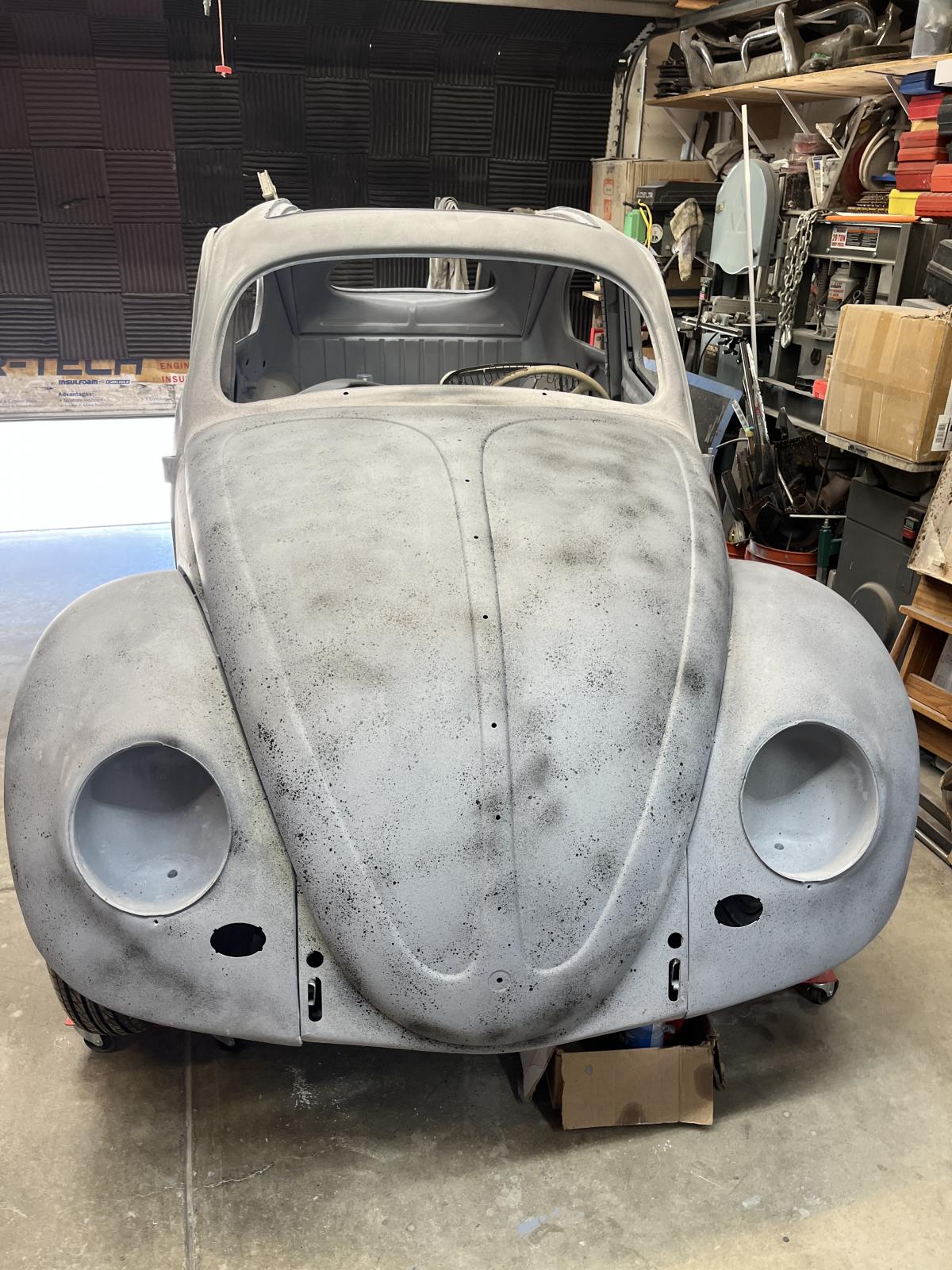

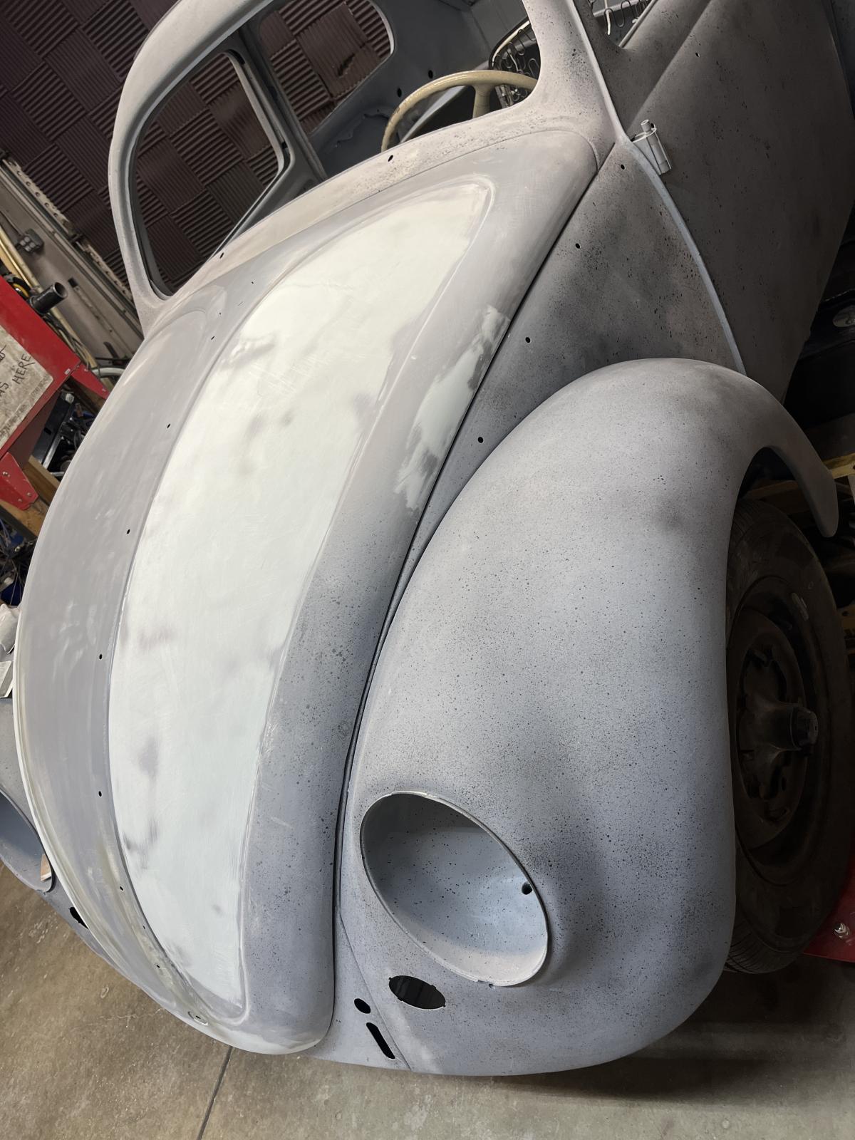

PostPosted: Sat May 24, 2025 2:13 pm    Post subject: Re: Jimmy V's 54 Oval Project Reply with quote

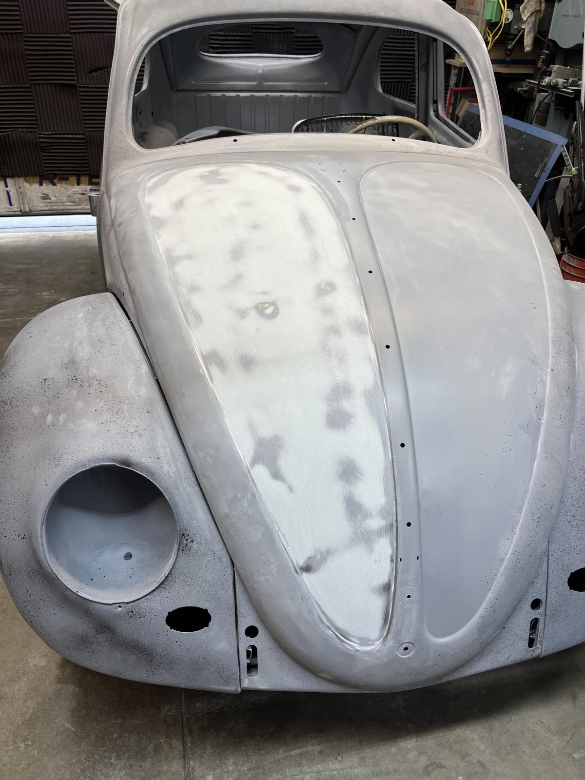

Yippee! Got in another 6 hours over the last few days! Knocked out the hood! It is SO GOOD! Check it out! Spread Rage on the driver’s side and then laid some down the sides. They had a few ripples.
I also spent some more time stretching out the middle to lengthen the hood, so it would lay better. It helped tremendously! The drivers side is the worst. But I managed to get it from 1/2 inch gap at the widest point to 1/4 inch!
Sanded and primed!
Onto the passenger door to repair the dings and dents from the kid!
Jimbo

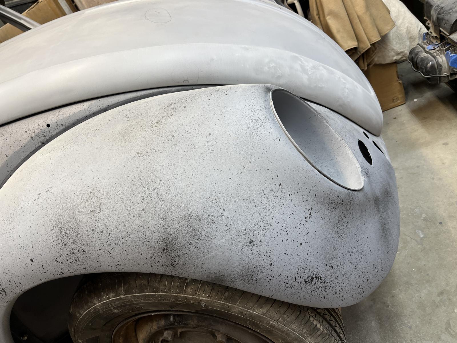

PostPosted: Sun May 25, 2025 11:57 pm    Post subject: Re: Jimmy V's 54 Oval Project Reply with quote

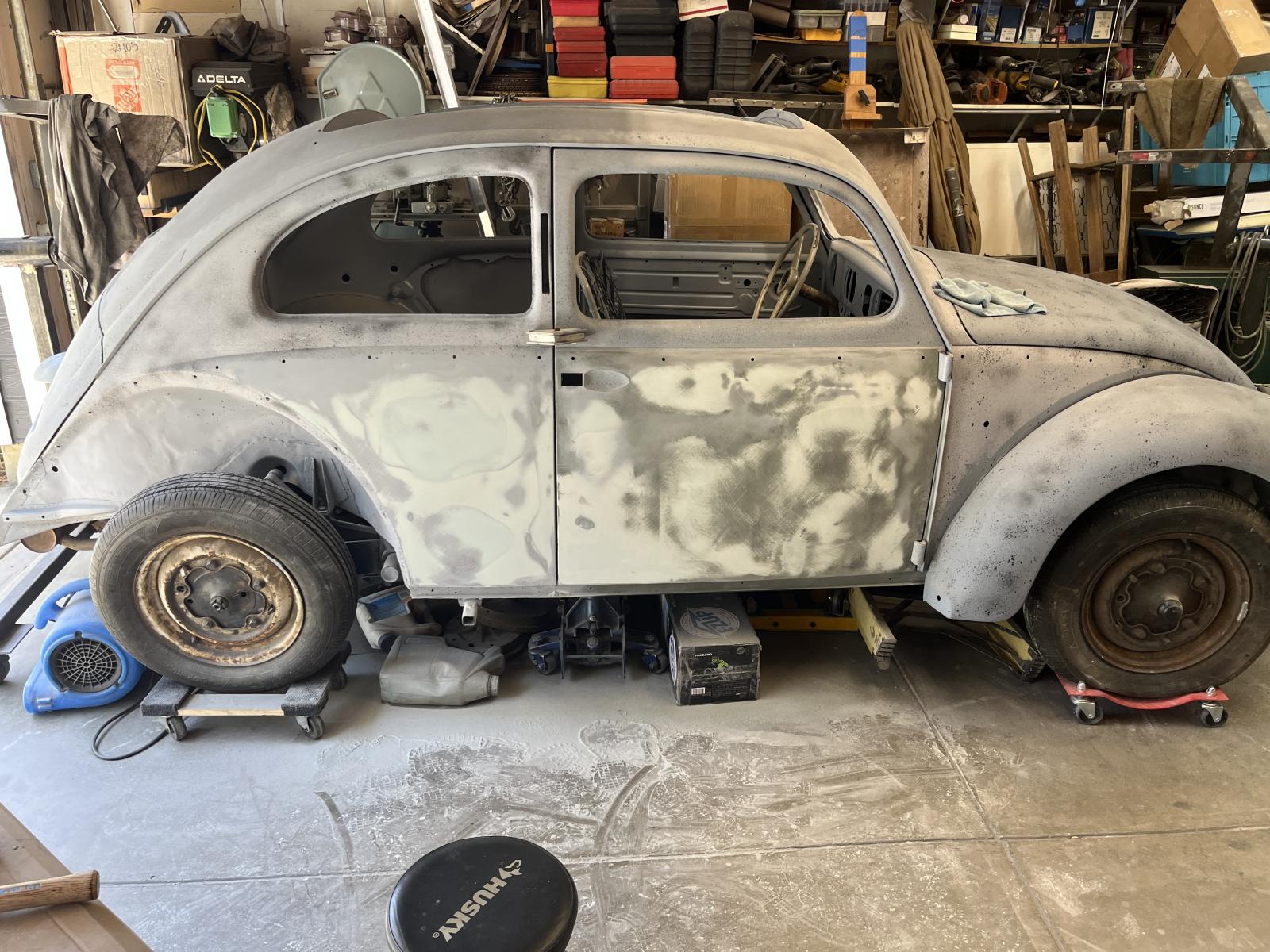

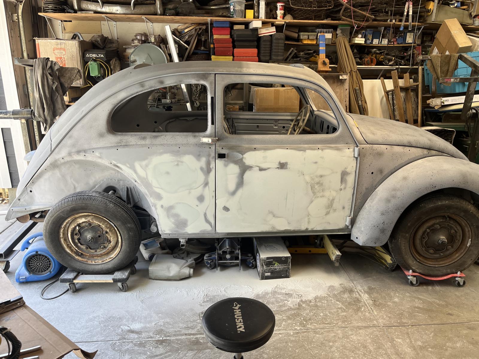

Got in about 4 hours today. I had to revisit the passenger side door and rear quarter panel. There were some dents found. I really think it was my youngest daughter opening her door into the Bug. But she semi proved this hypothesis to be false (in her mind). I did not see it that way. I am positive it is her door, that when opened by her, magically encounters extreme resistance. I added that the extreme resistance was the STEEL of the Bug’s door being DENTED! Not sure if I won, probably not. But it does not even matter because I am fully aware of the person who gets to make it right. Me!
Here it is on its first layer of Rage (it took 4)!
I then sanded and sanded and applied another layer about 1/16” thick. Then sanded down till I could find a new low spot . Then again, 1/16 inch thick layer, followed by sanding. And I got to here.
I then wipe it down and rolled some epoxy primer over it with a speckling of black primer.
Hope you all enjoyed that! Maybe I will get a tiny bit more time!

Looking good, Jimbo! Do you mind showing a pic of the Rage body filler in use? I saw a couple of different kinds on Amazon, about $75 per quart. Sound about right? Or do you have a source for better value?
1966 Bug project
1973 Thing project
VW_Jimbo Premium Member
Joined: May 22, 2016
Posts: 10968
VW_Jimbo is offline
PostPosted: Mon May 26, 2025 7:29 am    Post subject: Re: Jimmy V's 54 Oval Project Reply with quote
Thanks!
This is what I am using!
https://a.co/d/9wGxvZ4
This is the hardener.
https://a.co/d/gUgtPa7
I started with the Extreme version, but it was too soupy for my liking. This stuff is great. Not soupy, stays in place and sands super nice! I start with 36 grit and finish with 80 grit. You cannot wait to sand. I start in a minute after smearing it on.
When you order it, get an extra tube of hardener. Any of the blue hardeners work well. I buy the double pack when I order. I hate running out of product!
Good luck! And these sanding blocks and paper are the bomb diggitty!
Sanding blocks.
https://a.co/d/dLduhvt
Adhesive backed paper for the blocks!
https://a.co/d/2iRjniB
I will never sand a car panel any other way!

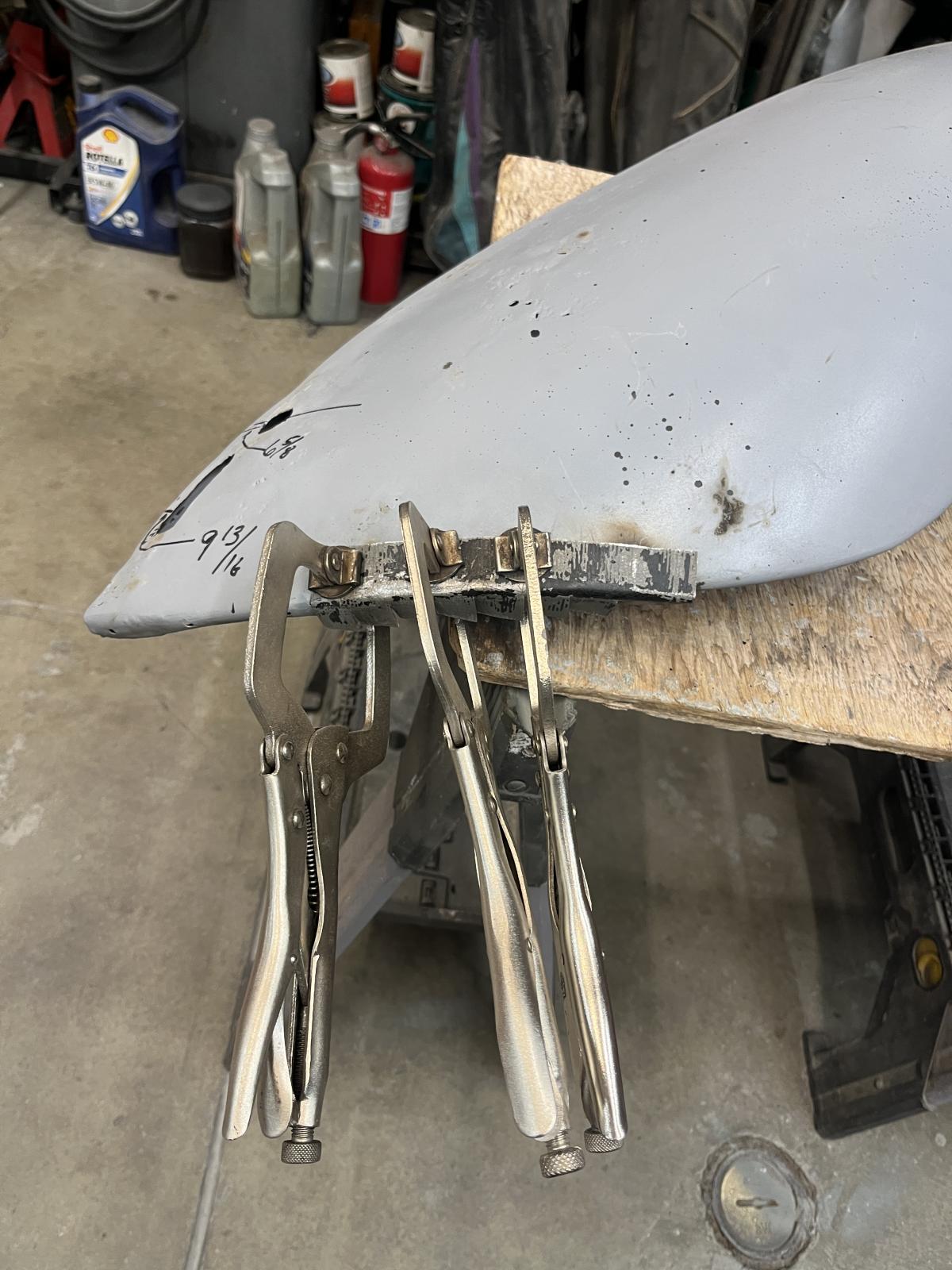

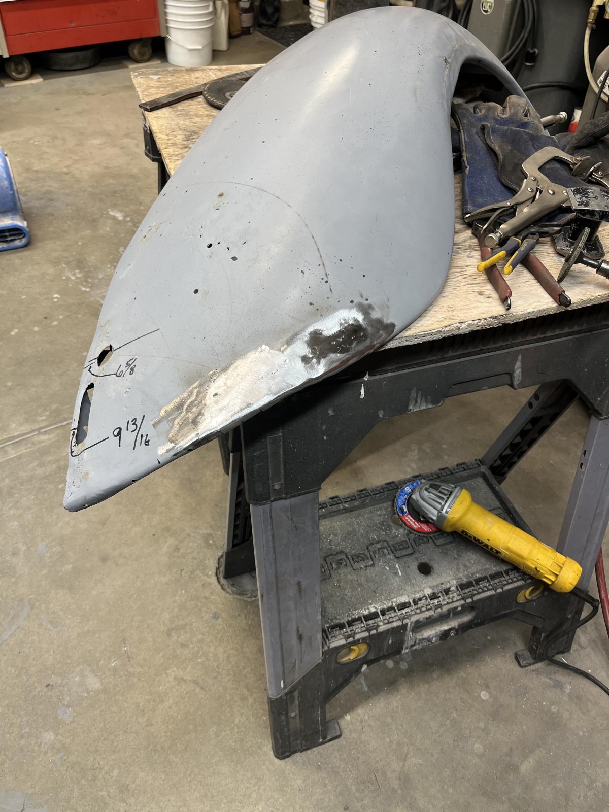

PostPosted: Sun Jun 01, 2025 10:57 pm    Post subject: Re: Jimmy V's 54 Oval Project Reply with quote
Update time! Been a hot minute. The house is in wedding mode, as we slide into 13 days away! It does not leave much room for any extra thinking or doing, but this weekend was left wide open for me. So Saturday, I got the Bug pulled out, the garage set up to tackle the rear fender and that is when it happened. A great customer calls and states that their 10 year old water heater is not making hot water anymore. Well, I tell him that I can be over in an hour. Long to short, 4 hours to remove and install a new water heater. Not a record but not bad. But that left no Bug time.
Sunday morning rolls around and BAM! I am out in the garage by 9:30! I even did waffles, an egg and bacon! Stuff moves really quick when there is only one person to make food for and clean up afterwards.

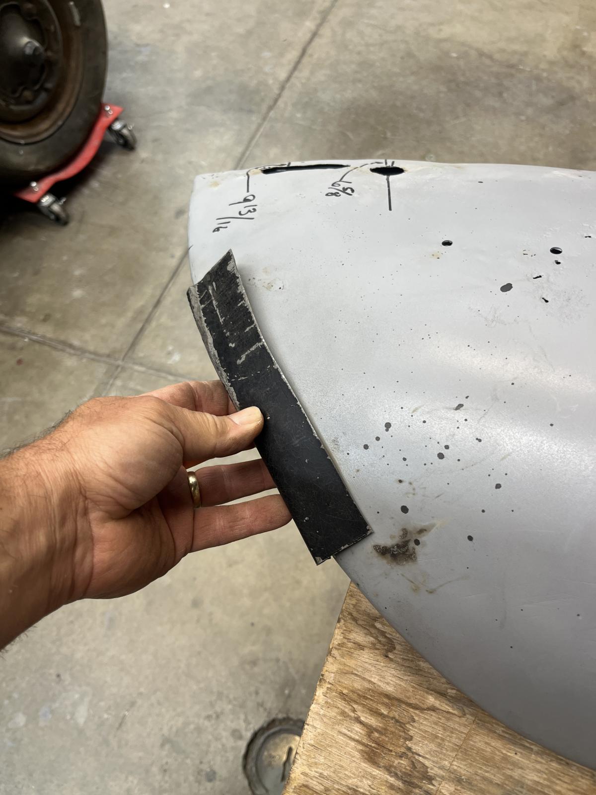

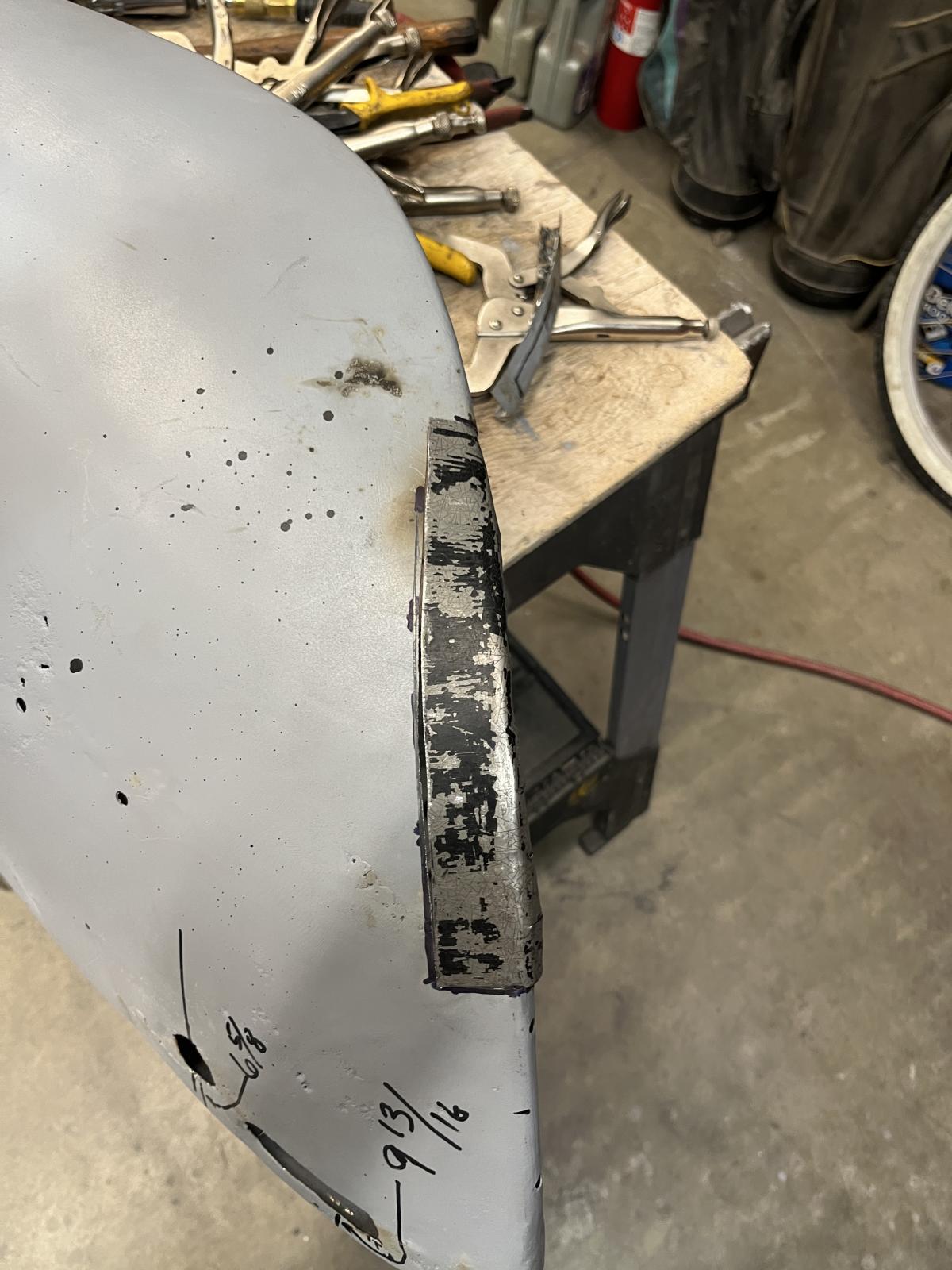

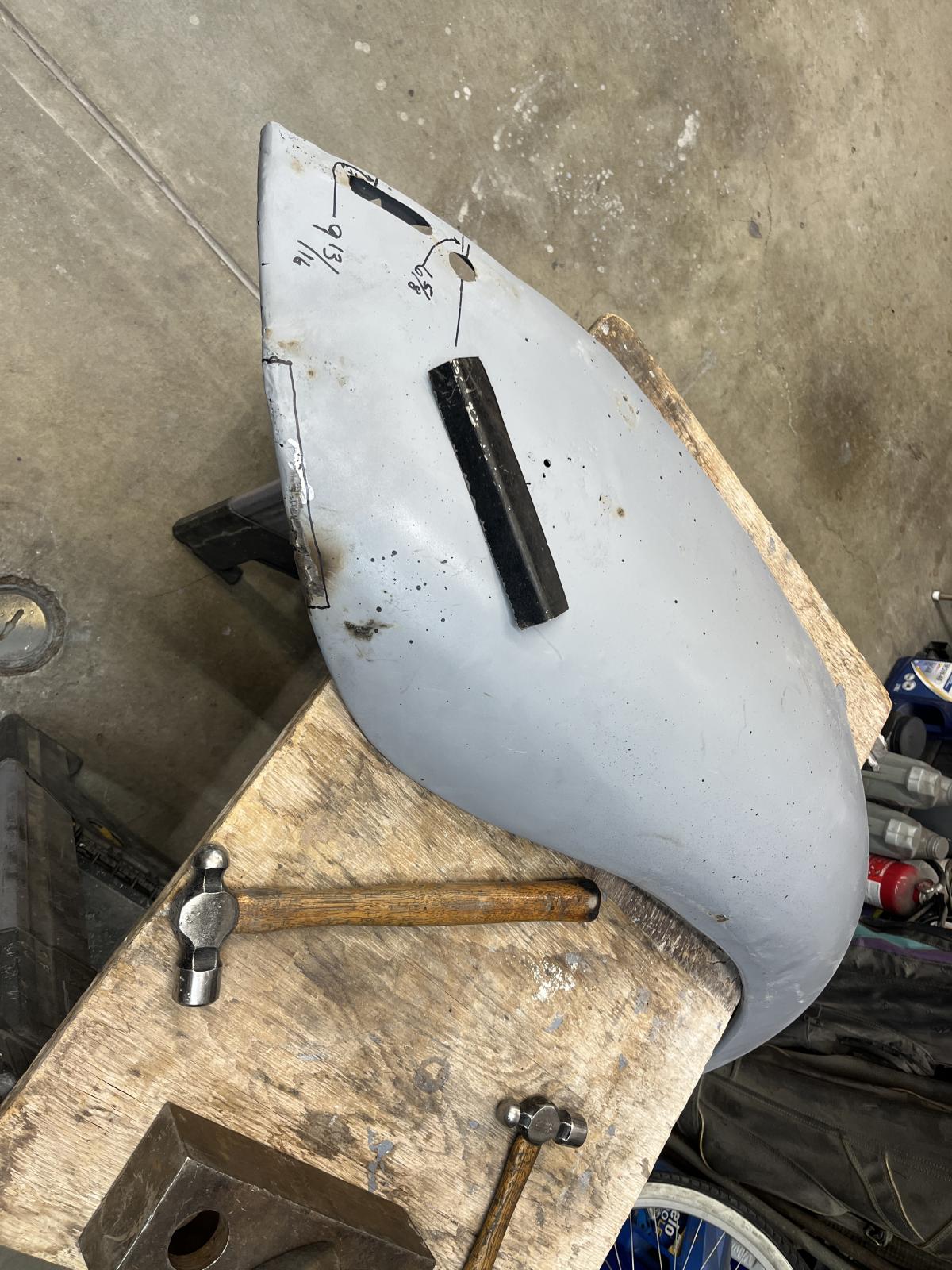

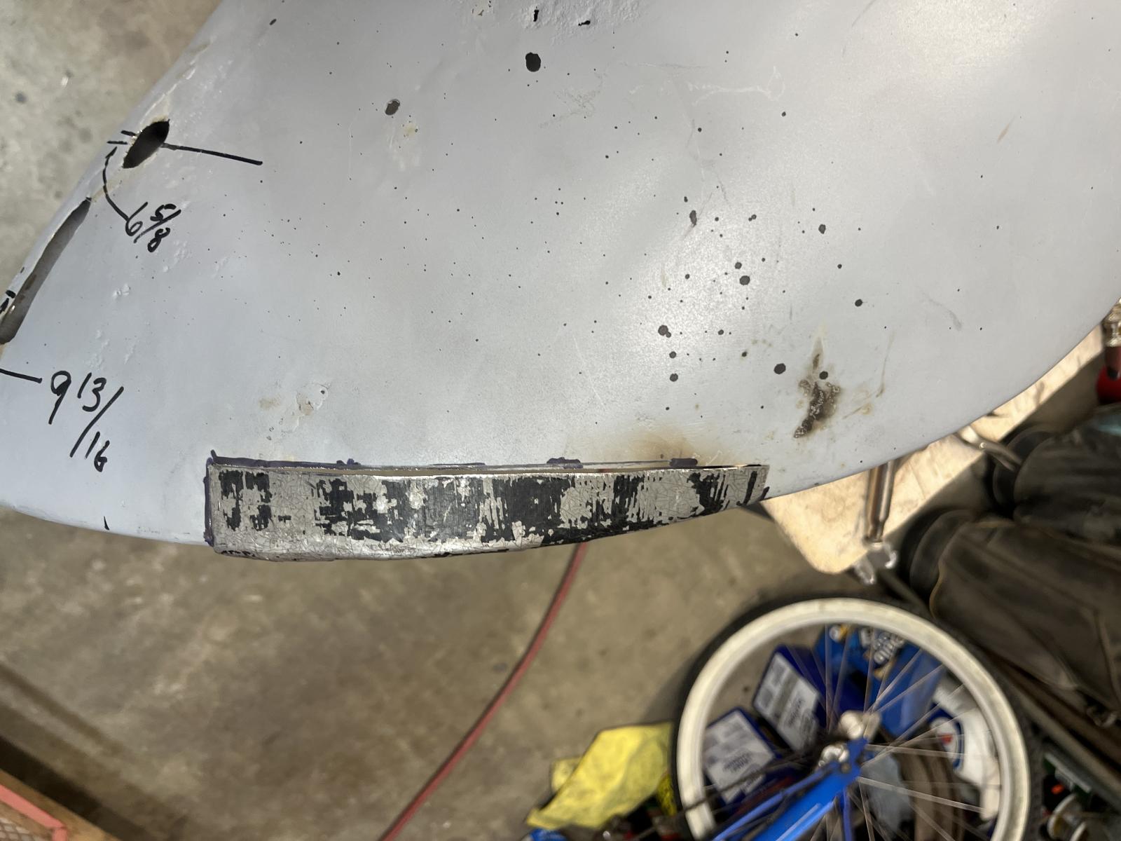

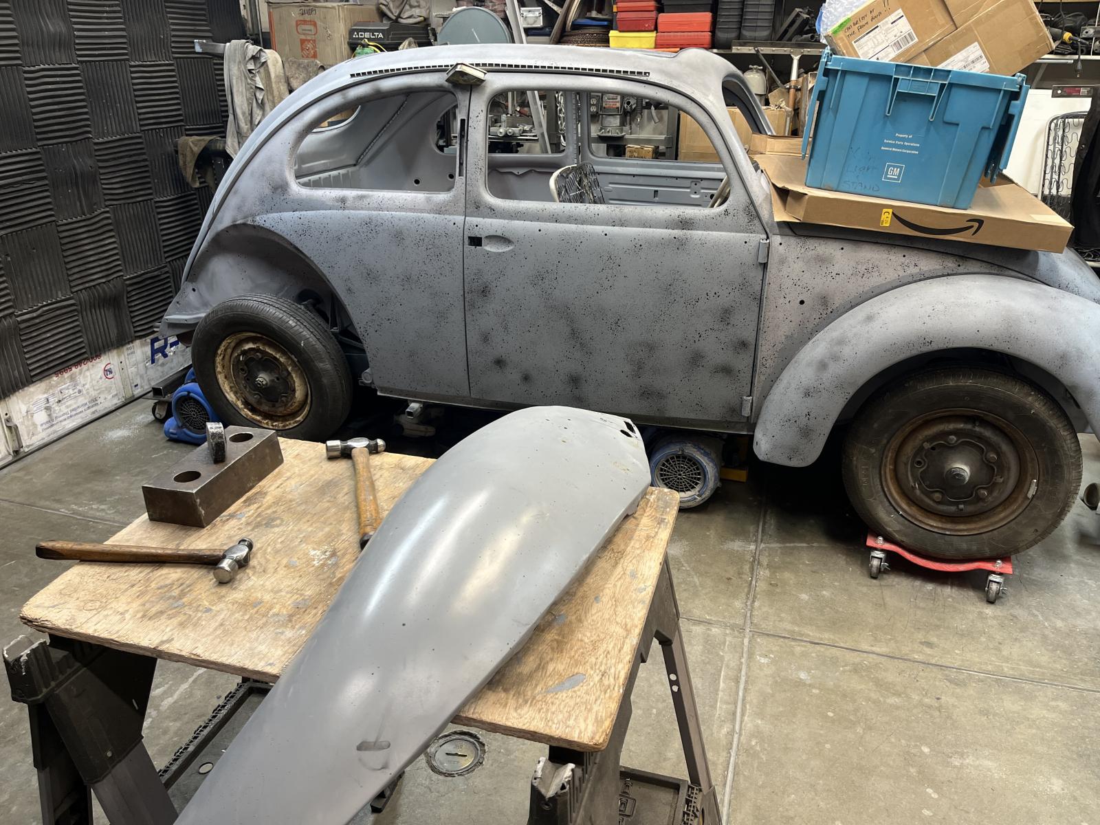

After cleaning up, it was out to the Bug!

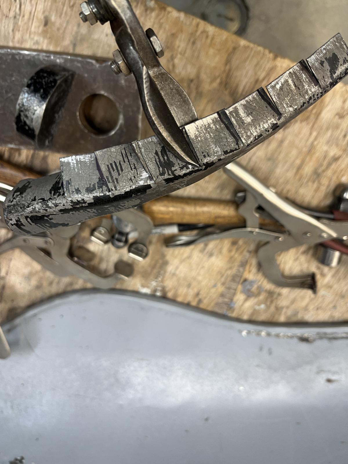

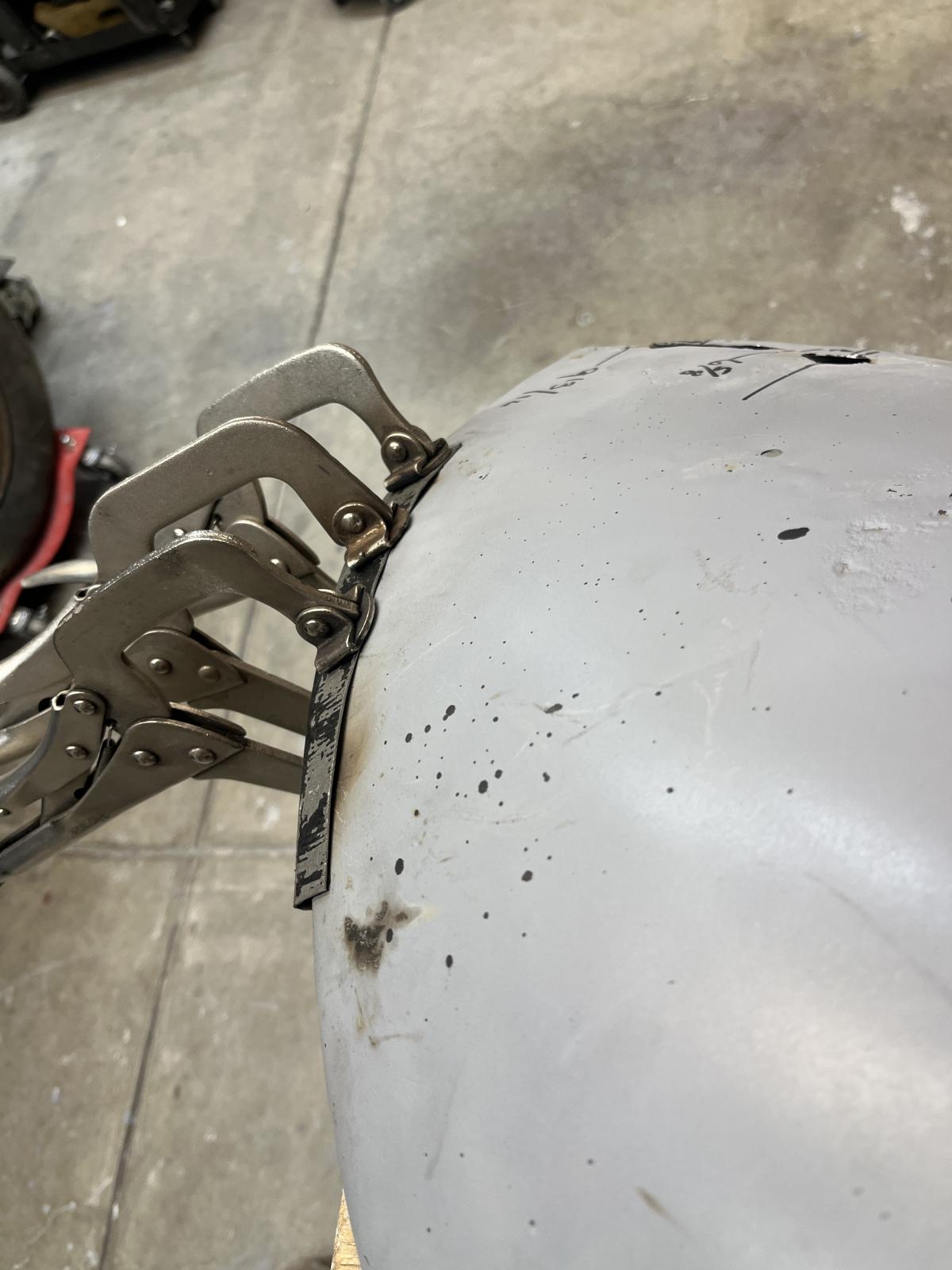

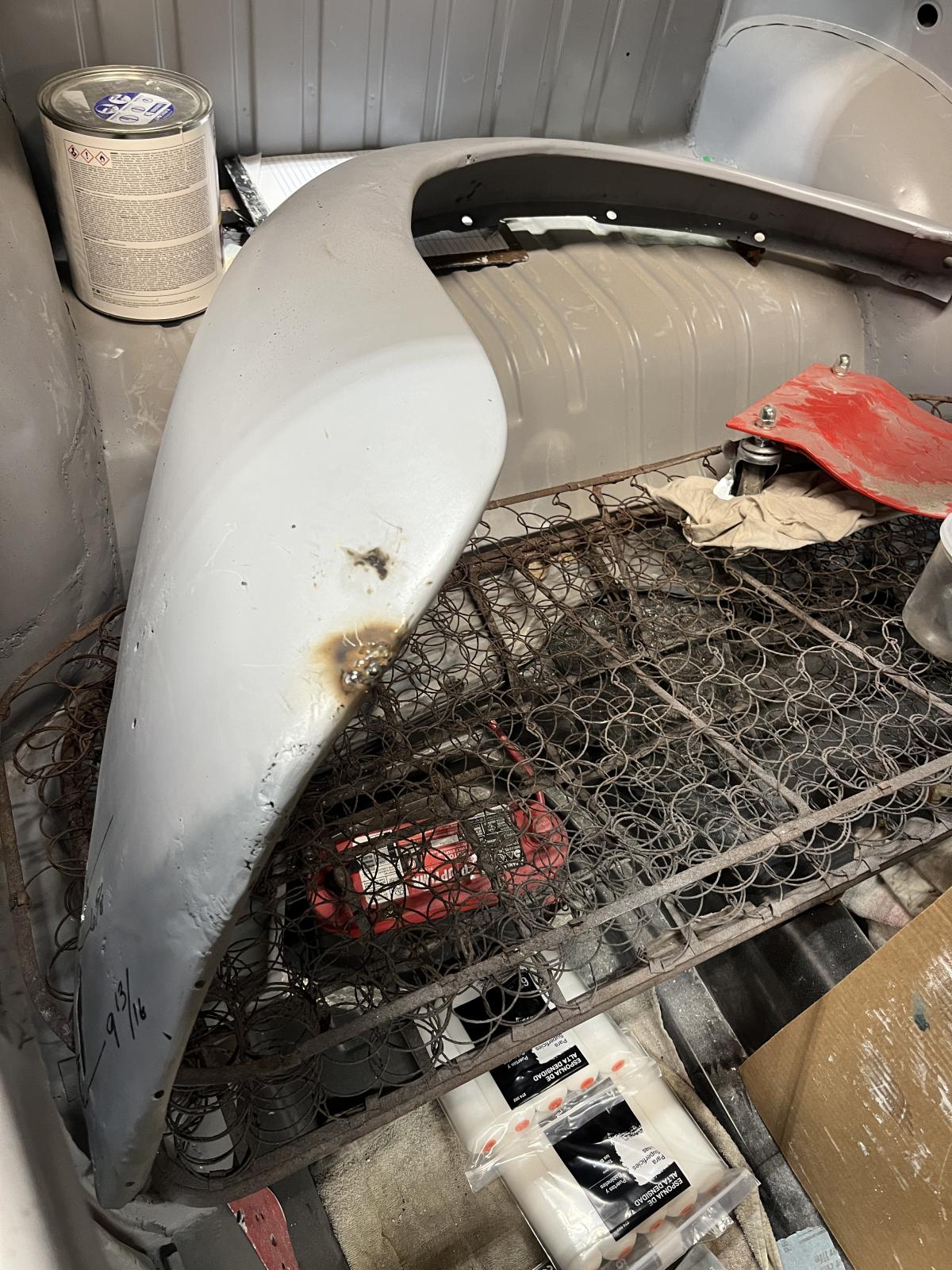

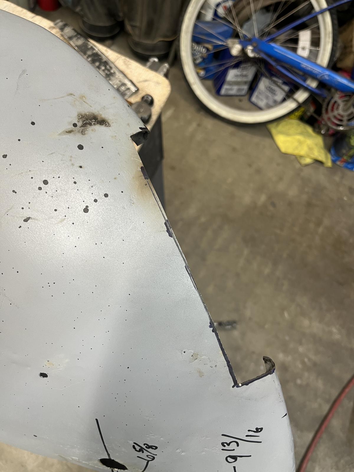

Set up the rear fender. It needs some thin metal replaced at the rolled over edge towards the bottom. Pulled out a section of old front clip steel that already had a soft 90 radiused edge.

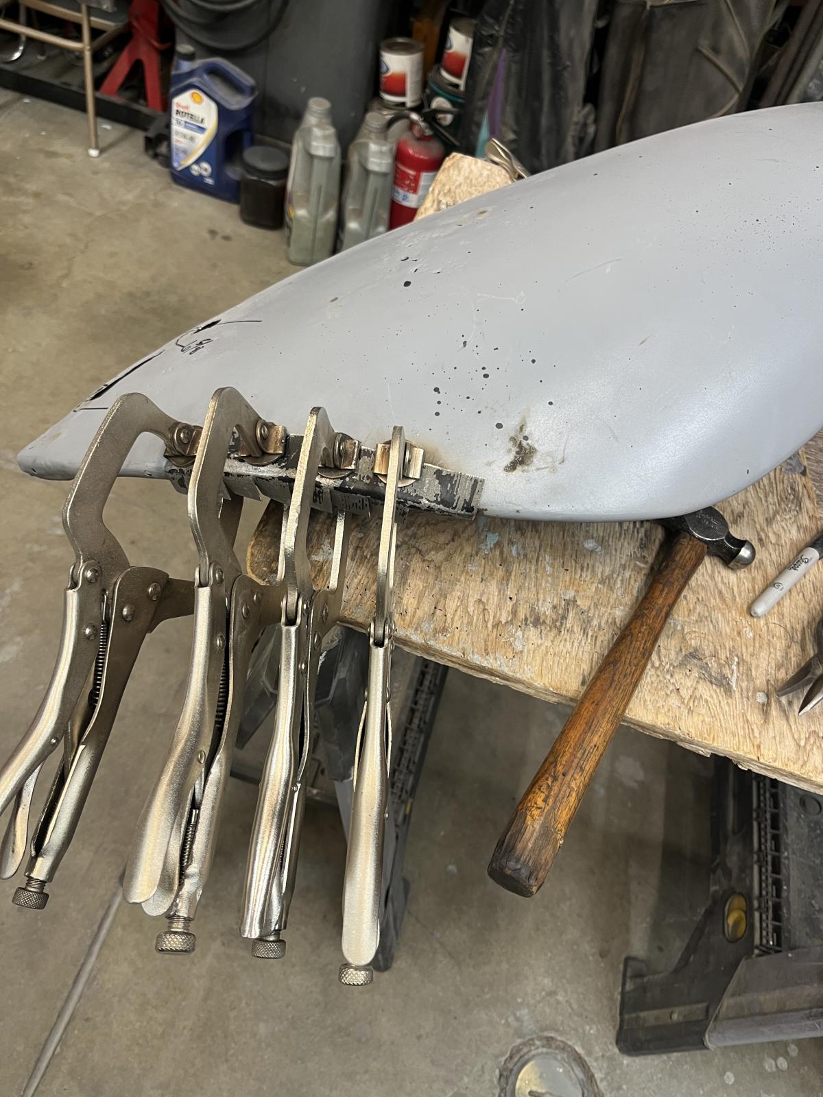

Spent some time between the stretcher, shrinker and hammer, working the piece until I got the compound curve just right.
I clamped the piece to the fender repeatedly, checking it, but also shaping it too.
It was a bear to get it to match.
Just a bit more to go. So close!
More hammering. More clamps. Better!

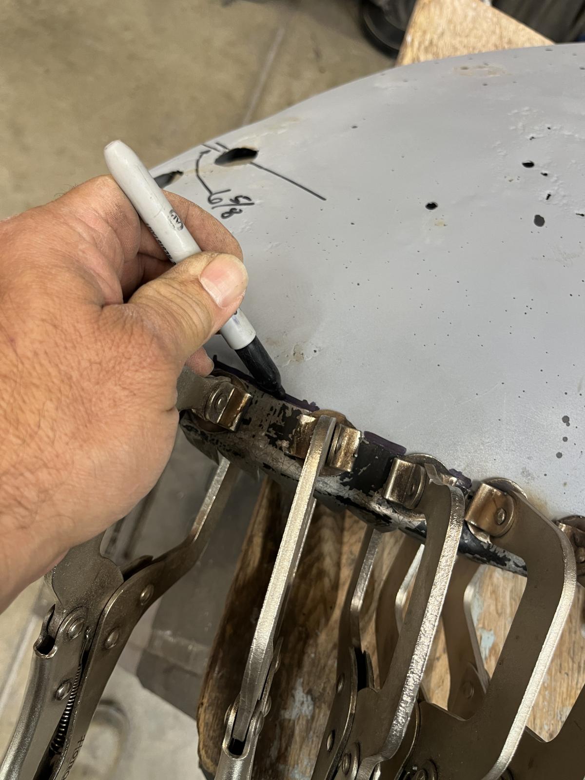

Then finally, it is perfect! Now let’s mark the fender for the cut and remove the rusted steel!

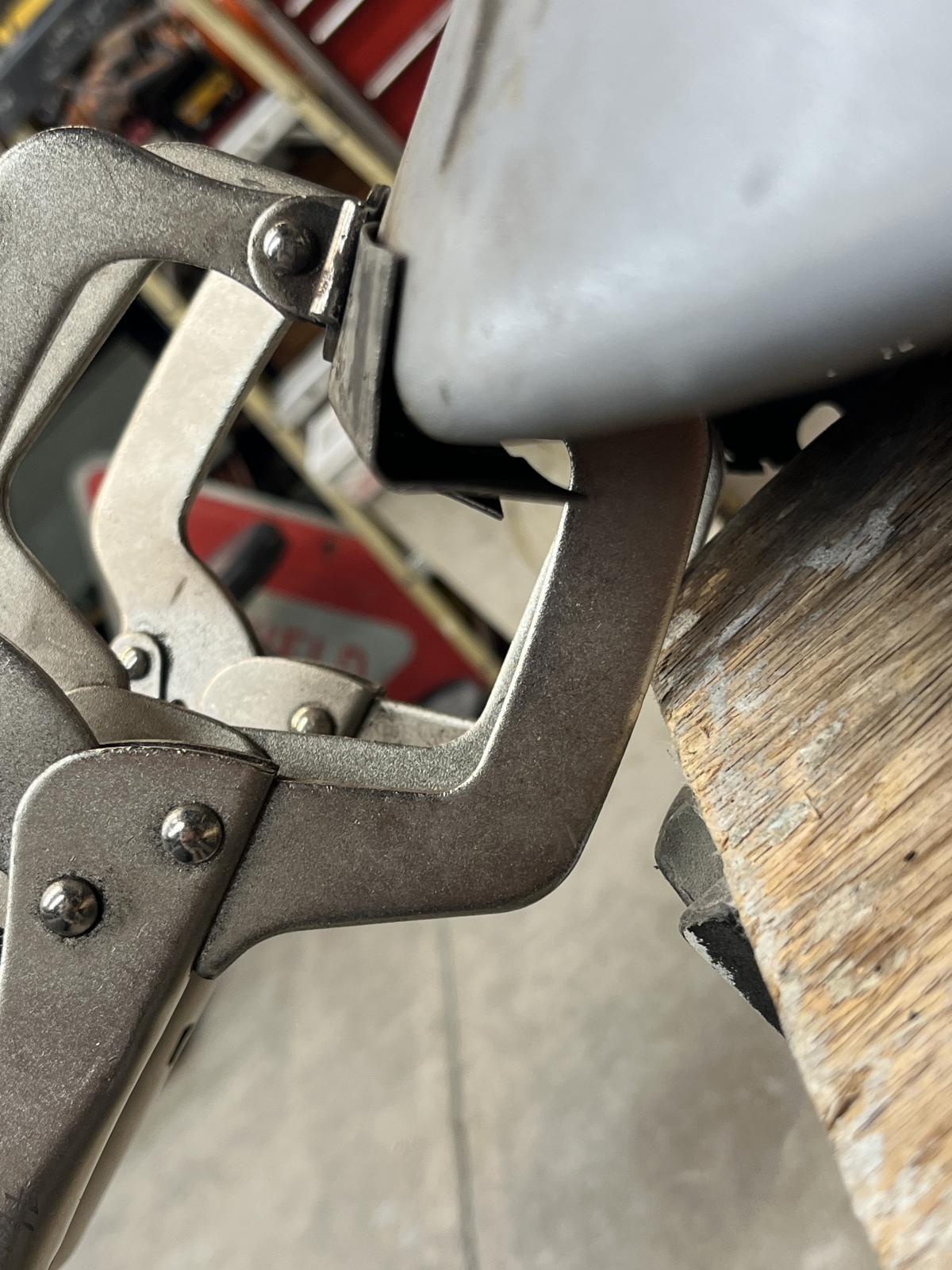

I had to cut the folded edge to get the piece to relax enough to fit the shape. You can see the segmented cuts here.
Those will get formed 100% and welded up later. However, I did take the time to shape the edge a tiny bit. I bent the first tab around to fit then the next. Marking each segment overlap, so that I could cut out the portion under the top segment.
The piece was then unclamped and cut. Look at those tiny slivers!
And the resulting piece. A double compound curve with a rolled over edge!

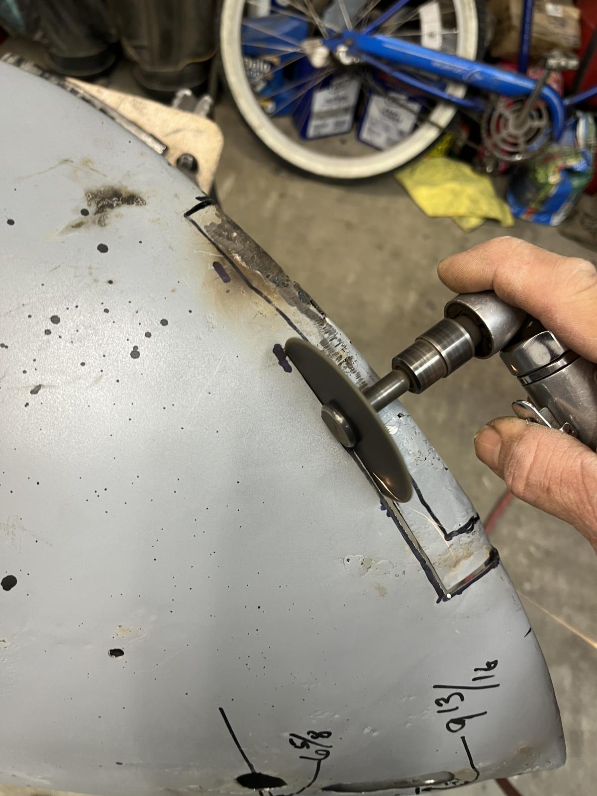

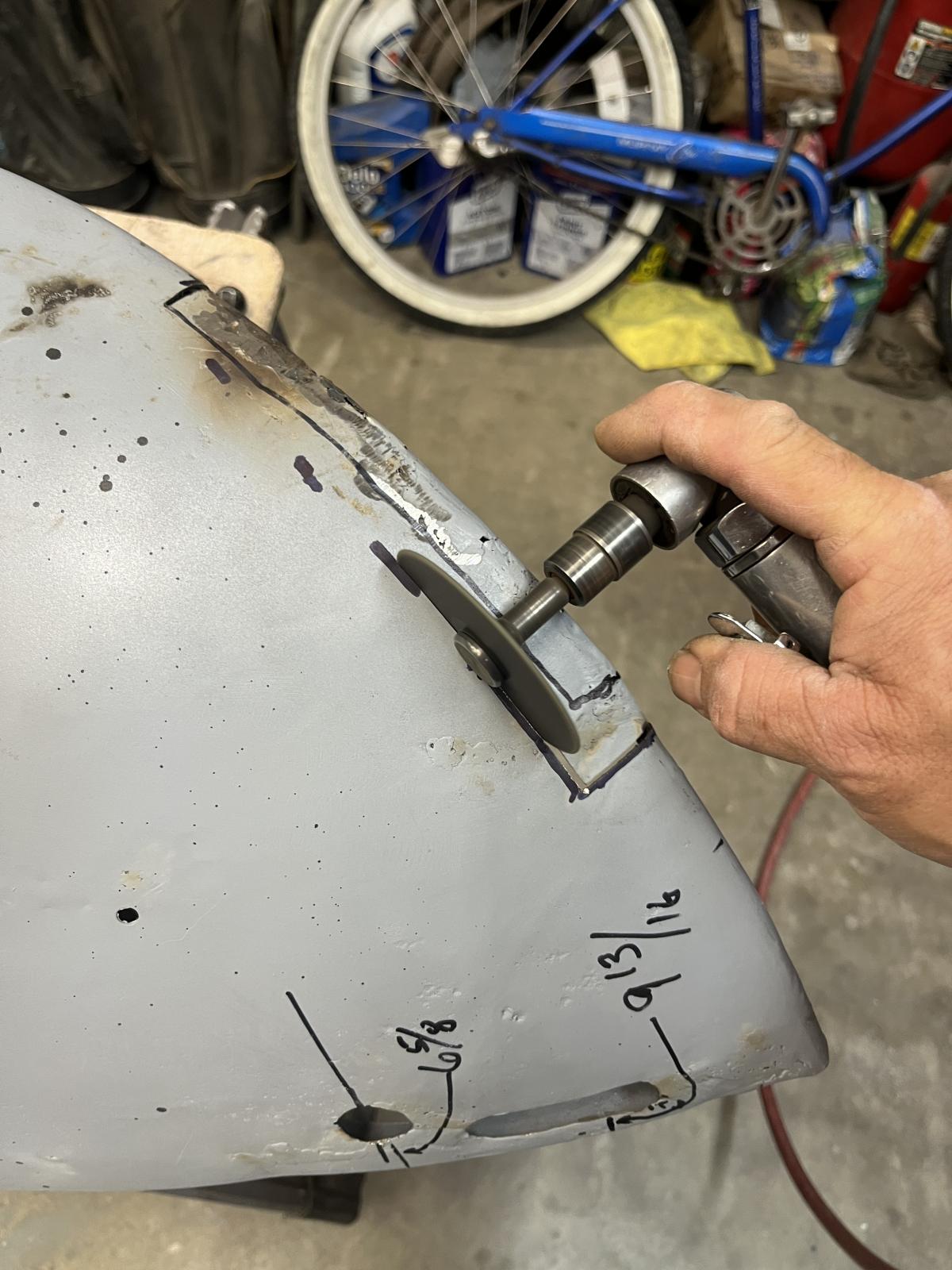

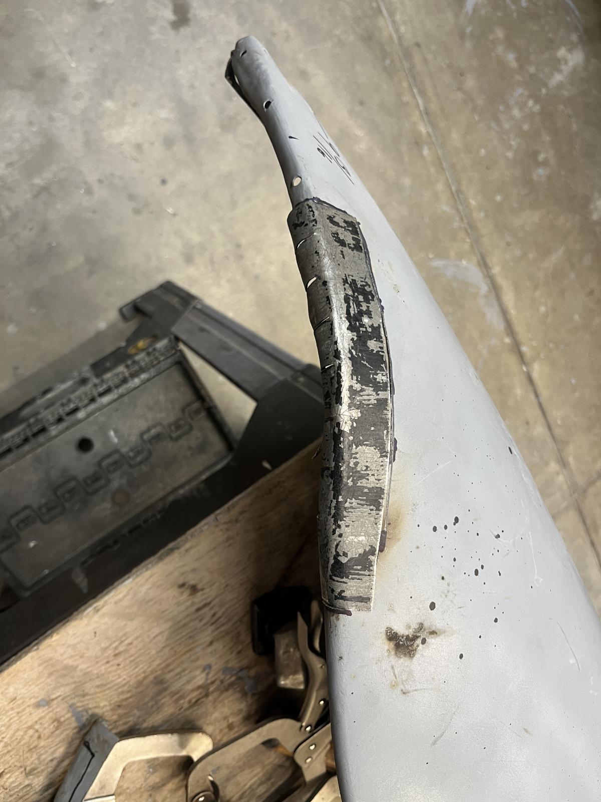

Let’s cut the fender! Dropped the disc in after cutting the 2 short sides.
Cut it till it dropped out! Left the marker line, as that was the outline of the patch!
I then picked up the fall off piece and slipped it into the patch. Then I clamped the shit out of it. The hammer was then used to finish rolling the edge over, matching the old piece 100%!
And there it is….PERFECT!

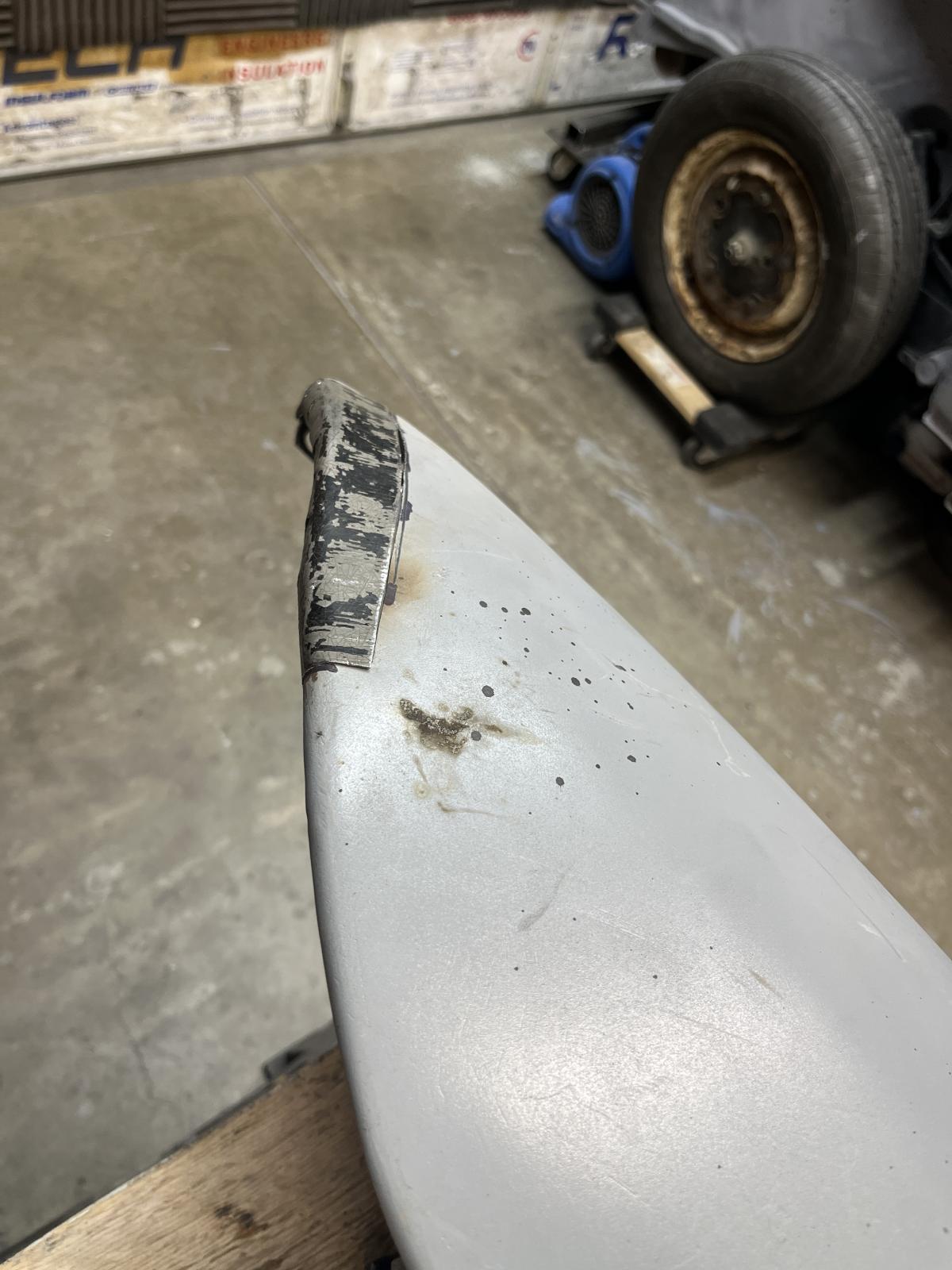

I removed it and removed the paint from both pieces. A flap disc on the fender and the blast cabinet for the patch.
It was then clamped well and welded into its place!
Then my good friend rang the beer bell! Time for a few pints and a late lunch! Primed the exposed steel, then pushed the Bug over to its spot and checked out it’s rear section!
Not too shabby, right? Hopefully I can get a few more hours in before the wedding!
