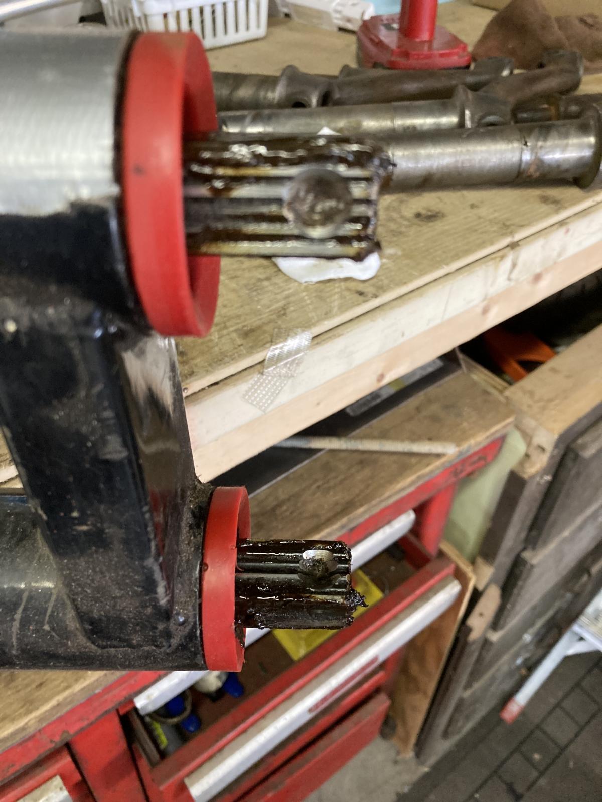

PostPosted: Sat Apr 30, 2022 2:12 pm    Post subject: Re: Pictures of tire, wheel, and suspension thread for FAQ's Reply with quote
Narrow beam question.
I’ve had this narrowed beam for years. Finally getting around to trying to use. Problem is the lower spring plates seem to have the simple 90 degree off??

PostPosted: Sat Apr 30, 2022 5:07 pm    Post subject: Re: Pictures of tire, wheel, and suspension thread for FAQ's Reply with quote
type4split wrote:
... 90 degree off??
Look at how the adjusters are oriented; they're about 90° different from one another.

PostPosted: Sat Apr 30, 2022 5:27 pm    Post subject: Re: Pictures of tire, wheel, and suspension thread for FAQ's Reply with quote
I noticed that. Wtf. How would this have ever worked? I almost thought it was raised for a minute….. well, 1/2 raised
Is it possible they had the dimples 90 degrees out ?
****edit******. Figured it out, Put it together like it should. Found the center location. All 👍🏻 good

PostPosted: Wed May 11, 2022 5:13 pm    Post subject: Re: Pictures of tire, wheel, and suspension thread for FAQ's Reply with quote
Did the center anchor have 2 sides threaded for set screws? I could see a setup with one short set screw to hold the bars, then turn the center 90 degrees install the long one (with a flat bottom) to hold the center anchor in place on the beam. This would cause the adjuster to be turned 90 degrees so it is not going to get ripped off if you go too low.
