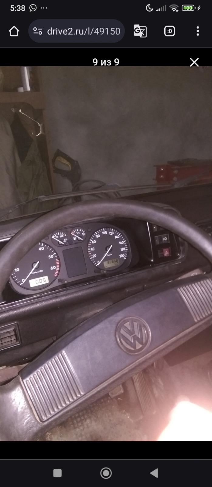

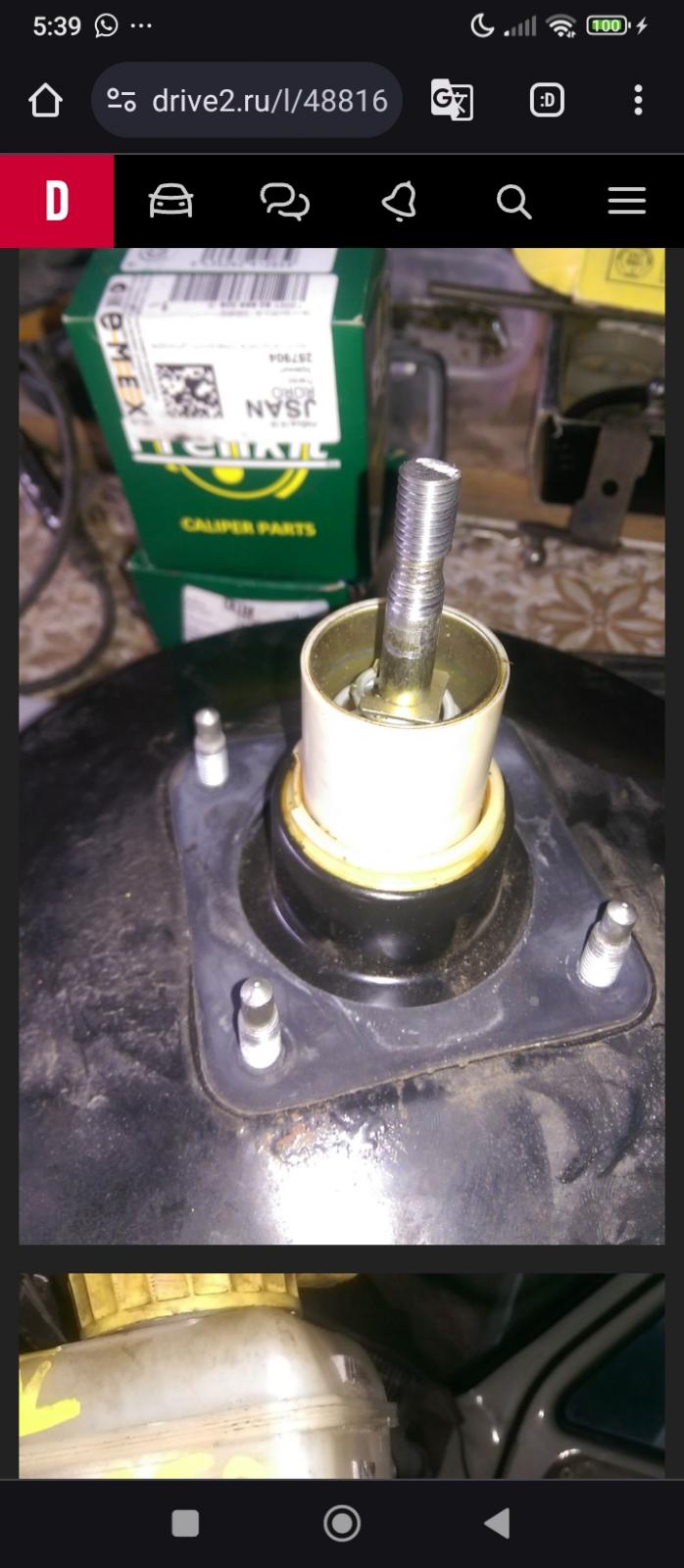

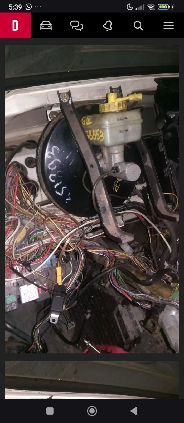

PostPosted: Fri May 17, 2024 7:47 pm    Post subject: Re: Bigger brake booster, improved brakes. Reply with quote
Golf mk4 ,dashboard vw polo
