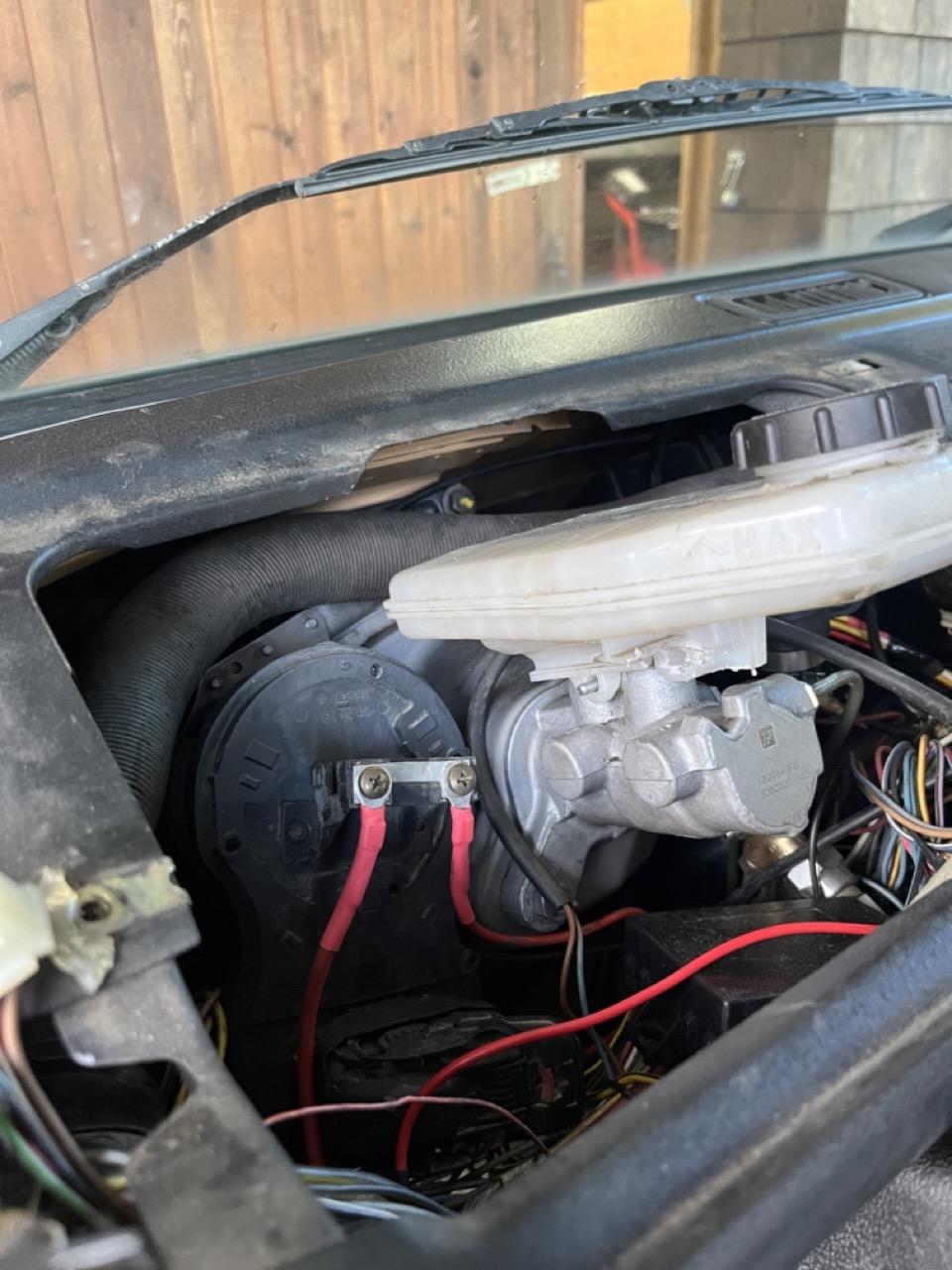

If you wait a few days, I am hoping to see how the Honda Accord iBooster fits this weekend. With how many old restos are using the Bosch iBooster, I think it's definitely the way to go.

I have a iBooster out of a Tesla Model Y installed in my Doka. As far as I'm concerned these will be the future of brake upgrades. Compared to the BMW booster which I have so ran in the past the iBooster with the larger bore MC feels incredible. It feels more up to modern car standards if that makes sense.

MarkWard wrote:
. For sure the above reservoir sure looks hokey. If you want the van on the road with the least resistance, buy a new booster while you can.
The Honda Accord model has a remote reservoir. I bought a motorcycle reservoir but I realize it's not going to be large enough. It'll be enough to move it around the yard though. I am hoping this set up will allow the cluster to sit properly without any modification.
My thread with the install in progress.
https://www.thesamba.com/vw/forum/viewtopic.php?t=...;start=140

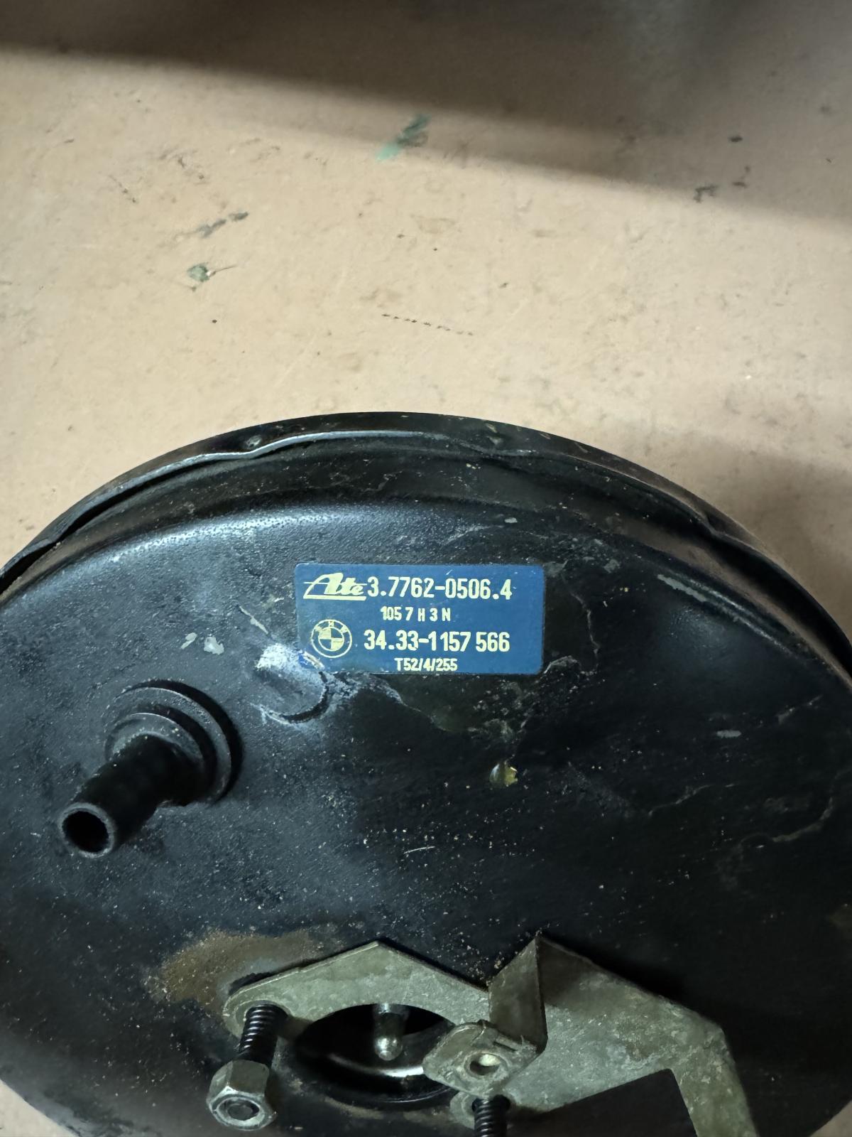

For any who might be looking, I have a BMW ATE brake booster that I was planning on using and instead it looks like I'll be selling my van.
Excellent condition (OEM), pulled from an 88 528E with 108k miles, part number 34331157566. Paid $150 for it and putting it up in the classifieds shortly, feel free to message me if you have interest.

thanks you all folks!
I have heard mostly good things about E30 but Alika's comment (step in dog's shit, lol Wink ) made me wonder if it was the way to go.
About the 60mm piston, I am not sure what you are referring to cause the girling 60 has 2 pistons at the front (smaller than 60, if I recall right) and the small car system piston is definitely smaller than 60mm.
Also, I had to order some parts from Brickwerks recently and the owner Simon told me to "try harder" to find an E30 booster of all the options I asked advices for.
I happen to have found one last friday in a scrap yard and they will send it to me in the next few days.
The next step is to convince me that I will put that old part in my van, without much testing and that I will be really really pissed should I have to take it all after bleeding everything and putting my cluster back, etc...
I guess the most important is to make sure brake fluid did not leaked in and some mechanic today sugested me to test it with pressure (instead of vacuum) and (taper) plugging the M/C hole which I think might work, at least for major leaks/problems...
I tried to find somebody in my area (deep Canada...) that does test and renew it and after calling a few knowledgeable mechanics, it is not common at all at least in a radius of +- 200 miles of where I live...
FYI, I ordered a rockauto Cardone 53-2601 and received the crappy "generic one" with the thick black spacer. I would not say that it could not be done BUT there were a lot more challenges than the "how-to" on the internet. there is a guy on the samba that documented fitting it but AFAIK, he did not said that he got to the end. I tried to put it in the dash to begin with and I was not able to put the 2 top bolts (just one at the time) since the outside diameter of that one was interfering with the bulkead... When I have seen that, I said myself it was not worth trying modifying it and I searched the scrap yard...
