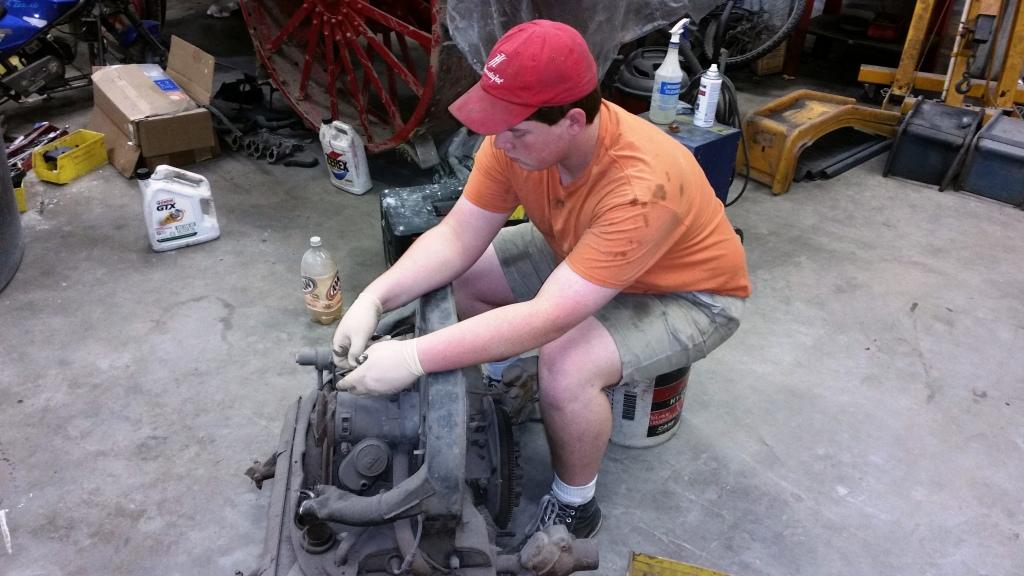

PostPosted: Sat Jan 02, 2016 7:02 am    Post subject: Noah's 1972 VW Type 1 Sedan Restoration Reply with quote
We removed the engine and started teardown. Will post pictures of old engine once the cylinders are removed. We plan to use the cylinders and pistons on the new build. Here is a picture of the car being backed into the shop for engine removal.
Getting started on the engine removal
Engine removed, note we did not have to discharge the A/C system.

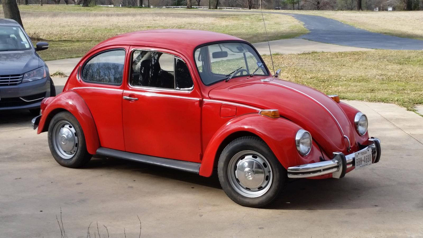

PostPosted: Mon Feb 27, 2017 11:13 pm    Post subject: Re: Noah's 1972 VW Type 1 Sedan Restoration Reply with quote
Added VW mud flaps!

PostPosted: Sun Apr 23, 2017 6:57 am    Post subject: Re: Noah's 1972 VW Type 1 Sedan Restoration Reply with quote
VW Spring Fest at Bob Beck's VW in McKinney, Texas. Car is still running perfect. It was cold and looked like rain, but the rain held off and we had a good time.
