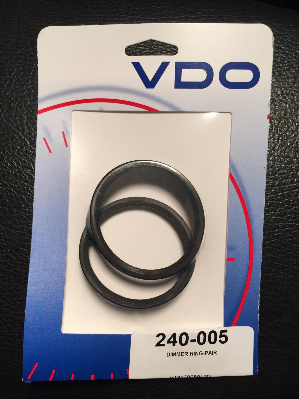

Yeah, those anti-glare bezel trim ring things work great. I was bummed to see such a strong reflection on the windshield the first night I drove around with my new gauges. Slapped on a set of these and "problem solved."

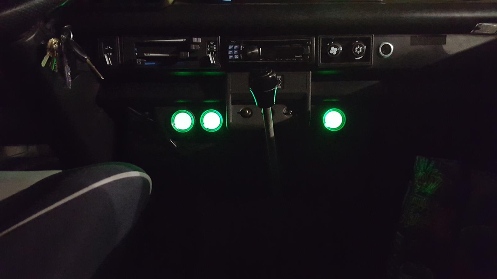

This spot has been working well for me, it doesn't interfere with the shifter and I can glance down there pretty easily. Version 2.0 would have the gauges tilt toward facing the driver, like the ash tray pod posted above, for a more accurate reading. Note the beer is for garage use only, not on-road.
It's just a piece of aluminum that I bandsawed and holesawed and bent in the metal brake. I had to file away a small bit of the plastic dash vent cover to route the wires. Trying to imagine how to tilt the gauges toward the driver without having them stick out any further from the dash, into shifter country. Slightly more technical bending is on the way..

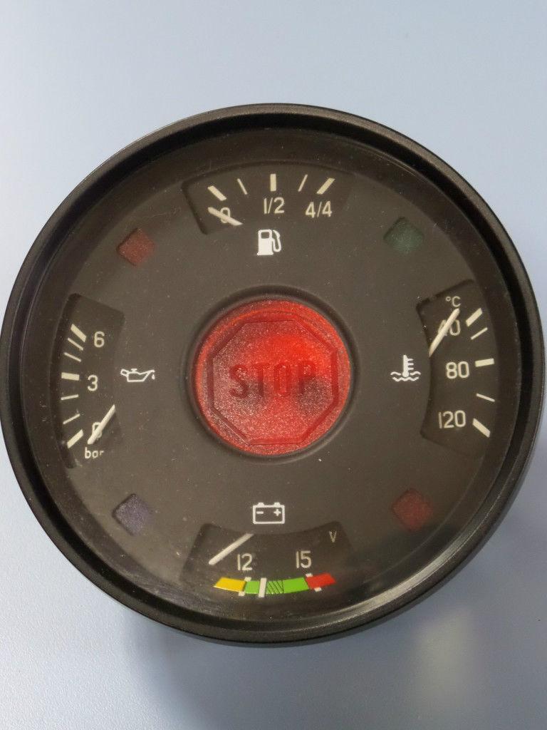

anybody try something like this?

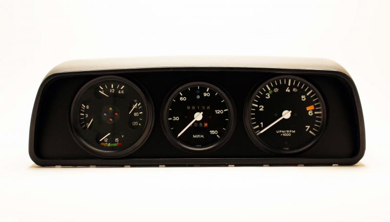

I made this dash for the doka. I know I will need to deal with the m/c. I bought the left gauge on ebay. The original gauge was about 50% larger than I needed. I machined a new housing the same size as a Porsche tach housing and fit everything in, and used the Porsche lens and trim rings. The tach is from a 914, and the speedo is a mechanical 911 unit. I bought a early vanagon mechanical speedo cable to connect the gauge.
