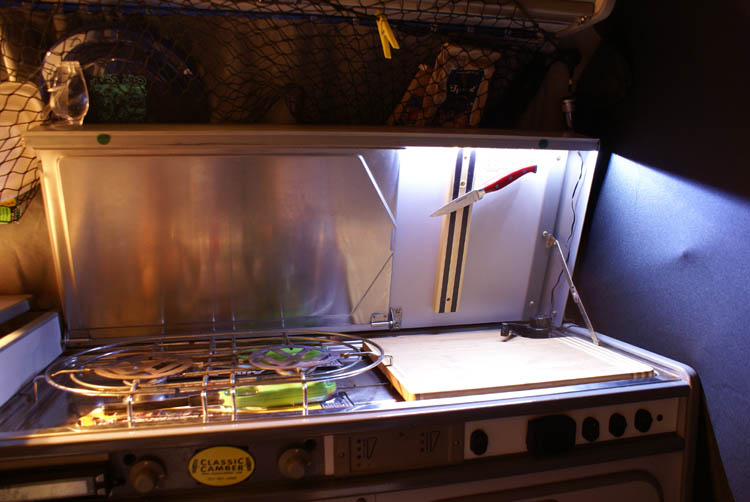

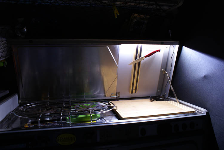

Hello all,
When our vans were made, LEDs could do little but illuminate themselves as indicators and that was pretty darn cool at the time. Today, LEDs are really coming into their own as light sources with new products emerging at a rapid pace. There is much to like: LEDs are long-lived, very efficient, and agreeably compact. In just the last year they have become more powerful, less expensive, and their color continues to improve.
Having just competed a few basic mechanical chores (yes, including new 30R9 fuel lines!) with the 1990 Westfalia I acquired in September I thought the dark days of winter would be a fun time to play around with an interior lighting makeover. Thus, as a relative newbie I have followed this thread with interest.
I ended up using products from Oznium thanks to a pointer from climberjohn in this thread. It was very smooth doing business with Oznium – they were fast and reasonably priced (I have no business connection with them). I ended up using two different LED products from Oznium, both quite satisfying. The first is their Waterproof SMD Bar, which provides about 30 surface-mount LEDs in a ¼” by ½” aluminum channel that is 20” long. Each SMD Bar consumes ~2.4 W at 12V. I have placed two bars above the kitchen counter, a bar above the rear bench seat, and a bar in the lower center of the dashboard. I have also used Oznium’s High Intensity LED Flood Light in the back bay of the van over the engine compartment.
As climberjohn notes, these LED strips are a bit too glaring for use in the normal field of view. For the installation over the kitchen counter I used a length of ½” x ½” aluminum angle as a mounting shield. This works really well to direct a useful swatch of light on the top surface without glare and the 1/2" "fixture" is so small you hardly see it. I mounted the strip underneath the inside edge of the shelf above the counter. In this position it illuminates the cooking surface and sink nicely when the kitchen lid is raised.
Daytime view of the installation:
… and the light it provides at night.
The strip of lights over the rear bench seat was a bit more prone to glare since folks sitting there would be just a foot or so away from the source and looking toward it. In this case I recessed the LED Bar into a 5/8” x 5/8” aluminum channel. The sides of the channel are just right to block the occupant’s view of the LED bar. Since aluminum is a shiny reflector I placed a strip of old, black Velcro tape (it was handy) on the inside surface of the channel so it would not reflect back into passenger’s eyes.
Daytime view view:
Nighttime view:
I followed the lead of thatvwbusguy in mounting a strip of lights on the dash board. In the case of Oznium’s LED Bar the LEDs are already mounted on a tidy strip of aluminum. I elected to mount one 20” bar at the bottom of the metal portion of the dash using two small plastic clips that came with the bar. I applied black electrical tape to the exposed aluminum surfaces of the bar to help it blend in with the dash and, like thatvwbusguy, routed the power leads to the existing map light. This is working fine except the map light switch is a little fiddly.
Daytime views with the dash light off and on:
Light number 4 is a single Oznium High Intensity LED Flood Light mounted over the engine compartment. This is a small single LED fixture with a substantial 1-1/4” round aluminum heat sink. It lights the engine bay quite nicely but is probably the wrong geometry for a reading light.
View of the small flood light and the light it produces:

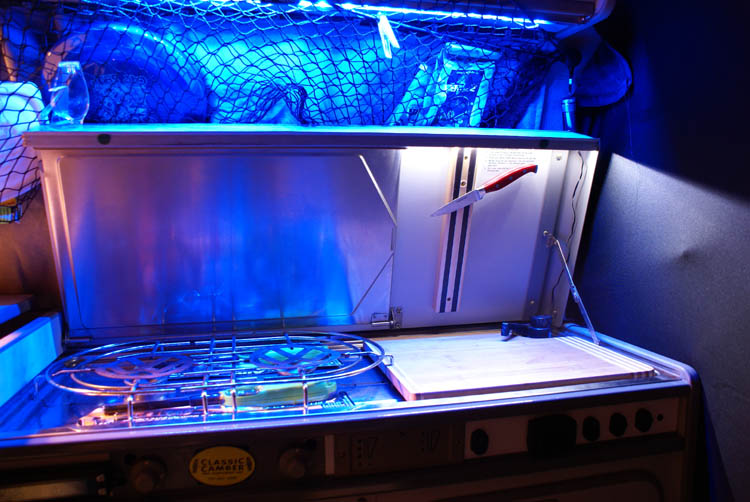

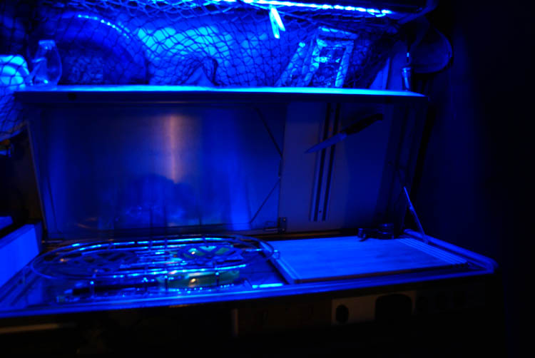

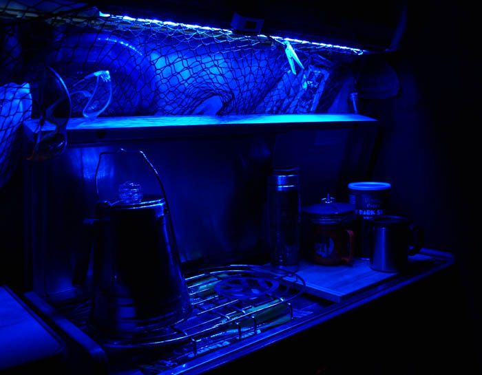

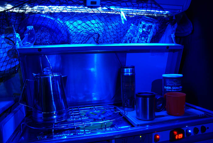

PostPosted: Sun Jan 09, 2011 5:06 pm    Post subject: Reply with quote
Thanks Chris for the pics of your install, it was eactly what I was looking for when I
saw them. However, the leds color was too bright for what I want them for.
I was looking for light not to cook or prepare, just something that would light the
area and still provide enough light to see but without the white light. I've looked at
the blue lights mutiple times and thought how could I use them, as I have other blue
LEDs throughout the van. When I saw your kitchen fixture, that was the answer.
From a different thread, the poster removed his kitchen shelf to get at the wires
for new light fixtures he was installing. I didn't want to remove the shelf so that I
could tap into the kitchen lamps' wires. However I did want to put the LEDs over
the sink/stove. I removed the end piece of the shelf and used three 36" zip ties that
I had cut the clasp off from and taped then together. In the end I ended up with a
flexible piece that I could tape my new light fixtures wires too and pull them through
the small space behind the shelf too the front of the closet. I pulled an extra set
of wire through in case I want to add more LEDs down the road in this location.
I already had an LED light fixture in my closet so tapping into that power source would
be the easiest thing to do, to power the new set. Hopefully others that want to add
these lights in a same location can use this information and not think that they have
to remove the shelf to get to wires. They can just run their own, if they already have power
somewhere else close bye. Here are some pics of my new LEDs, thanks again Chris.
Backlit from my other Blue LED over the slider. That one is a POD and is very bright.

heliodon
Joined: October 20, 2010
Posts: 34
Location: Berkeley, CA
heliodon is offline
PostPosted: Tue Jan 11, 2011 10:44 am    Post subject: Reply with quote
The aluminum sections I used to mount my Oznium linear LED strips serve two purposes: 1) they neaten up the installation and 2) they shield the bright LED light sources from the direct view of our Westies’ occupants. The trimming function is pretty subjective so we can all do that to taste. The shielding function is a more quantitative geometry / finish properties exercise. The idea would be to prevent line of sight to the LEDs (or their bright reflection) from any common, nearby point of view while minimizing obstruction to the useful flow of light.
Since the LED strip over the side counter is only viewed from one side, an L-shaped angle section is sufficient to shield the strip. The light over the rear seat can be seen from the front and the back so a C-channel used there shields the strip from both points of view. One thing I noticed while putting my installation together was that the inside surface of my clear anodized aluminum channel did an excellent job of reflecting the bright LEDs. This is good for getting light out of the “fixture” but bad from a glare perspective since the reflection was almost as bright as the carefully shielded LEDs. I worked around this by covering the offending surface with black tape (in my case leftover Velcro.) Climberjohn’s C-channel with a black finish should be a good approach – I am interested to see how it turns out.
I think C-channel would work fine over the side counter, especially if you do something to tone down the back reflection from the inside surface, but an L-shape section is better.
BTW, I recently checked the Oznium WWW site and they have a new wireless remote for the LEDs with eight-step dimming. The system appears to have two circuits but, sadly, they are only used for flashing back and forth for a "wig-wag" effect. What I would really like is a remote that controls on/off and dimming individually on two (or more) circuits.
Cheers,
Cris
90 Westfalia (current)
91 Cabriolet (current)
60 Bugeye Sprite (good prep for VWs)

ClimberJohn you got me thinking Mood/Work light so here's my compromise.
Mood Only
Mood with work
Only Work
Work plus Stock
The Whole ShaaaaaaaaaaaBang!
I'll clean up the wiring after work tomorrow and add another switch to the Kitchen panel
for the new Work light.
