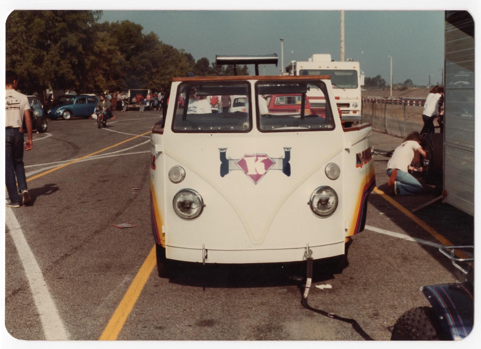

From the 81 Bug-In (OC raceway):

PostPosted: Tue Jul 01, 2014 10:08 pm    Post subject: Reply with quote
I remember seeing that bus wheelie down the track at OCIR. I've been waiting for someone to post a picture of it. Thanks Shoyrtt!

PostPosted: Wed Jul 02, 2014 1:03 pm    Post subject: Reply with quote
I remember seeing it also in the early 80's. Very cool to see it wheelie! Cool
Dave Kawell's site has a great article about the bus with all of it's history:
http://www.kawellracing.com/racebus.html

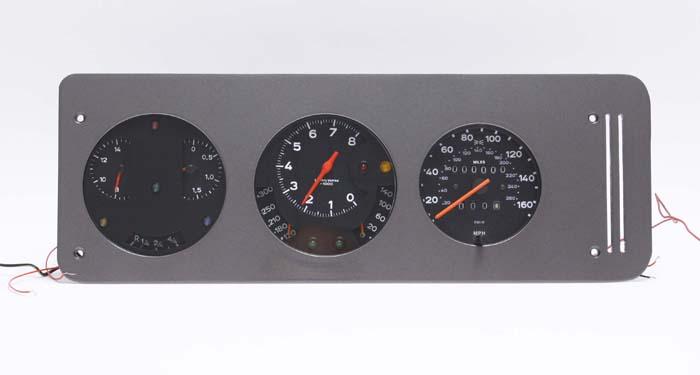

PostPosted: Sun Oct 05, 2014 6:12 pm    Post subject: Reply with quote
The turbo motor is moving very slowly, parts still out being machined. Displacement got bumped up to 3.3, SC cams for better low end torque, ported heads, match ported injector blocks and cis intake. Also picked up a set of used headers w/heat. Turbo will be a Garrett GT35 for quick spool up.
Meanwhile I made a new dash and gauges.
