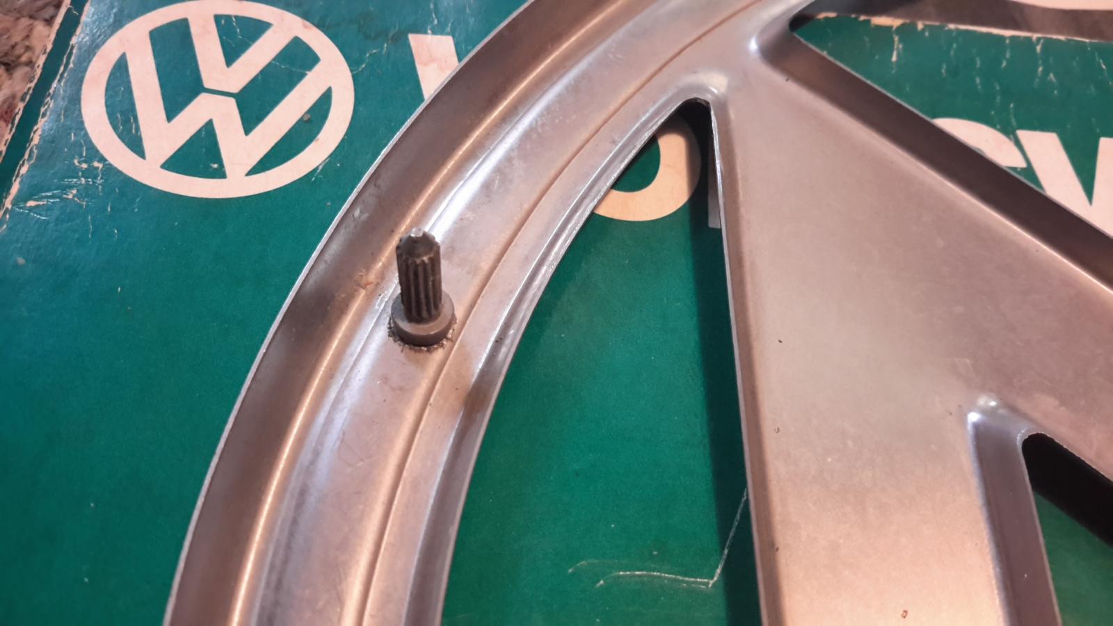

Or (if you can hold them still) find a sheet metal screw of the correct size, then screw it into the old clip and PULL!!

The factory emblem was mounted with posts affixed in plastic "receivers" that slipped into the original holes in the front of the bus.
Aftermarket emblems use threaded posts with fastening nuts. Using this method does keep your emblem from ending up on someone else's bus ! Evil or Very Mad

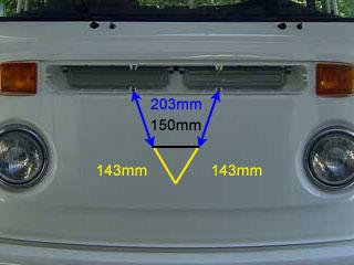

Hey guys, I posted this over on earlybay.com and thought it would be useful for you too:
Hey guys, as a little thank you to the forum I have created a 1:1 scale drawing that you can stick to the front of your bus and use as a template if you are trying to fit a front badge but have no holes present. I have taken the measurements from the photo posted above, and checked it against my own early bay.
You can download it from here:
http://naturalmohican.com/permanent/forum/VW-T2-FrontBadge-Template.pdf
If anyone wants me to print out a full size version for them I may be able to do that soon as I have purchased a plotter, otherwise any printing company can do this for you.

brenthughes wrote:
Here are the dimensions from my '68.
The measurements involving mounting holes are taken from the center of the hole.
I'm guessing it would be easiest to center the emblem by dividing the the 2-11/16" grill center measurement and 6-3/8" pin to pin measurement in half. Maybe use a plumb line if you can level the bus itself.
A 15/64" drill bit fit snug in my mounting holes, made thinner by a couple layers of paint. However, I believe a 1/4" bit will be too large.
My only advice would be to punch your marks, start with fresh, small bits and move up to the 15/64" size.
Good Luck!
Brent Hughes
