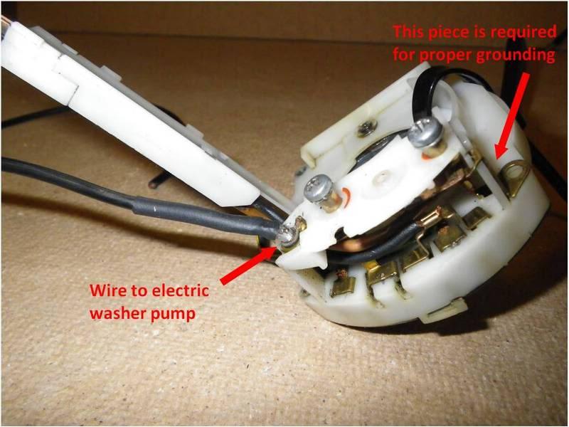

bikelash wrote:
I will try to find some pics but Joel did a write up on it. When you pull the washer stalk out some have a black wire that is attached to nothing.
If there is no black wire just look for the connection point at the same place as in the pic. It is simpler than it appears. When you pull the lever back it will energize that wire. Then use that to energize your pump. Been using a new for a couple of years now and it works great
BTW this pic is from Joel's write up.

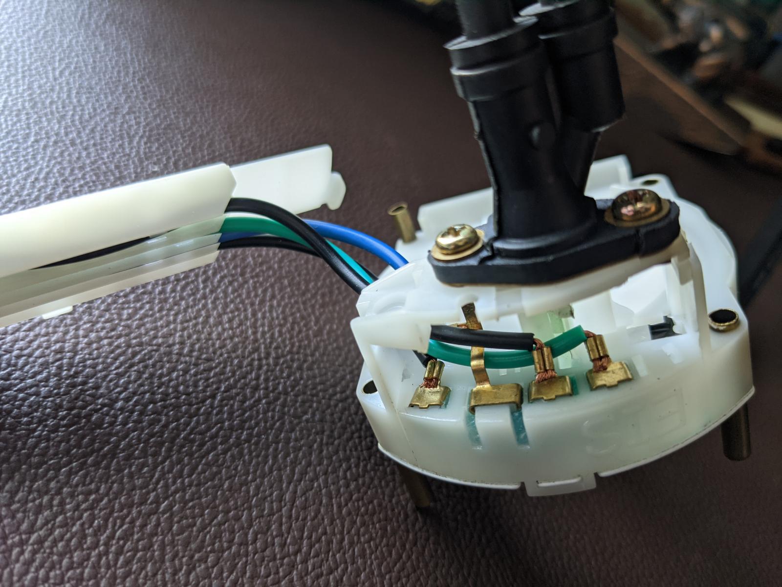

Which wire would be the equivalent on the new stalk??

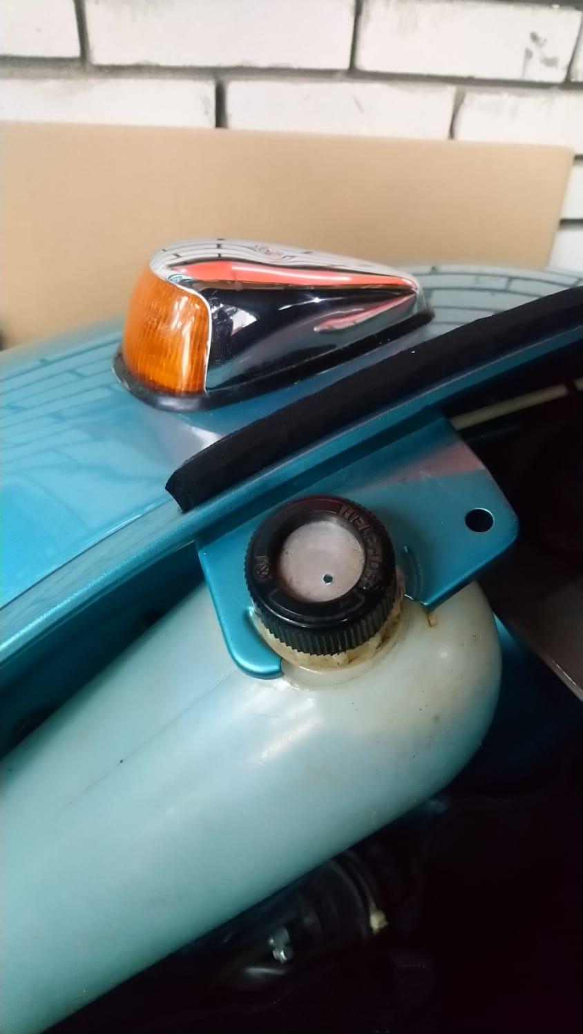

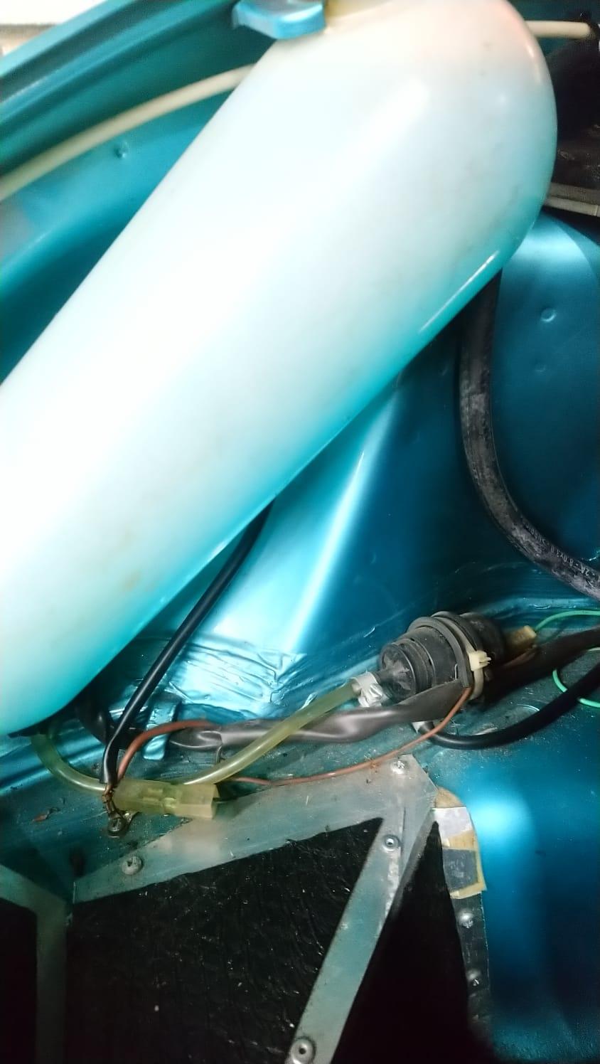

Beetlebaum wrote:
How does that pump work? Maybe I should get one for my (US-spec) '73 Super Beetle, which has never had a working windshield washer system.
I think you would be better off with a kit like this:
https://www.paruzzi.com/nl/volkswagen/elektriciteit/ruitenwisser-ruitensproeier/2448/
You can place this pump inline the current tube, and then you can retain your standard washer fluid reservoir. The pictured mexi reservoir does not really fit in the front of a super beetle (as Paul already pointed out).
If you're handy, you can also only buy the pump, which is a lot cheaper.
Search for part number 431955651, you will find a lot of offerings.
But you will need a switch, cables etc. .
BTW, the little pipe on the side is the exit, the one on the top is the inlet.
I use this pump too in my super beetle:
I've modified the cap of the reservoir so it has a little hole for air to get in:
And I've modified my steering column stalk to accept a micro switch:
http://www.gerrelt.nl/section-modifications/window-washer-switch
