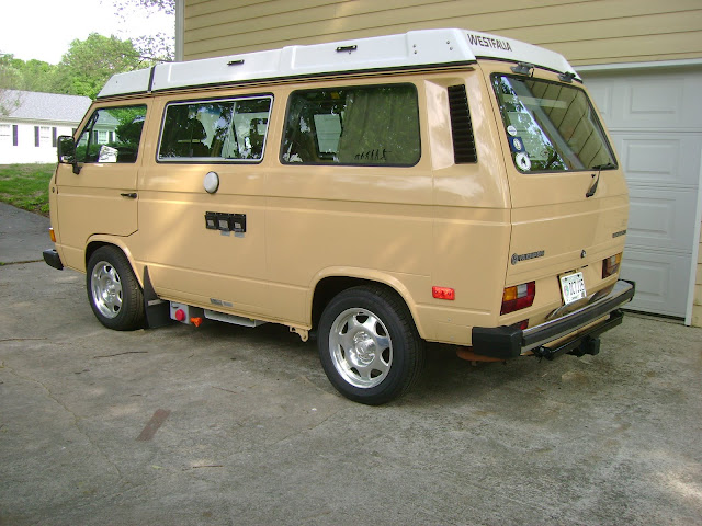

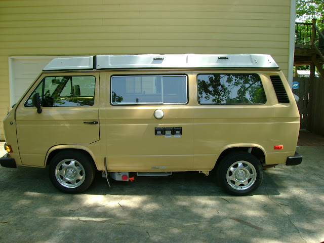

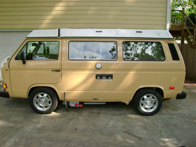

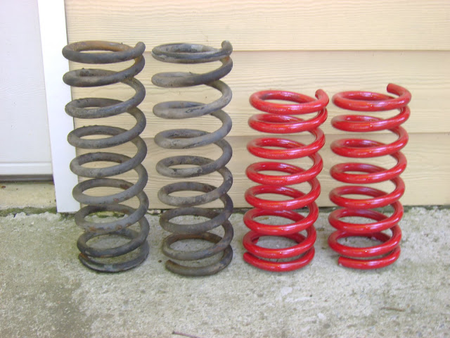

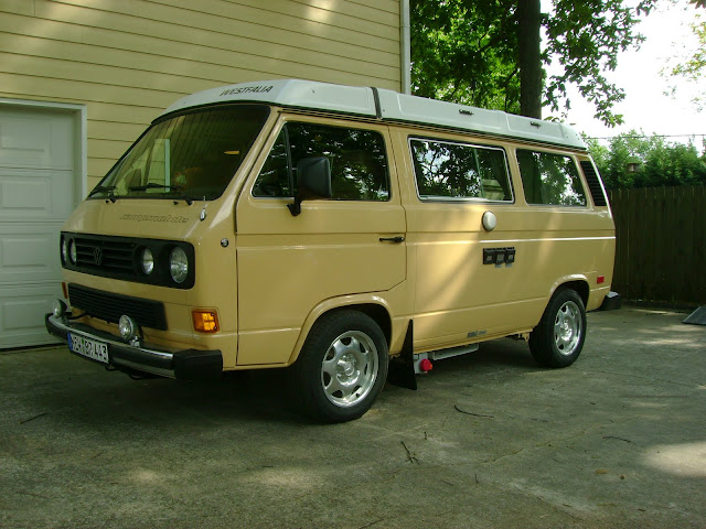

Okay, here are my pics. Already had put the CLK wheels on there a few weeks back, so installing the Carat springs was the finishing touch to de-Monster Trucking my Vanagon. My old set-up was this
Tall 85 Springs paired with 15 inch alloys rolling 215/75-15 BFGs
So here are the front Carat springs sitting next to the 85 springs I just pulled off the van.
Here's the van with front Carats and rear tall 85 springs. Got the 70s muscle car rake to it.
And here we go all Carat'ed.
Haven't really had a chance to drive it with the new set-up, I need to head to the alignment shop first thing in the morning.

Hey Hiram, that looks RIGHT! Can you pull a measurement from the center of the wheel to the bottom of the fender well?
First thing I did. Old set-up wheel center to fender lip was 17.25 all the way around. With carat springs I've 15 inches up front, 15.5 in the back.
The van is noticeably lower, even at a casual glance. I no longer have to make a "jump" up into the driver's seat, it's now just a little "hop"
These springs, along with the CLKs and 16 inch 60 series (correctly rated) tires should transform the van's ride. Couple that with last weekend's complete front brake overhaul with new pads, rotors, lines, and calipers, and then add in the rear disc conversion I did about a month ago, and I've pretty drastically changed the driving experience.
When the crate Zetec that is sitting in my garage goes in, it will be even better.
And, yes, new Koni's are on order for the front, and I'm going with the Gabriel air shocks in the back.

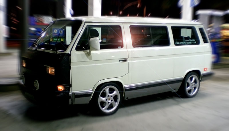

I am running H & R red (purple) with Koni shocks, Adeco sway bars, and soon to be installed Burley upper front A arms for lowered busses.
Still has a slight wedge to the stance which I like. Rides like a big square go cart !

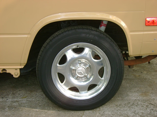

Hiram...side question... Did you have to mod the center caps on the CLK's to get them to fit? I have a set waiting in the wings and when I test fit them the center caps didn't clear the spindle/cap on the fronts.
I'm running a 5mm spacer in the rear, and a 8mm spacer in the front. With those spacers, and cutting down the front greasecaps a bit, they "kinda" fit. The fronts Mercedes center caps don't quite (like 1mm short) seat all the way.
They are staying put so far!!
