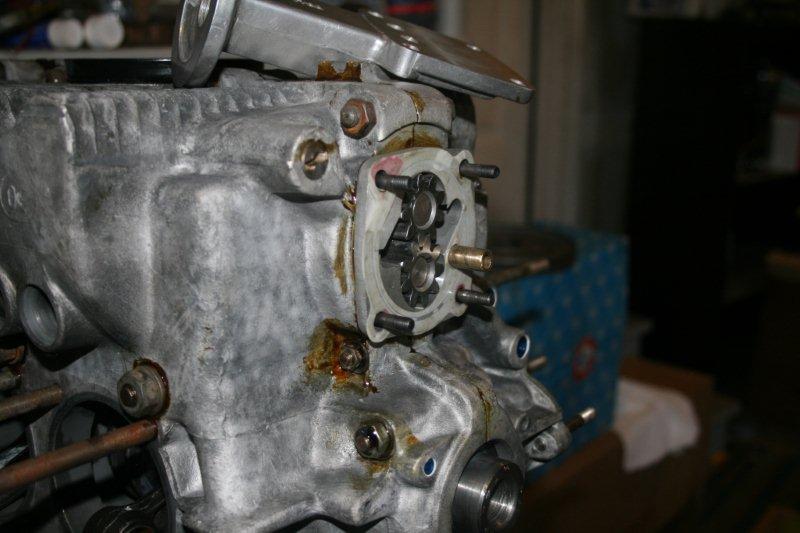

Here are my thoughts on it, based on tinkering and my experimental solution, from another thread. Getting ready to start it on the test stand...
Bart Dunn wrote:
Long time between updates....been busy with new kids, work, etc. Have been working on the sedan and getting it roadworthy, most significantly with the engine, although brakes are all done, new tires, wheels painted, electric mostly sorted out.
One of the things I want to do is have better oil filtration, but the full-flow plumbing looks like crap (IMHO) on a vintage engine. The galley plugs look bad enough... So, I'm fitting a CB Performance spin-on filter, as follows, which I don't think you'll really be able to see unless you get all proctological with looking at it.
Pump body fits fine in the case, but the issue arises with the 6mm studs on the older cases with the 8mm holes on this style pump. I fit a cut off valve guide in the oil galley in the pump body to line it up with the corresponding hole in the cover, like with a clutch alignment tool. Nice, tight fit:
Then I made some offset "spacers" out of some 8mm steel rod to take up the slack between the studs and the pump body and cover. You can see here one of the spacers and three of the studs, showing the problem. The issue is that while the case holds the pump body in place just fine, there's a ton of slop in the cover with these skinny studs, and the oil galleys will get all out of alignment between the pump and the cover. With these bad boys here, I can stand on it and it won't move, and I've ensured good alignment with the valve guide. Yes, the valve guide was removed before the final fitting of the pump cover:
Prior to firing up the engine, I'm going to make sure there's good oil pressure just spinning everything around with the starter. I've already cranked it around just by hand and have oil coming out the hole where the oil pressure switch is, so it appears all's going to be well.

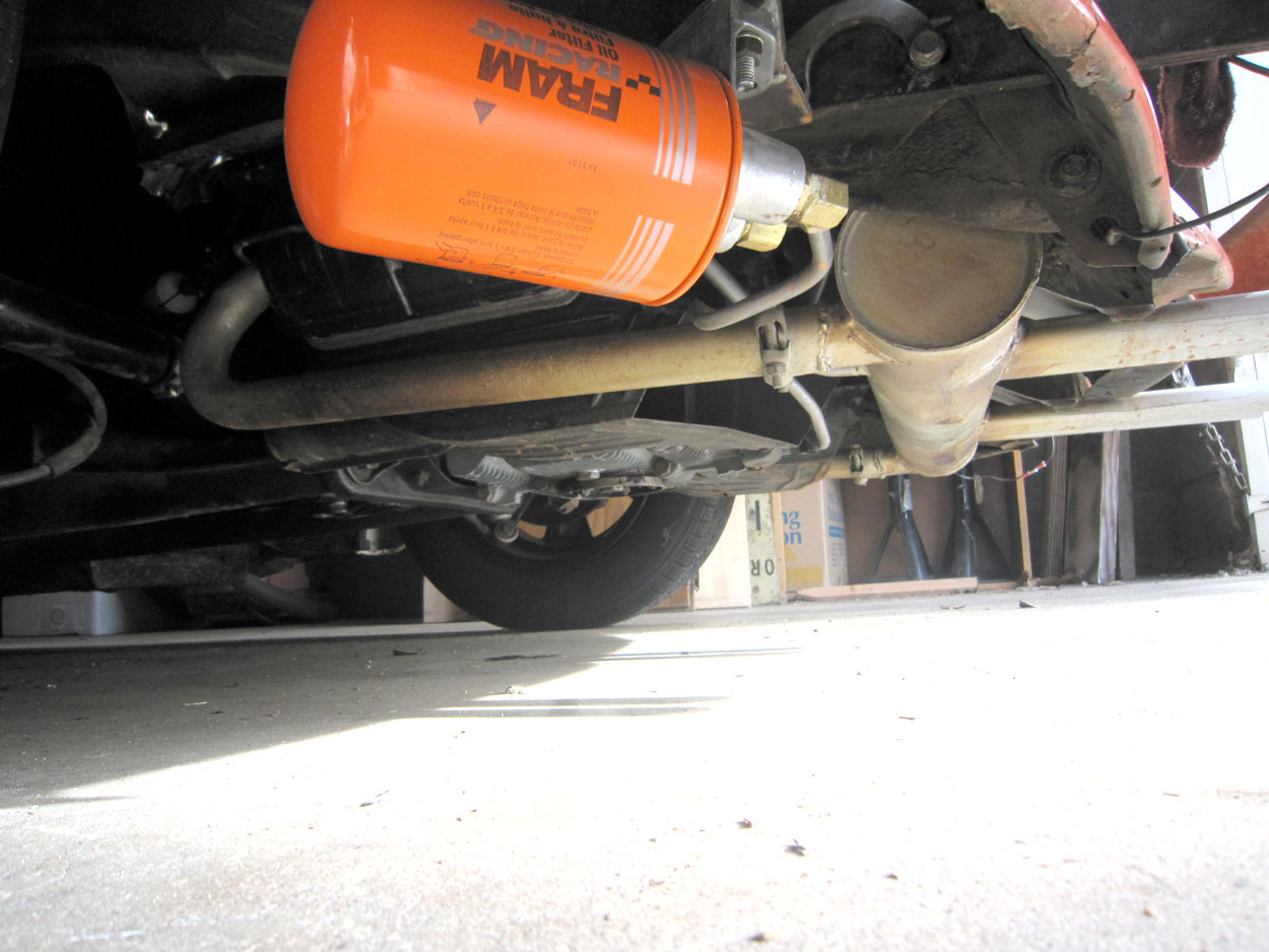

Here is mine running a CB in-out pump:
