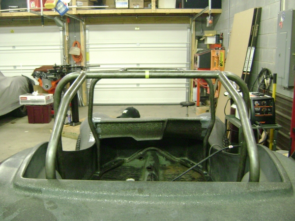

We did get a little work done on the Roll Cage this past weekend. Using some welding wire we formed the rear section of the roll cage and bent the 1 5/8" DOM tubing to match the shape of the welding wire by using angle finders and a protractor.

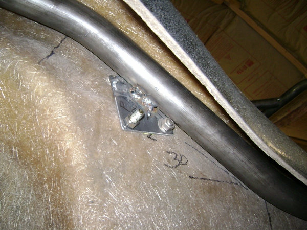

Instead of having to make some brackets that would show up inside the rear seating area we decided to make some threaded ends for the 1 5/8" DOM tubing and bolt the rear sections through the fiberglass body for a extra clean look. Cool
We proceeded to tack weld the joints of the roll cage with my new welder I received on Thursday. A new Hobart 187 MIG welder. My old 110 volt Hobart works well up to 1/8" steel but was strugling to penetrate the roll cage DOM tubing. Well worth the money. Very Happy
Hoping to get to the rear supports for the F/G body this coming weekend and fabricate some front body mounts and headlight supports. Very Happy [/img]

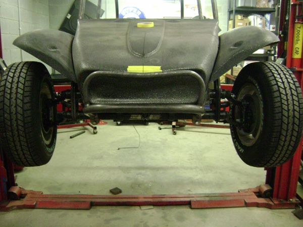

Front body mount to front beam with headlight supports to keep the headlights from shaking . Mount is made from 1"x2"x 14ga. rect. tubing with 3/16"x2" steel flat plate.

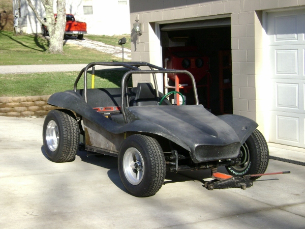

Rolled the buggy outside last weekend to work on my family car. Nice sunny day had to take a few photo's.
Mocked up the motor and new Tri-Mil header to start fabrication of the rear bumper and mounts.

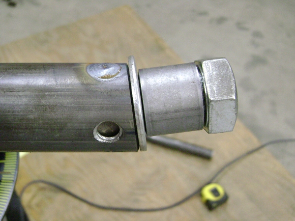

Made the rear bumper mounts so they would connect to the roll cage and rear body supports. 1"x 2" rect. tubing and 1 5/8"x.120" DOM tubing.
Had a pair of ladder bar safety brackets left over from my 1970 Camaro bracket car and they worked perfect for my lower bumper/cage mounts. Welded on some 1 1/4"x.120" pipe to slide 1 5/8" DOM over and secure with 3/8" grade 8 bolts.

Front bumper 1 5/8" x .120 DOM and 1" x .120" DOM.

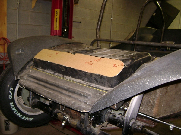

Well... been looking at the rear cage/bumper for a couple of weeks and was not really happy with the size and decided to remove approximately 4" from the main hoop. Also added a 2" receiver hitch to the cage/bumper for a tow hook or an aluminum hitch rack for long trips. Cool
After searching all day looking for a fuel cell to adapt to the buggy I have discovered why nobody has used a aftermarket fuel cell....THEY WILL NOT FIT!! Brick wall
I began to alter a stock VW tank and thought this was going to be alot harder than it really was...well we will see as soon as I weld in a flat plate and move the filler neck... but it clears the hood by approximately 1/2".

Sheet metal welded into buggy gas tank. welds look good but will seal inside of tank with POR-15 tank sealer and for extra protection JB Weld over weld stiching just in case. Rolling Eyes
Soon as I get my Cobra style flip cap I will relocate the fiiler neck.
