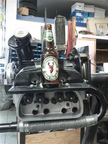

I am still playing with all the engine bits. I guess it is all baby steps with this type of build.
I am working on the cooling tin,t-stat and exhaust shielding, thanks to all the help in the performance engine forums.
I am fitting the exhaust. I know I will take alot of flak over my choice, but it is a just for now exhaust, while I save up for a Vintage Speed system.

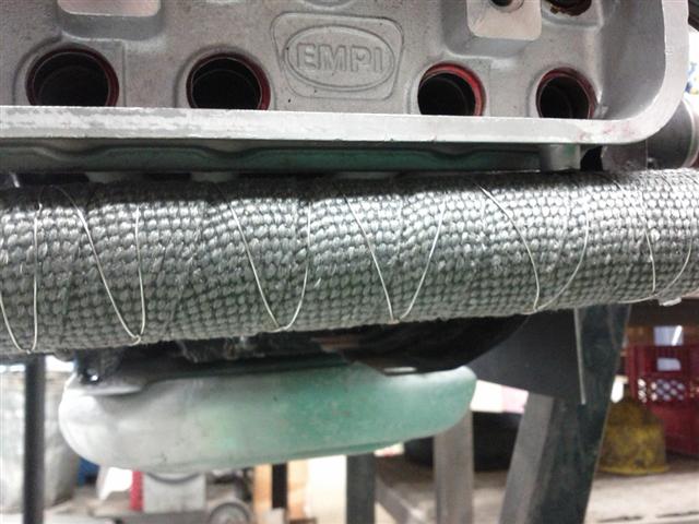

I have some concerns about heat transfer from the J-tube exhaust, so I wrapped them. I will also be fabbing a heat shield.
The exhaust wrap, with stainless wire woven over top. This helps to stop it from shifting.

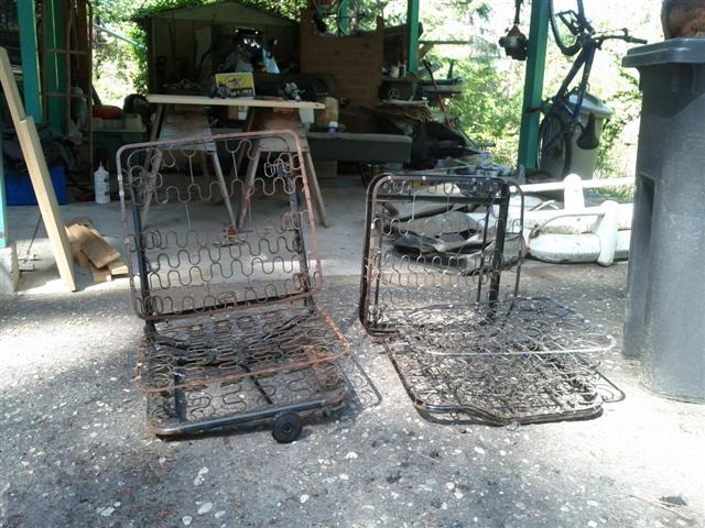

Get a start on the upholstery. removed all the old stuff and only broke one hook tang.
This seat back will be headed to Skaw's Bus.
I wonder if this is why my asthma has been acting up lately?

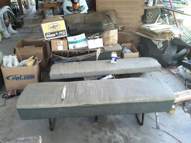

time to order the seat covers and padding. I will be going with Platinum mesh vintage TMI stuff. Panels too. Anyone had really bad experiences, or just the minor issues that come up on the search. I know there are better ones out there but they come at a much higher price than TMIs.
Headliner I will be getting from West Coast restorations as I have heard it is better quality at near the same cost.
Welcome to any suggestions you may have.

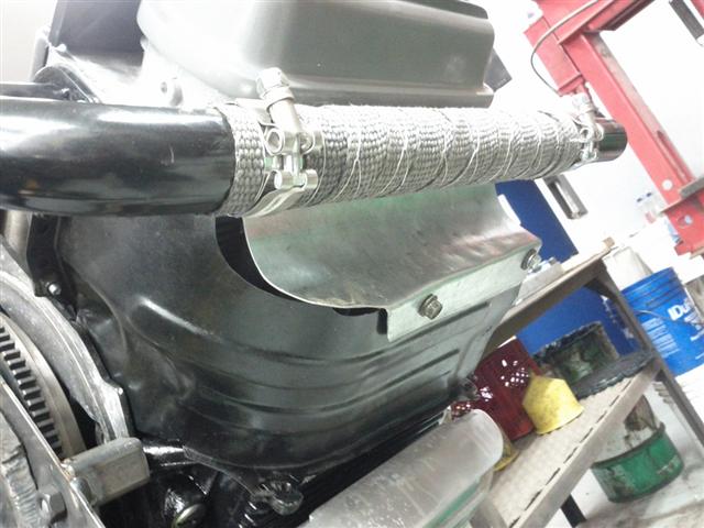

I had to "clearance" the full flow oil pump cover to fit behind the new degree pulley and the new pulley tin had to be cut away just enough to meet the clearsnced areas.
I bent up some tin to close in the sleds around the J-tubes , just enough to mimic what would have been the heater boxes. This should allow my T-stat to operate as intended.

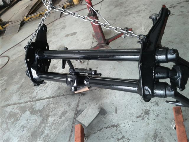

Now that spindles are nearly sorted out, I thought i had better get the other bits of the front end cleaned up and ready for reassembly. I ordered new link pins and roller bearings,tie rod ends, plus the adjusters for the front beam.
Axle tubes sand blasted and fresh paint.
New boots on the long axles now locked on the trans.
I was wondering if the '68 front swaybar would fit onto the link pin front end? If the pinch bolt for the lower link pin is long enough it could be used to bolt the ends of the swaybar to the control arm. Then the '68 swaybar bushing and clamp would fit right on the control arm too. The only issue I can see, is at full sag of the suspension the swaybar touches the front beam ends. I will ask if it has been done in the performance section.
