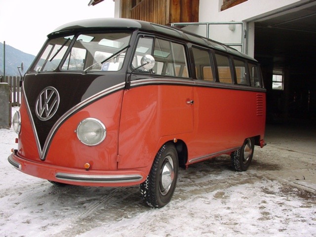

PT, what was the deal with the 23 window barn, that was hacked up? Was it for sale? Where was it? I am looking to build a resto custom barndoor bus, not picky of style, but would like to find one similar to that one from ebay.
