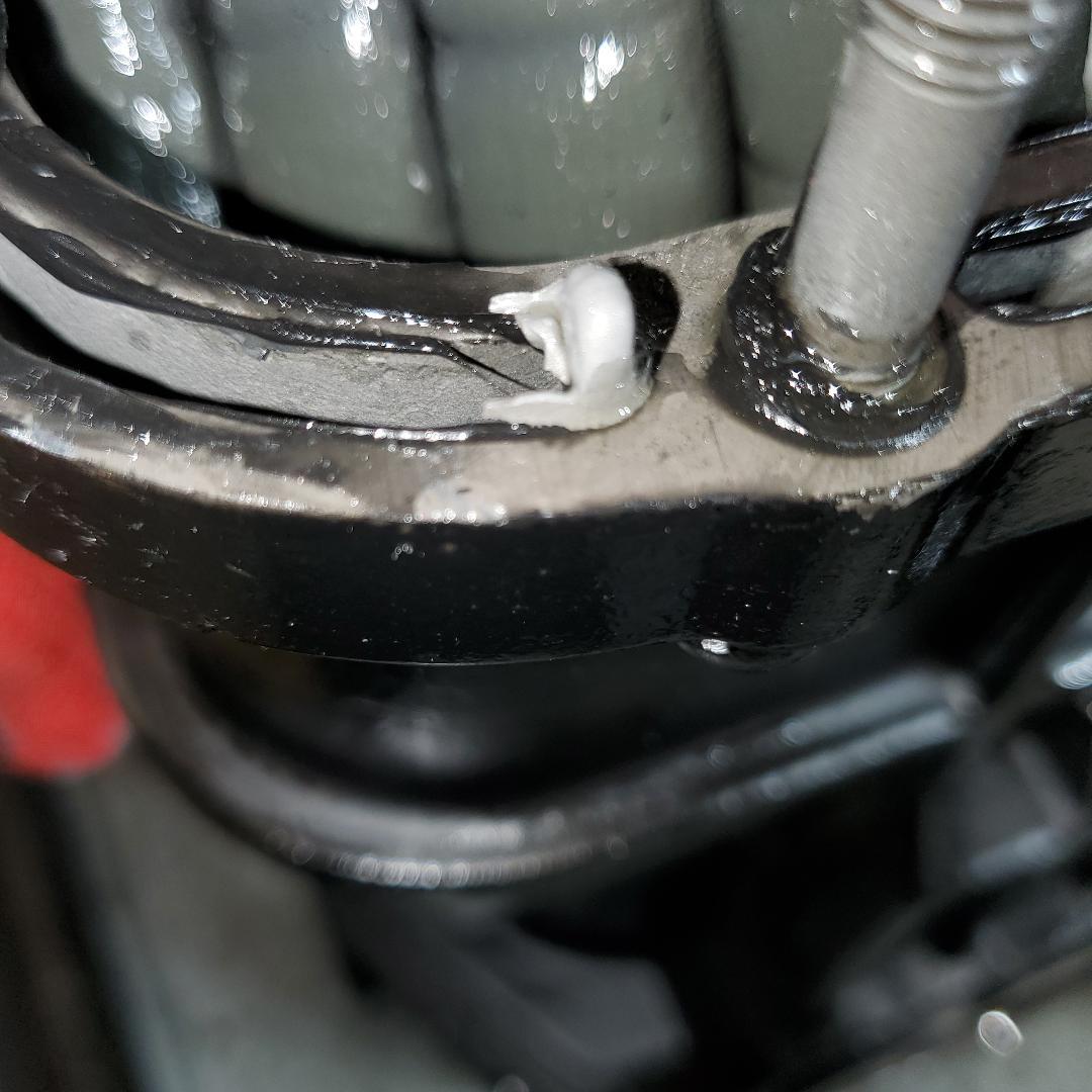

Then it went to shit. I came out one morning only to find a donut sized puddle of gear oil under the car. At first I thought maybe the fill plug or vent, NOPE!!! Sealant between the gear housing and main case was leaking like a sieve.

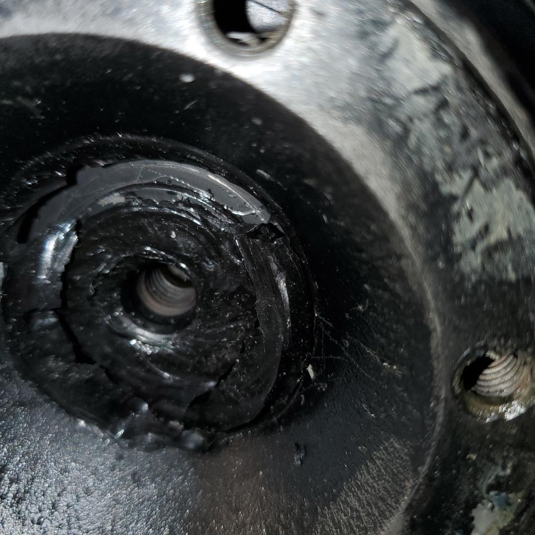

So I broke it down myself... After having to CHISEL the pinion nut off do to what appeared to be permanent locktite being added to the nut, and over 350fttq being applied to the nut and it NOT budging, I proceeded to tear it down.
For starters, he used what looked like the cheapest sealant he could find, kinda looked like that little tube of FelPro sealant they give you in an old GM intake gasket set, you know, the stuff you throw in the trash? It gets worse! There were remnants of MY old grey Permatex ALL OVER the mating flanges, hence the MULTIPLE oil leaks as the old sealant pushed out the new when the flanges were put back together, the kicker? NO CUP SEALS!?!? Just a wad of silicone. These seals not only seal the flanges, but ALSO provide a "BUMP STOP" for the axle shaft to the diff...

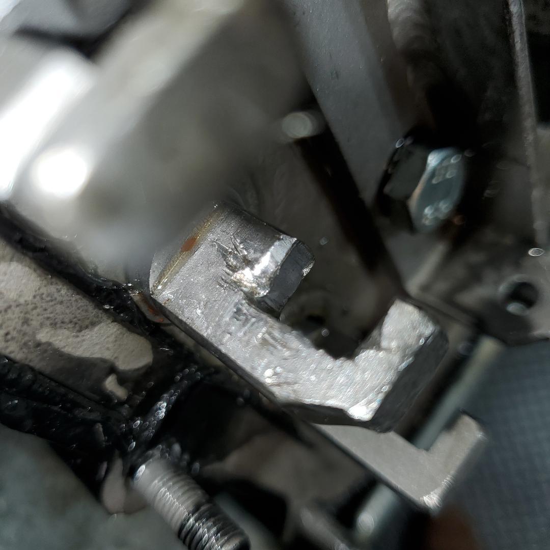

Then there's the thievery... He STOLE my NEW Weddle Reverse rail, Reverse pivot arm, Chromoly Pinion Nut, Reverse pivot arm lock nut, Reverse gear, swapped out my perfectly good "OLD STYLE" paddle style reverse gear actuator for the late style solid pin which I was told is inferior to what I had and put ALL the jacked up DAMAGED parts (REVERSE RAIL, REVERSE PIVOT) I sent in with the trans for inspection, back in the trans and kept the good parts!!! Hell I'm not even sure at this point if any of the bearings were changed as he claimed.
