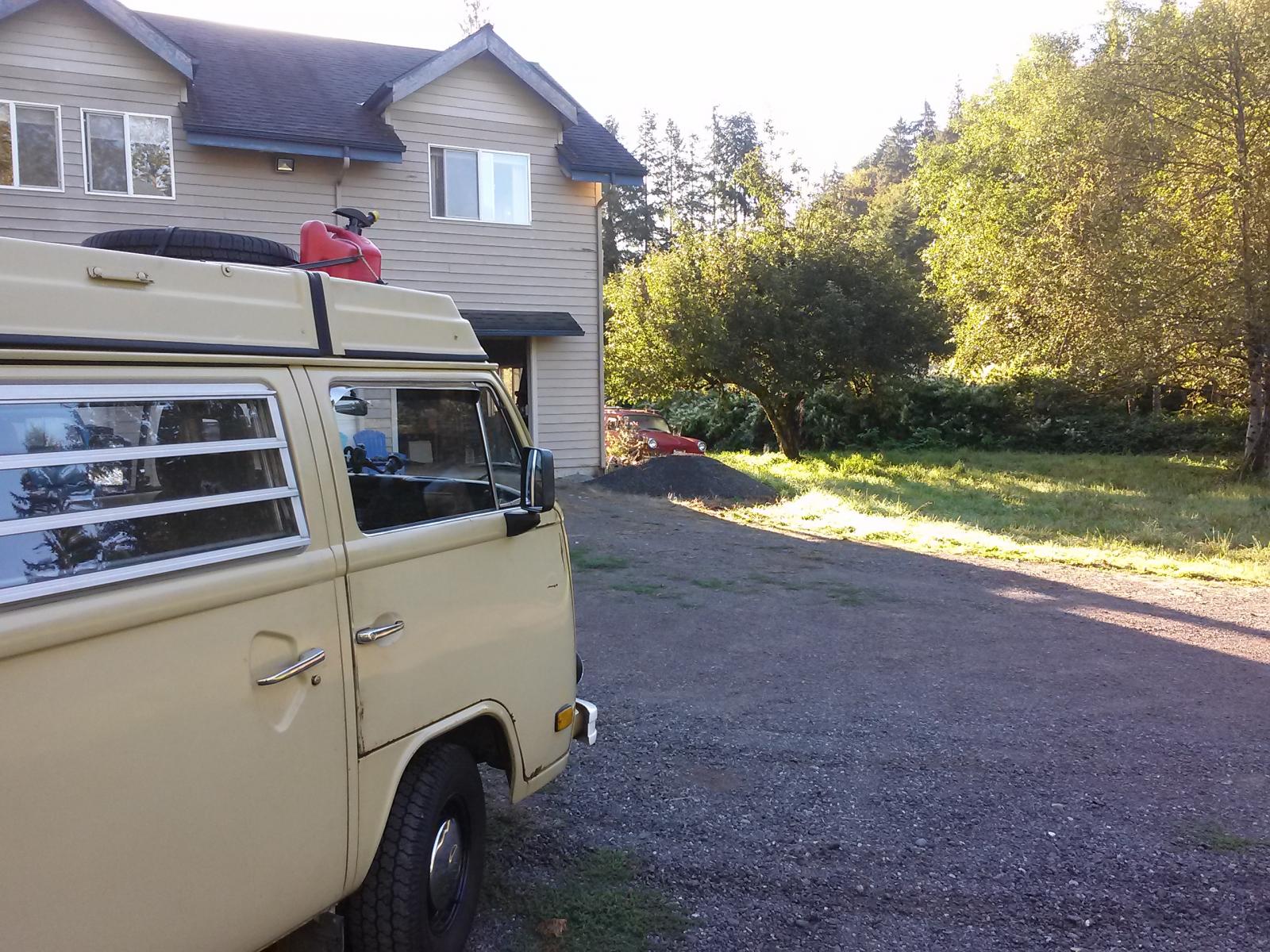

visited the square last friday...
really getting motivated to get it on the road soon! got a transmission install to do to my bus, and once thats going well, i really want to drag this thing back onto the road. may even make a trip out to just work on it where it is, rather then transport it back to continue the work.
suggestions on the tank...i suspect rusted holes in it.....thoughts on checking for leaks? i dont , repeat, DONT want to reseal it with a POR kit or anything...never heard anything good about those. just want to clean it out....
really just getting excited overall for VW's....bus transmission, looking for a splitty, and wanna get this running so i can use it! just super pumped up overall!
