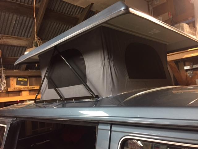

[Does the front and/or rear window screen unzip? (Not that I would expect them to). ]
No they don't but I have been thinking about that and I may sew that in in the future[/quote]

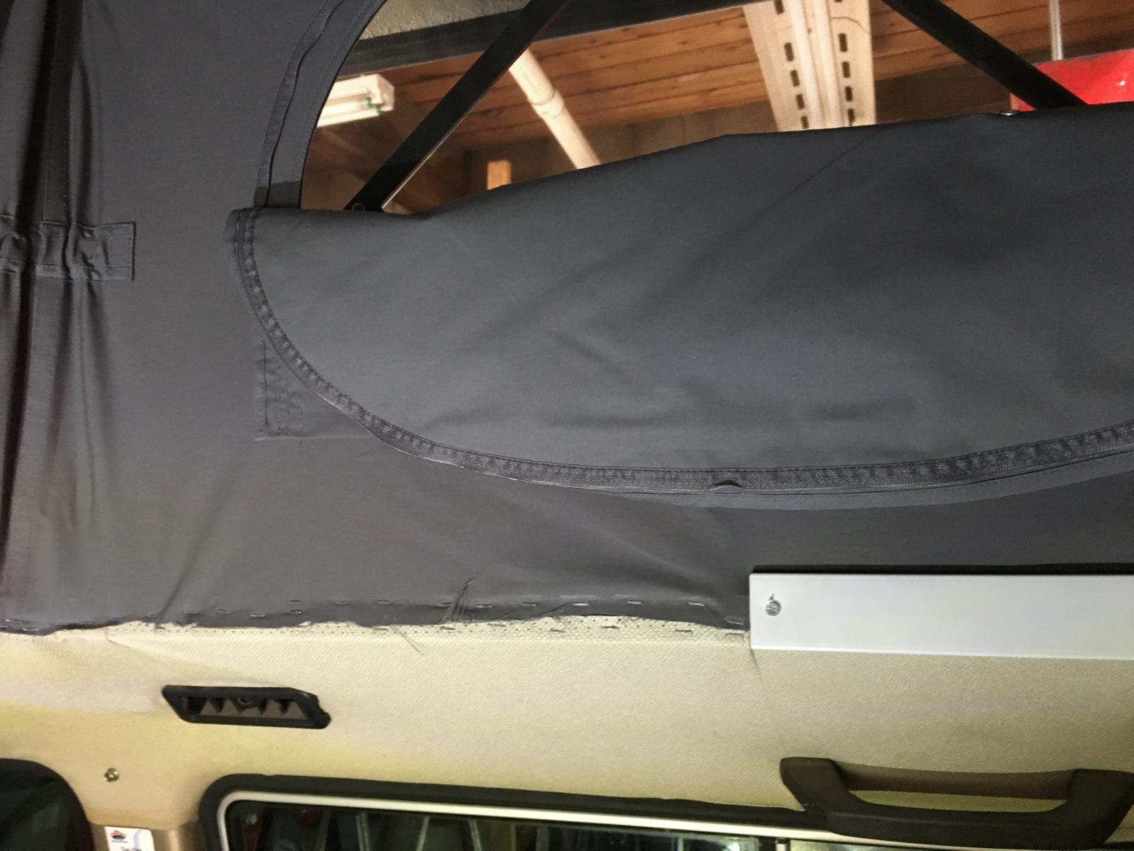

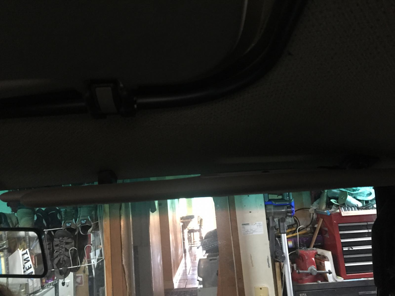

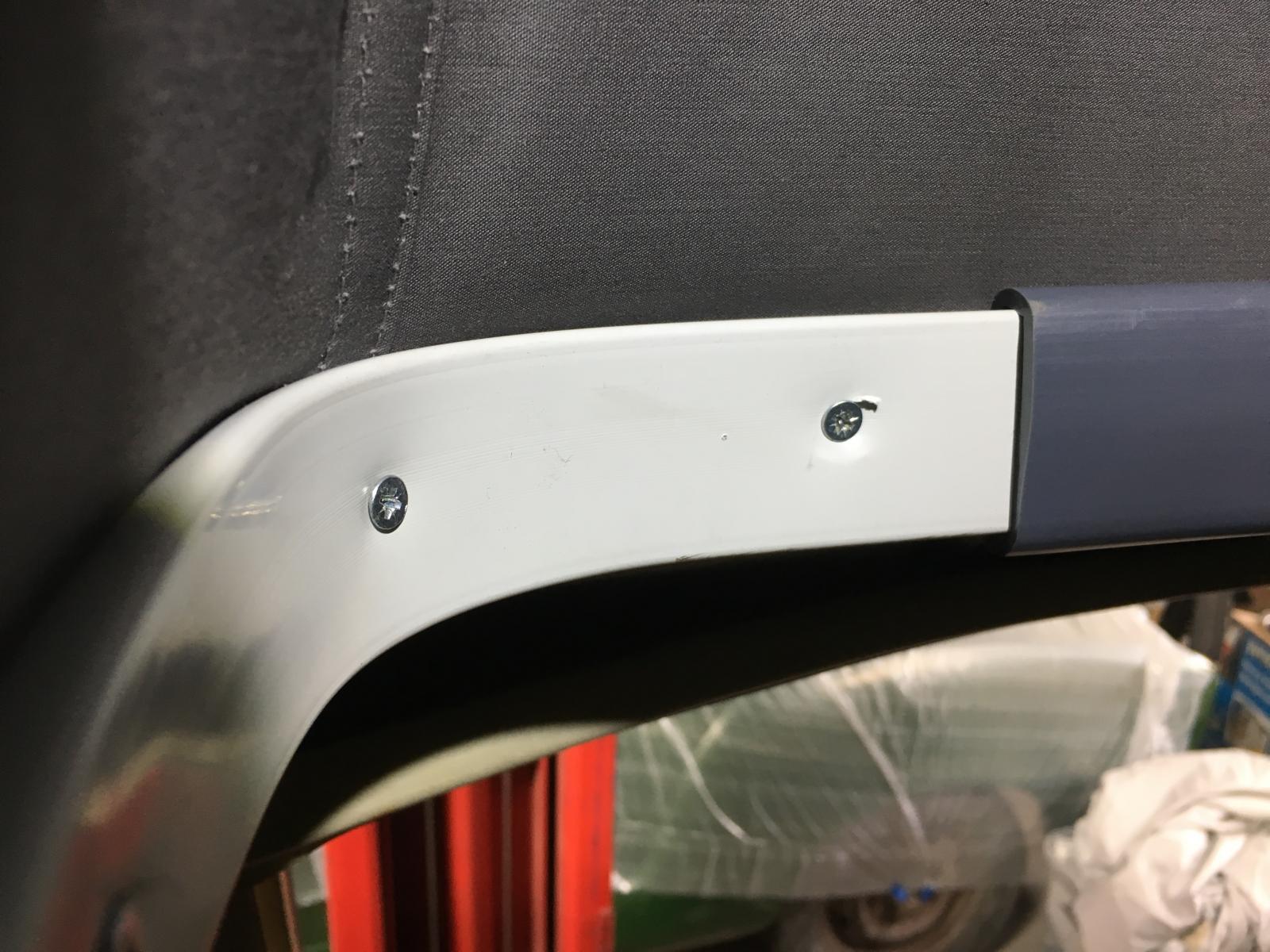

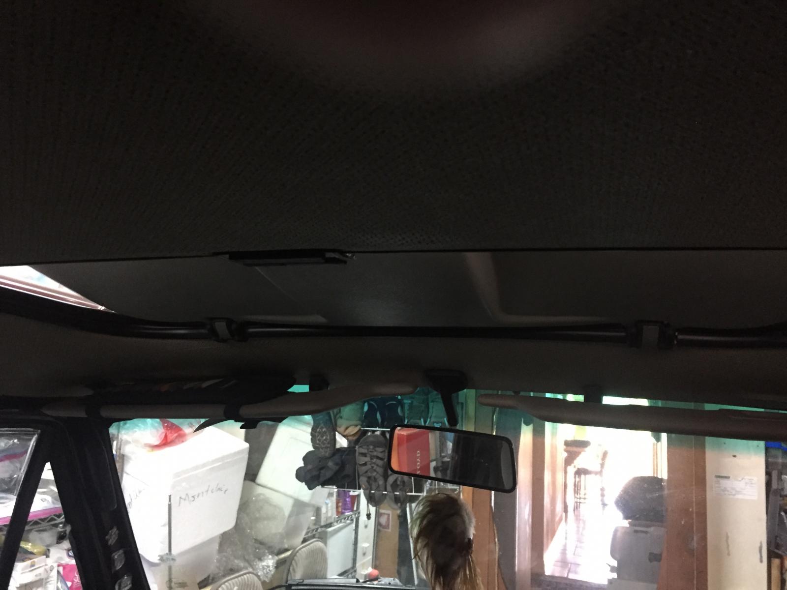

I have been getting inquires on how to handle the A/C Tunnel with the Reimo Mushroom top. Here are some pictures of my 1991 CHC with the Tunnel modification. Since my controls are in the dash it was easy to cut the center tunnel with the six vents and move it to the rear. If you have your controls in the sun-visor section then you have a choice:
1. You can leave them where they are, leave the front section installed, extend the wires to go around the hole and under the headliner. Your headliner is complete under the tunnel. You can use the front A/C section as storage for maps, sunglasses etc.
2. You can also move the controls to the dash. This requires extending the wires and going down the front passenger pillar. Use flexible wire and remove the grab handle on the pillar. The wires will come out behind the glove box. Take your time.
To hold the front face on the rear A/C duct I screwed blocks of wood inside of the tunnel so I could screw the face into place and I capped the screws. You can see them on the front of the trim. To hold the blocks of wood in the tunnel I used small screws and counter sunk them in the plastic and I hid them using the VW vinyl trim used to cover the seams of the A/C duct.
I have seen some people remove all the ducting and have a large hole in the rear to blow the cold air to the front.
Finally the front sun-visor will screw into the roof without the front tunnel. You will have too drop the sun-visor a little in order to clear the headliner. You will have do two things:
1. When you remove the front A/C duct there are two square black plastic pieces behind the duct. Use them on the visor on the swivel side to drop that side. For the side that holds the visor I made a wooden spacer from 1/4" plywood the shape the holder and painted it black.

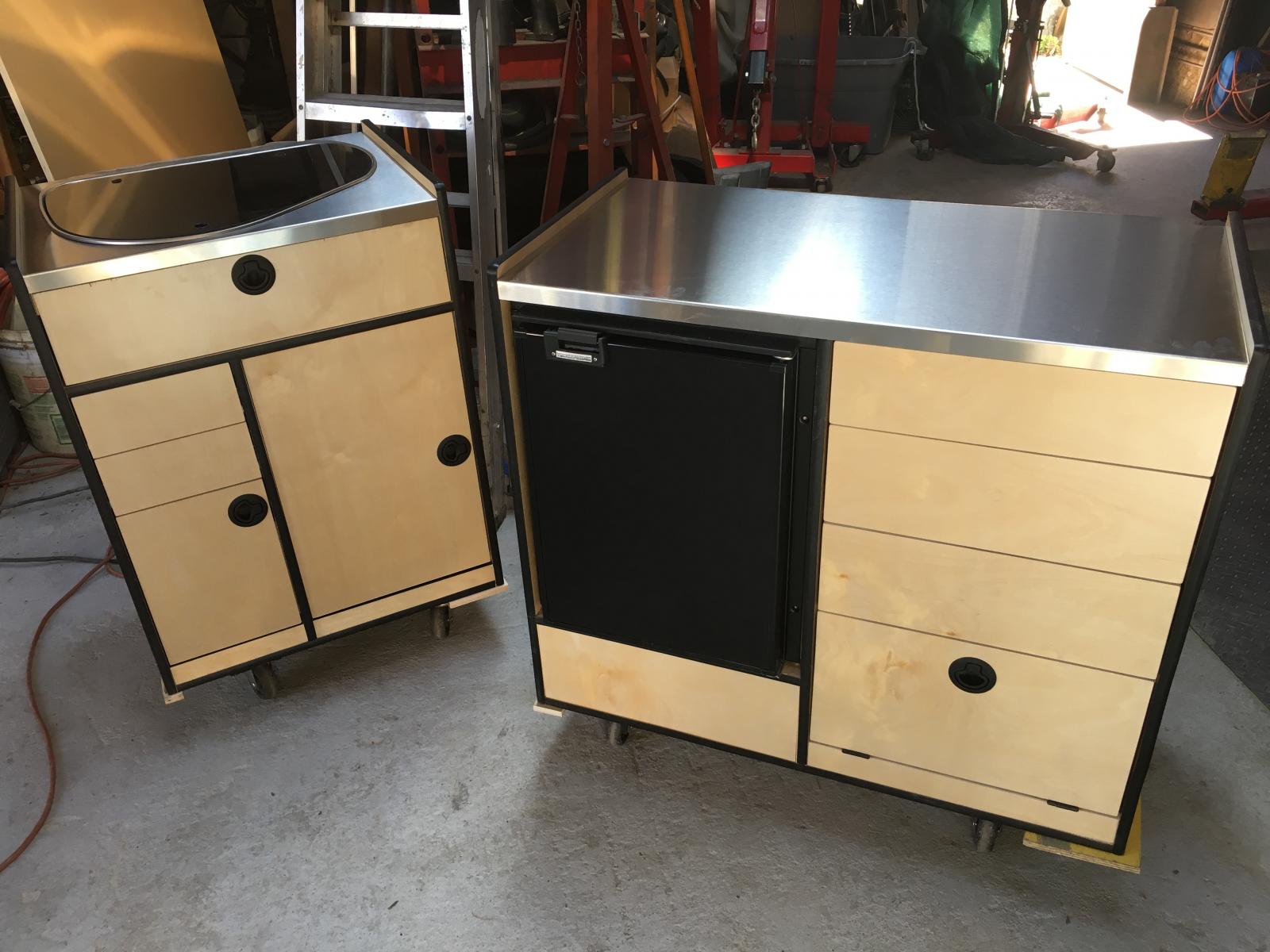

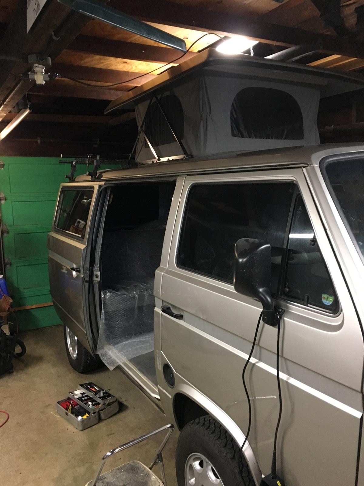

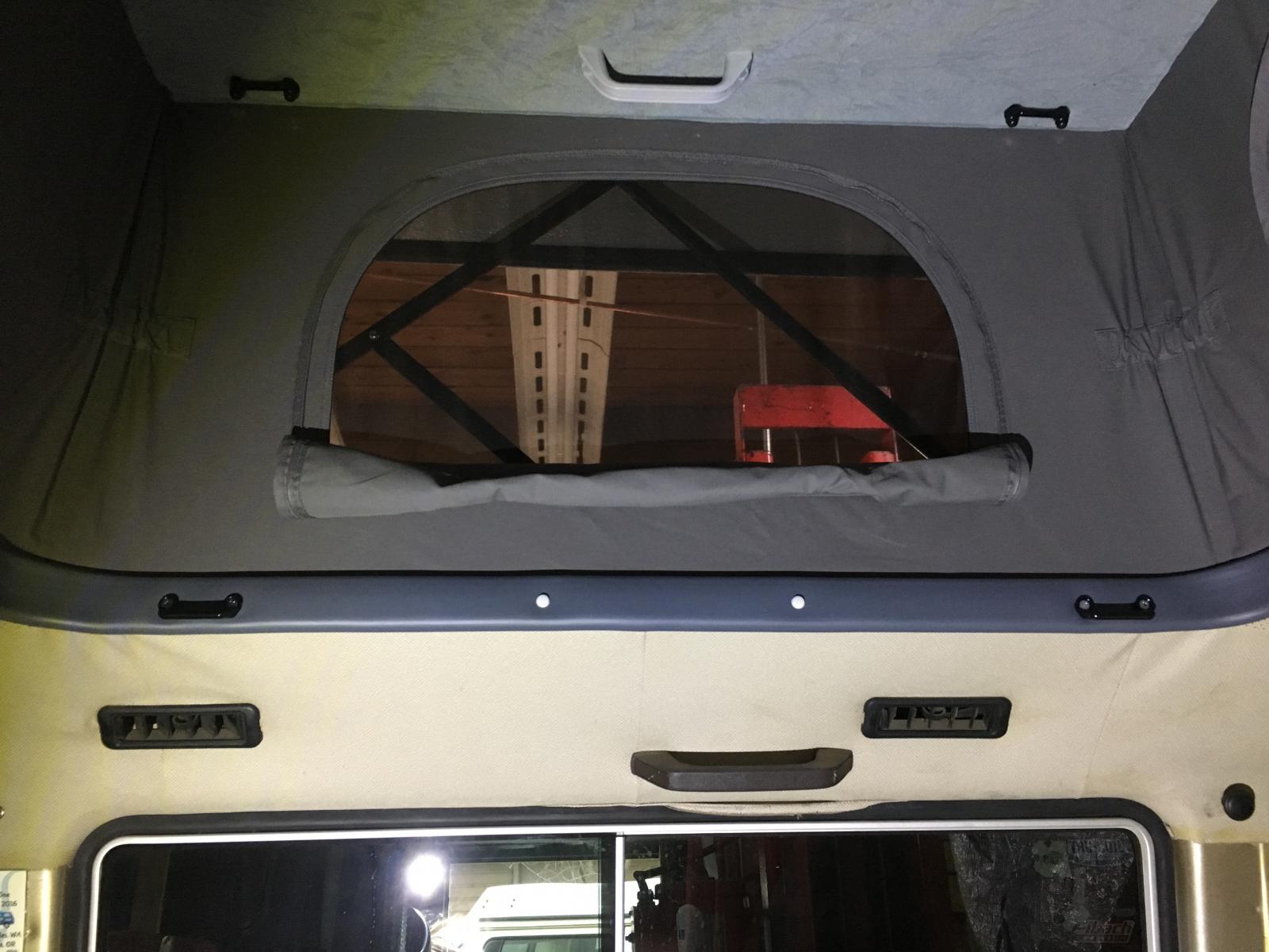

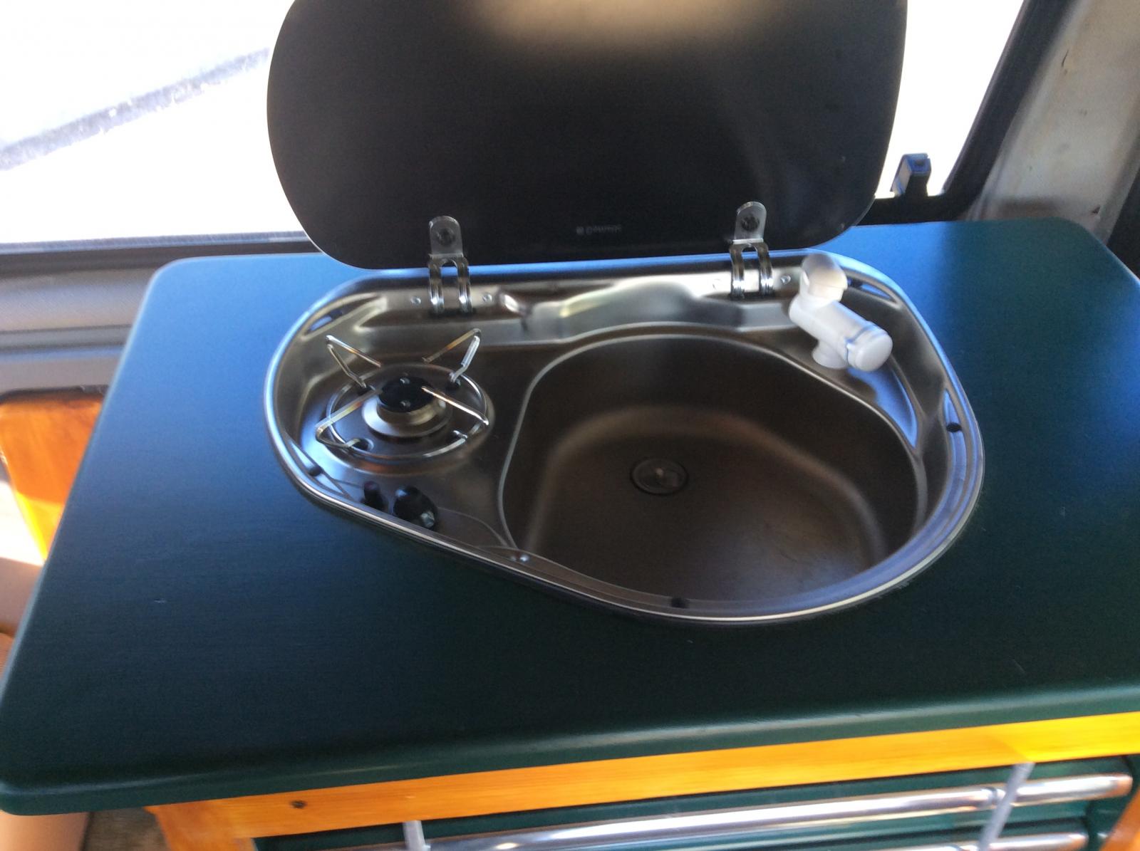

Here's a few more photos of another Reimo "low roof" poptop install. After staring at the German instructions and staring at the parts included it all eventually made sense. Salim had a translation and that helped too. I'll include a few photos of the interior finish components which really make the transition between headliner and poptop canvas nice.
Next up, installing these custom cabinets I built...

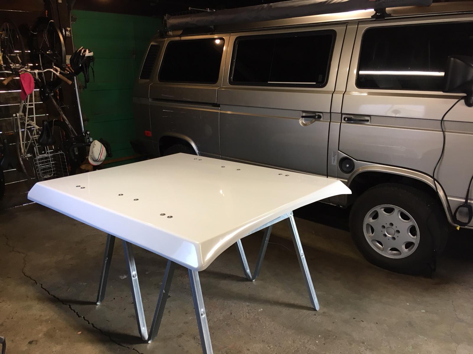

Painted (poorly), cut the hole, and mounted everything up. I just need to do the final interior trim, tie-downs, and silicon bead along the outside. Pretty happy with the quality. Happy to see the 30 year old Craftsman jig saw my dad gave me still powered through cutting hole in the roof! Laughing
Will test it out on a trip around Washington's Olympic Peninsula next week. Should be a thorough leak test.

Just installed mine , I bought it at drbjornsauto.com BC Can
Does the front and/or rear window screen unzip? (Not that I would expect them to). That would make getting items out of front or rear rack easy.
Yes, I believe so, at least one but I think it is front and back are Von Zippered... Laughing
